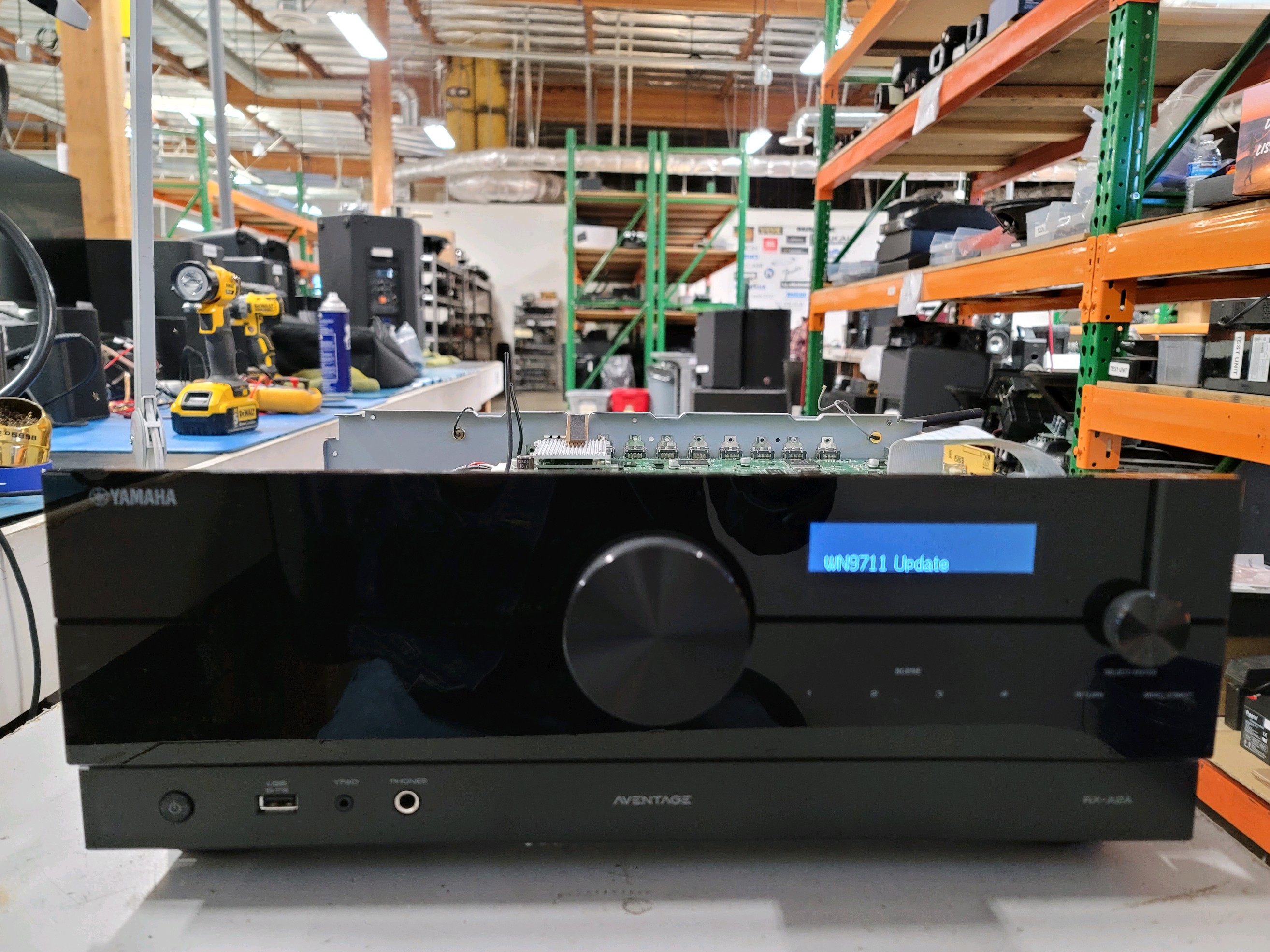

    I have a RX-A2A that doesn't do anything besides stuck with WN9711 Update. Any ideas I can get pass this screen?

    Looks like there is a TTL port on the lower left. Hook up to it and see what’s going on in there. I suppose you can’t do the reset procedure? You also could put the latest firmware on a USB stick and try to update it. Maybe someone tried to do an update, but then pulled the stick out or turned the unit off.

      The error would suggest the wireless lan had a problem, Try putting the firmware on a usb stick as suggested, or try connecting a network cable?
      See if this procedure works with this model:

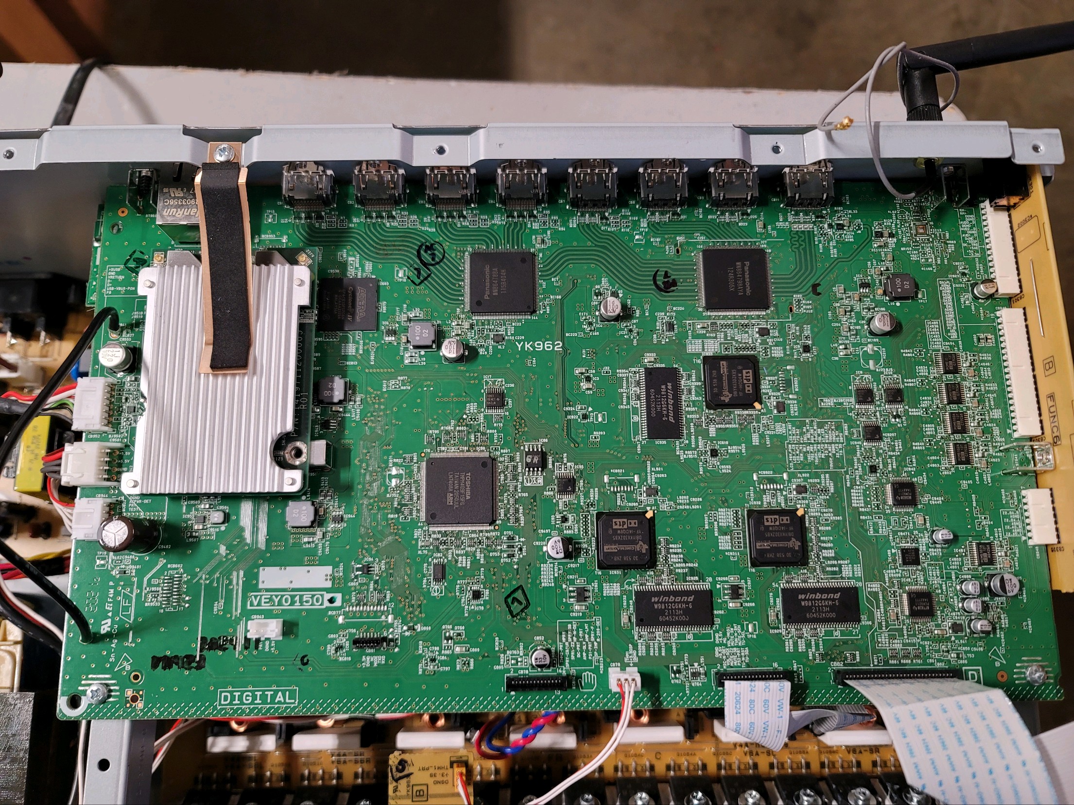

        Repair is completed. There was a port on the board where I jumper the pins that allowed me to access the settings to complete to the update.

              Here are the instructions. Took me a while to hunt it down. Should help for RX-V4A, TSR-400, RX-V6A, TSR-700, and RX-A2A showing a WN9711 update. Gotta program the EEPROM.

                    Did you do what it suggests on page 3? Press SCENE1 or SCENE2 key several times until the error message disappears.

                              yes its J260
