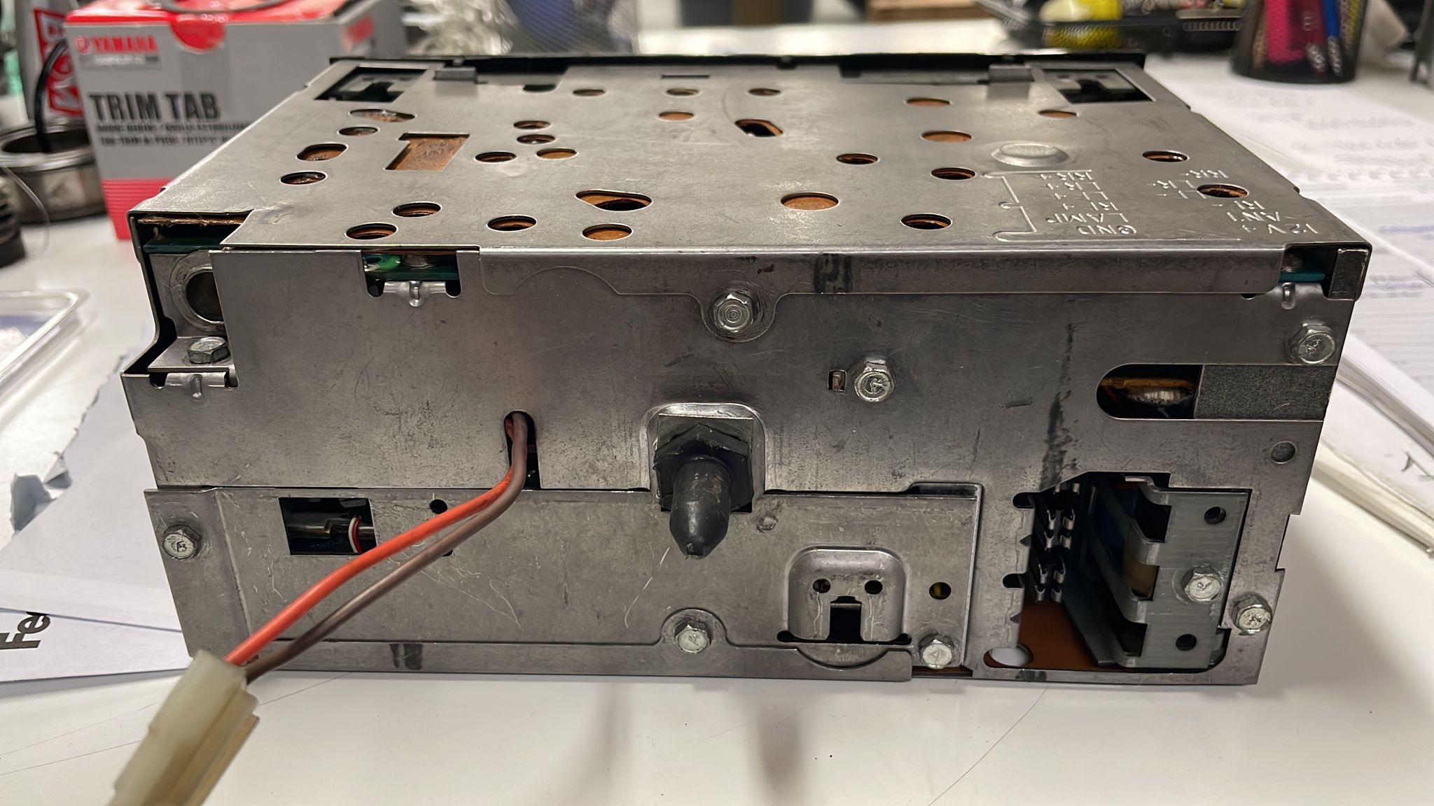

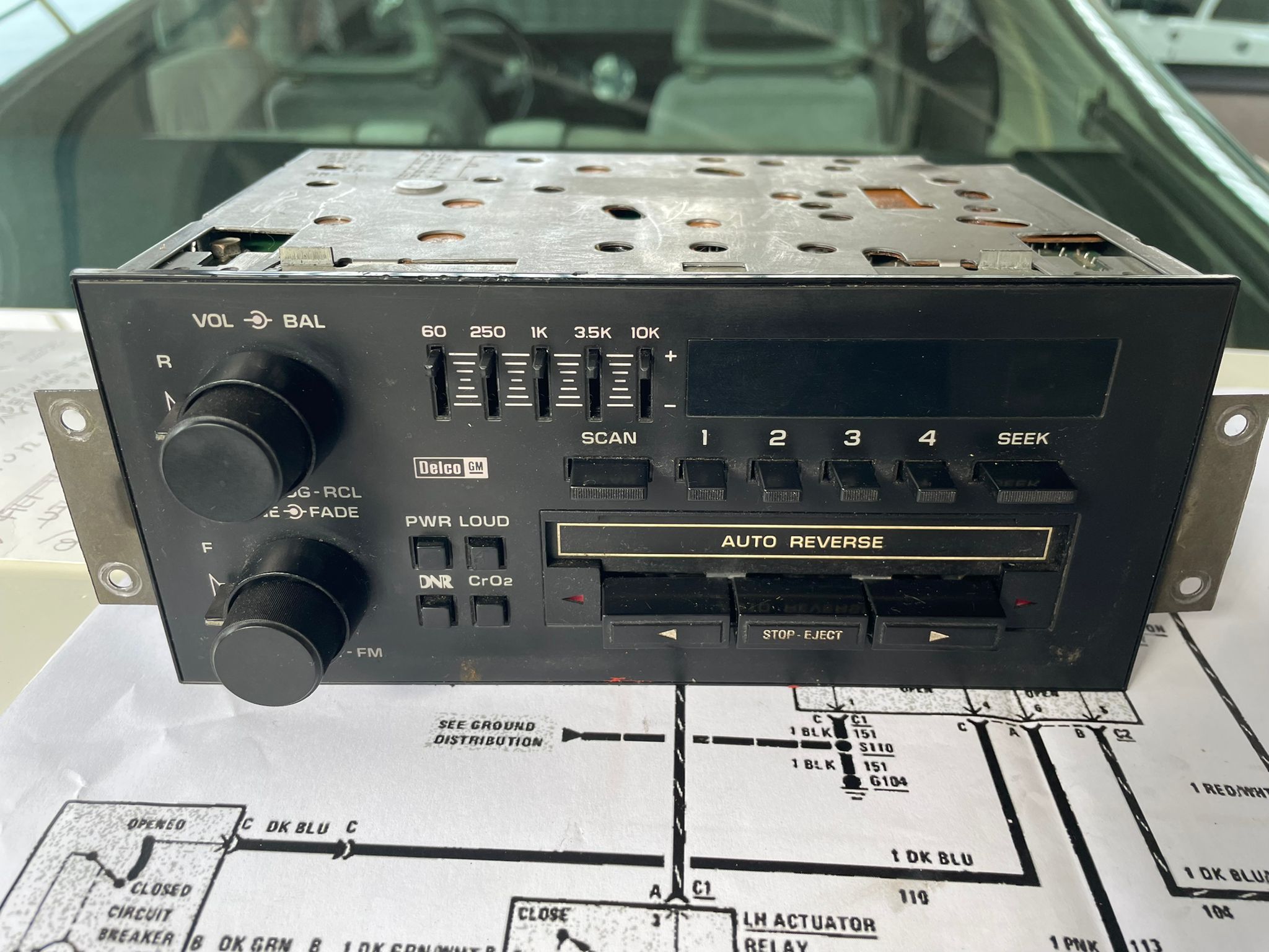

    Hello to all friends and welcome back
    I am struggling with a complete restoration of a Delco GM car radio, I have already taken these car radios in the past but this is a bit more complicated and has many problems, in the meantime I ask if anyone knows the exact model in order to trace a possible repair scheme, I have if someone and they have it I would be very happy, I am attaching photos and I also ask what is the purpose of that two-wire connector that comes out from the back (orange-brown) the radio turns on with the display completely off, the mechanics make strange and non-strange noises accepts the tape, the audio is distorted on all channels, first of all I would like to start with the display off, I have only redone some soldering but nothing has changed, I have also found two faulty micro-lamps have been changed and now they turn on but the display always remains off, is it possible that it has something to do with the small connector on the back?
    thank you all

    Re: Car Audio Delco identification and restoration / repair
    Seems to be a model number 16066335.
        I believe the 2 pin plug is for constant +12v (memory) and display lamp (controlled by dash lamp dimmer)
          Thanks a lot R_J
          I just connected the red to the + 12v but I still have a display turned off, what should I connect to the brown cable?
          obviously I feed everything on the counter
            The Red wire is likely for the constant memory backup, the brown should be for the display, connecting it to +12v should light the display
              Just tried + 12v on the brown cable too but I still get display off, troubleshooting tips?

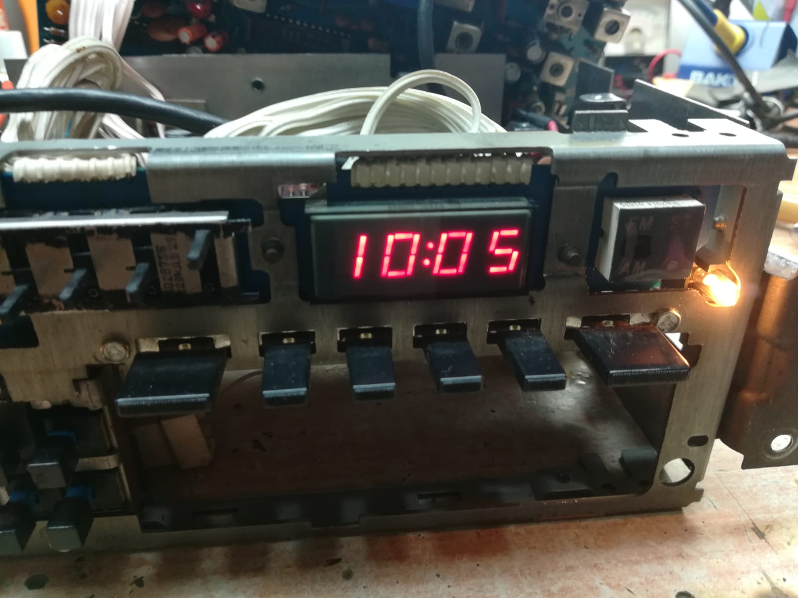

                        The two-pin connector P201, schematic shows one wire is BATT, other is Park Lights. So the unit will not power up unless you have power to BATT (as well as IGN and RCVR).
                        The 12-pin connector also has park lights (DIM), IGN 14V, RCVR 14V (power amps) but can give no 5V power, that seems to come separately from the 2-pin connector. Very strange Delco. Maybe they wanted a quiet take off point.
                        On the 2-pin connector, you can put power there, not sure if orange or brown wire.
                          The 2 pin cable will require +12 volts for the Batt lead as well as +12 volts to the PK Lights lead. This controls the display. the DIM connection controls the brightness of the internal (trim panel) lamps and may also control the brightness of the led display as well, so the dim also need +12 volts (or less for a dimmer display)

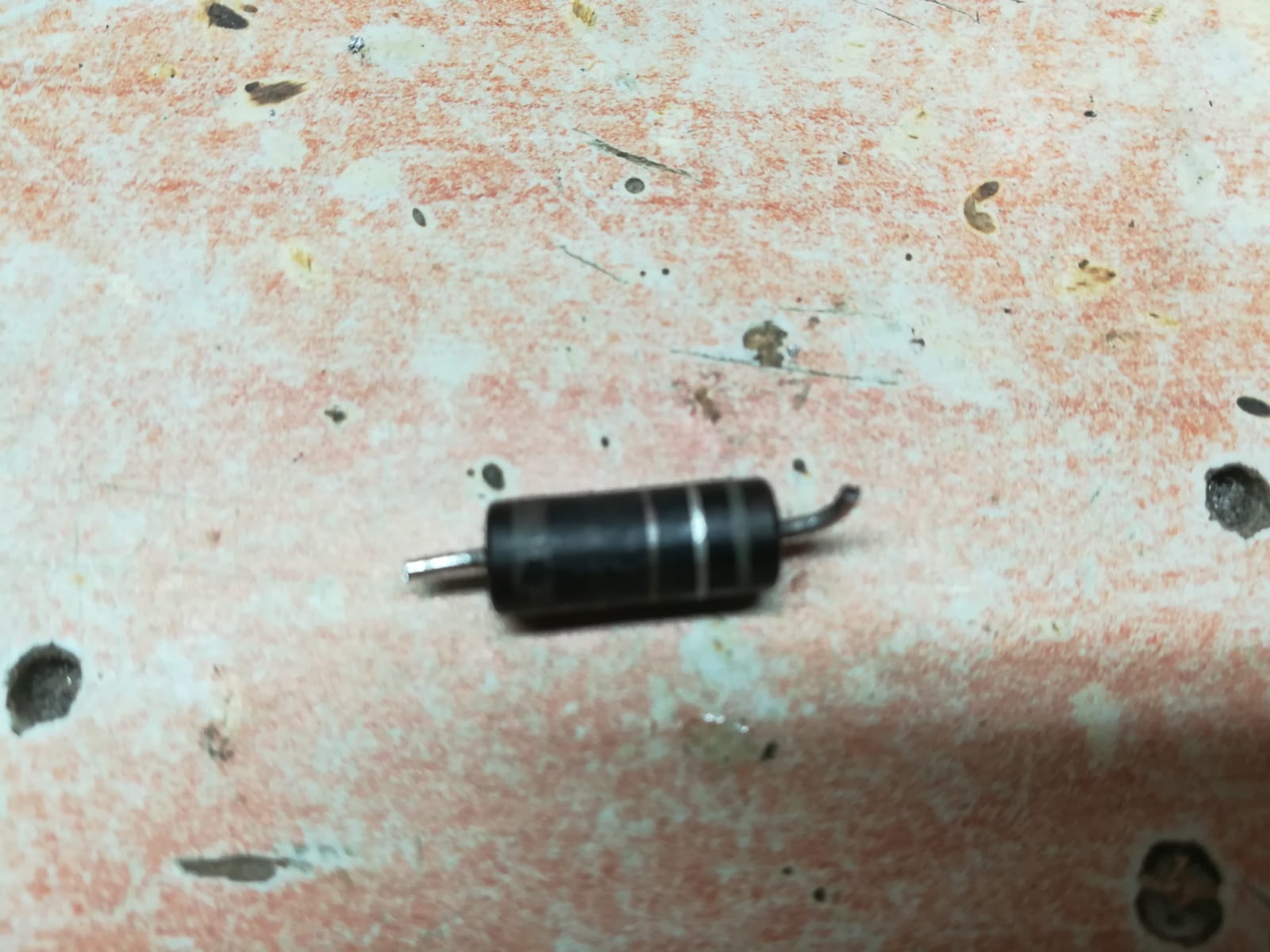

                            Update
                            Thanks to the diagram I have identified R240 from 6.8 ohm (page 23 and 27) which incredibly measured 30k, replaced and now we have a clock display on (attached photo) but as you can still see the small am / fm display is off, so something is still not go, all your help is very precious and I am grateful to you

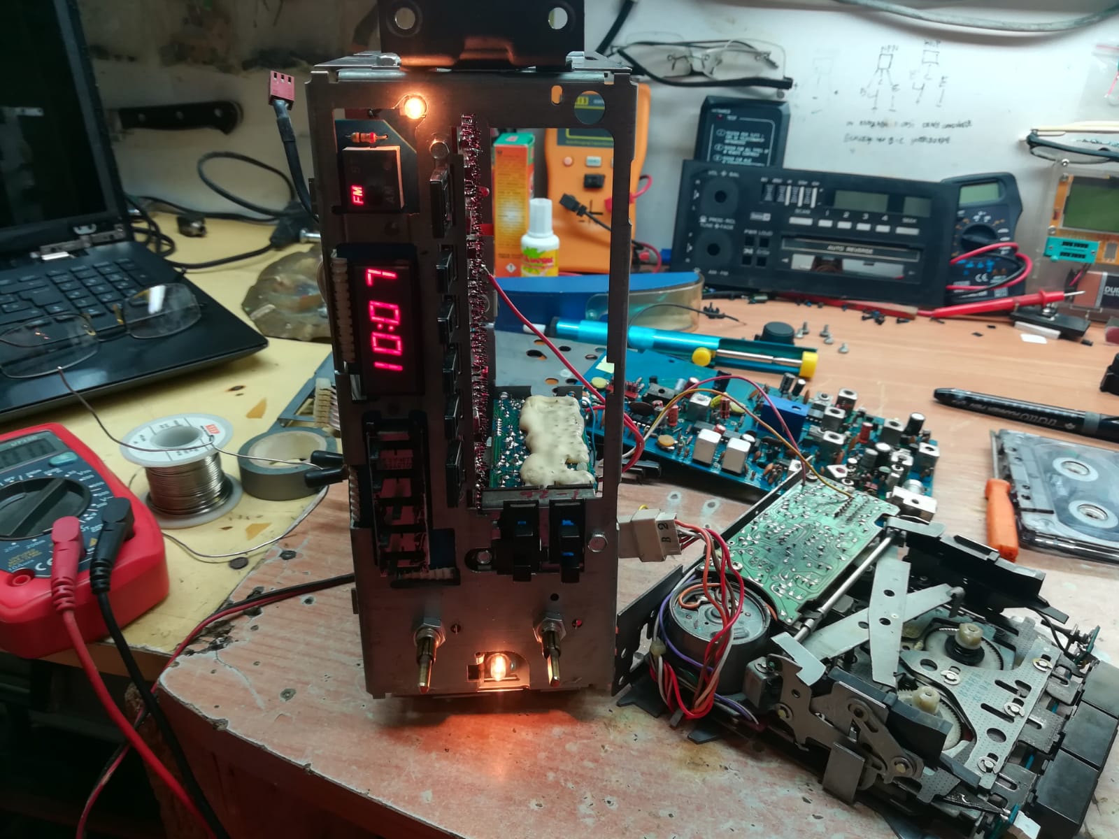

                                If the clock display is on, it could be the radio in not actually turned on. What is the voltage on the resistor R240? if it was open, something else on that line may be damaged, check if you have +5v on U204
                                  Hi guys ... the + 5v on U204 were present but with pulsating voltage due to a short on C231 electrolytic 16v 100uf replaced and now we also have the second display on, now that I have both displays I am dedicating myself to the amplification part, the whose audio is almost a hiss on all channels, the volume responds to the control, four IC DM113 are mounted on the amplification circuit we hope they are not fried
                                      Thanks keeney123 you do what you can
                                      Changed all electrolytic capacitors on the amplifier board but still I get the same hiss, by applying an external source on connector J301 (page 7) all four channels sound perfectly, so it is excluded that it is the amplifier, but instead the noise comes from the preamplified part, the thing gets complicated and I can't understand what kind of component could affect all four channels, I would also exclude capacitors on the preampl section ... but now I find myself in a deadlock ... all the advice is well accepted ... thank you
