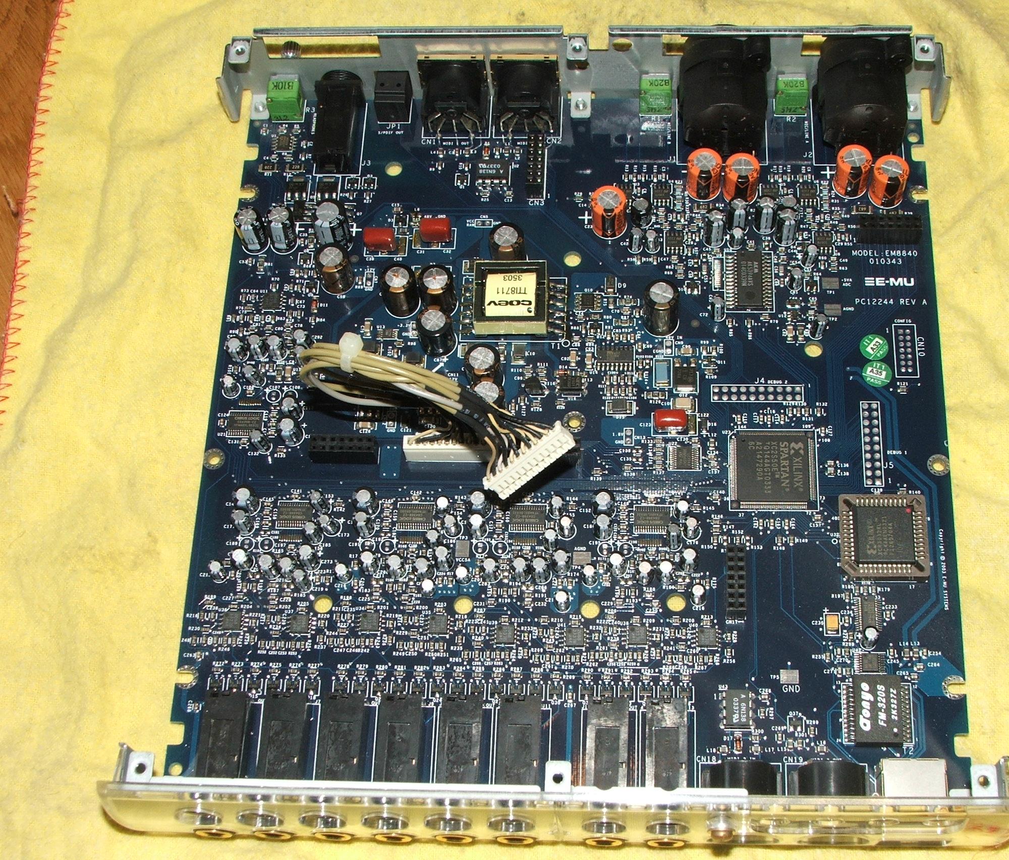

    Hi, first post here!
    I have an EMU 1820M soundcard which has been fine last 3-4yrs, but suddenly went wrong by making strange popping noises and won't detect the breakout box so I took it out and cleaned the PCI cards up. I forgot about it for a while and used the onboard sound but then yesterday I put it all back in the computer and it was still faulty. I uninstalled all the drivers and reinstalled the latest ones - still faulty.
    I started to do google searches and came accross some youtube clips of similar faulty souncards and one of the comments said it was bad caps.
    I then searched bad caps and came accross this website. And here I am!
    So I read a few posts and got the courage to open the breakout box and have a look inside. At first glance all seemed well but then I noticed 2 bad caps!
    https://www.badcaps.net/forum/attach...id=16957&stc=1
    https://www.badcaps.net/forum/attach...id=16958&stc=1
    https://www.badcaps.net/forum/attach...id=16959&stc=1
    https://www.badcaps.net/forum/attach...id=16960&stc=1

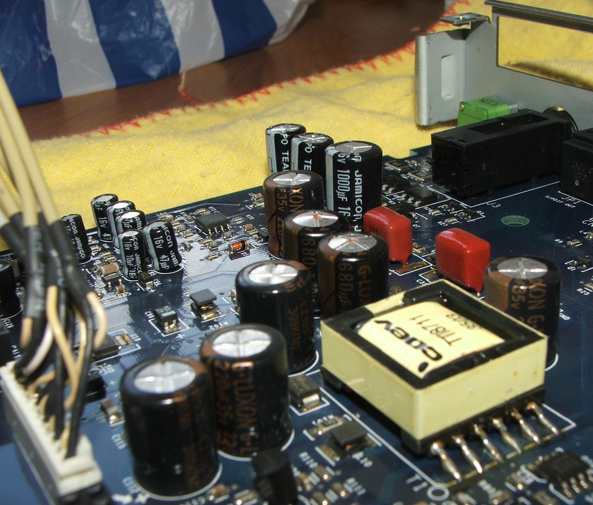

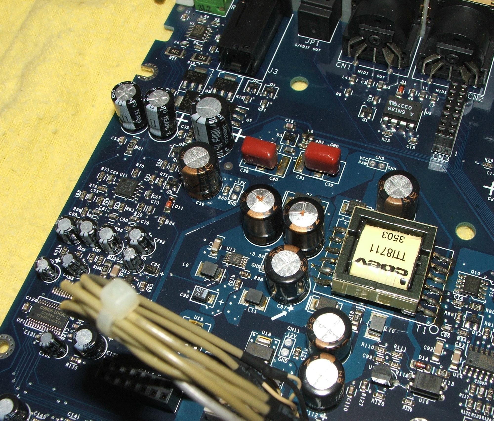

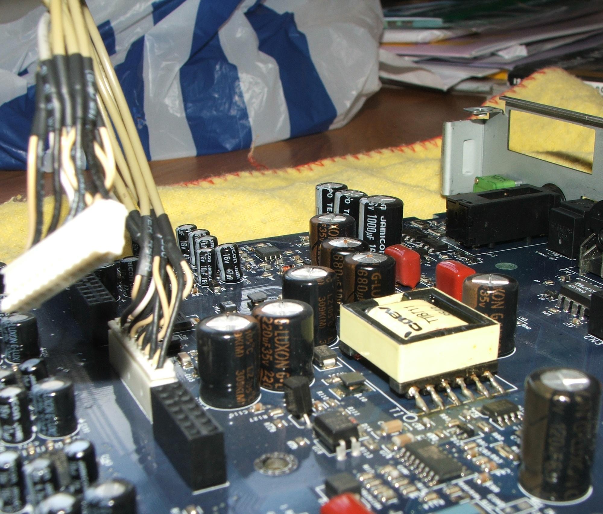

    I got the info off them - G-Luxon 680uF 10v LZ 105C, diameter=10mm, height=12.5mm. And then I ordered some Panasonic EEUFM1A681 from RS-Online. Should get here tuesday.
    But I was wandering if you guys think I should replace any other parts while I'm at it?
    And have I done things correctly? I think I kind of rushed in a bit but think its all correct.

    Re: EMU 1820M not working properly
    kinda sad to see what crap manufacturers put in there..
    replace all the G-Luxons.
    and what are those orange ones? pics?
      The orange ones are more G-Luxons
        They even put the microprocessor in a socket, yet used useless capacitors.
        Makes me wonder if the manufacturers actually know how bad these capacitors are...
        Hopefully you'll get it working in no time!
          Just posting to say I changed the 2 bad caps and I'm listening to the soundcard on my headphones right now(its late) and it sounds awesome! I couldn't wait to order all the other caps to replace them as well but I'll be happy if I get another 2 yrs or so until the next one goes. Actually if another does go I will replace all the rubbish ones.
          So a big thank you to Bad Caps!

                  If by RS you mean Radioshack then don't. They don't sell high quality capacitors.
                  I would at least replace all the G-Luxons, not just the two leaking ones.
                  No need to go crazy getting higher voltage parts, there is no real point. What you really should do is make sure you match ESR and Ripple current rating as the originals (You will need to look up this in the datasheets)
                  ESR should be same or lower, RCR same or higher.

                                      Thank you. An interesting thing just happened. I just had a friend over and he was looking at my interface and noticed something that I had missed. There is some discoloration on something on the board that looks like it may have been a failure which needs to be replaced. Problem is, I don't know what the thing is called to find a replacement or its function.
                                      In Broosta's origional post he uploaded some photos (2nd & 3rd), you can see thing that has a white ribbon around it marked as "coev, TTl8711" on top. Mine has clear markings as though it has been shorted, the ribbon has some burnt markings on it the color of caramel. I took some photos and tried to upload but for some reason the browser keeps timing out when I attempt to upload them.
                                      Does anybody have any guess as to what it might be?
