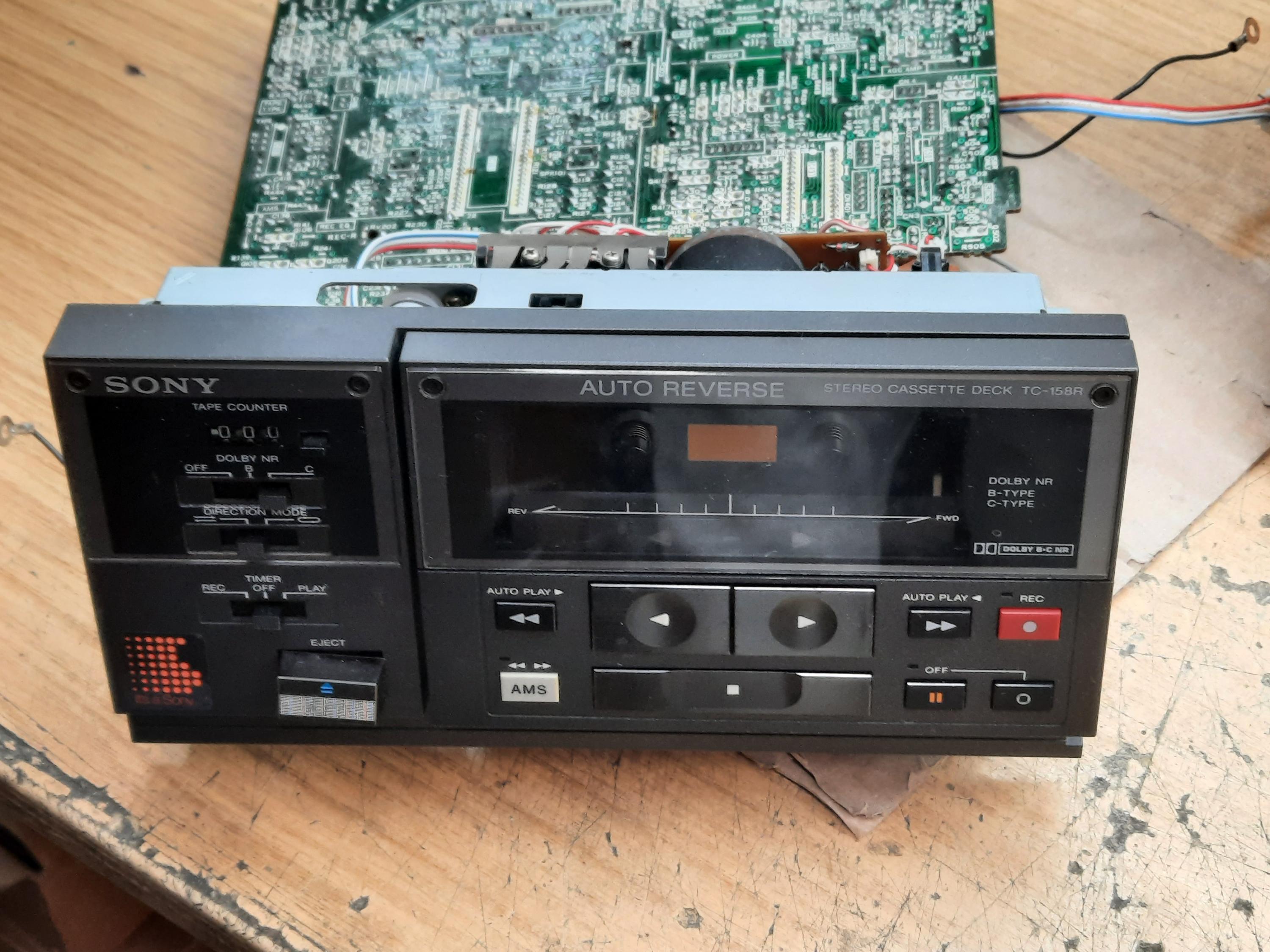

    Hi all
    This unit was working apart from noisy capstan motor .
    Popped off the back cover to clean brushes & lubricate it .
    When tested again it ran for a short while , then no power to deck .

      Re: TC158R , Sony cass deck schematic please
      Check your work- either you didn't put it back together properly or there is a (new) broken connection, bad solder joint, cable connector etc.
      Sometimes working on the motor can cause a short with the built-in servo board or brushes etc. You could try disconnect the motor and see if the unit powers up, or too late and a fuse popped.
        Thanks Lotas & Redwire
        Suspect a safety resistor has popped somewhere .

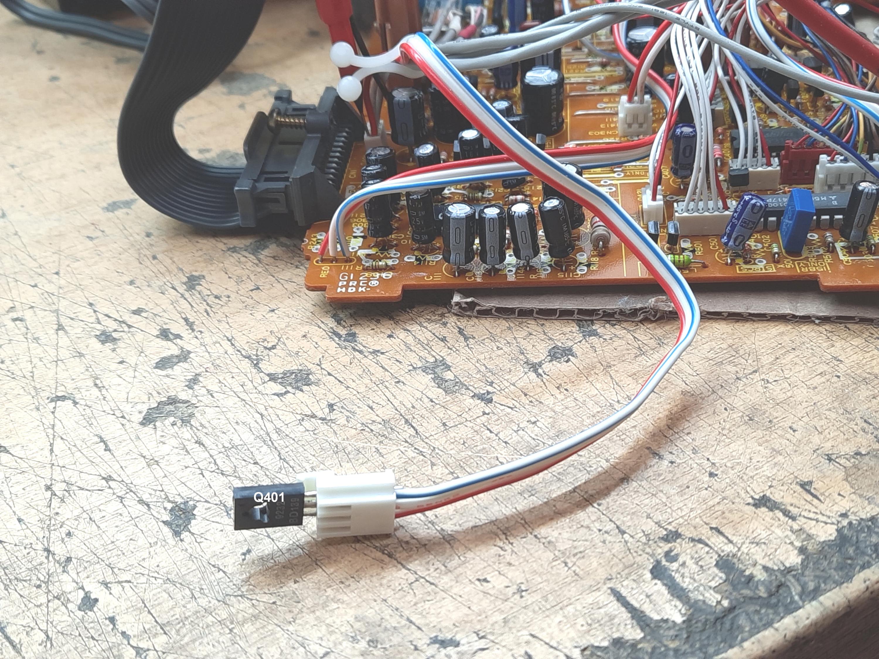

          Really impressed with schematic quality , considering original only available on on paper manual .
          Q401 , type 2SD809-K , which is part of the capstan drive network found to have an O/C B - E junction .
          Replaced using the slightly more powerful BD139 .
          Motor functions now restored
