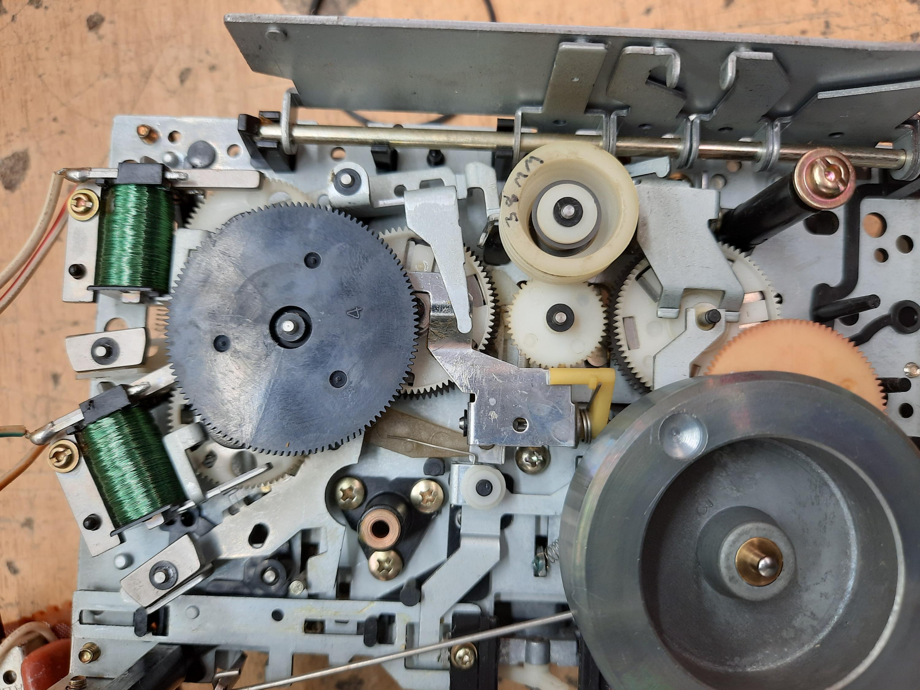

    Hi all
    This deck keeps jamming.
    Took a chance & ordered an upgraded FF cam gear, plus slider sold on Ebay, as I thought it might be a common cause of issues being that it was sold a repair kit.
    Well, that's what I get for making assumptions.

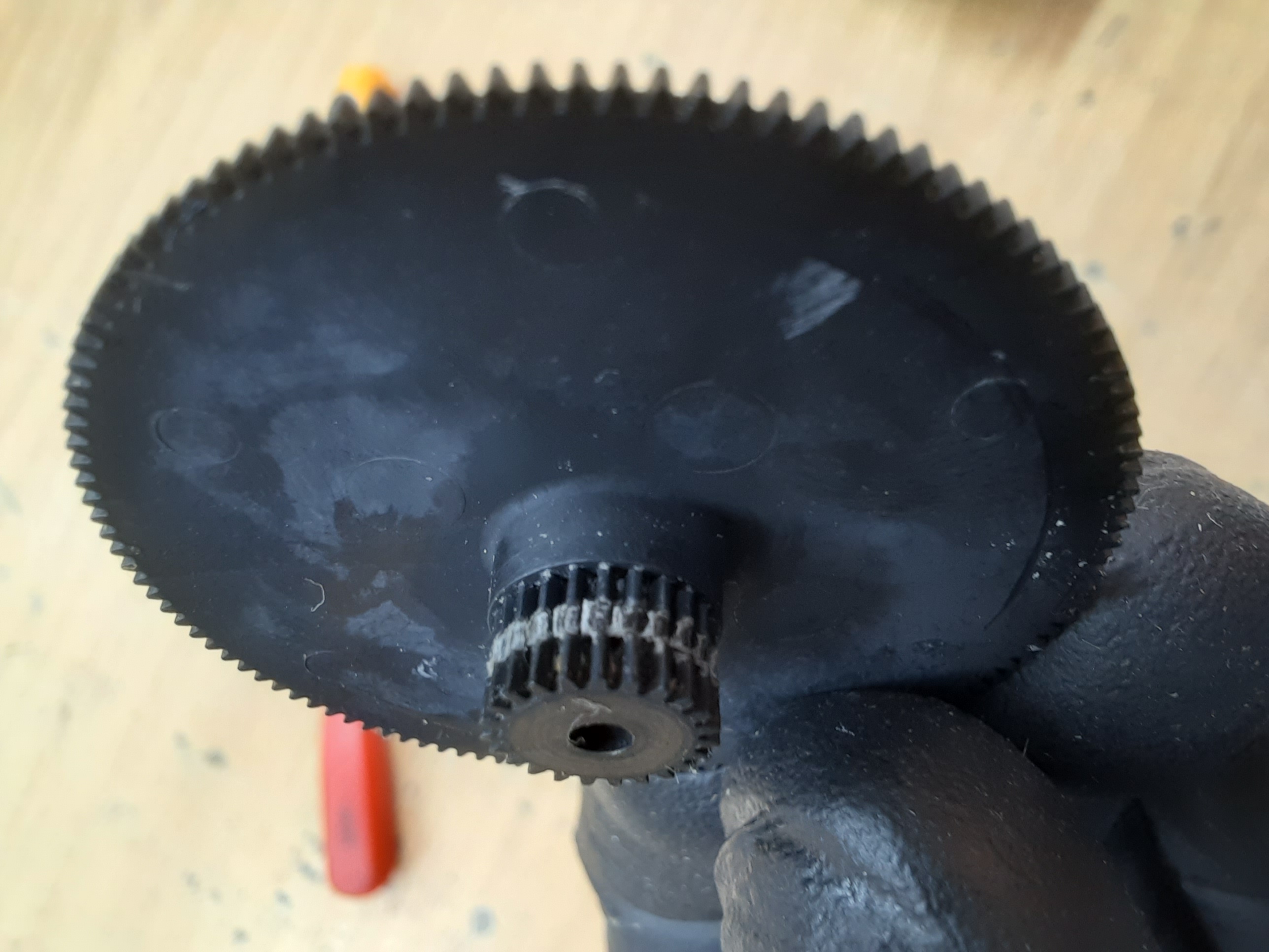

    Stripped down & discovered a large black intermediate gear with worn teeth.
    Can anyone help to source it?

    Re: FH7 Sony cass deck service manual & gear required.
    The service manual is online, the part number for the (T) driving gear is 3-307-321-00, The new number was 3-307-321-12, but it is likely NLA
      Thanks very much RJ
      Potentially have a colleague that may be able to 3D print it for me.
