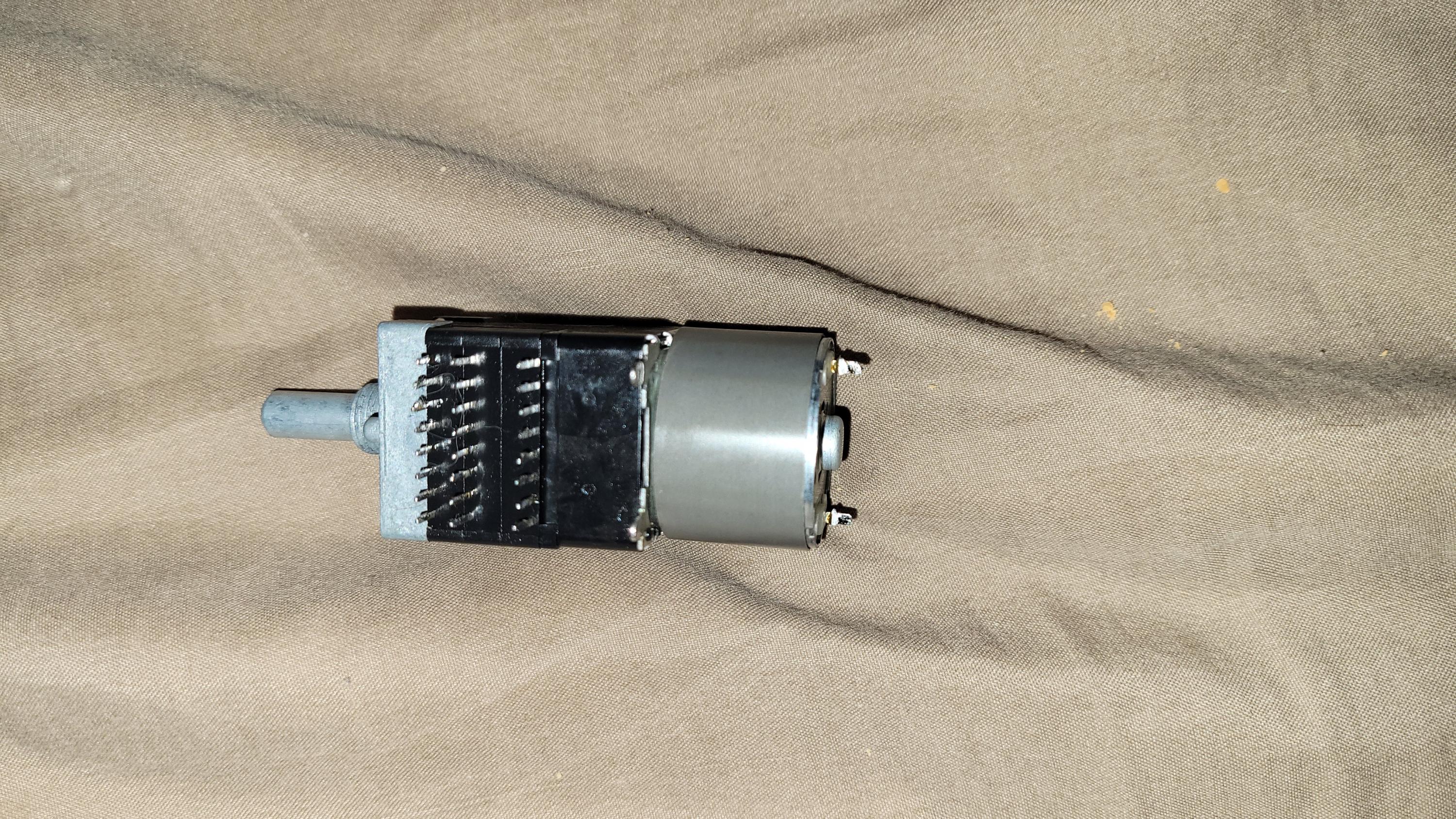

    Sony DE-425 volume motor/knob
    So, I had it in the living room but the remote control for the volume started slowing down and eventually starting and stopping.
    I got the motor out, think I broke a trace but there is enough exposed on it I can probably blob the lead to it
    Also, I can't find the damn knob. I'll get there when I get there
    Anyways, here is the potentiometer/stepping motor
    It has an 8x3 pins, and I can't find a replacement, only ones that are single row (8x1)

    Re: Sony DE-425 volume motor/knob
    Ali has items that look similar, I guess it down to spec as to whether they match. . https://www.aliexpress.com/item/4000822055553.html
    https://www.aliexpress.com/item/4001063463840.html

      Interesting. Searching for the model with 8x3 rows show it's for "six channel", and the 100KAX2 says for stereo, like this amp. I wonder if they used this volume board for a number of receivers, some 6ch, 4ch (quadraphonic), and stereo like this one, and just used the same pot for all the different models. Makes me wonder if an 8x1 will work

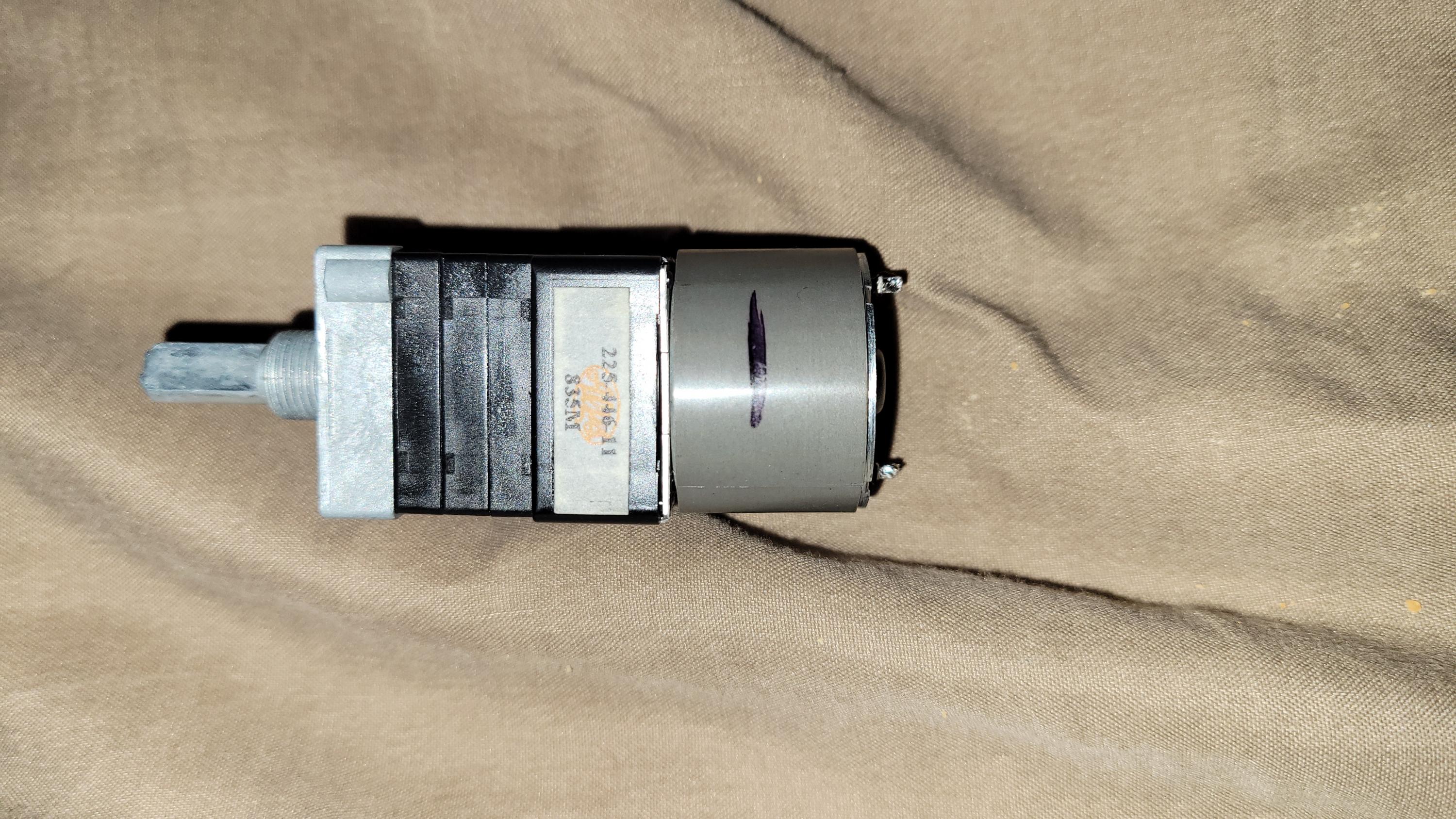

        https://aliexpress.ru/item/100500171...00017326156038
        225-446-11 RES, VAR, CARBON 100KX6

          How do I see how many ohms this is? Which pins would show me the max impedance on the one I have?

                Does anyone know the pot impedance? Or how to measure it with my meter? I'm guessing just turn it all the way down and measure

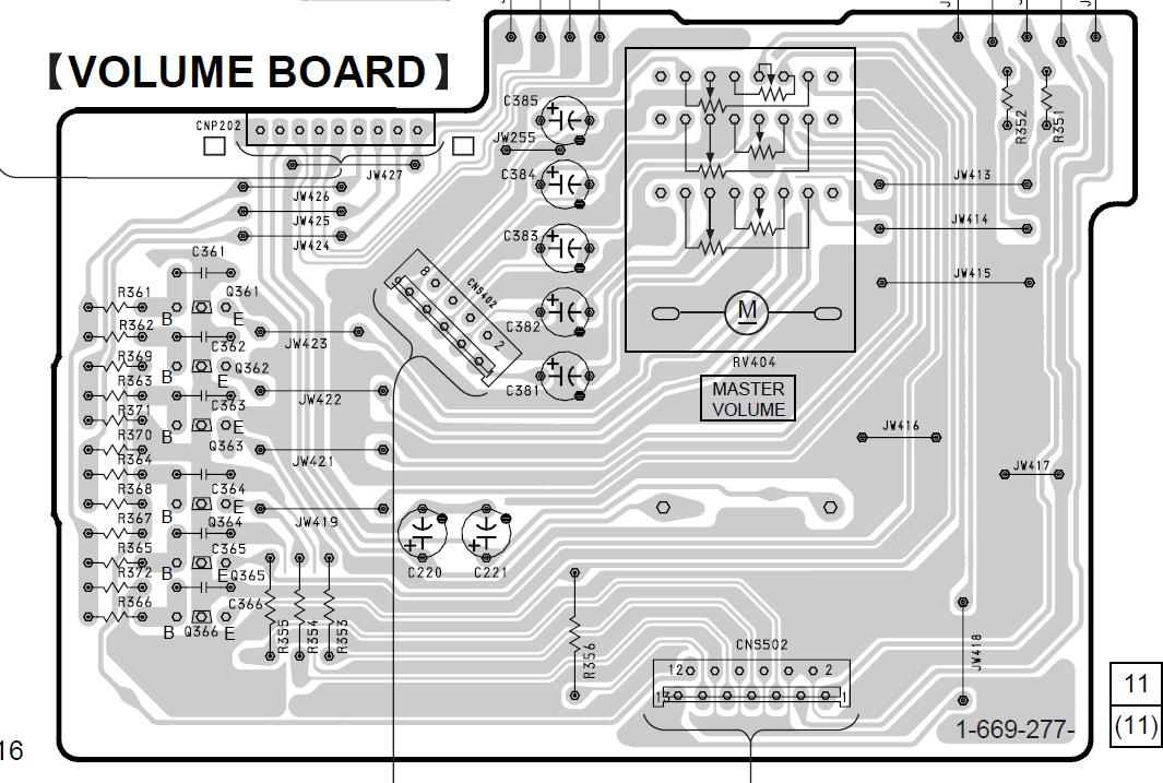

                I found the schematics but the site is low resolution because it costs to sign up

                  If you use the correct model number you will find your service manual, free.
                  The RESITANCE of the control is 100K X6, The motor is not a stepper motor it is just a dc motor

                      I use Google, The model number is STR-DE425, Enter this into google ... STR-DE425 service manual, the first return line is this: https://www.manualslib.com/manual/90...Str-De425.html

                        I got that too but once you go through a number of pages it bumps the resolution down if you don't pay

                          No it does'nt, you download the pdf, what site did you go to?
                          Here, this is what I downloaded from the link I posted
                          Or download it here
