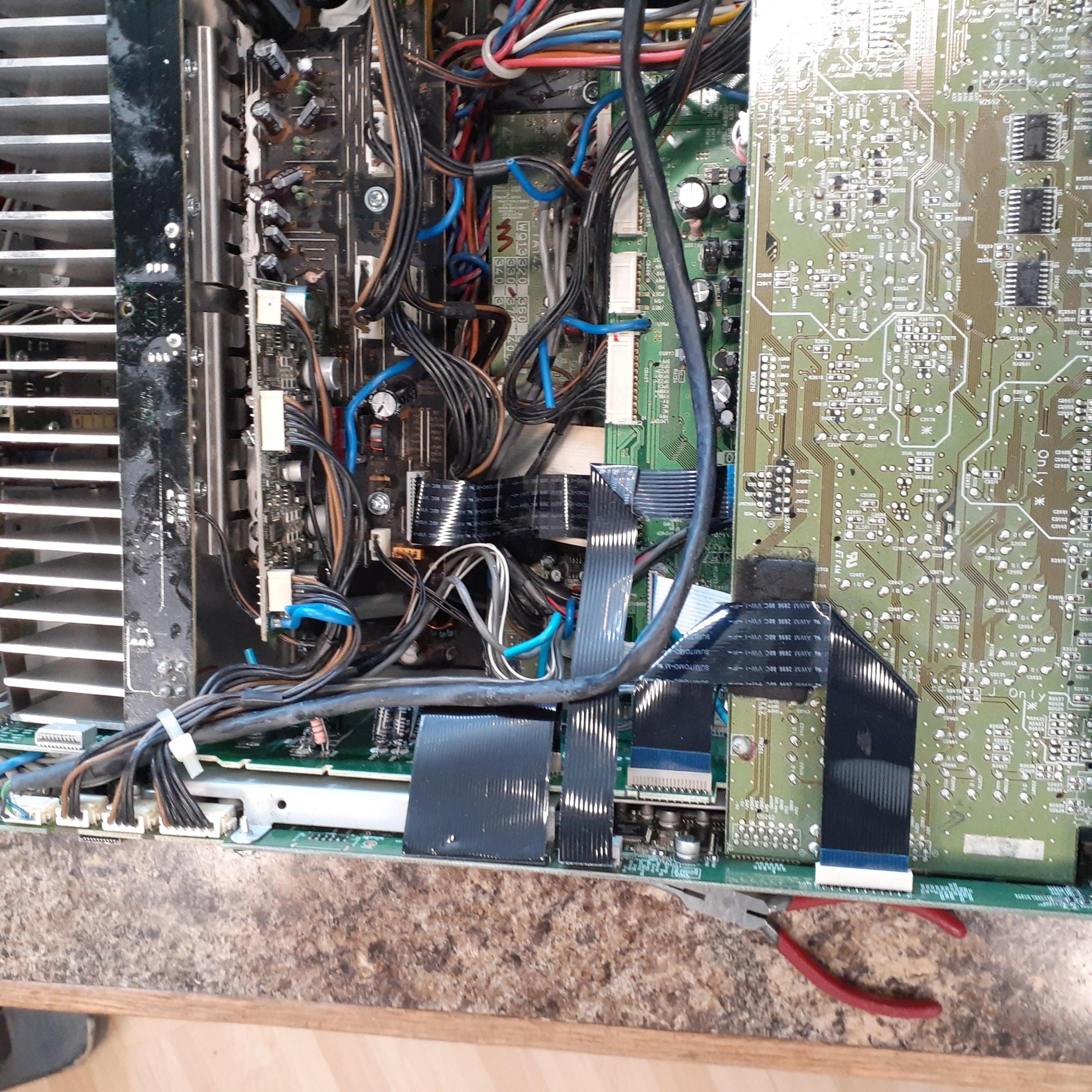

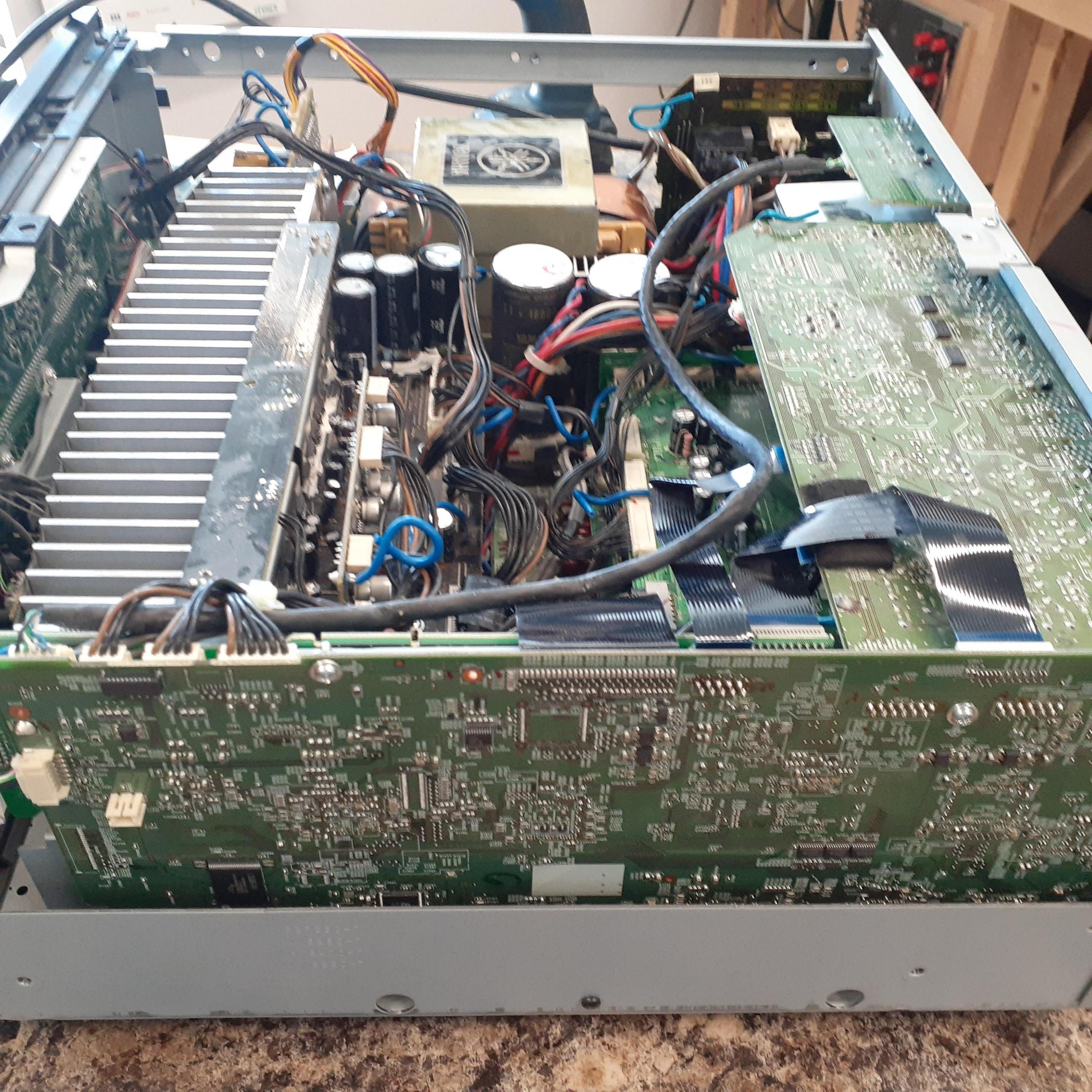

    Hi guys, I have this Yamaha for repair, the problem is when I push Power ON,, the amplifier goes Off in 1 second, I try Hard reset, same problem, I change all the capacitors on the Ic regulator circuit and same problem, I check all the audio output transistors all are good, I check voltage on Regulators board and I have a little low voltages on circuits like on 12 volts I have 11.6 volts, on -12 volts I have -11.4 volts , on 5 volts I have 4.81 volts, could someone tell me what I have to check now?

                    If it's going into protect due to over voltage or over current then you have to remove that condition first. The way to do that is to unplug one of the cables going from the hdmi board to the main board.
                    You'll have to have a look further or post some pictures as I have no idea about the receiver in question here.

                      I try disconnect all connectors on HDMI board always same problem, see the photos

                          You can't disconnect ALL connectors. Try them one at a time or find the service manual for less guess work.

                            Did you check the output voltages on the DCCNVT pcb?
                            I had an issue with the board, Channel 2 4.3v Dc. Rail was < 0.4VDC.
                            This was triggering the protect mode.
                            Note: During this fault you could not enter diagnostics mode, but could activate PSU’s to test voltages using the diag mode.
                            Replaced the DCCNVT board, problem resolved.
