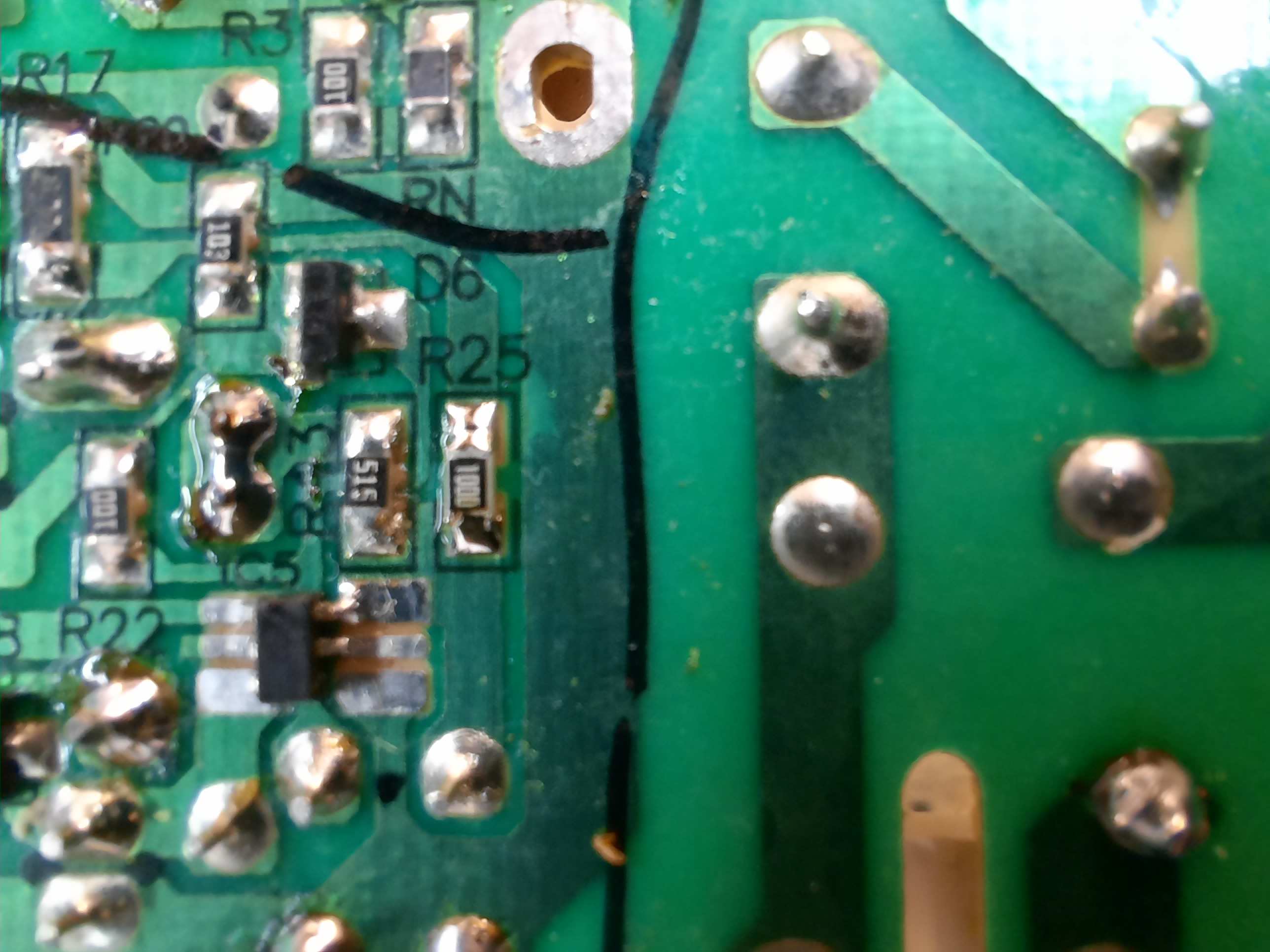

    No power , with F1 ( F5A ) O/C
    There's a S/C reading from 8V rail to GND .
    R14 & R17 ( see picture ) are cooked . Need to identify them so that i can continue with repair .
    Connected in parallel , therefore most probably same value , which i suspect is going to be low .
    No info coming up on a Google search.
    Power board number PCB 160926G1

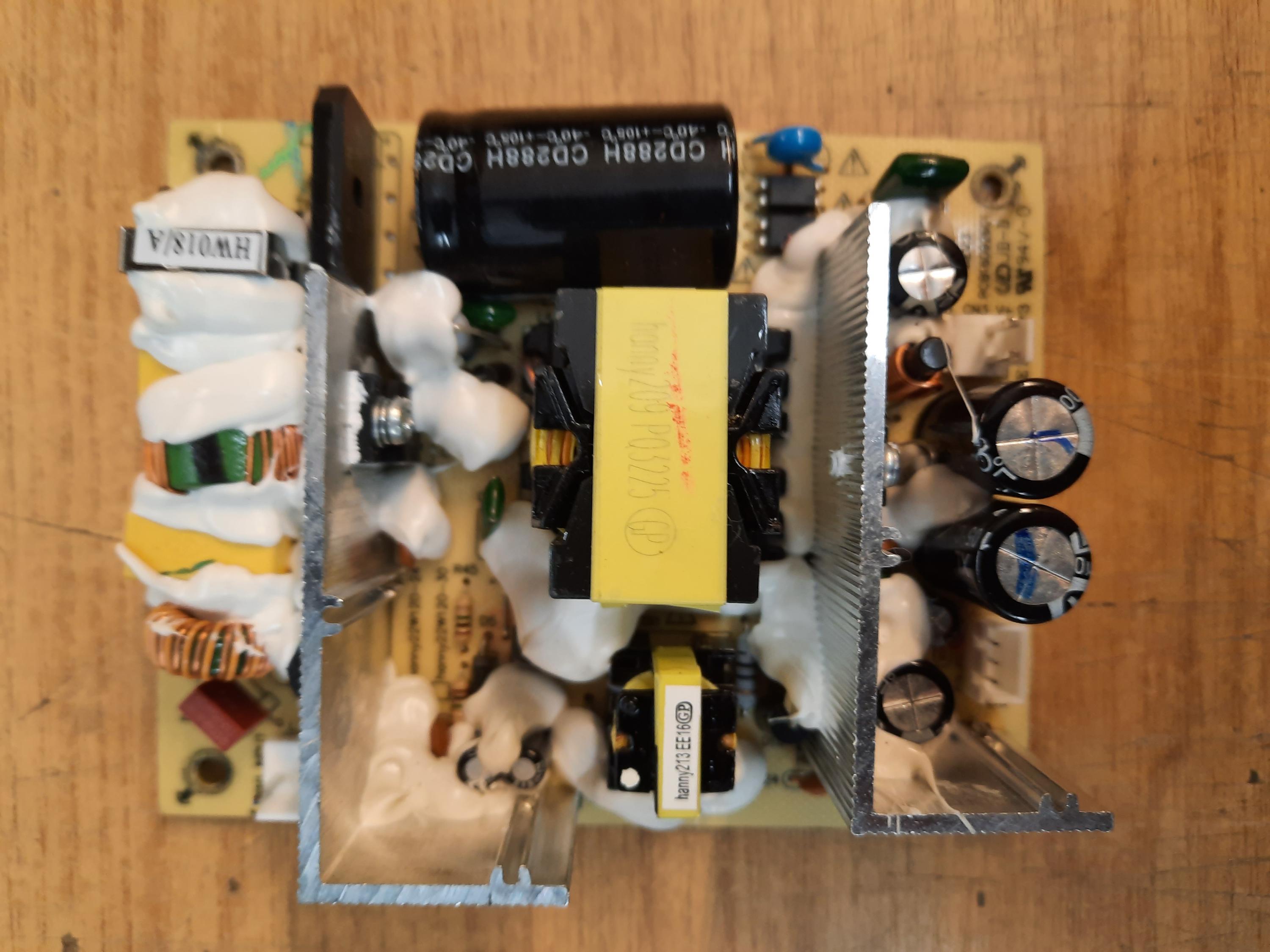

    Re: Kanto YU6 active speaker power board schematic please
    Top view of power board
        Thanks very much & i see what you mean regarding blurry picture .
        I make them both out to be 2R2 .
        Would be most grateful if anyone could confirm this .
          That is what they look like (2R2) they seem to be the source resistors for the mosfet, if this is what they are, R25 connects the mosfet source to the CS pin of the ic5 and many times when the source resistors open, full supply voltage is applied to the CS pin, which usually has a max of around 2 volts.
          So replacing the mosfet and resistors may not repair it. and the ic5 needs to be replaced as well.
          What are the numbers on IC5?

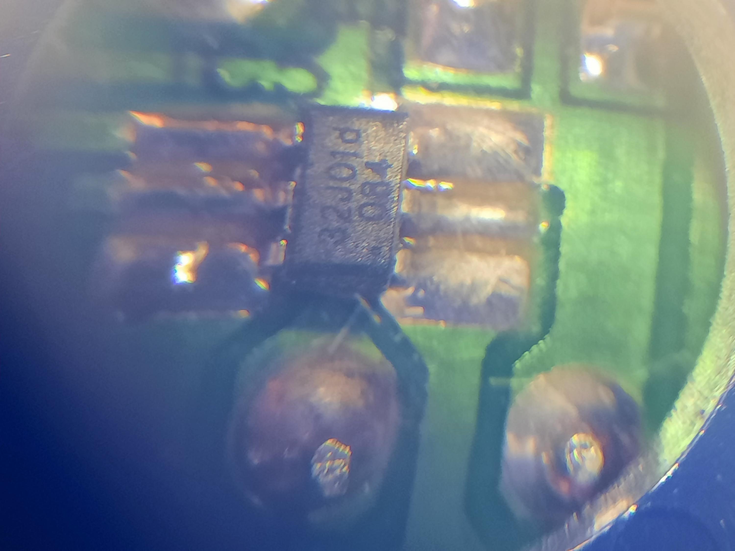

              Here you go RJ
              Any idea of type & where i could source one from ?

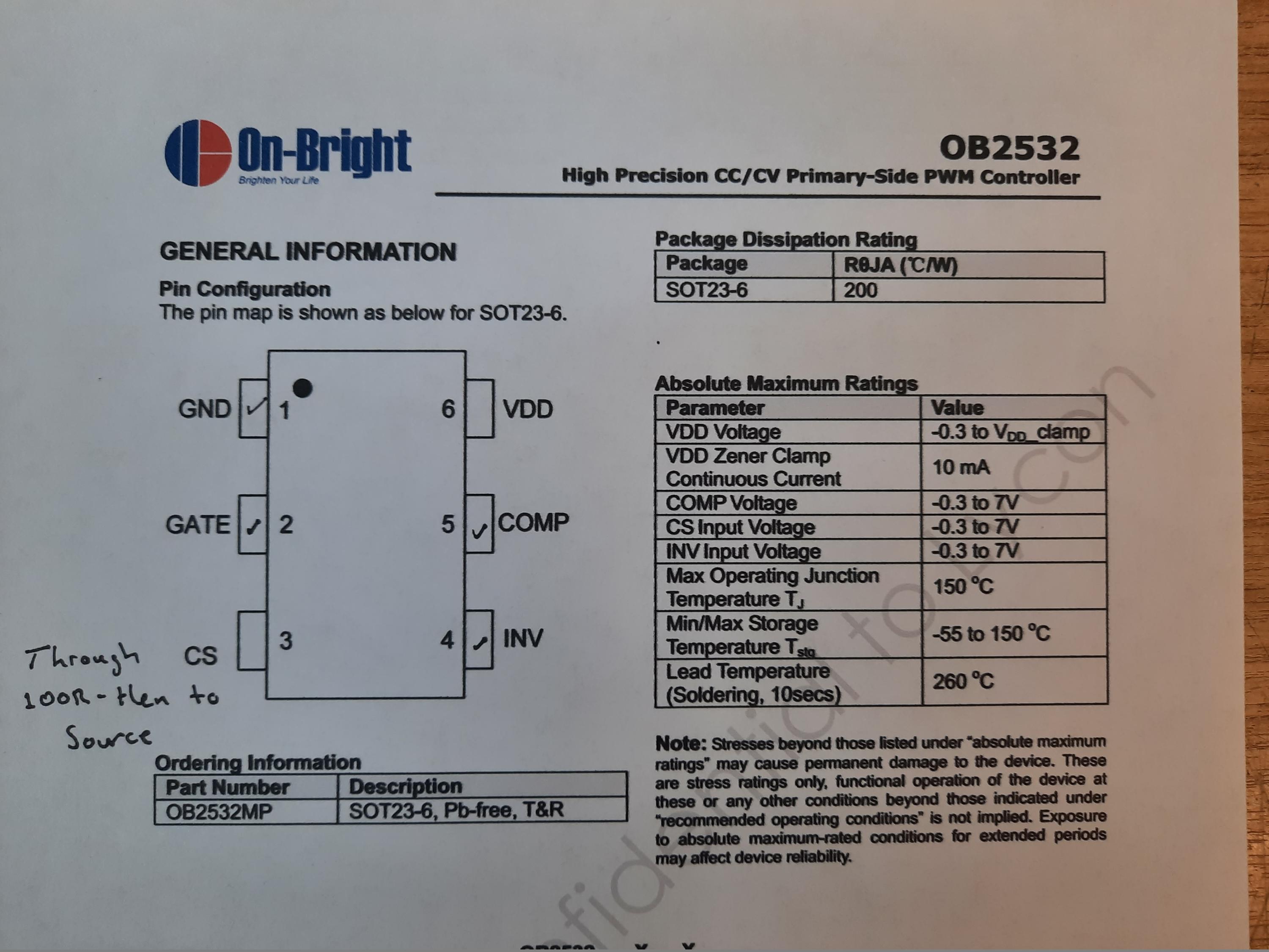

                  Probably not worth continuing till i can identify & source IC5 ( 32J01d )
                  Pins 5 & 6 measuring S/C
                  I believe it's package type is SOT23-6
                  Can anyone help ?
                    It might be the On-Bright OB2532, Check the datasheet to see if the pinout matches
                        Thanks so much for your help RJ
                        Followed pads on PCB from device & they do seem to correspond with datasheet .

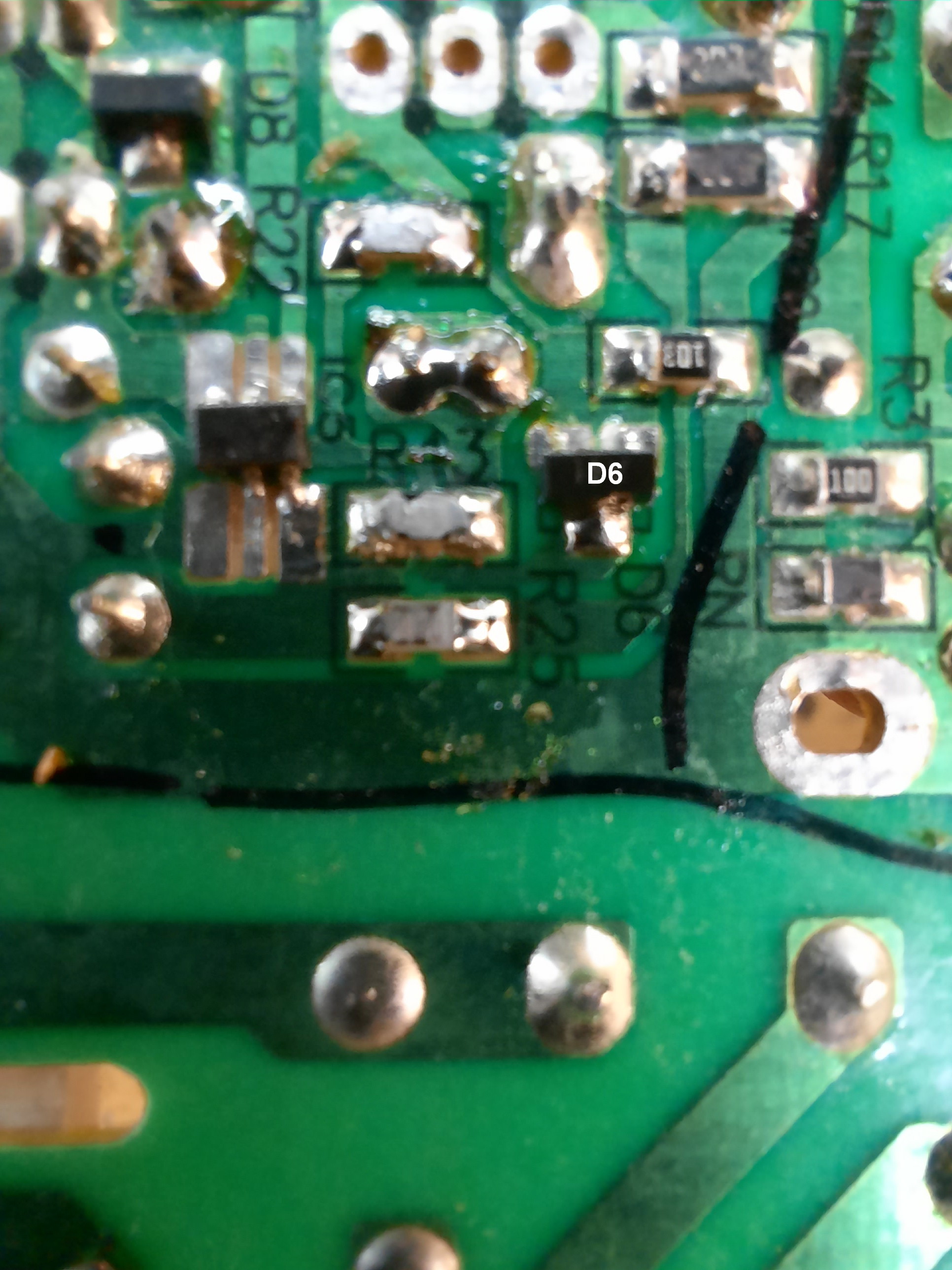

                              D6 , MARKED A4t , measuring leaky .
                              Replaced with a more powerful SMAJ5.0

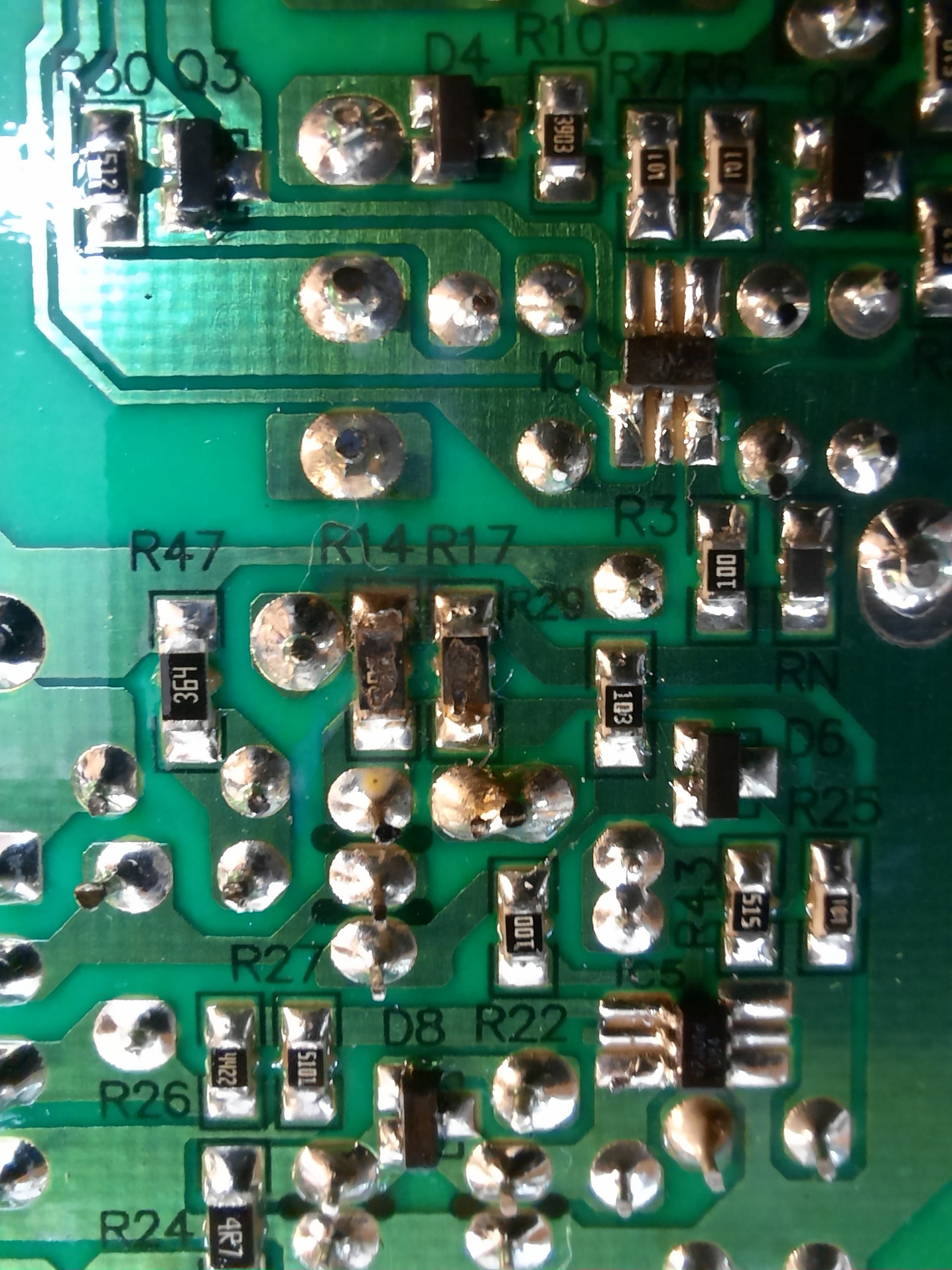

                                Yet another sticking point .
                                I'm back to values of R14 & R17 .
                                Removed & cleaned them & fairly certain that they are not , as i had previously suspected 2R2 .
                                If you look at picture , The first number does look like a 2 .
                                The third has a flat top and is potentially a 3
                                It's all on the second number . Can't make out if it's an R , or 0 .
                                Could really do with some clarity on this one .
                                  Regards R14 & R17 , went with my initial thoughts of using 2R2
                                  Happy to report that all the effort seems to have paid off .
                                  Speaker now working & on test .
                                    Good to here it is working. It may be that the values are 2R7
                                    Check if the mosfet is running warm and not too hot. Usually small smd resistors like this and used in the source of a mosfet are under a few ohms in value so it is likely an `R' not a `0' The R represents a decimal
                                    2R3 is not a standard value but 2R7 is
