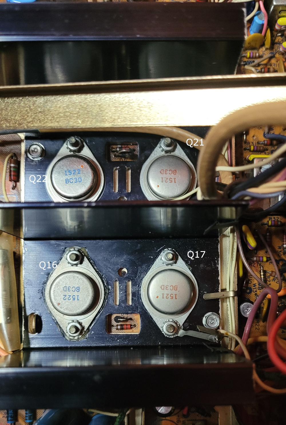

    Okay, so the issue is that the part numbers on the transistors don't come up with anything on google. Thats why I was using the parts list to describe them. Here are the part numbers AS INSTALLED. Also, I attached pictures, forgive the messy board, it will get cleaned up once I figure out what's up.
    Q16: 1522 BC3D
    Q17: 1512 BC3D
    Q21: 1512 BC3D
    Q22: 1522 BC3D

      Q21 must be PNP. If C is 0V, B is 5V and E is .31V this looks like saturation and is a problem. This does not make sense as the transistor should be cutoff, seems it either has an E-C short or you have an NPN transistor installed here.
      Well well well, so in diode test on Q21
      C > B .116 forward
      E > B .116 forward
      E > C DEAD SHORT
      I only tested them using C to B E to B and I did the same test but with the meter leads reversed. I don't recall testing E to C...
      Going to pull working PNP from the other side and run the extra test.
      Q17, shows the following:
      C > B .113 forward
      E > B .115 forward
      E > C starts out as 0.117V forward then slowly keeps creeping up. It was up to 0.200 after about 10 seconds, then it starts to climb quicker.

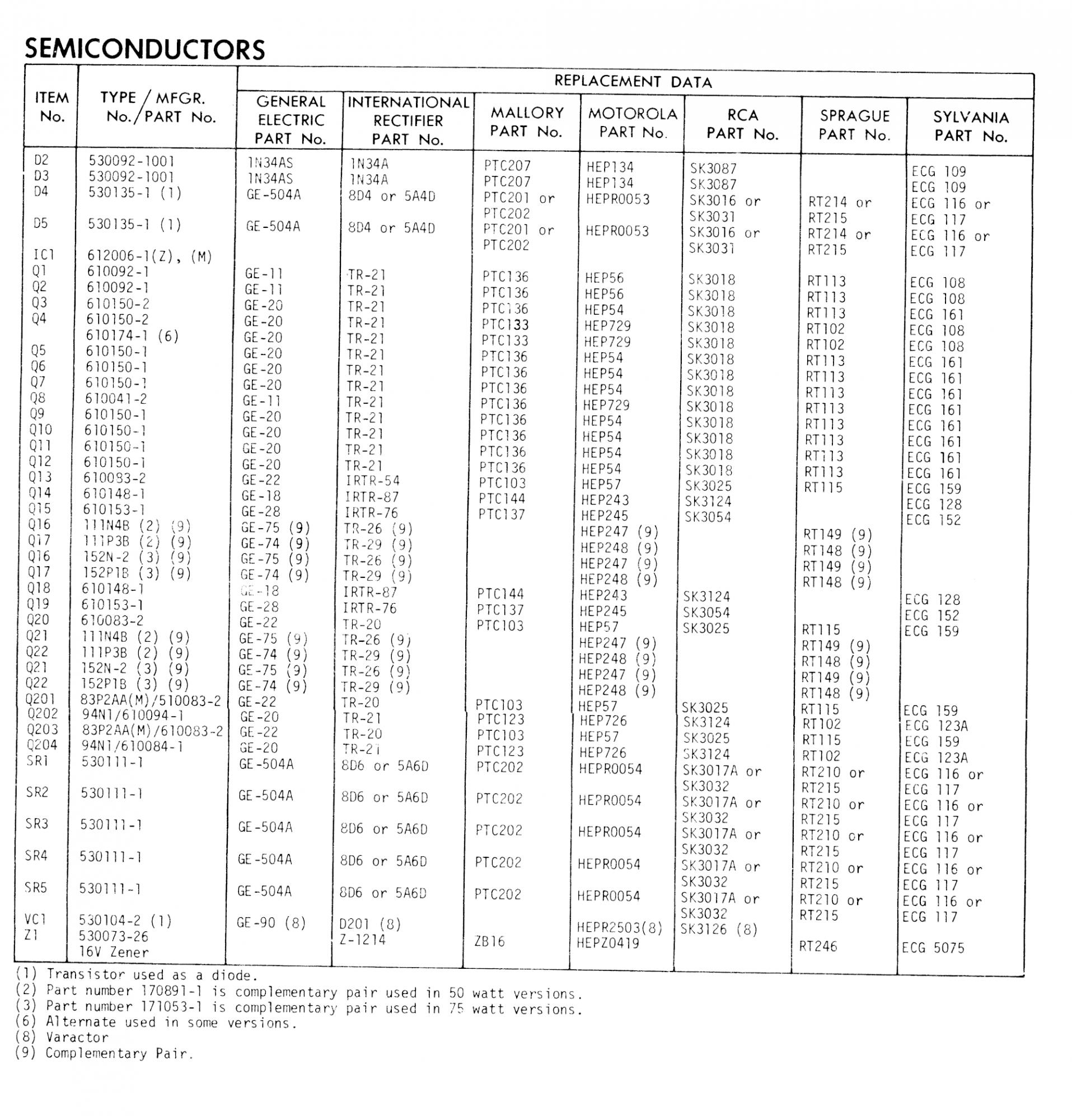

            I attached that section of the parts list.
            So we may have found the big issue with this amp? What do you think?
            If so, time to order parts and open a can of worms...
            1) What capacitors does everyone like for the PSU and Audio sections? So far I came up with using Nichicon UHE in the PSU and maybe Nichicon UKZ in the audio? This is based off what is in stock at Digikey.
            2) I saw someplace that its hard to get the replacement output transistors to bias right? Im a noob at this. Is that true? Can I buy the NTE's off digikey and have this thing work right? Or should I look for old stock name brand off Ebay?
            3) The replacement resistors for R107, R101. The factory ones are.47ohm, Non-Inductive, ceramic blocks. I had a few from Amazon I used for testing, but I wish to replace them with something better, but now I noticed it seems to be a odd part? Should I just roll with the off brand ones for now?

                D5 tests at .542v
                I agree, I am looking for a simple repair at this point. Per the parts list, are the outputs silicon or germanium? The other smaller transistors are in the modern looking packages.

                  parts list appears to be silicon though there are some things I'm not familiar with which may be related to germanium so that they could be swapped in when cheap.

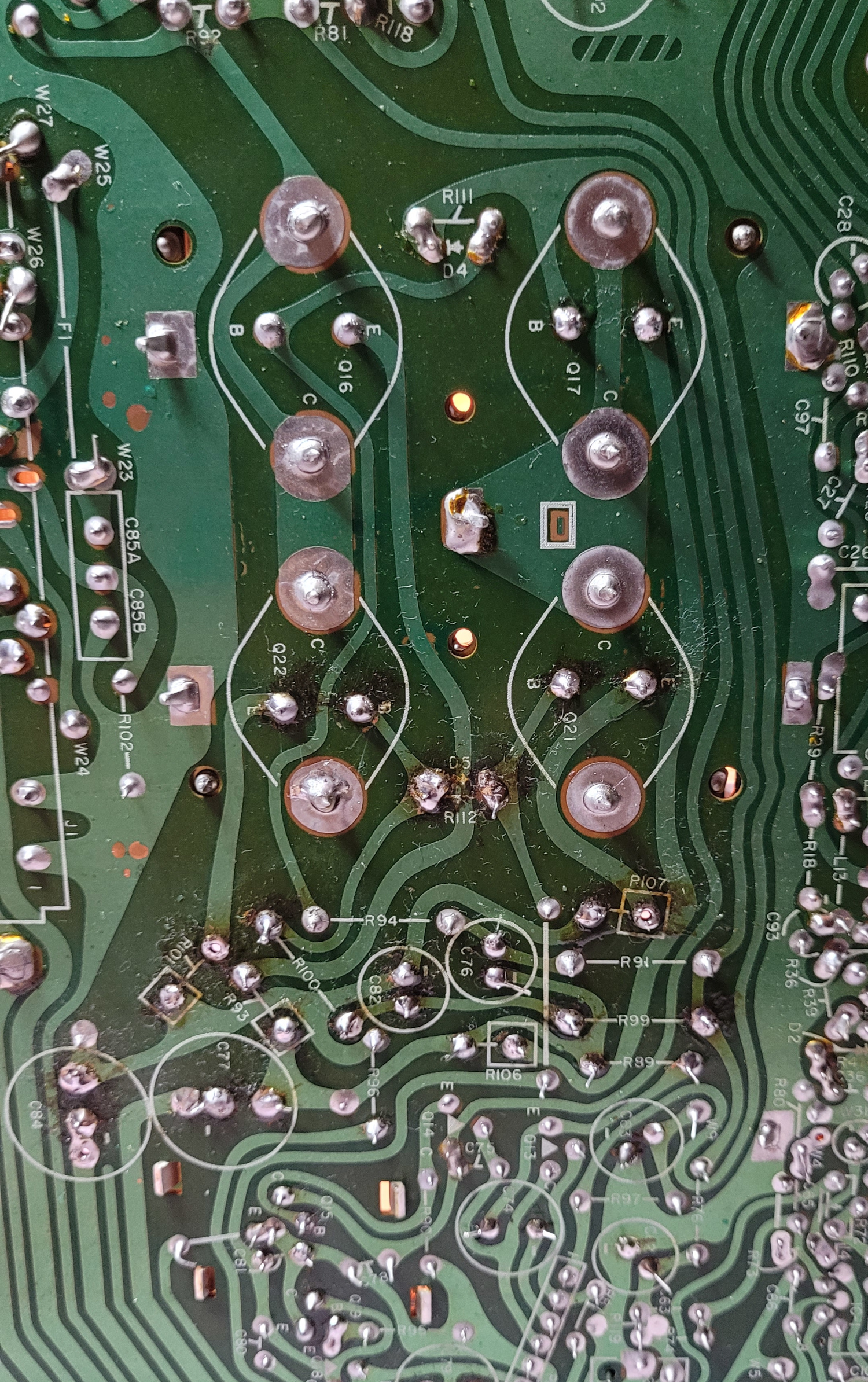

                  BTW chances are you should remove R111 / R112 for the respective channel if you're replacing with silicon output transistors (which you may well need to, finding NOS NPN Ge transistors is probably hard, personally pretty much all my Ge transistors are PNP, and I think I may have just one NPN Ge transistor and it's not a power transistor). You could replace the resistor with a pot to be the bias adjustment though I'm not sure what's the best value. Probably less than 500 ohms but it may be touchy to adjust. On the other hand, if you leave the resistor in, you'll likely get distortion on the output -- and that, even as a non audiophile, I likely can hear as it would introduce odd harmonics. But TBH I've never had an amp with Germanium power output transistors, all the ones I've run across were already Si.

                    Well, I have a large selection of resistors. I also have a scope. If I leave the left channel with Ge transistors, could I use that channel as a reference to help tune the silicon replacements on the right channel? or will it never sound right unless I switch both to silicon and fiddle around?

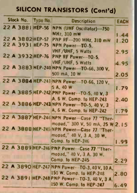

                                    My parts list has alternatives for the outputs. One option it lists is a pair of HEP-247 and HEP-248. Check out this old page I found on google.

                                      Well HEP-247 and HEP-248, like others on that page, are all silicon...
                                      It is kind of weird, seems hole mobility is bad in Si (hence HEP248 and likely MJ2955 are more expensive than HEP247/2N3055) but the issue is not as bad as other issues in Ge.
                                      interesting, 2n3055 is more expensive than mj2955 on mouser... might be demand inflation.
