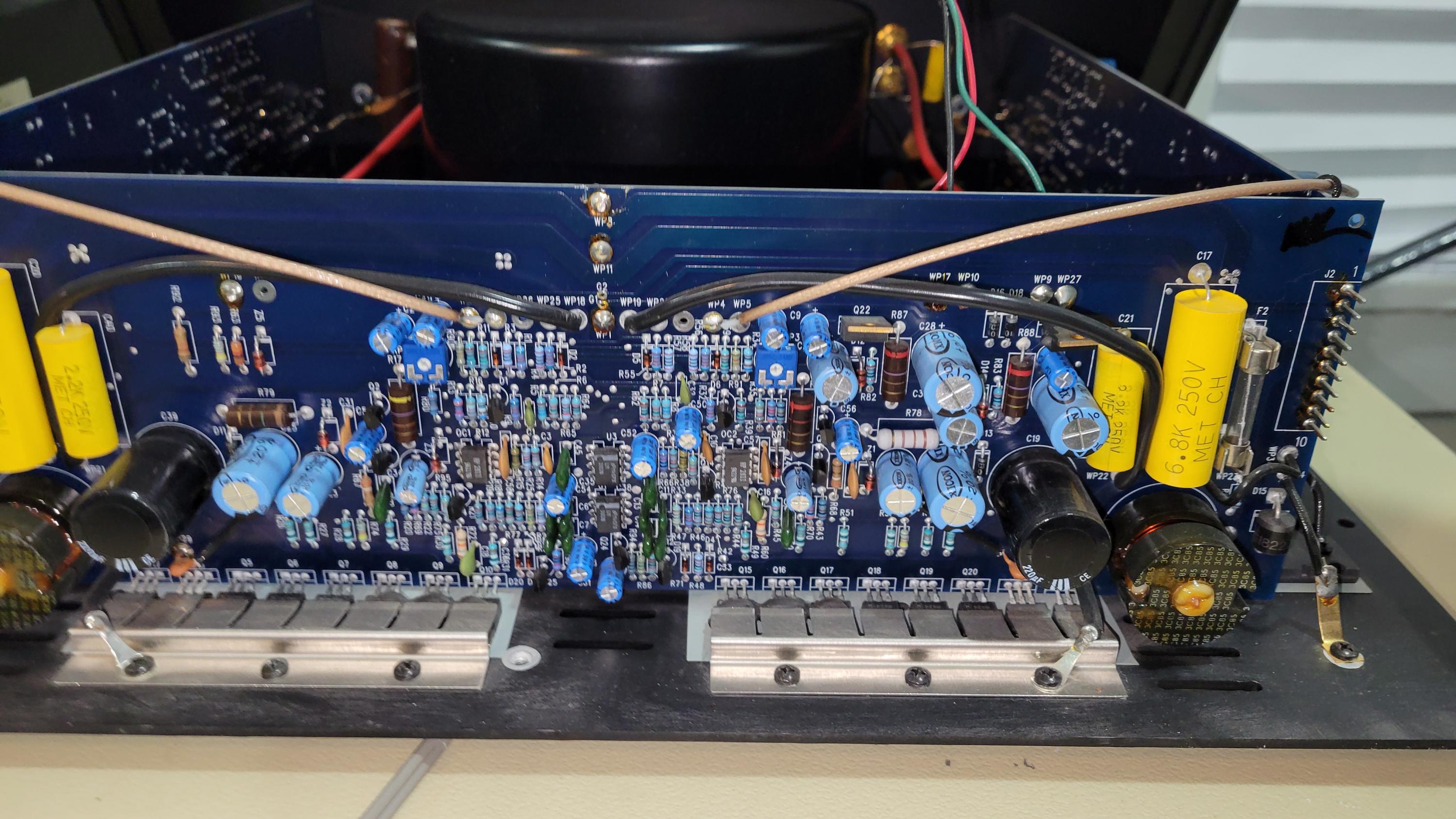

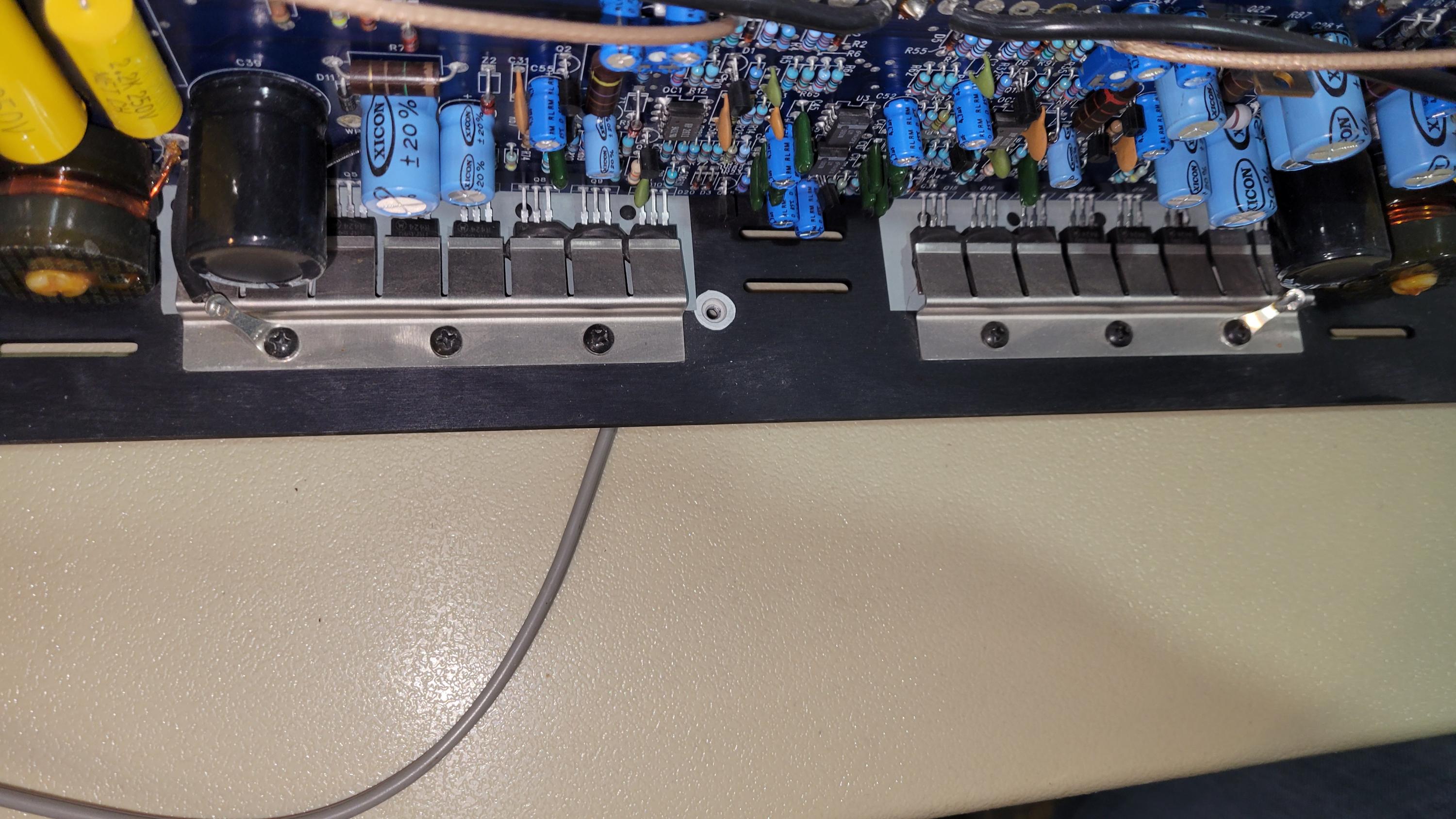

Think I would need to recap this Sunfire bi-wired amp ?
  • Uranium-235
    Comrade Glimmer
    • Aug 2007
    • 5042
    • US

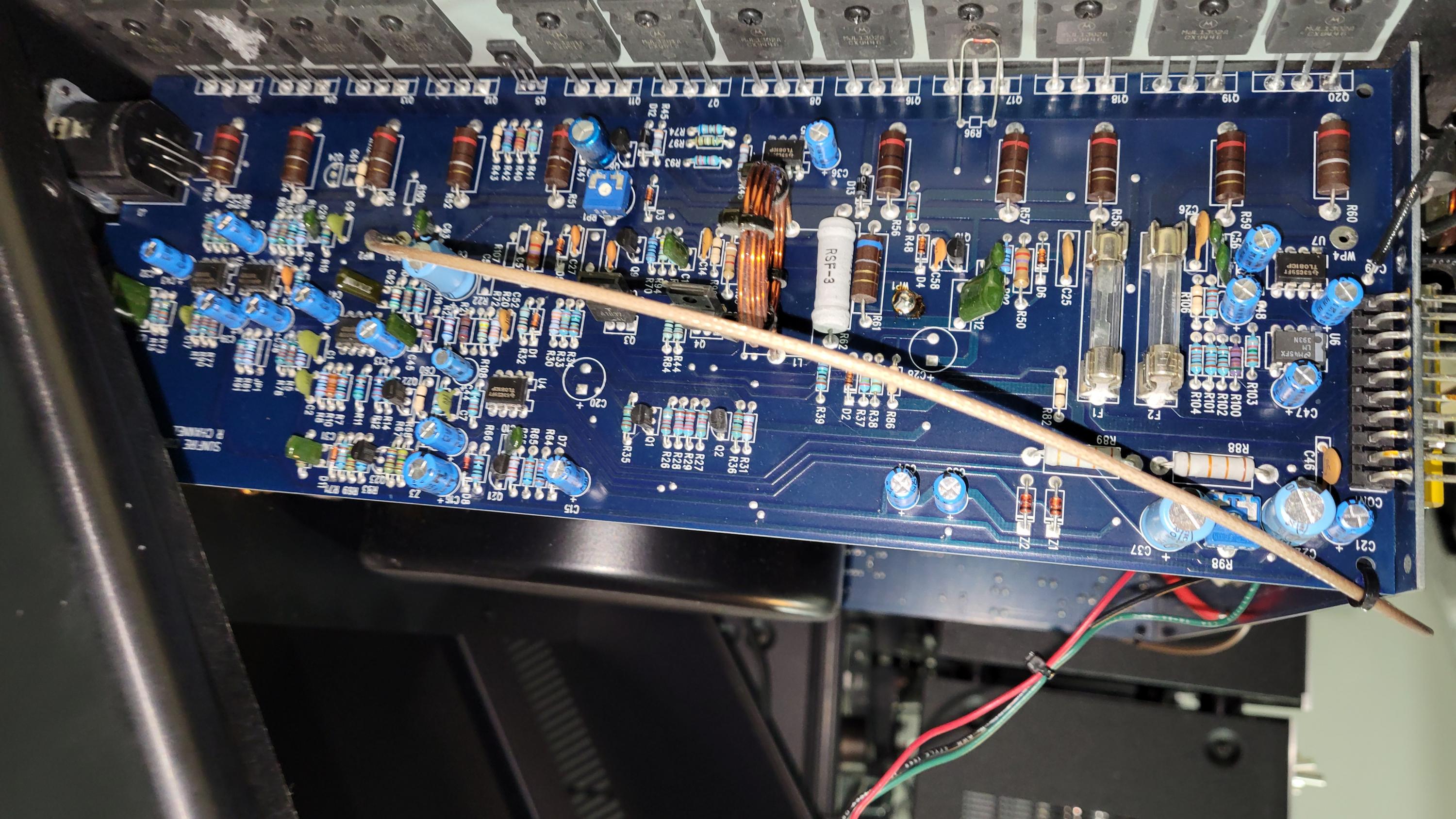

    Sunfire bi-wired amp. Not sure if it's the 300w version or 600w version
    stored in a cool place. Not turned on for like, 30 years

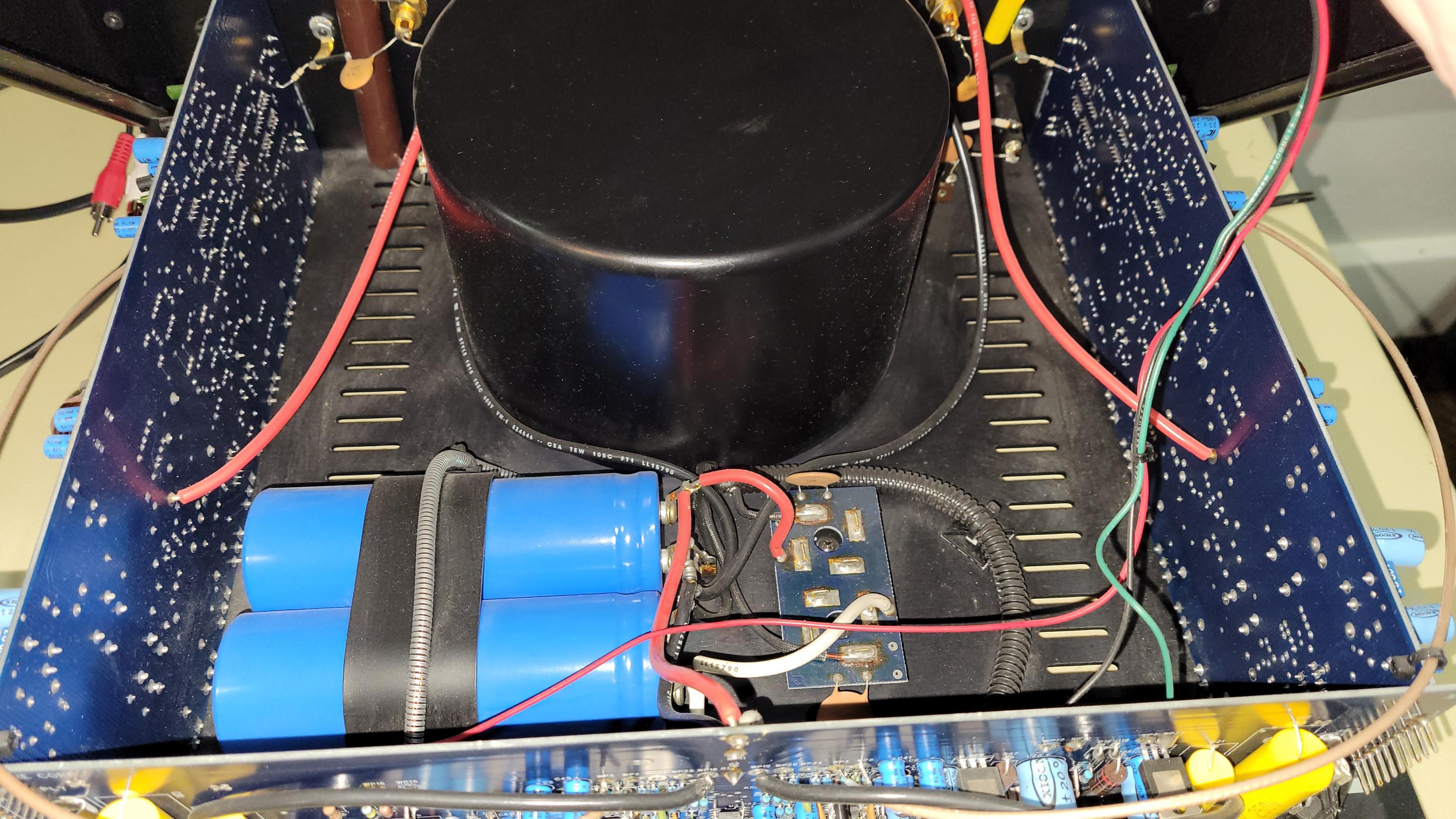

    I'm worried about the big two after the rectifier. But if anything else catches your eye please speak up
    dried out, obviously not bloated

    you could charge the caps with some AA batteries just to reduce the chances of them being de-polarised
    or even better if you have a bench supply with a computer interface.

      Re: Think I would need to recap this Sunfire bi-wired amp ?
      i'd reform these big caps with a bench power supply and put them back in service.

        I have no bench PSU.
        Are these just likely high ripple power caps?
          Then just do what stj said with the battery trick. Better than nothing. Or using a variable transformer and bring the voltage up slowly.
            Dim bulb it.
            Make sure no the speaker outputs are unloaded, since some amps "slam" to one rail under extended/severe undervoltage, such as when dim-bulbing.
            A Variac by itself doesn't current limit.
            Oh, make sure it's an incandescent bulb, LED or CFL won't work!
              Originally posted by kaboom
              Dim bulb it.
              Concur x2.
              A standard 40W incandescent bulb on 120V AC will present at about 360 Ohms impedance to the input caps (at full short-circuit)... which should work quite nicely to reform them without you having to take them out of the amp and doing so manually.
              Dim bulb wiring (I'm sure mostly everyone here knows how... but just in case):
              https://www.badcaps.net/forum/showpo...4&postcount=70
              And yeah... no loading or testing the amp with speakers on the dim bulb. Just let it sit connected and powered up for 20-30 minutes. Maybe more, if you like (1 hour should be more than enough.) If all looks normal, you can power the amp after that directly from the wall... and if that goes OK, plug in speakers too. Or if you want to take it extra safe, just in case: use 100-300 Watt halogen (long bulb) or 100-500W heating element in place of the incandescent bulb. This will still limit power going to the amp, but should allow enough to test the amp with speakers at lower volume.
                I blew up a Peavy power amp on a dim bulb tester, it was playing quietly and turning it up a little bit, the amp latched up bulb full lit and it killed some transistors. The power supply can collapse and do damage.
                I find a dim bulb or light bulb tester is not great for reforming, you need reduced voltage and at light load the bulb goes out and voltage is high on the caps so what was the point.
                This amp, looks like better quality parts. I would use a variac at 50-75% voltage.

                  You sound like someone who knows a lot of the inside of these types of amps
                  if I wanted to replace those two main caps, where would I find them. I don't know the voltage or uf. I'm guessing the ripple is incredibly high, coming right off (or into?) those bridges.
                  I'm much more familiar with switching PSU's, i've seen others like these before. That bigass heavy (round) transformer. It's linear I bet. Never dealt with them.
                    If your amp blew on the dim bulb, it might have already had issues to begin with.
                    Yes, transistors can still get killed even with the series incandescent bulb, particularly if the amp has large bulk caps that store a lot of energy. But this can also happen with a variac as well, so it's a moot point. The only difference is that a series bulb limits how much current can go in the amp, so at least you won't blow fuses or rectifiers in the process... so damage is generally limited to only the energy stored in the bulk caps.
                    That said, I've never had an amp with a linear (line transformer) misbehave on a series incandescent bulb. Cranked a few until the bulb was partly lit and no problems... though they had +/- rails derived from the main HV rail, so even with a low line input, the +/- rails for the pre-amp stage still had the correct voltages.
                    Only thing to watch out for is if the bulb is dropping too much voltage (too small a bulb usually - can happen on amps with really large transformers that generally eat 8-15 Watts by themselves) and possibly causing issues with the biasing on the output stage or offset/DC voltage in the pre-amp supplies. So for smaller amps, 40W bulb is usually OK. But for the bigger stuff, you might have to go to 60W or 100W.
                    The point is current limiting. When caps reform, they can draw excess current as the oxide layer literally reforms... and this excess current draw by the caps can possibly damage other components in front of them in the circuit or the caps can damage themselves - especially large caps that have been sitting with the power off for a long time. A variac will not limit the current, and that's the main reason why it's not recommended for reforming caps. Sure, if the voltage is low enough from the variac, the current drawn by the caps could be small. But you may happen to hit a voltage point to where the caps haven't been reformed yet or they're just too old and just won't reform to that voltage. In such case, they can still draw excess current and damage something else.
                    That said, you could also run a combo of variac + series dim bulb. That would actually give the best of both worlds: controlled slow voltage rise and limited current. Of course, care still needs to be taken to make sure any secondary +/- voltage rails for the pre-amp stage aren't offset too much from each other, or that can cause an offset DC on the outputs as well. So that also really depends on the design of the amp.
                    Probably Digikey or other similar parts places. They're just going to be really expensive... but that should be expected given their size.
                    They're pretty standard caps, actually, since they are filtering 50/60 Hz line current (well, 100-120 Hz technically, since the rectifier doubles the frequency.) So no need for anything special here. They're just going to be very large... and with that, of course, also comes high ripple current handling. Typical cap values for an amp like that might be something like 80-100V for the voltage rating and 10000 uF (10 mF!) or higher capacitance.
                      the dim bulb tester has its place, but here in this case I wouldn't. That's only my opinion...
