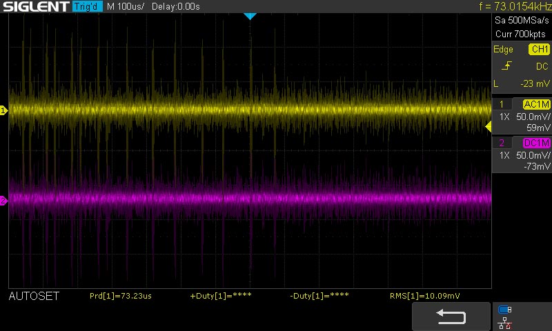

    Hi All,
    I have an old Denon DR-M10HX cassette deck and want to service it.
    I have aquired some test tapes and I have a scope. When I connect the scope to the L&R line level outputs I see a great deal of high frequency noise. Equally when I play a 3.5KHz test tape it's hard to see the test frequency through the noise.
    Any advise would be welcome.

    A dirty, oxidized Record-Play switch is a very common problem with cassette decks.
    Spray some DeOxit or other PPE cleaner into the switch and move it back and forth a hundred times. Don't get spray on the belts! Check the other switches and potentiometers are not dirty.
    Then, you bring out the scope if need be.

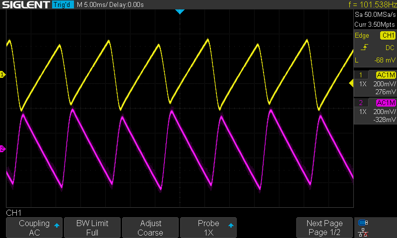

              The circuit board does not match the service manual. There is a discrete bridge rectifier followed by two 1000uF/25V caps. The image below is the trace acoss each of them:
              Using a Peak ESR70 meter they each measure (in circuit) ≈ 994uF & 0.12Ω

              • R_J
                • Jun 2012
                • 9634
                Re: Denon DR-M10HX Cassette Deck Servicing Help
                That service manual is for the DR-M10, not the DR-10MX, The wave form across the caps is the raw dc, it should then go into positive and negative regulator circuits. This is the place to check if the regulator and filter circuits are working.

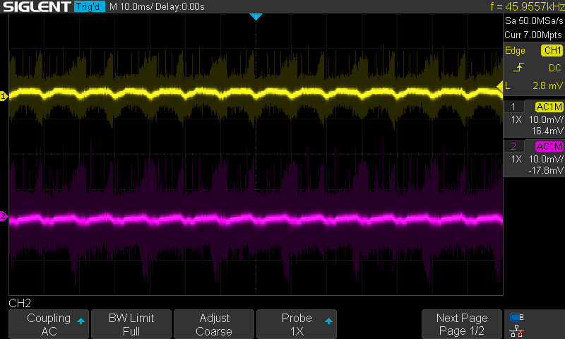

                  There are two TO220 transistors close to the bridge rectifier and smoothing caps. One is a D985 and the other is a B794. The trace below is from the emitter pins.

                  • R_J
                    • Jun 2012
                    • 9634
                    That noise is likely not from the power supply, but could be coming from the motor. I suspect the noise is there even if you hit play without any tape? if it is, use your finger to slow down the motor and see if the pitch of the noise changes, it could be coming from the motor.

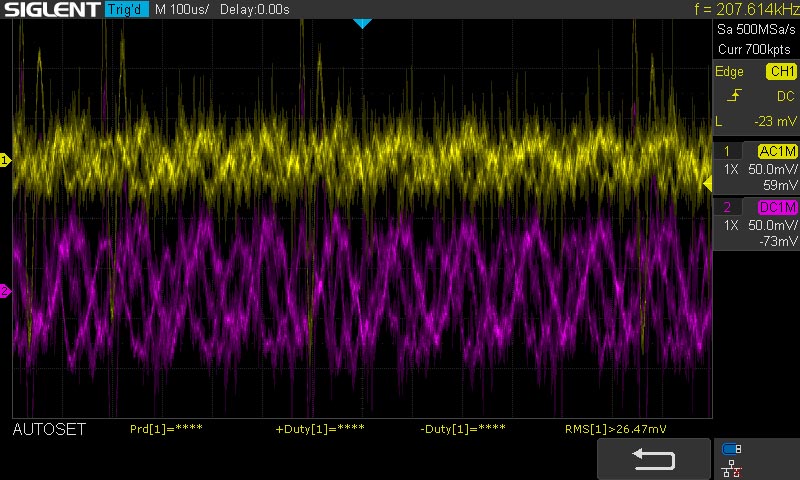

                    • Nevillet
                      • Sep 2019
                      • 272
                      • United Kingdom
                      Slowing the motor does not seem to alter the noise. Even if I unplug the power cables to deck motors the noise remains.
