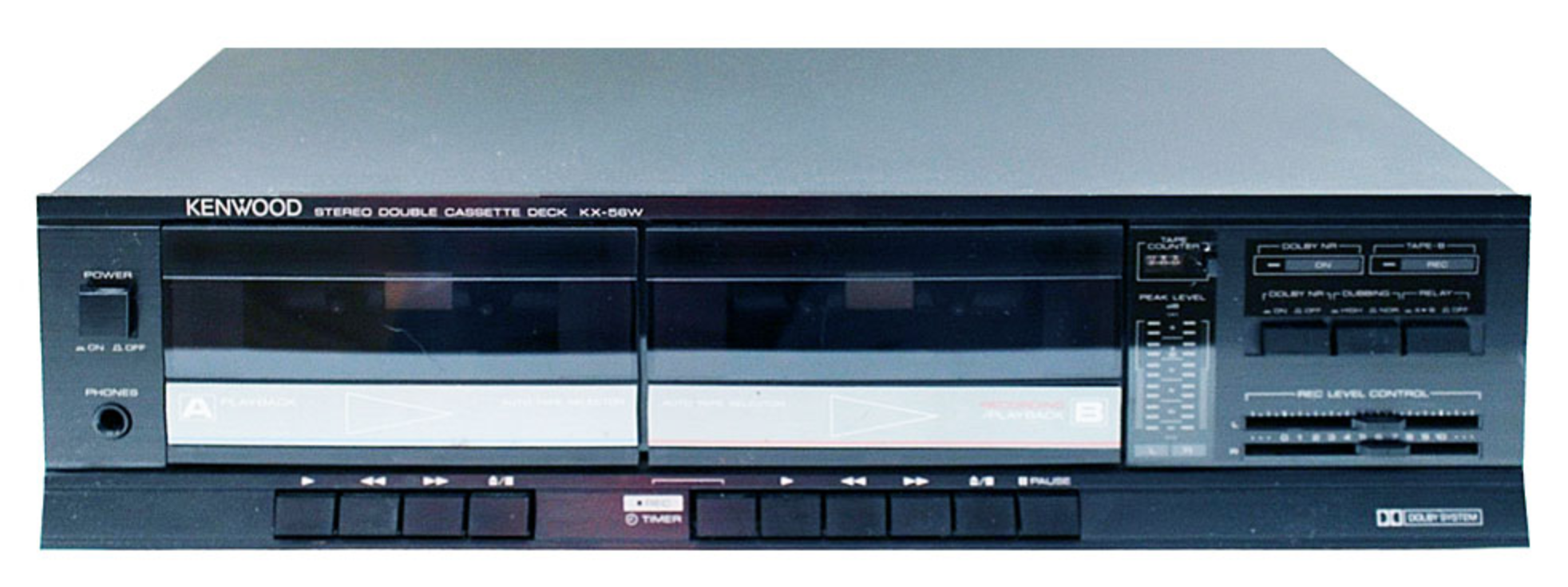

    Hello!
    I'm trying to fix my Kenwood KX-56CW dual cassette deck (seen in the picture below).

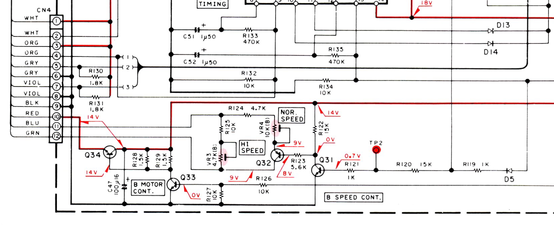

    Everything functions as it should except that the motor for tape deck B plays back extremely fast (tape deck A functions properly). I've located the two trim pots on the board that control the speed of deck B and they were only able to bring the speed down a little bit. I was able to find a schematic online (attached) with suggested voltages, so I measured the board while playing a tape in deck B (as per the instructions on the schematic). Some voltages were close and others were substantially different. Here's what I measured and a screenshot of the relevant portion of the schematic.
    Q31 (2SC1740S) C=70mV, B=20mV, E=0V
    Q32 (2SC1740S) C=8.3V, B=9V, E=11V
    Q33 (2SC1740S) C = 0V, B=14V, E=0V
    Q34 (2SD863) C=14V, B=14V, E=14V
    Based on these incorrect voltages, can you tell me where to start looking? Do I need to replace the transistors? Resistors? Something else?

        I think these voltages
        are just measured wrong, C&B reversed. Q31 base is too low and not being turned on. To test, you can short Q31 E-C it should play at normal speed. If It does, then check the base circuit to find out why it's not being tuned on

              I think these voltages are just measured wrong, C&B reversed. Q31 base is too low and not being turned on. To test, you can short Q31 E-C it should play at normal speed. If It does, then check the base circuit to find out why it's not being tuned on
              Thank you for your help! You're right, I mixed up the B & C on all of my measurements! Also, I just realized that Q32 is a different type of transistor. Here are the correct voltages/parts list:
              Q31 (2SC1740S) B=70mV, C=20mV, E=0V
              Q32 (2SA933S) B=8V, C=9V, E=11V
              Q33 (2SC1740S) B=0V, C=14V, E=0V
              Q34 (2SD863) B=14V, C=14V, E=14V
              I shorted E-C on Q31, but it didn't slow the motor down. Does this mean the transistor is bad?
              I shorter E-C on Q32 and it slowed the motor down, but it is still faster than it should be.
              Any other ideas?

                  Re: Kenwood KX-56CW Duel Cassette Deck Repair
                  With the correct voltages, Q31 has .7v on it's base so it is already tuned on so shorting it e~c will have no effect.
                  It could be that Q32 is bad as it should be turned on and have the same voltage on E & C. If it slows down but is still fast, adjust VR4 (you may also need to adjust VR3 to get the correct speed). Also check the value of R124, R125 VR3 and VR4 if any are open this will cause high speed.
                  The speed is controlled by the resistance across CN4 pins 11&12. in high speed, Q32 is open so the speed is controlled by R125 and VR3. In NORMAL speed Q32 shorts connecting R124 and VR4 across R125/VR3

                    When I measure the resistance of R124, VR3, and VR4 with the power on and the motor running, it measures correctly, but when I measure R125 it measures as "overload" which I'm assuming is an open circuit. This fell in line with what you thought could be the problem, so I removed R125 from the circuit. Since R125 was measuring as open I turned the circuit on again and expected it to run as it was before, but the motor was running even faster than before. So I measured R125 while it was out of the circuit and it measured correctly. I then re-soldered R125 into the circuit and measured it again (still measured open). This time I noticed that when I measured R125 the motor slowed down substantially. R125 is still measuring as open, but while my probes are touching both leads on R125 the motor slows down to almost the correct speed.
                    Any ideas on why R125 measures open in the circuit, but correctly out of the circuit?
                    Any ideas on why the motor slows down when I measure R125?
                    I think I need to buy some transistors, will any general purpose PNP resistor do? Or do I need to buy the same exact 2SA933S transistor for Q32? If a variety of PNP transistors will work, which one(s) do you recommend?

                      So, I replaced Q32 with an exact replacement (2SA933S) and nothing changed.
                      Since R125 was acting funny I shorted it out and now I can tune the motor to the correct speed, but the sound has a warble to it. Is this because of the shorting or should I investigate the belts? Is it dangerous to short out this resistor?
                      Without the short the motor spins so fast that it's hard to tell if there's a warble. Also, the cassettes play fine (correct speed and no warble in cassette deck A, so I know the issue isn't the cassette itself).

                              If you short R125 that places the pot itself across the motors speed control, This pot, depending on the adjustment position could be near zero ohms or near 4.7kΩ or somewhere in between. I suspect the motor's internal speed control circuit might be bad. This could also explain the warble sound
