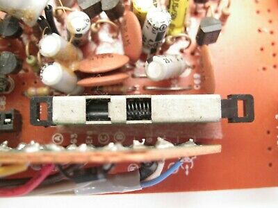

    When I press play, the VU meters max out, with or without cassette loaded. The play head or pickup looks like it could have some gunk on it but not sure. I took some isopropyl to it and the meters are still maxed out. Can't seem to locate a service manual. Any thoughts?

    do the meters go maximum if you place it in record mode? it might be a dirty record/playback switch.

      Yes, a dirty record-play switch can make the circuit oscillate. Common in cassette decks.
      Best to take it apart and put contact cleaner like DeOxit D5 in the really long switch (but not on the belts!). A trick in the shop was to take a small screwdriver and exercise the switch lever (inside the unit) 50 times or so, back and forth, to scrape off heavy oxide buildup.
      Another method, without taking it apart, is pushing the no-record tab sensor up (using a junk cassette, or your finger or scotch tape), while pressing the record button a zillion times to exercise it. Not too rough.

          The record-play switch is on the circuit board, not the front panel. It is a long multi-section switch with a spring or wire linking it mechanically to move when you press the record button on the front panel. Note the REC button won't move, it has a lockput, unless the tab is pushed up. With the door open, a pinky pushing up on the rec tab sensor, then I can push the REC button down.
          Don't be too rough, just find a way to press and release the record button a dozen times and see if that helps the problem. Ultimately contact cleaner is best. Dirty rec/play switches are very common problem because they don't move for years and get oxidized. I've seen many decks oscillate and peg VU meters due to this.
