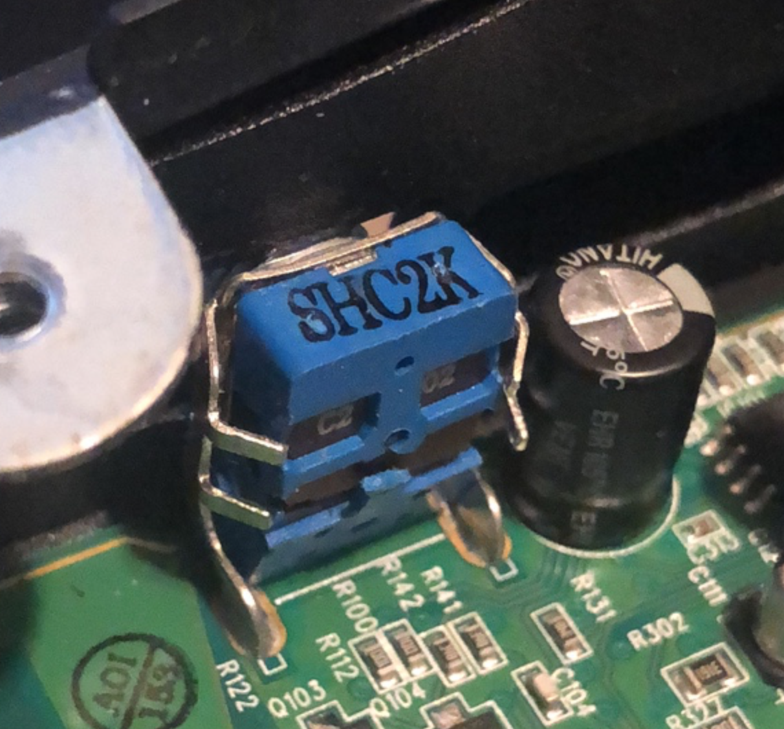

need help to know what is the ohm of this switch
  • tonytiger
    • Jan 2010
    • 163
    • canada
    hi,guys.
    this is a volume pot inside of a tc-helicon voicelive touch 2....'ve been trying to find a diagram but did not have any luck....and nobody can tell me what switch i need to replace the original one....so far i tryed a P110KV1-1F15BR100K(100 ohm)
    from digi-key and i need to put it at 3/4 before starting to have volume.... there is no other numbers on this switch other that the one you see on top...can someone tell me what im missing or what other switch i could try.thank you.

    You can probably find the ohms by using a multimeter.
    Other than that, you could find a new switch by looking up the specific device the volume pot goes to on a replacement parts site.

      Check the resistance across the two outside connections, then measure the size of the control and shaft, It looks like a 8mm or 10mm pot. If the pot directly controls the audio signal you will need a audio taper pot.
      The pot P110KV1-1F15BR100K is a 100KΩ not 100Ω

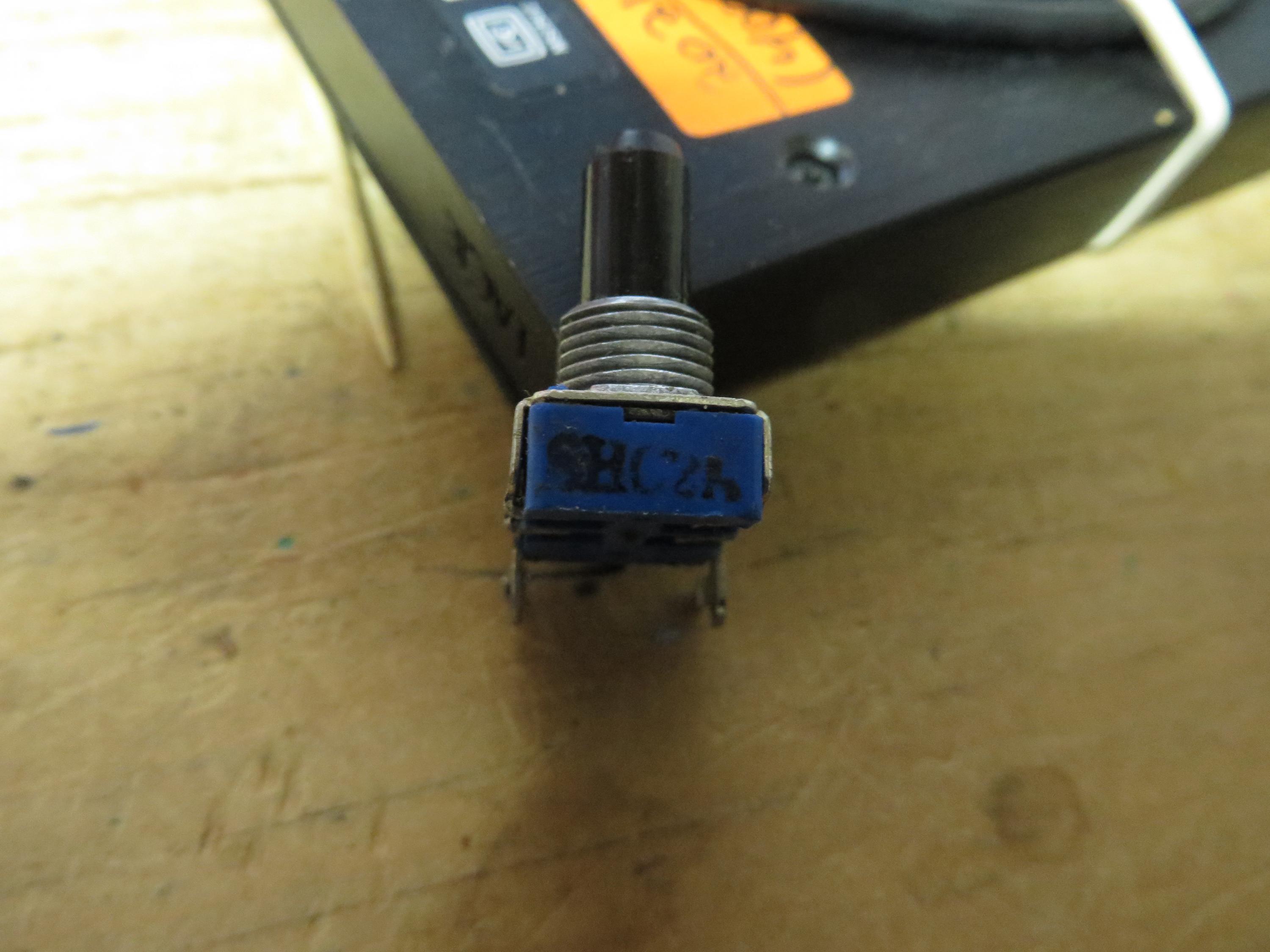

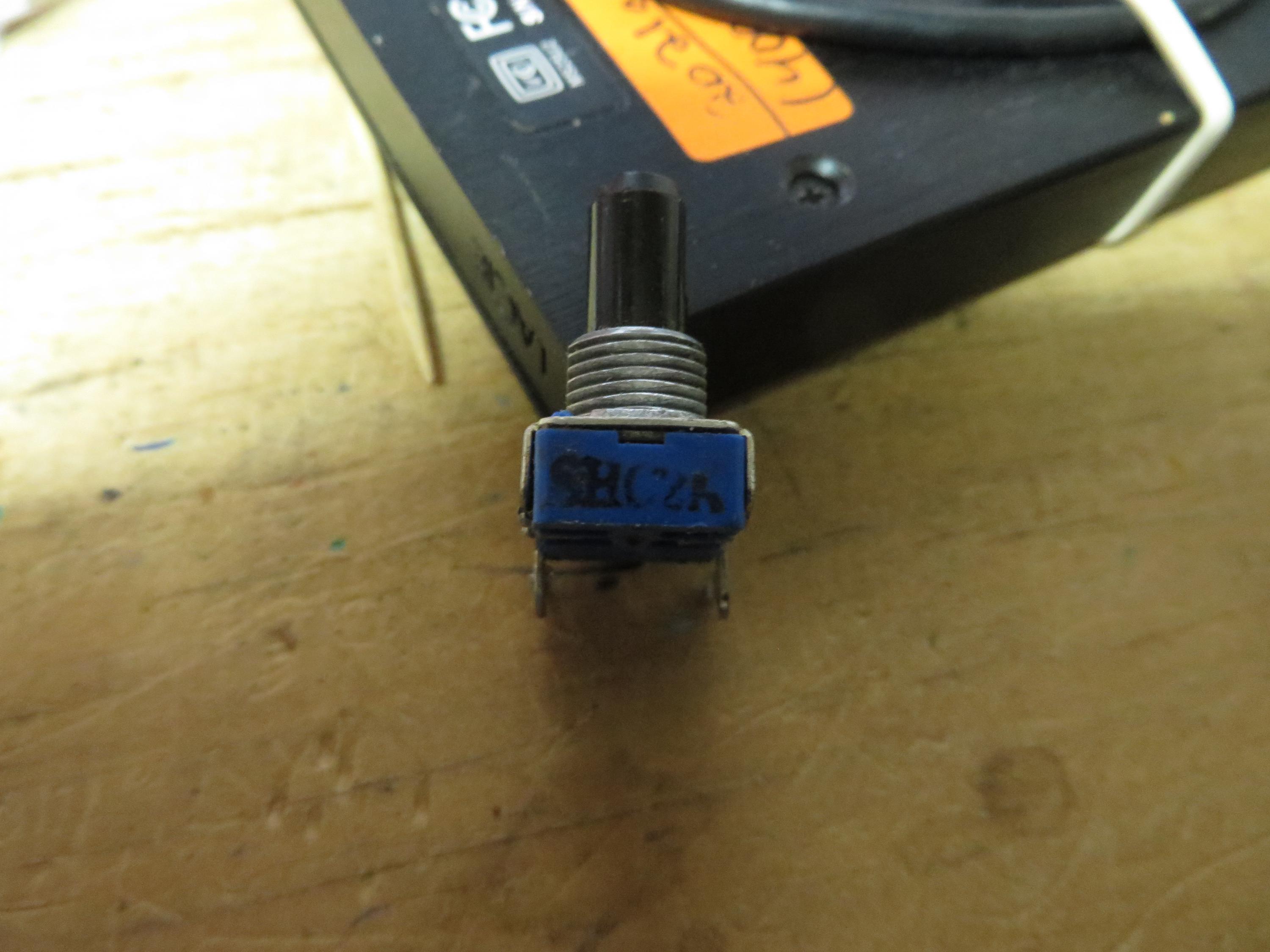

        Those markings look a lot like "SHC2K". "SH" might have something to do with the series or brand, but "C2K" would indicate a C-taper (reverse-logarithmic, anti-logarithmic) 2Kohm potentiometer.
        C-taper pots are often used in the gain adjust of mic preamps.

                  Also, see if the pinout matches the one in the datasheet for the potentiometer i linked. I can't see in the photos you posted, if yours has 3 or 4 pins, even.

                  The one i linked is a 2Kohm reverse-audio / reverse-logarithmic / anti-logarithmic taper / C-taper potentiometer, which should(?) match the one that seems to be faulty in your unit. So it should work, as long as you can confirm the end-to-end resistance in yours is indeed 2Kohm, and compare the dimensions with the drawings in the datasheet.

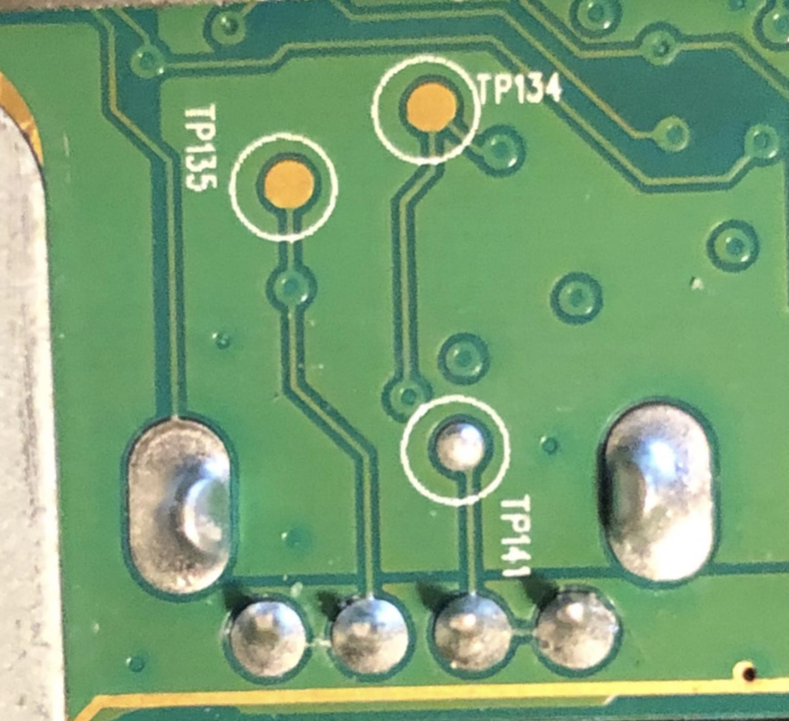

                    it has 4 pins.
                    it is hard to test since the pot is broken through though.

                        I'm going to guess the potentiometer (if you can look at the bottom of the board) has two of the active pins connected together, so in essence, wired as a variable resistor. The big fat electrolytic next to it would be indicative of this being the analog gain adjustment of the mic preamp.
                        In that context, you could very well use a 10K pot, and solder in a resistor (say, 3.3k or so) in parallel with it.

                          Re: need help to know what is the ohm of this switch
                          thanks, made some new pics that confirm your suspicions.
                          btw left two pins are not connected, think it was some dust in the pic.
                          pin 3,4 are connected.
                          the 3.3K resistor to which pins do i solder that?

                            https://cdn.badcaps-static.com/pdfs/...106059987c.pdf
                            "Electrical diagrams", first one, PTV111. As you can see, pin 4 (as seen from the front) is "dummy". Your "pin 3,4" are pins 1 and 2 in the datasheet.
