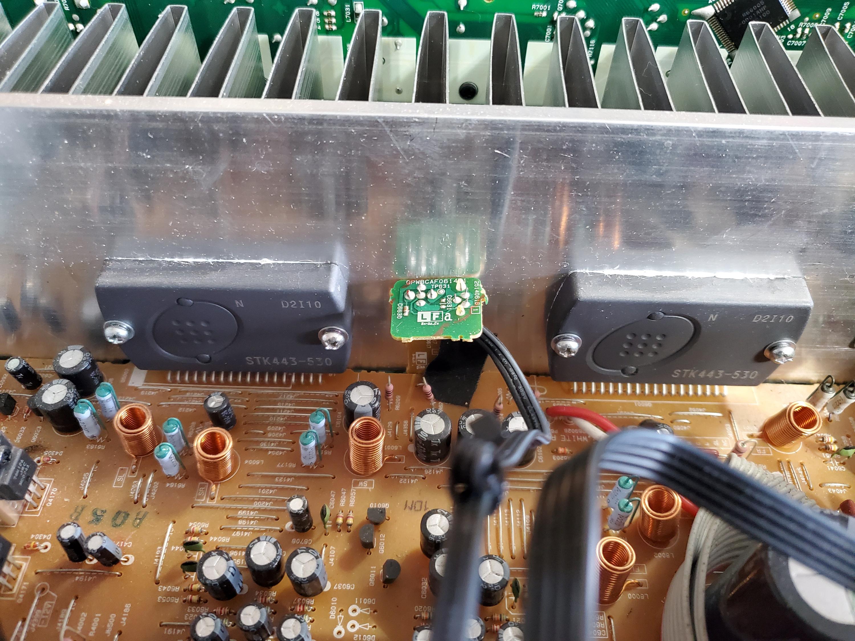

                        • SolomonMan
                          • Apr 2019
                          • 206
                          #32
                          Re: onkyo ht-r290 - My Next Project
                          Originally posted by tibimakai
                          He is turning it on every time.
                          That is correct! I am turning it on every time.
                          Chris
                          • SolomonMan
                            • Apr 2019
                            • 206
                            #33
                            All,
                            Thanks for the help,
                            Got the furnace all set.
                            Now to something fun.
                            There appears to be NO shorts between ground and 4 5 6 7 17 18 power amp outputs.
                            The 6 sets of resistors like r6164/r6174 all measure at .4 ohms which I believe is correct (resistors in series .22 + .22 = .44).
                            The Voltage readings at the IC are a little bit of a different story;
                            I have included a pic of what I am doing for testing;
                            Basically the black lead Alligator Clip to the Chasis.
                            The Red lead to IC pin using a IC clip.
                            Voltages are as follows (when I push power on and before it clicks off);
                            Left IC
                            Pin4 - .25 V
                            Pin5 - 1.5V
                            Pin6 - 5V
                            Pin7 - .25V
                            Pin17 - 2.31V
                            Pin18 - 5.3V
                            Right IC
                            Pin4 - 3.75 V
                            Pin5 - .25V
                            Pin6 - .25V
                            Pin7 - 6.25V
                            Pin17 - 24.75
                            Pin18 - 25.00V
                            The Right IC pins 17 and 18 are pushing 25Volts on the Right IC. I tested this 3 times and each time 25 Volts.
                            Another thing that is interesting is when the relay (the click) flips off (assumed). The voltage on some of the other higher leads may switch polarity (+-) with a significant voltage changes down but still usually over 3 Volts and the voltage then stays consistent and then slowly bleeds away.
                            I am going to have to review the schematics etc...Any ideas?
                            Thanks again everyone for the help,
                            Chris
                            • madan1
                              • Nov 2016
                              • 670
                              • Bulgaria
                              #34
                              Originally posted by SolomonMan
                              ...Right IC
                              Pin4 - 3.75 V
                              Pin5 - .25V
                              Pin6 - .25V
                              Pin7 - 6.25V
                              Pin17 - 24.75
                              Pin18 - 25.00V
                              There it is.. now cut pins 1 and 2 and try to power the unit.
                              By the way what is the voltage on pins 1 and 2?
                              • SolomonMan
                                • Apr 2019
                                • 206
                                #35
                                mandan1,
                                pins 1 and 2 on both ICs are 24.95 volts.
                                Cutting pins 1 and 2 on the right side allowed the amp to stay on and put out music on half the channels.
                                I assume just replacing the STK443-530N will correct the problem?
                                Chris
                                • madan1
                                  • Nov 2016
                                  • 670
                                  • Bulgaria
                                  #36
                                  Are you sure about the polarity of the voltage? One should be positive, the other one - negative.
                                  Also, according to the service manual - the power supply should be +/- 49. Check the user manual and be sure that 8ohm speakers are selected and check again that rails.
                                  When you have power rail voltage on the output, this usually means that a transistor has shorted. In your case I would also check the input signal for that particular channel ( pins 15 16 ), just to be sure that there is not something wrong on the pre-amp.
                                  And yes, if the pre-amp is fine, installing a working STK should fix the problem.
                                  By the way, why don't you try to connect back pins 1 and 2 and cut the output pins for the bad channel ( 17 18 ). I have never worked on such ICs and wonder if it is possible only a single channel to fail or a failure like that will affect all channels/IC.
                                      Well, I hoped that if you cut the faulty channel pins, you could use the rest, but no luck here. Looks like the fault has affected and the other channels which puts the amp into protect mode.
                                      I can't give you an advice about a replacement.. but I have read that there are many fake STK ( https://www.youtube.com/watch?v=EZJjqpDaSZs ).
                                      Probably look for good seller feedback or search the threads here for more info. I guess I would get a used original one.
                                      Yes, you can use thermal paste as long as it does not short any pins to each other or to the heatsink.

                                        madan1,
                                        Thanks for the help!
                                        I will probably pick up the used one in the hopes of getting it fixed over my Christmas break.
                                        I will let everyone know the outcome of the fix!
                                        Thanks again!
