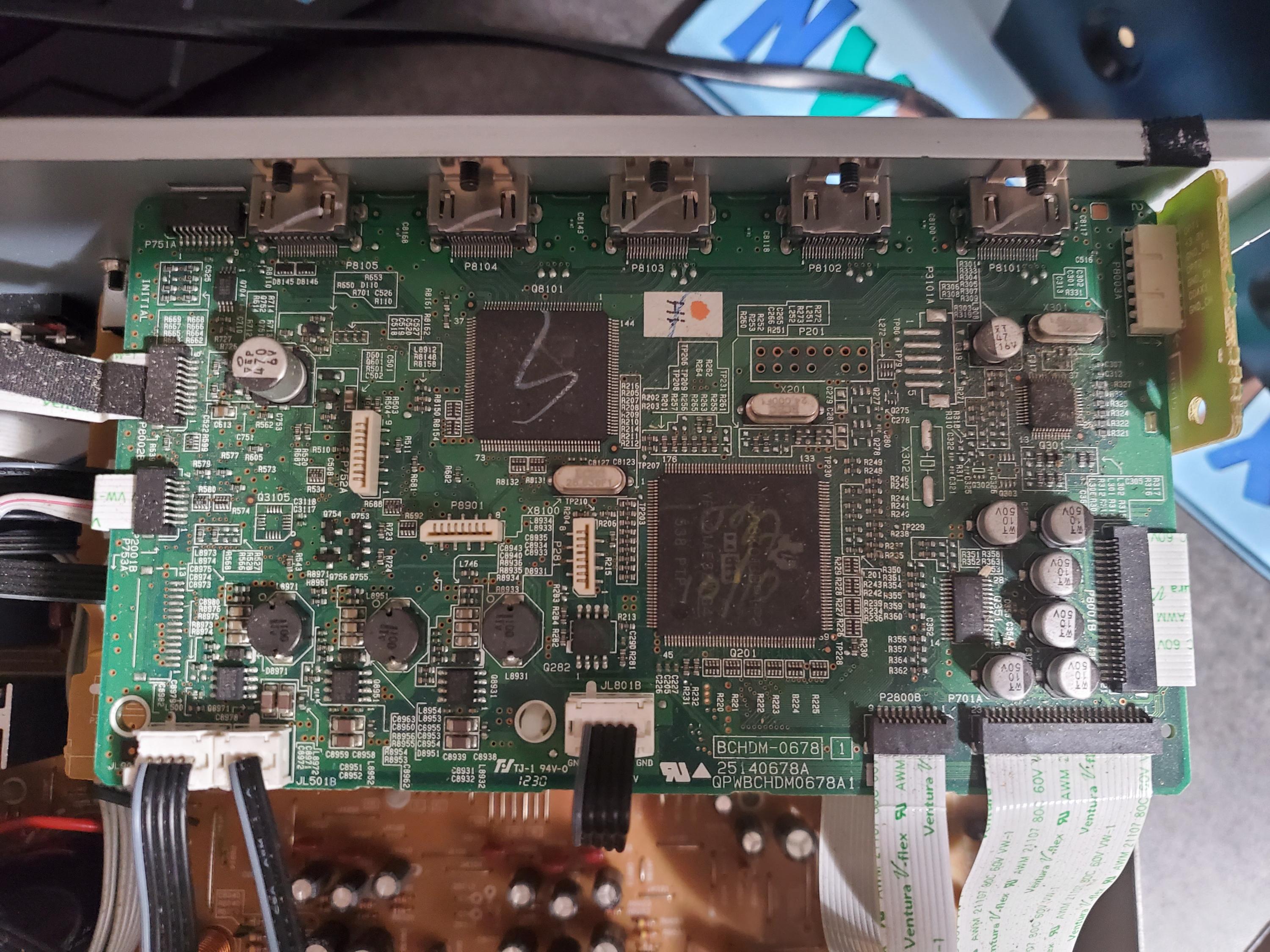

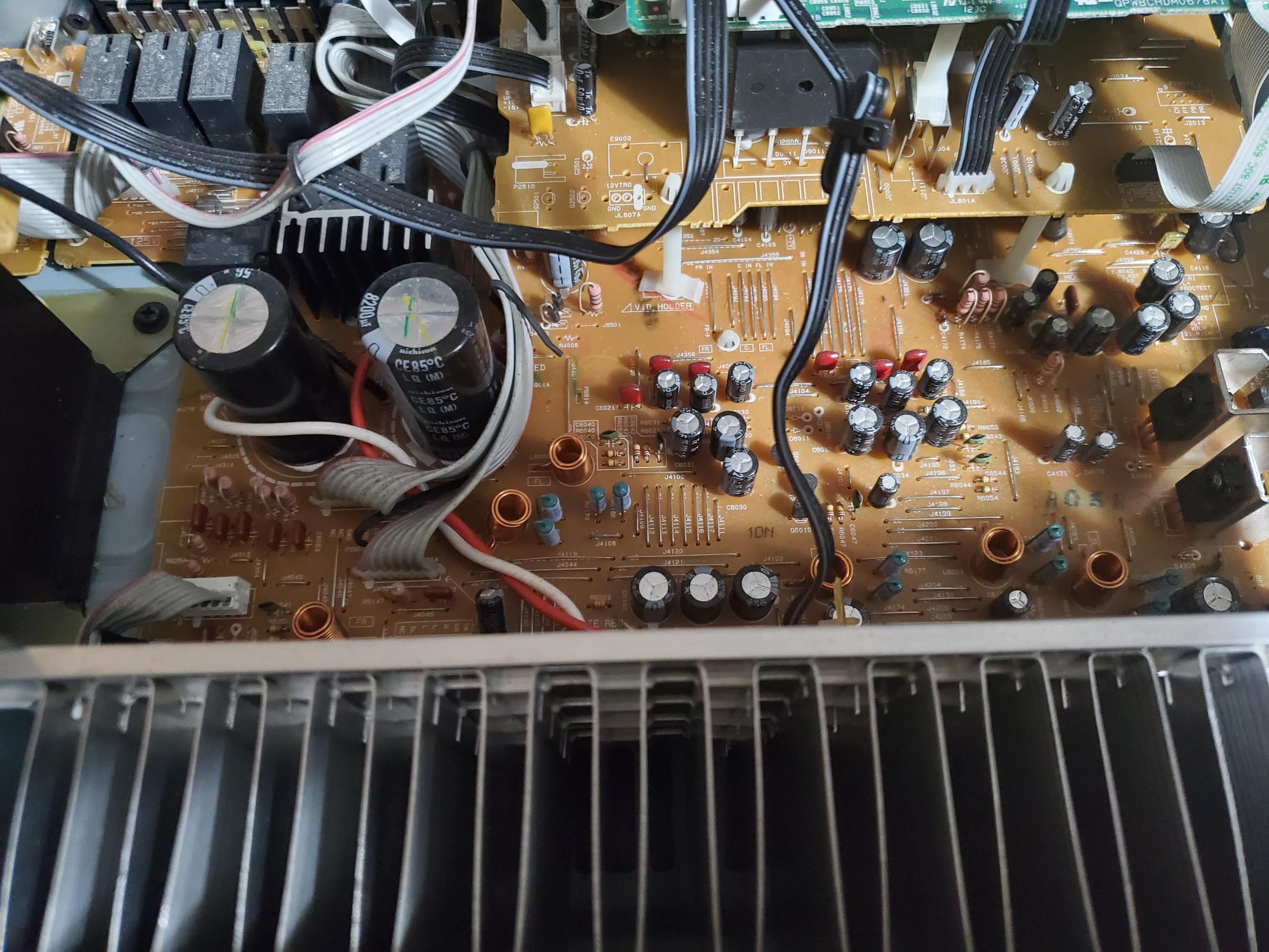

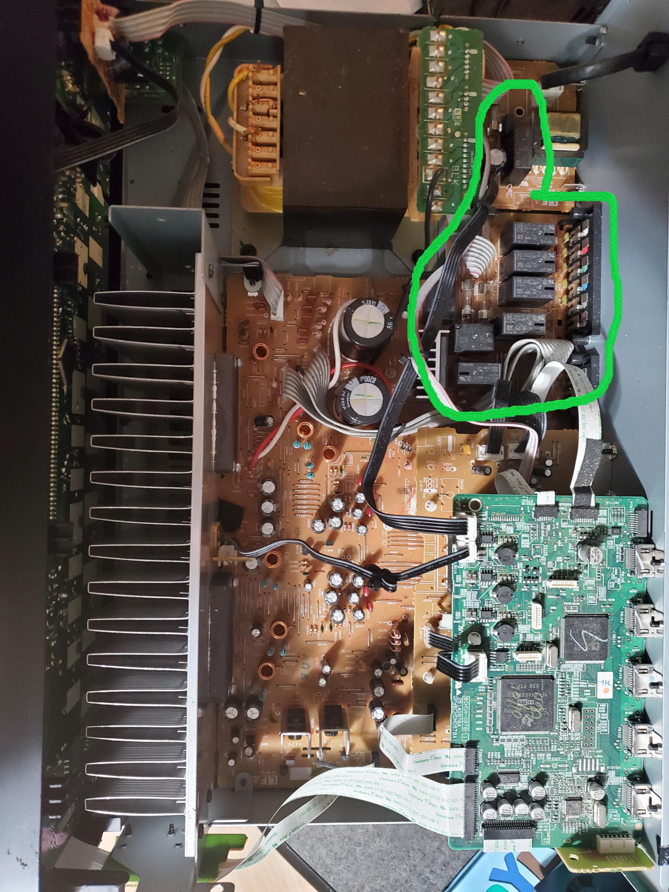

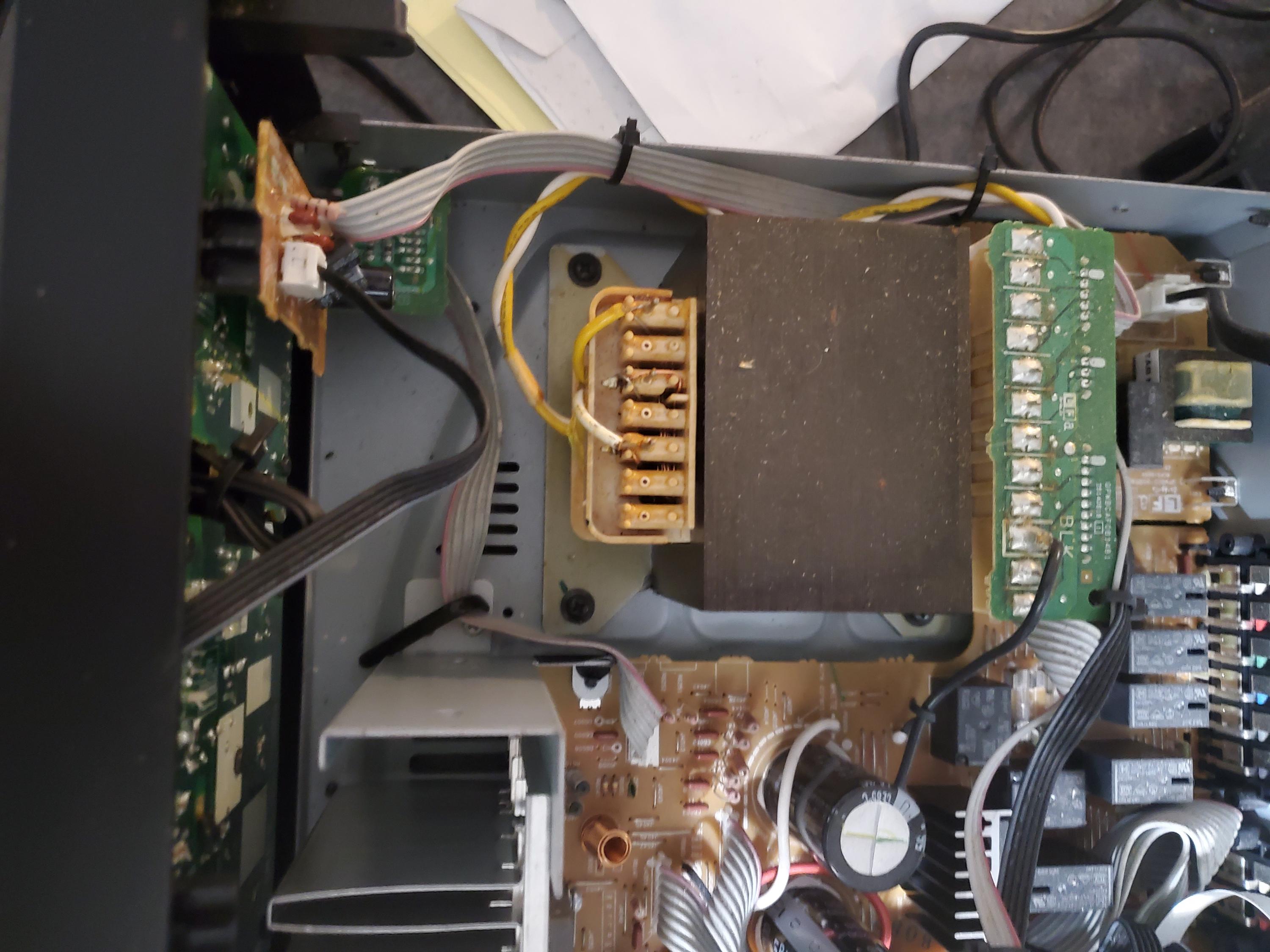

        • SolomonMan
          • Apr 2019
          • 206
          Re: onkyo ht-r290 - My Next Project
          Sorry for the Delay,
          Below are some images of the stereo amplifier in question;
          Chris

                  • frankusb
                    • Apr 2015
                    • 110
                    The two big black integrated amplifiers on the heat sink (in your 4th picture) is where I would start. Can you get the part number off of them?

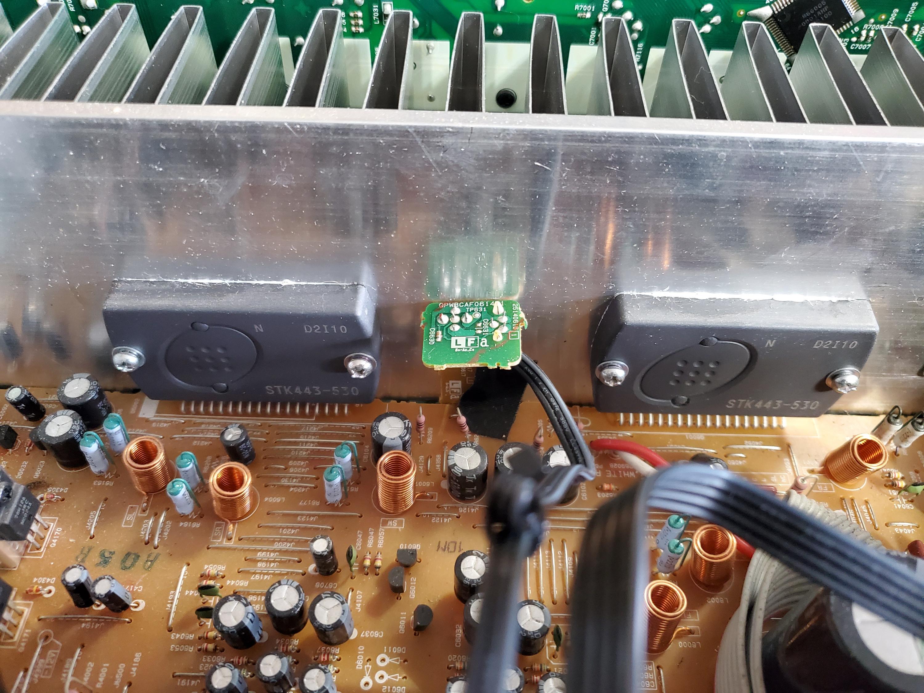

                      • tibimakai
                        • Jan 2012
                        • 3680
                        I'm not familiar with Onkyos, with integrated amps. BUt most likely one of them has an issue.
                        The schematic shows three integrated amps, you seem to have only two. So maybe yours is only a 5.1 channel receiver.
                        2 x STK-442-730-E and 1 x STK442-530-E
                        You should have a 730, and a 530 in there.

                            • tibimakai
                              • Jan 2012
                              • 3680
                              If there is an error, the receiver protects itself and the speakers won't be turned on. There are a few relays, close to the transformer at the back, that do that.
                              I would check those 0.22 Ohm resistors, at the legs #4 to see if they are open.
                              • SolomonMan
                                • Apr 2019
                                • 206
                                Guys,
                                Thanks for the responses I really appreciate it and I have learned so so much!
                                I will check the .22 ohm resistors and the temperature of the Amplifier IC.
                                I was hoping to get to it last night or possibly tonight but family chores (have 5 kids and a wife) has kept me hopping all this week...not to mention the earlier weeks snow. Tonight does not look any better, its grocery night (lol) but I believe Saturday (since I did groceries tonight) I can squeeze some time in for this endeavor.
                                If the one or both Amplifier ICs appear hot will removing them entirely still allow the Amplifier to stay on? (Is this kind of a standard testing protocol for amplifiers?)
                                If it turns out to be a single Amplifier IC would one normally just replace one or both? (How likely is the other to fail?)
                                I actually located the IC for about $15 new so if there is any benefit I may just replace both. Or maybe buy 2 and keep one as a spare if the chance of it not being available is ever a possibility.
                                On the relays, I included a image, I assume they are the large black items circled in green. I am looking for red, red, silver (.22ohms) resistors to test as well...correct?
                                Thanks again for all the help,
                                Chris

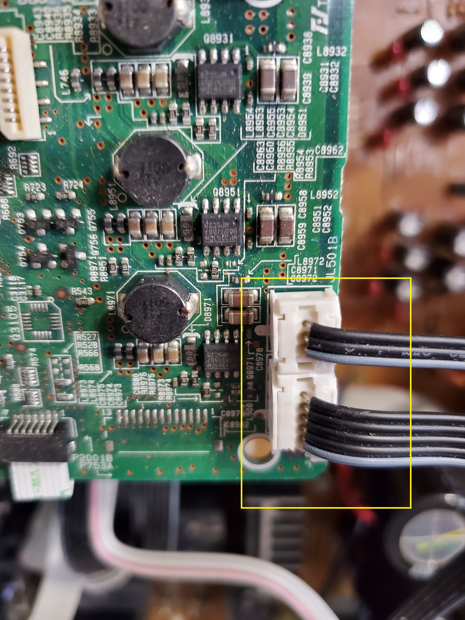

                                      • SolomonMan
                                        • Apr 2019
                                        • 206
                                        Guys,
                                        I got a little time on the amplifier last night and this morning.
                                        The Amplifier ICs do not appear to be getting hot in the least. I ran it thru the ON and then protection OFF "process" a full six times (right after each other) with the amp full up volume.
                                        Images are included of the actual ICs.
                                        They are a pair of STK443-530.
                                        I was going to tear things down and try to start troubleshooting the electronic components but I am going to ask for a little guidance on the tear down part. (To avoid breaking things/time reasons)
                                        How does one normally tear down a Amplifier or specifically a Onkyo Amplifier?
                                        Does the bottom come off some way or do you just strip it down board by board to the board in question. The reason I am asking this is I have seen a couple examples on YouTube where they are replacing the ICs and they just took off the bottom (Somehow) of the stereo unit to desolder and resolder in a new set.
                                        Also I have include a image of a set of connectors (Yellow Square) that are numerous on this unit. It appears they are power connectors.
                                        I am going to mention, for anybody in the future that has to tear this unit down, they disconnect by pushing down on the white center on both sides and gently pull the wire(s) up.
                                        It took me a little while on this as I have not seen this connector before but luckily I took my time to figure it out. (read here no damage)
                                        Thanks everyone for the help,
                                        Chris
