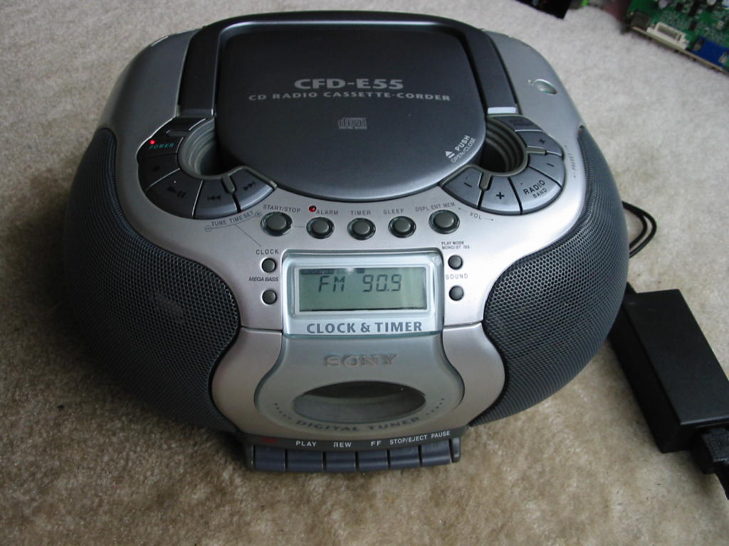

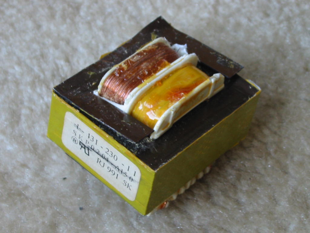

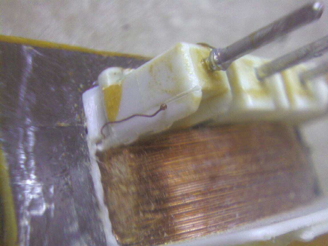

    Long story long , my dad picked up a Sony CFD-E55 boombox over a decade ago from the trash room in a condo where we used to live.
    (Note: picture below is of the boombox after the repair.)
    He then put it in a box when we moved places and it sat in the garage for a few years. Eventually, I tested the boombox and found that it worked on batteries, but not on AC. Digging in revealed the internal line-connected transformer had an open primary winding and no thermal fuse (wires melted on a few layers, thus not able to repair it in any way, and I had to crack-open the plastic shell on the transformer, as seen on the pictures below.)
    So I made a power plug for it to fit a spare 15V, 4 Amp laptop power adapter I had at the time. I even posted the repair here in the ghetto mod thread some 8 years ago.
    Old picture of the repair: https://www.badcaps.net/forum/attach...3&d=1353991011
    While that repair did work OK, I noticed that the amp IC would get quite hot, along with the linear regulator IC for the CD and Cassette Deck (hot enough to cause burning sensation, so probably 50-60°C.) I don’t know what voltage the original transformer output, but given that the output filter cap was rated at 16V, the DC voltage couldn’t have been higher and was probably in the 9-12V range. Thus, I suspect the 15V power adapter was probably giving a little higher voltage than originally, and hence why the regulators and amp IC ran hot. Nothing overheated with the 15V adapter, though, and the boombox did work OK like that. Moreover, it’s not like anyone used it much at the time, so for the most part, it sat idle in the garage. I actually did use it a few times when I found some old cassette tapes and was curious what was recorded on them. On that note, this Sony CFD-E55 actually has a really good, clean-sounding tape deck. Radio and CD also work great.

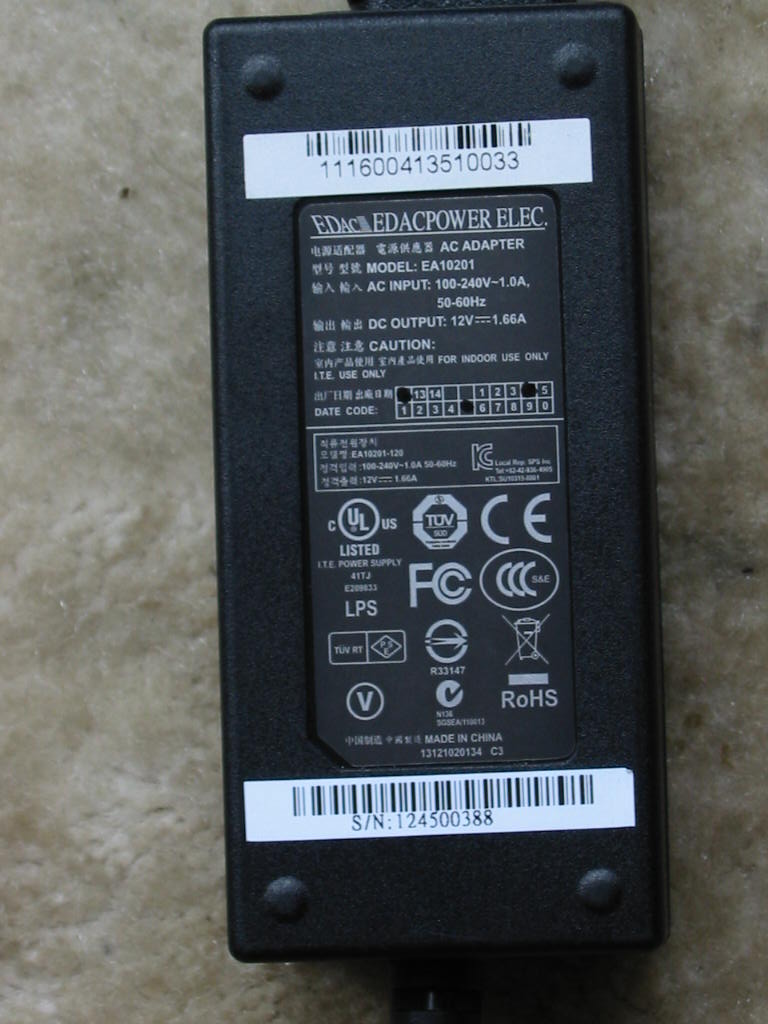

    Starting with the power adapter I used (15V, 4 Amps)… let’s be honest: a boombox like this doesn’t really need such a large power adapter. Perhaps if the amp IC was one of those dual BTL jobbies, that current rating would have made sense. But this wasn’t the case here. The amplifier IC in the CFD-E55 is a Sanyo LA4601, which is a single-ended stereo amplifier chip. Its datasheet suggests that it can drive up to 2x 7 Watts (with ugly 10% THD ) into 3-Ohm speakers with Vcc of 15V. But it also states that if Vcc is 9V or less, the IC can be used without heatsink, which is how it was in this boombox (this hints the original transformer was probably rated at 12V or less.) All in all, though, the LA4601 amp IC is really nothing to write home about. The internal speakers in the CFD-E55 boombox are rated 3.2 Ohms and 3 Watts max. Doing the math… a 12V supply used in single-ended amp application means 6V max for the positive or negative peaks. Of course, the speakers would never see that, because of the biasing and internal voltage drops in the amplifier. So, assuming 2 voltage drops @ 0.7V for each 6V “side”, this leaves us with 4.4V max peak (and even that is probably somewhat inflated, but not unreasonable.) With the 3.2-Ohm built-in speakers, the max possible power from 12V should then be P = ((V_rms)^2) / R = [(4.4^2) / 2] / 3.2 = 3.025 Watts RMS. (In reality, the power output would probably be even lower, but this is a decent “best possible” approximation.) Thus, it looked like a 12V power adapter should be plenty to drive the speakers.
    I wasn’t sure which of my 12V adapters to use (I have many), but I had quite a few like this one:
    https://www.badcaps.net/forum/attach...1&d=1601752102
    It is switching type, rated for 1.66 Amps at 12V, with a grounded plug. I load-tested it up to 1.6 Amps continuous, which it output with barely any voltage drop. What worried me more was the ground connection, as sometimes this can introduce line hum noise (especially if the boombox is to input or output audio to another grounded audio device.) I don’t plan on driving an amplifier with this boombox, though, and there are no auxiliary audio inputs, so the grounded adapter shouldn’t be a problem. Being switching type, it probably would interfere with AM reception, though.

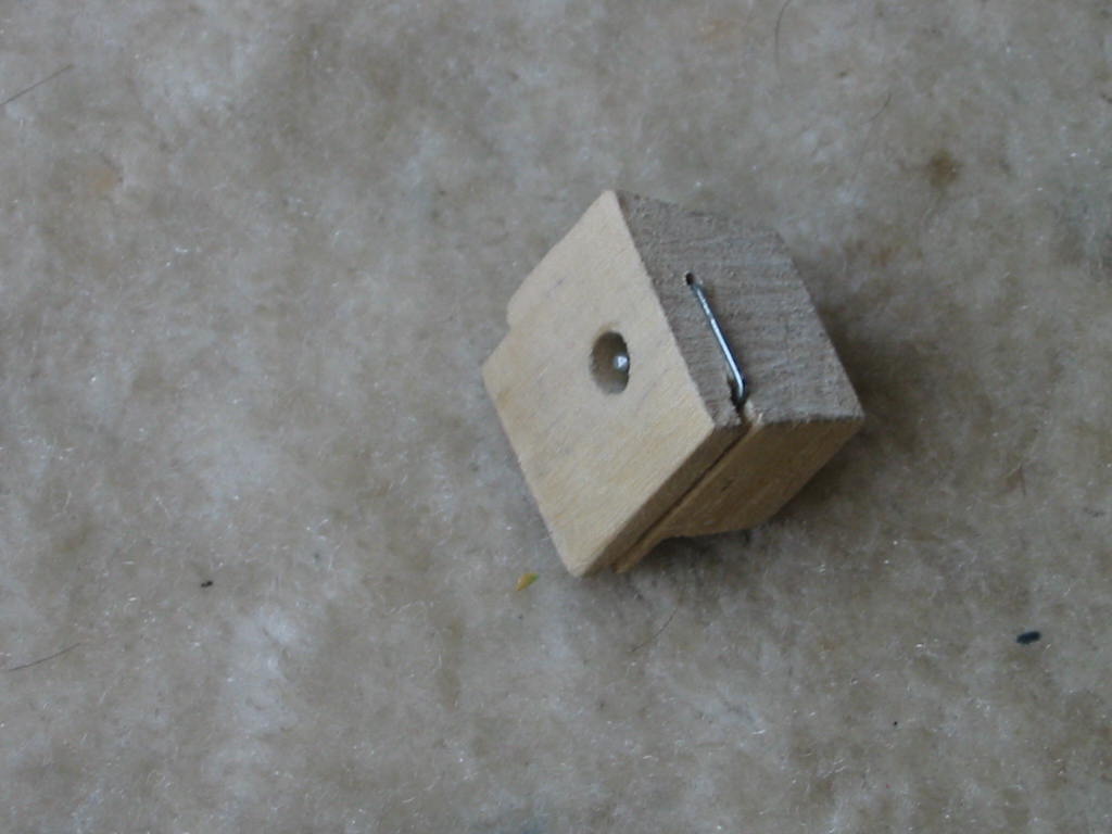

    Next step was to make a plug for the adapter. About 30 minutes later, and I had this:

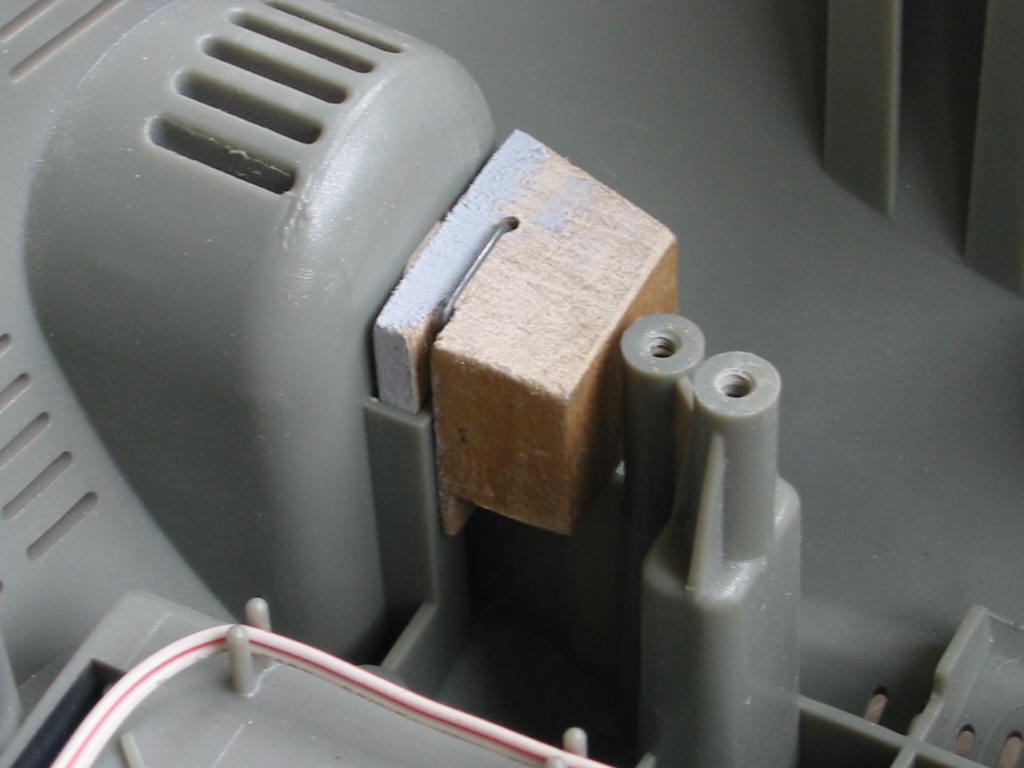

    A block of wood, a piece of nail, and a paper clip is all it took to make this, along with some drilling and cutting, of course. You can also see an ugly piece of aluminum I bent into an L-shape (more on that later below.)
    Checking that the plug fit in the case as intended…

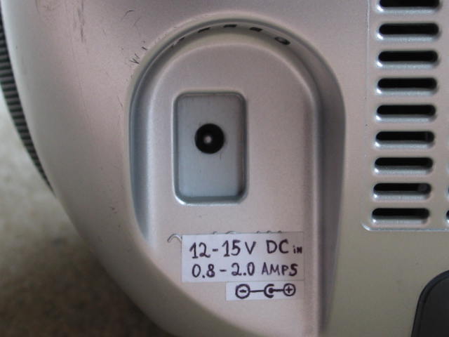

    Painted and added some stickers (from recycled shipping labels ) for the expected voltage and current input, in case the adapter was ever lost (which shouldn’t matter, as I have two or three more of these spare):

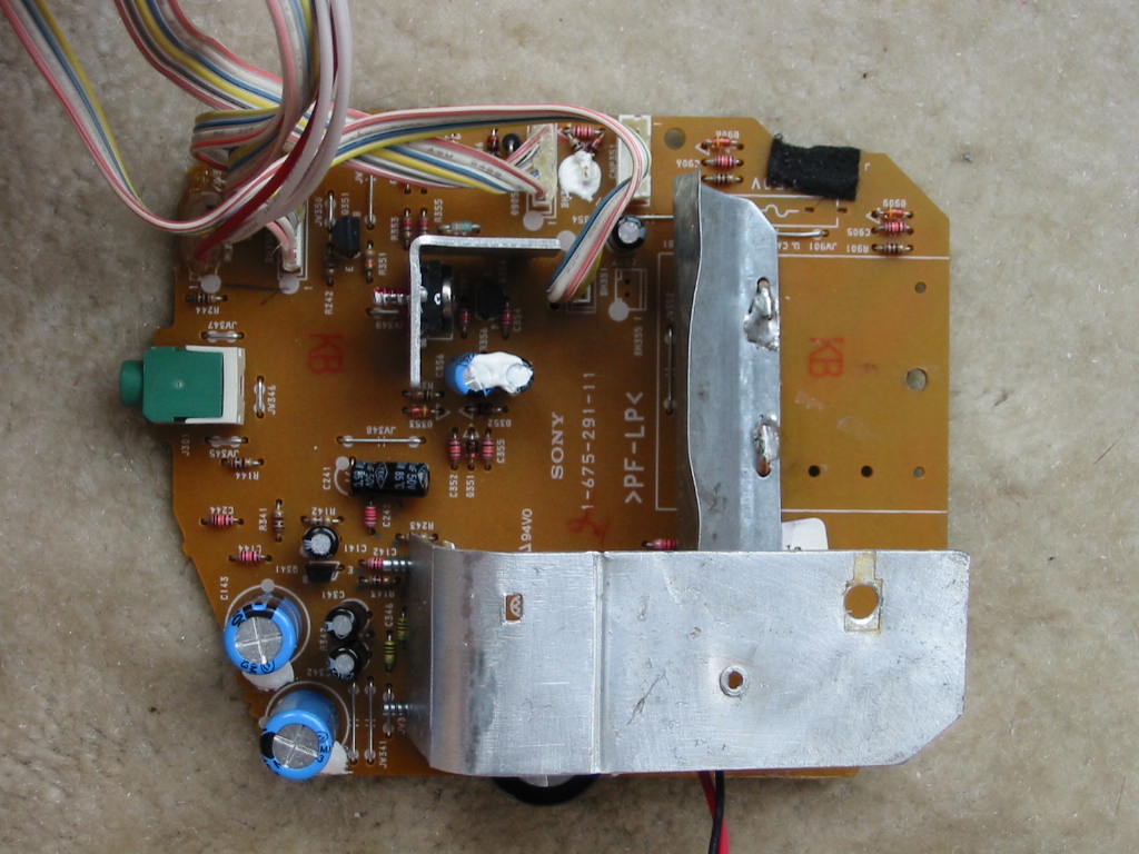

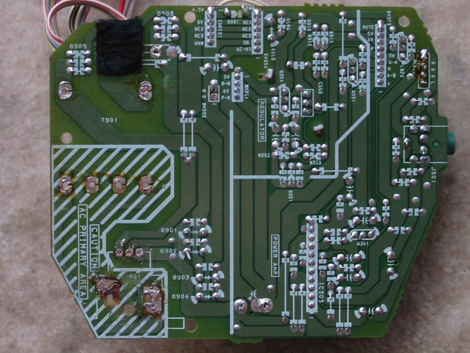

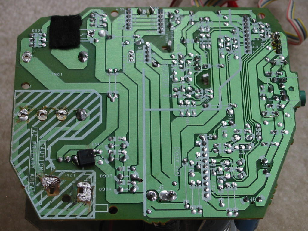

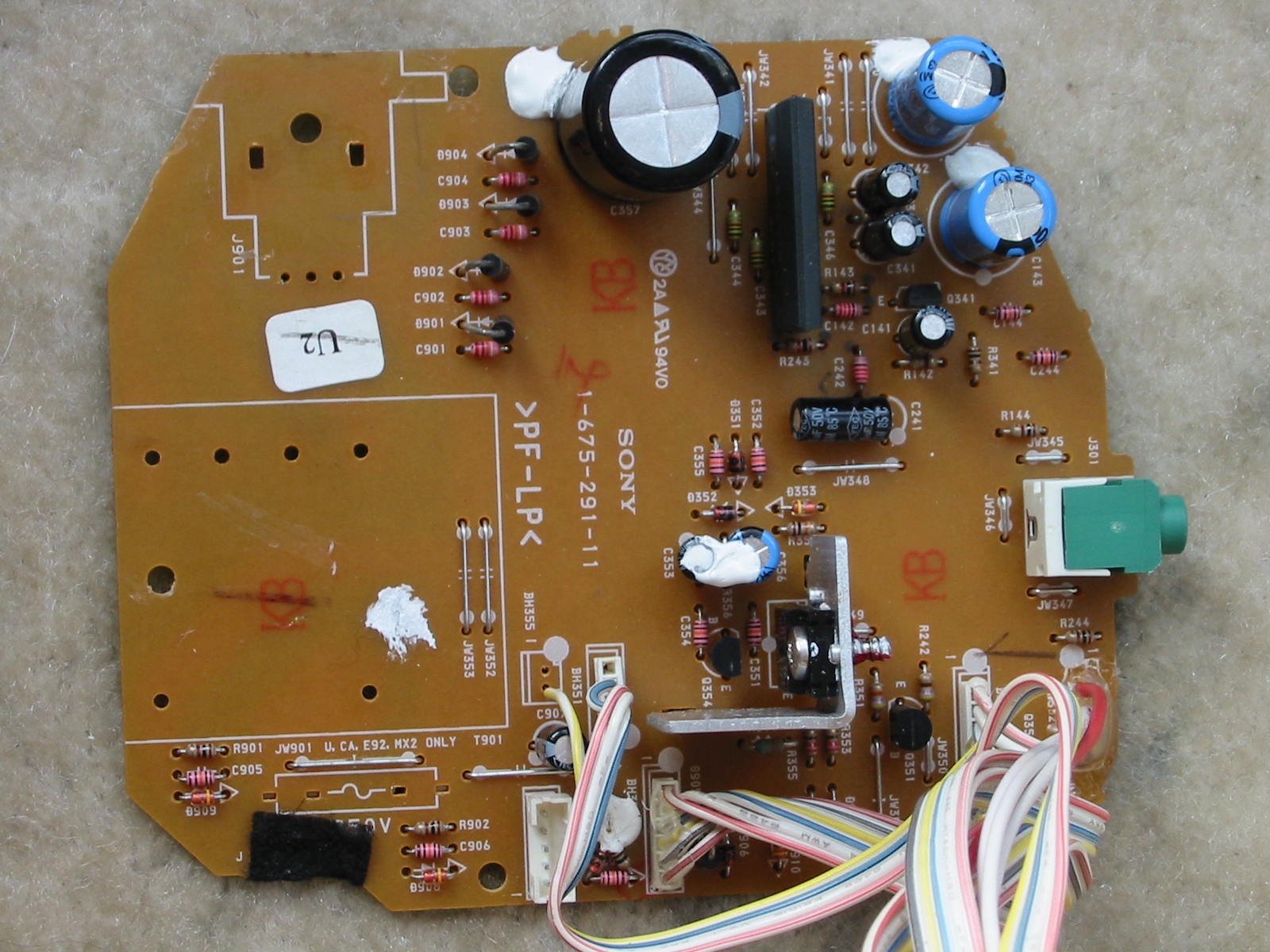

    With the plug part done, time to re-visit the amplifier board (Sony P/N: 1-675-291-11) for some modifications I long had planned. But first, here it is in stock form, minus the old line transformer (T901) and old AC plug (J901).
    Don't mind the lifted/damaged traces on the AC plug - this was caused many years ago when I was beginning to learn to solder
    In the above pictures, diodes D901 through D904 were used with the old line transformer in a full bridge rectifier configuration. C357 is the filter cap for that - a YEC 85°C gp cap, rated for 16V and 6800 uF. Meanwhile, diodes D908 and D909 are for AC detection. More precisely, this boombox uses a rather basic scheme for running between batteries and AC power. Originally, whenever the boombox was plugged into AC, the old AC plug had a switch in it, which would disconnect the main battery source (6 series D-cells) and run the boombox from the rectified AC from the line transformer. So diodes D908 and D909 were used for signaling the power-regulating circuitry to provide various voltages to the deck/CD electronics. With AC gone and AC plug disconnected, the AC plug allows power from the batteries to pass to the amp IC directly. The battery compartment also has several taps between the series-connected D-cells, so that the batteries can directly provide various lower voltages to the deck/CD electronics, bypassing the linear regulators.
    Knowing that and still wanting to keep the battery option functional, I fed both the battery and adapter power through their own diodes. For the battery diode, I used one from the bridge rectifying diodes (D901-904). But for diode for the adapter, I wanted a slightly lower voltage drop, so I used 4813NH N-ch MOSFET connected in reverse (i.e. using the body diode of the MOSFET.) After all, the 4813NH MOSFET I used had a physically broken Gate pin. Instead of discarding it, I gave it a second life as a diode rectifier in my junk box. Don't laugh - high forms of recycling sometimes require more radical thinking!
    With this dual diode setup from each power source, even if power is lost from the adapter, the boombox can immediately continue to operate on batteries, if there are any installed (not that I ever plan to use this feature, but why not still keep it, right? ) The MOSFET diode dropped only about 0.6V under the highest load, so the amp IC was getting around 11.4V, which is even better, since lower voltage means less heat from the amp IC and linear regulator.

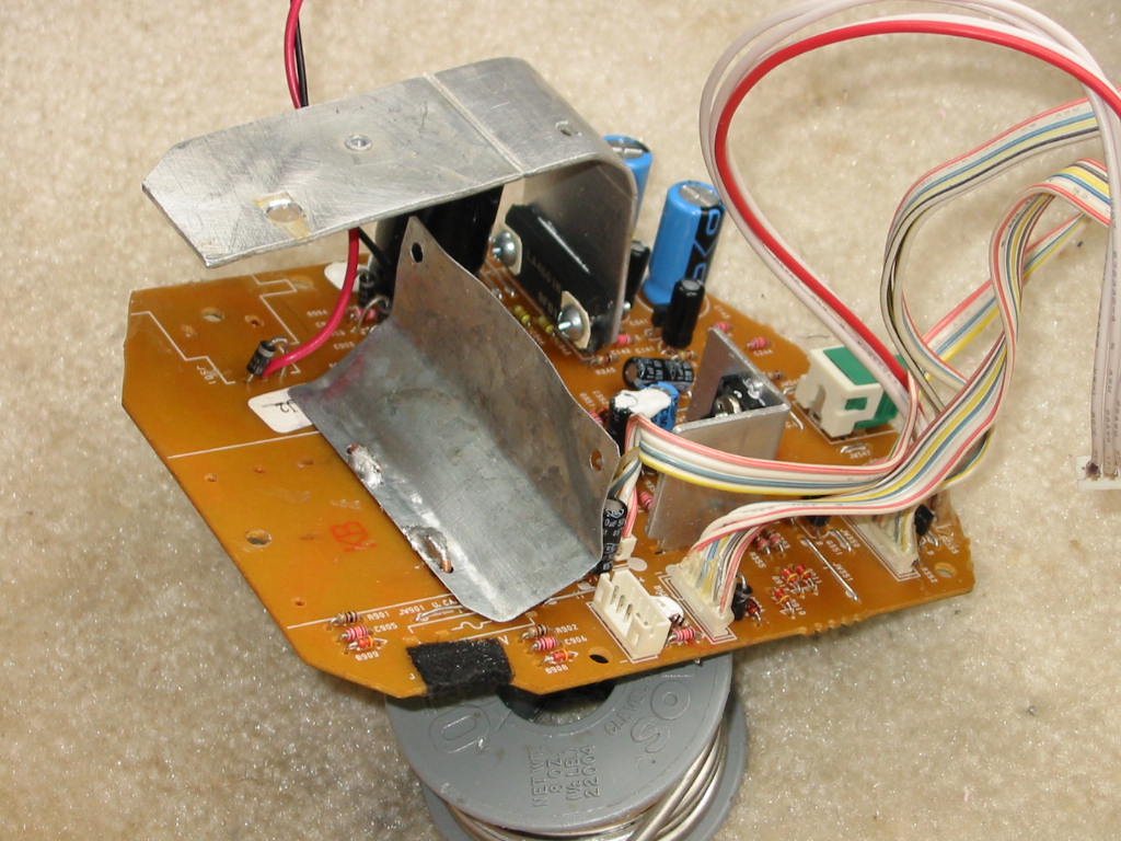

    I also proceeded to add a few other modifications. This was the result of those and the abovementioned ones:

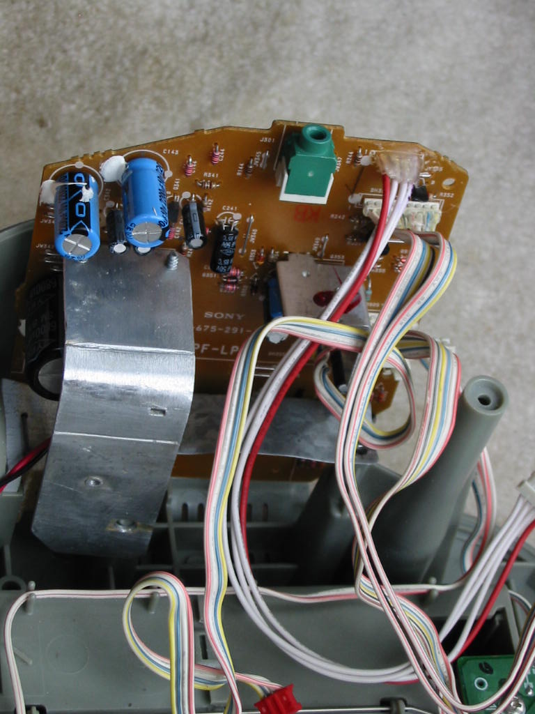

    Obviously, the biggest (literally) mod was a heatsink for the amplifier IC. I found this piece of aluminum on the side of the road many years ago. It had a MOSFET attached to it (which I detached and used for many of my breadboard experiments.) Even though this heatsink was ugly, deformed, dirty, and scratched, I managed to clean it up and straighten it easily. The length and width were just a perfect fit for this boombox (and it crossed my mind that's where this heatsink would go right when I found it.) I call it recycling karma … but calling it hardcore ghetto wouldn't be inappropriate either.

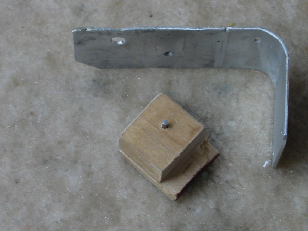

    Next, the big sheet metal piece: I added this, because the old line transformer had a metal bracket that would hold the PCB onto the boombox case (otherwise the PCB would be loose in there, making the headphone jack hard to use.) With the old line transformer gone, this seemed like a good solution (it wasn't, but we will get there as to why.)
    And finally, looking at the bottom side, I added jumper wires across resistors R144 and R244. Why? -Because these resistors are connected in series with the load on the headphone jack. This is a good idea to prevent damage to headphones (either due to amp volume turned too high or faulty/shorted amp IC.) However, it does add distortion to sound. Of course, I wasn't concerned about that. Rather, the idea behind this mod is to allow small (and better) bookshelf speakers to be connected through the headphone jack with a 3.5 mm to speaker output cable. I actually tested this after doing the mod with a pair of Kenwood LS-N451 6-Ohm speakers, which I've had for many years and know they sound pretty decent. The difference between those and the built-in boombox speakers was very significant. They were louder and bass actually sounded like… well, bass. Imagine that! Not that the CFD-E55's built-in speakers are bad, or anything. But there is no baffle in the boombox case and it's not really a proper speaker box anyways. So of course they will sound worse. Also, thanks to the speaker output coupling caps in the boombox being 2200 uF (Lelon brand with what appears to be week 33 of 1999 date code), this sets the -3dB low-cut frequency to about 12 Hz with my 6-Ohm speakers. The current draw from the power adapter was significantly lower as well - about 0.4 Amps max before significant sound distortion. That's half less than the consumption with the built-in boombox speakers (which makes sense, since the built-ins have approximately half the impedance.)
    Anyways, here is why I put on that steel sheet bracket:
    It basically allowed the amp board to get screwed onto the two plastic standoffs on the boombox case. However, the flimsy steel sheet that I used couldn't really hold the PCB too well, so the headphone jack would sag into the case every time a 3.5 mm plug was used. Also, this original arrangement of the PCB being held to the bottom part of the boombox made it difficult to shove all the wires and ribbon cables in the boombox when closing it together, especially with the newly added amp IC heatsink.
    So, a slight change was in order:
    I decided not to use the steel sheet bracket, and instead used a long piece of rigid steel wire to clamp down the PCB right in the boombox. To prevent the PCB from turning, you can see a pink piece of foam installed behind one side of the PCB (note: there are no components in that area, so there is nothing that can make the foam catch on fire.) This allowed me to neatly connect and route all wires and ribbon cables, away from the heatsink… except for the battery power ribbon cable - that was a PITA to connect with the amp IC PCB already mounted. But once done, everything closed up nicely. After testing the boombox at high volume for about an hour, I could feel the amp IC heatsink was doing its job, because I could feel slight heat coming from the vents right above the amp IC heatsink. Yet, checking the amp IC heatsink temperature revealed it wasn't running that hot - only around 45-50°C, which is quite acceptable. The more worrisome temperatures were on the linear regulator heatsink, running 55-60°C. Unfortunately, there is nothing I could do about that one, other than changing its heatsink as well… which would have been a PITA, so I left it as-is.
    Doing some tests with jumper leads revealed the CFD-E55 did not use more than 0.85 Amps @ 12V with the built-in speakers and volume high enough for bad audio distortion. This indeed confirms the “best-case” scenario calculations for the max power output that I did above. Given these numbers, the amp IC probably wasn't using more than ~10 Watts, which suggests the speakers weren't seeing more than 3 Watts (assuming 5 Watts went to each channel, and assuming 60% best-possible efficiency, as this is a class AB amp.)
    With that said, I do remember the 15V adapter did allow the volume to be set a little higher due to the higher voltage. But the difference is hardly worth it. In the end, boomboxes like these aren't really meant for loud listening or a Hi-Fi experience. So going down to 12V didn't seem to matter much, aside from lower dissipation from the IC, which I thought was more important
    After that, I closed everything up and set it up for my dad to use. He listened to it for several days while working in the garage (with the door open) in the midst of the summer heat (~30C / 86F.) So far, so good - this Sony boombox has been running well.

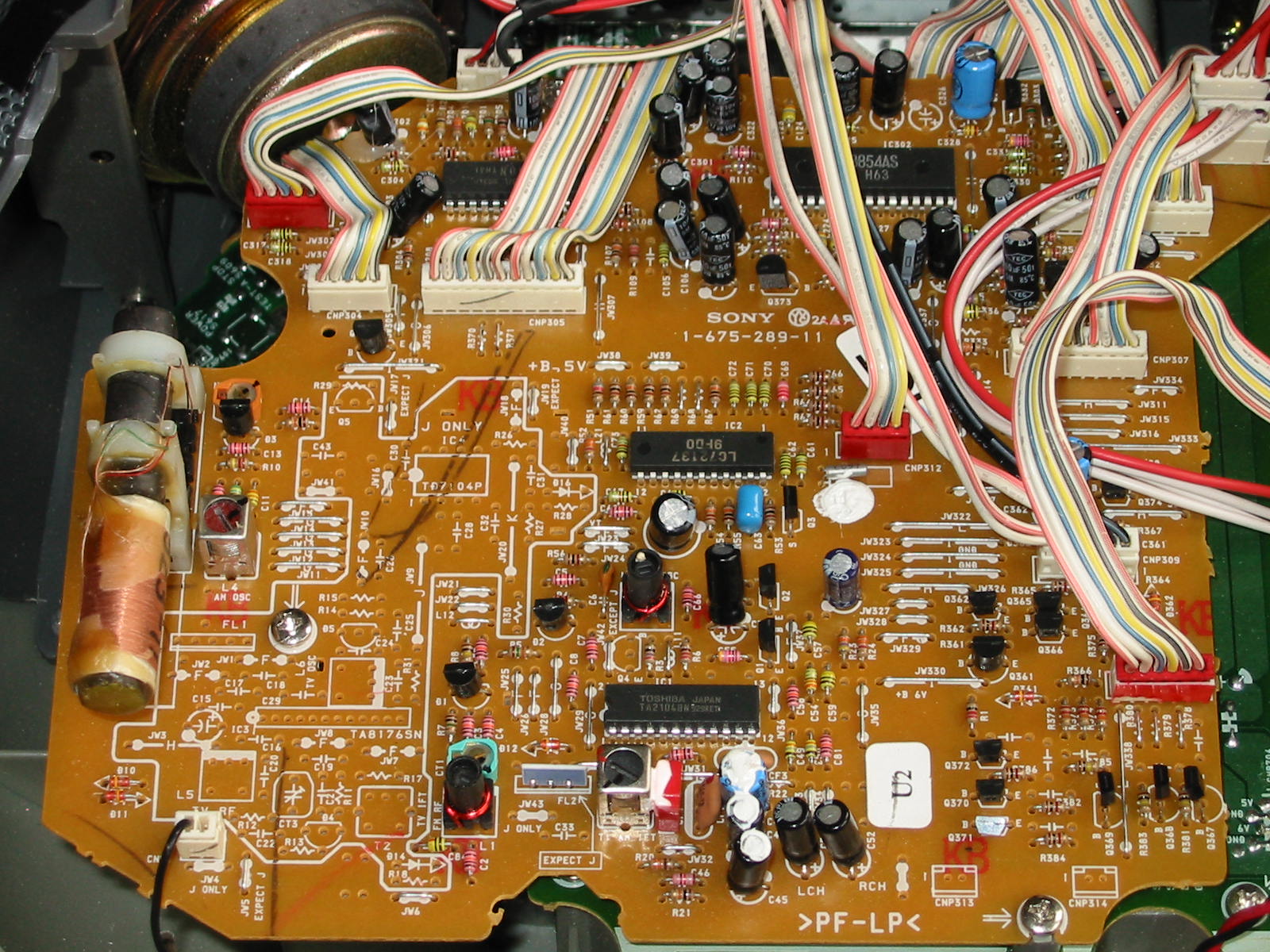

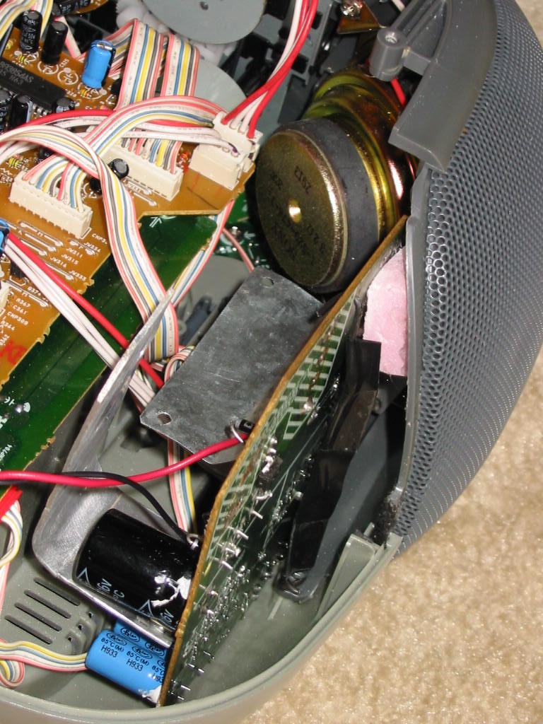

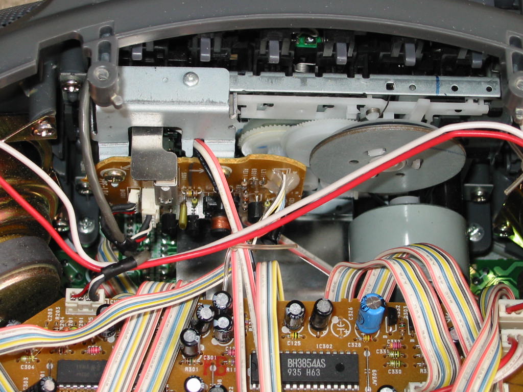

    I also snapped a few more pictures of the electronics inside this boombox, just for those who may be curious here.
    https://www.badcaps.net/forum/attach...1&d=1601752686
    Not much to see really. Just your average plastic-fantastic audio gear from the 90's and 2000's… but this one isn't that bad and, at least for some garage tunes, is OK. Plus, that's one item less for the local dump to incinerate and pollute the air.
