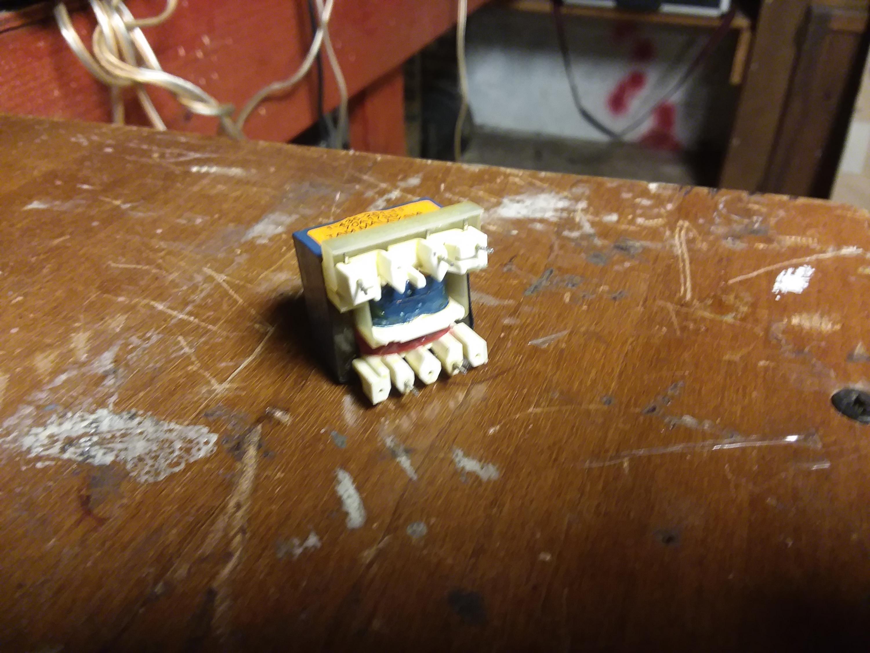

    Got a Sony STR-DE697 with a bad power transformer (1-435-281-11). This will be my second receiver with a bad transformer; the first I was able to find a direct replacement off ebay. With this one, nothing has been found except for an old ebay listing for the sub board itself.

            Primary side of transformer has 3 poles, measured OL on all of them. I know this isn't the best way to test these things but it's good enough for me.
            Even if I'm wrong, I'd like to learn how to tell what is needed for a replacement if a direct replacement isn't available. I'm missing something simple, I just know it.

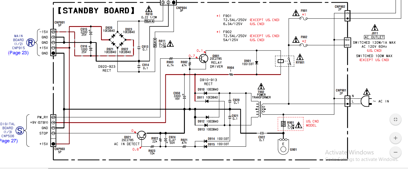

            For those of you following along at home, attached is the schematic for this stereo.

              Well, given that it is used for standby function, it probably doesn't have to output a whole lot of power. So likely you'll just have to find a 6.5V VAC transformer (since you want to get 9V DC) capable of probably at least 200-300 mA to be on the safe side. If space allows, maybe get one capable of at least 500 mA to be safer. Actually, on that note, the output current on the new transformer may not always be mentioned. Instead, you may just see a voltage and VA (Volt-Amps) rating. For the volts, make sure to get one that also matches your primary-side requirements - i.e. 115V if you're in North America or any place with 115V AC lines, and 230V if you're in Europe and most of Asia and Africa. As for the VA rating: that's basically a power rating. In simple terms, it's similar to Watts, but basically a bit more "inflated". So if the transformer is rated for let's say 6V output and 9 VA, the expected maximum output current possible should be somewhat less than 9 VA / 6V = 1.5 Amps (it can vary, based on how inductive or capacitative the load is.)
              All that aside, before you even go looking for a replacement original transformer, try seeing if you can fix the old one. Sometimes, these line AC transformers will have a thermal fuse inside. If you remove/break away some of the plastic tape and cover over the blue side, you may find a square box fuse in there. If you do, check it. If it's open, try replacing it with same or slightly lower-rated fuse and see if traffo works again.

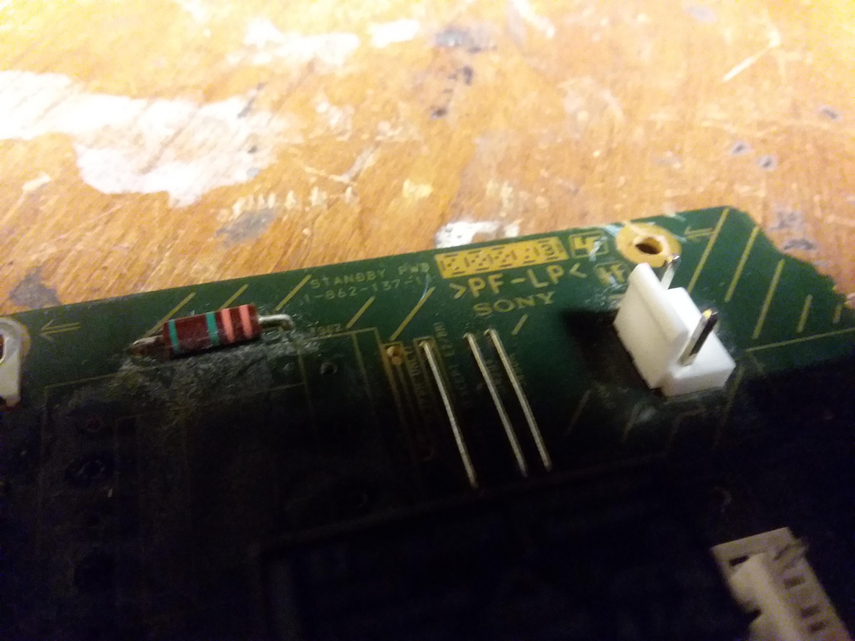

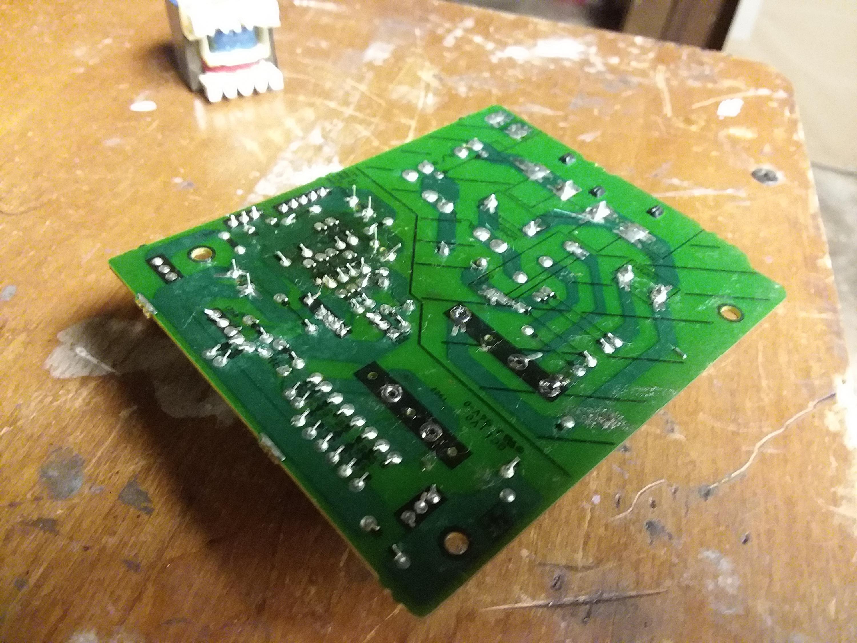

                also look where the windings are wrapped and soldered to the pins - they can break there because it's a weakpoint.

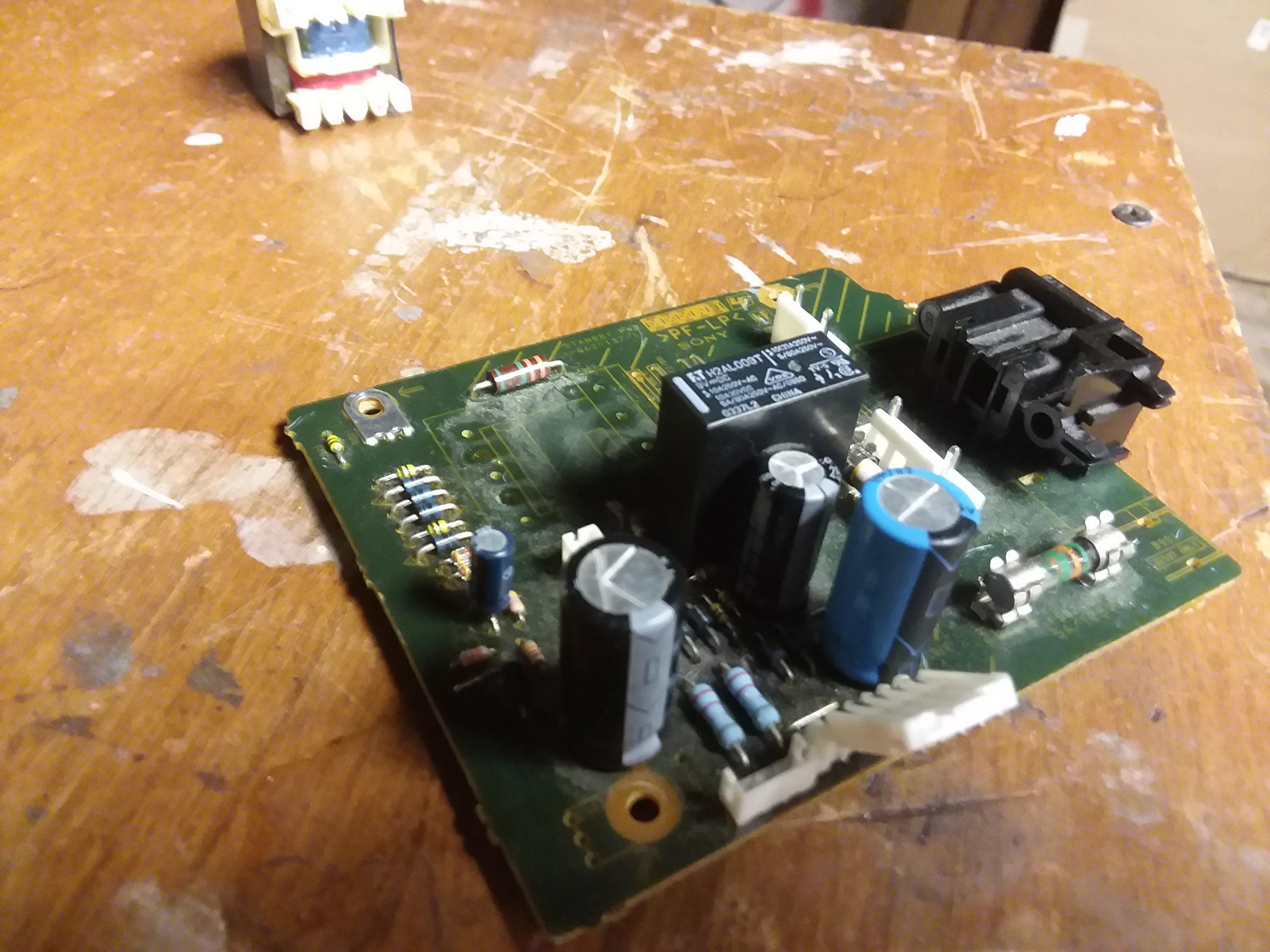

                  Attached is a picture of it. Used the two black for the primary, one red and one green for the secondary. Did I do that right? Tested by itself, output is around 8VAC. Too high? I can see why this should have worked but it didn't!

                    Yes you did it right, the a/c voltage may read a bit higher without any load, once installed it should be ok and the dc voltage should be close to the 9v required.

                      I'm still not getting 9V standby though. Obviously I missed something. I'll keep digging. Thanks for the confirmation, RJ!

                        Is C950 (3300u / 16v) ok? Still no 9V standby even with the digital board disconnected?

                          Like khron said, disconnect CNP903 going to the digital board, If C950 is bad as in open, you should still get some standby voltage, check that there is not a short across C950.

                            SUCCESS! The cap was fine. Apparently a ribbon cable worked itself loose from the a board (digital board?). I started at the power button and worked my way back and there it was. She turns on now. Man, that was fun! Thank you all for the help!
