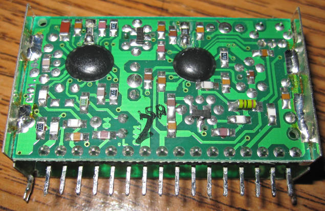

                                    Well, today's debug session was kind of annoying.
                                    I had broken the power output lead in my bench PSU, and was wondering why my radio didn't work at all on my bench. Finally tried shorting the output cable expecting the current to go up... it didn't. Alligator clip wire was found to be broken.
                                    So I needed to resolder. My 100W solder gun is now taking forever to heat up... well, guess what, I need a new tip for it. Grr. Well, I just let it heat up however slowly it does and finally was able to resolder the alligator clip to the wire.
                                    Now my radio powers up on the bench. With the pinout in hand I probed the pins... Glad I have a 300MHz scope (or too lazy to get the frequency counter set up) and confirmed the local oscillator is dead or at least it doesn't trigger the rest of the PLL circuit to work properly. Since the LO is on the COB TEMIC module, debug stops here, need to locate another TEMIC module to repair the radio.
                                    • eccerr0r
                                      Solder Sloth
                                      • Nov 2012
                                      • 8701
                                      Re: Car radio stopped working
                                      COB Hell.
                                      Yes there's more components on the other side, though covered by the shield.
                                        • 31111
                                        pull the shield.
                                        just from that picture i think it may recover just with a good fluxing and a re-heat of each joint.
                                        though from experience with sattelite tuners i would test the semiconductors - they are probably on the edge of there rating
