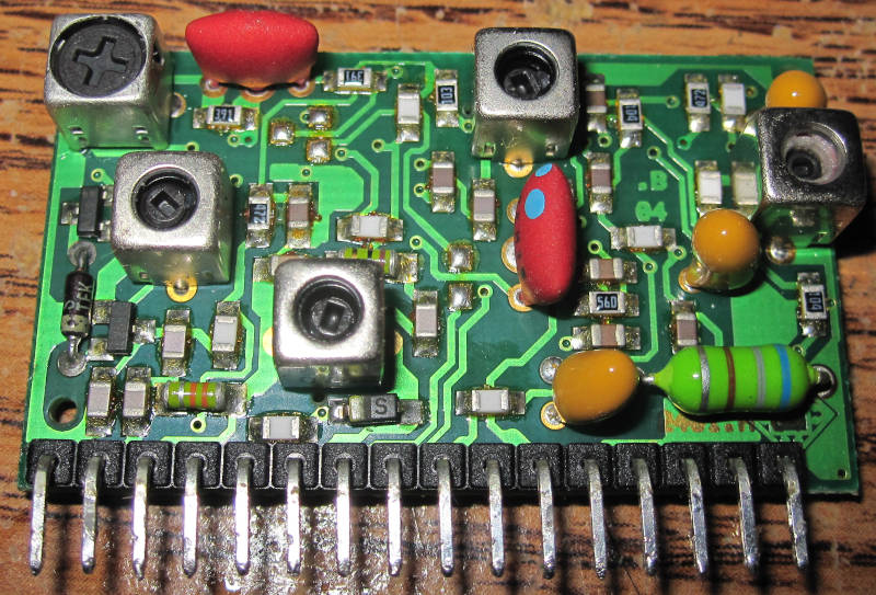

                    #29
                    Re: Car radio stopped working
                    Well after finding the pinout, here we go, shield removed...
                    ... nothing interesting here unfortunately.
                      • 30979
                      #30
                      you can check the diode and tants

                        #31
                        Well... It happened.
                        A few months ago I had the radio teetering on a stack of other crap, and it tipped over. Smashed the volume control and bent the shaft. Unrecoverable failure. Probably parts salvage at this point - maybe a VFD and a rotary encoder, maybe some other stuff.
                        And then today... I was able to locate another TEMIC module in a donor radio of similar vintage... Radio is almost identical except a few years newer. But unfortunately it uses a different volume control, rats. This donor radio had a blown left front channel and the tape player was jammed. Not to mention it doesn't physically fit as it was designed for another vehicle from the same parent company ... which does mean it plugged straight into the car harness.
                        Grr. Should have kept the old radio in a less likely place that would stack smash.
                        Well. I ended up tracing the blown left channel and found a bad resistor. Stuck a jumper resistor across it and...yep that was it, now all four outputs pass power to their speaker (I was almost tempted to swap the front/rear outputs to use the good output to drive the front speaker but having all four outputs working is better.) Tape player looks beyond repair but don't really care too much about it, could always broadcast.
                        Now I just need to make it "fit". Probably need to cut off the OEM "ears" so it would slide in (and slide out... need to figure out a way to make sure that doesn't happen.)
                        Oh well, who would have thought I'd running across another module...and it's all moot now, though I can hear broadcast radio once more on all speakers again (had another jury rigged radio in there but could only drive 2 speakers with it and didn't have a clock...that annoyed me.)
