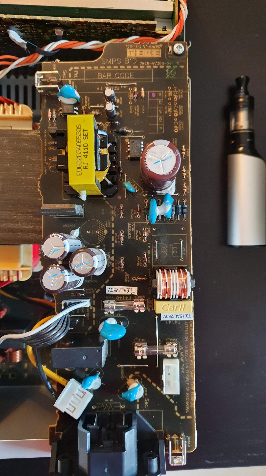

    Hello
    Ive got an NR-1504 which has no power the fuses check oke.
    Also Changed out IC4140 (TOP264MG) also all the diodes checkout oke

    Re: Marantz NR-1504 No power
    Also ive got no 5V from the smps board to the hdmi board

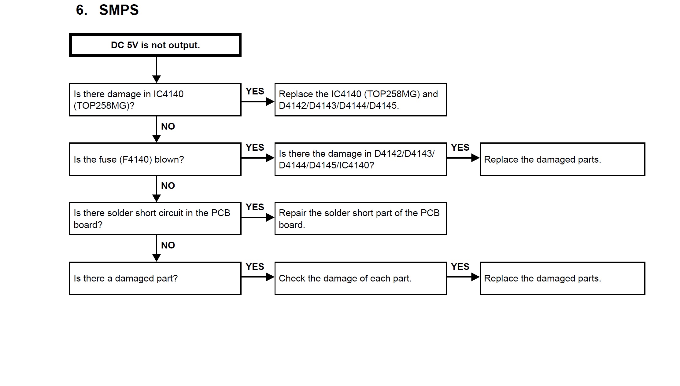

      So what Voltages do you have on each pin of the TOP258 SMPS IC? BTW, what is the history with this receiver?
      Can you also upload the full service manual?
        Hello Budm
        This receiver always worked perfect and suddenly stopped working,
        Pin 1 = 2.86VDC
        Pin 2 = 1,46VDC
        Pin 3 = 5.4 VDC
        Pin 5 = 313VDC
        https://www.manualslib.com/download/...r1504-U1b.html

          OK, based on the schematic on your post #1, you need to check the Voltage between the Gate and the Source pin of MOSFET TR4140 (KMB2D0N60SA), it should be >1.5V to turn on that MOSFET, that section of circuit is for monitoring AC line Voltage, if the line Voltage is too low it will shutdown the TOP258.
