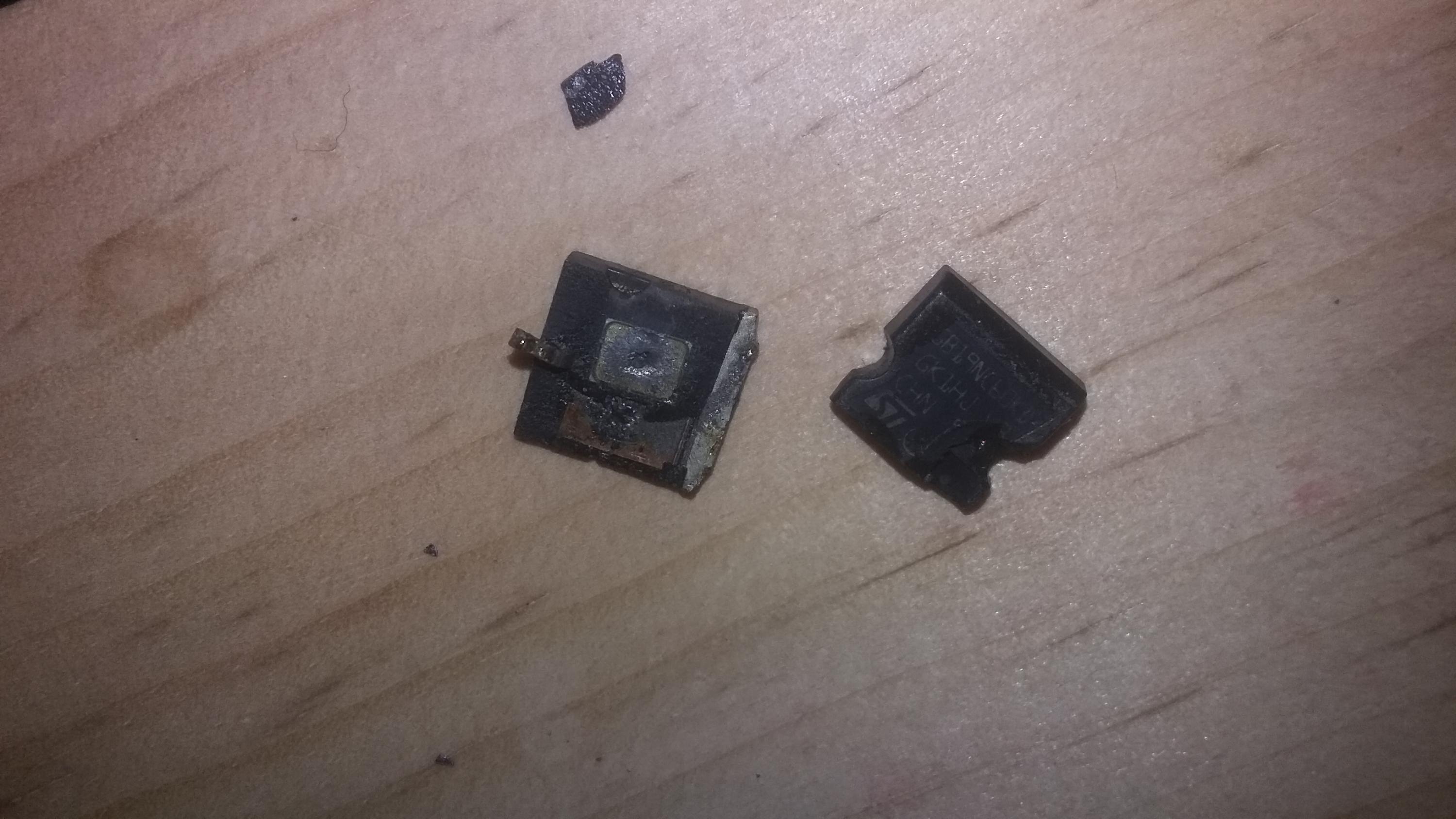

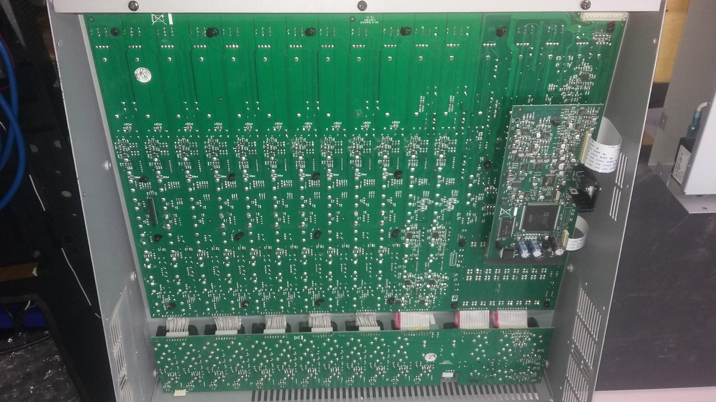

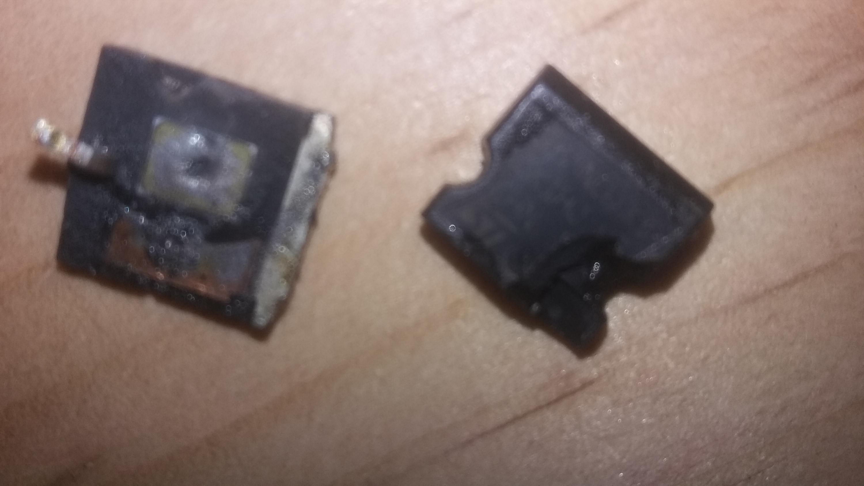

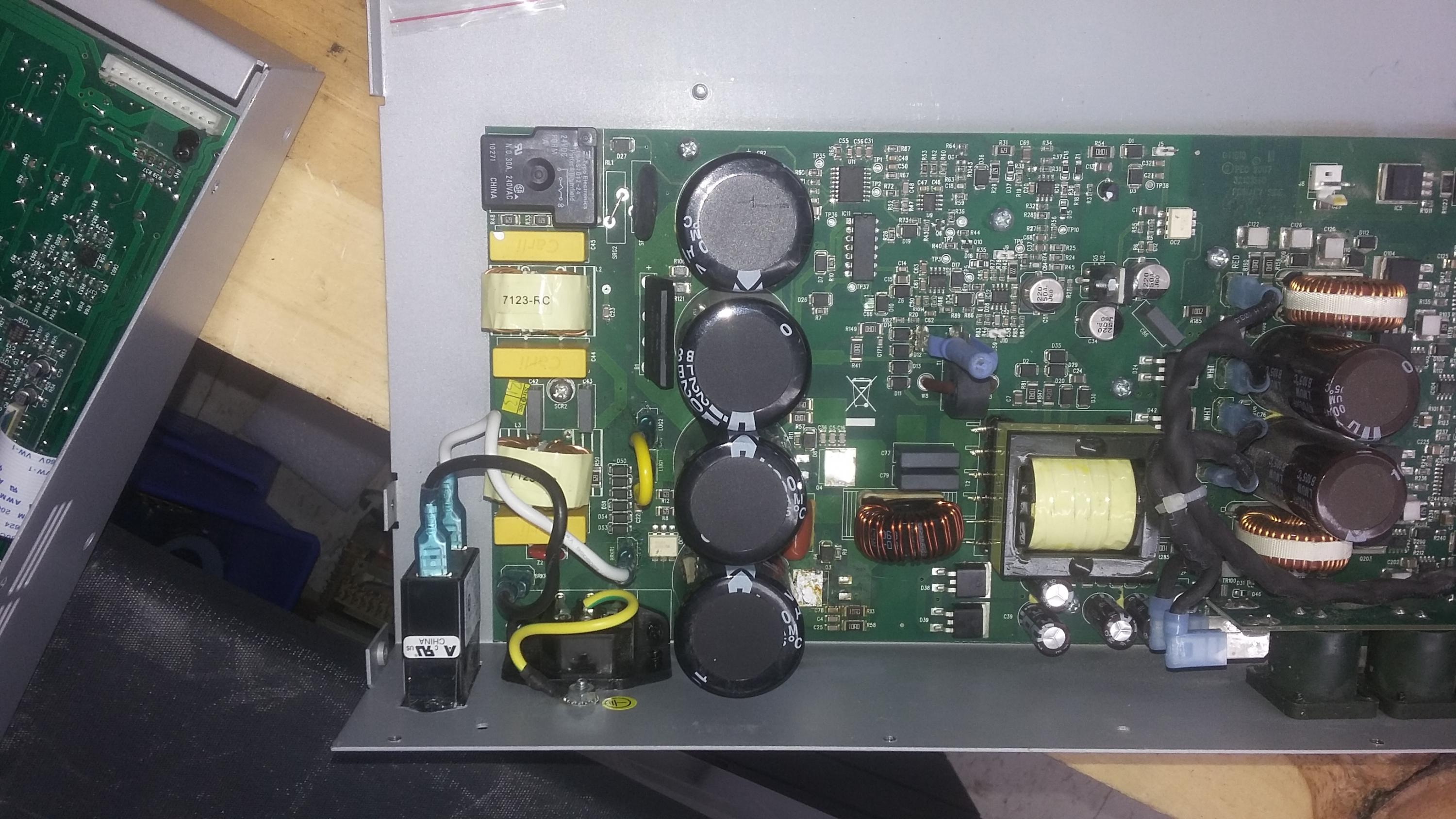

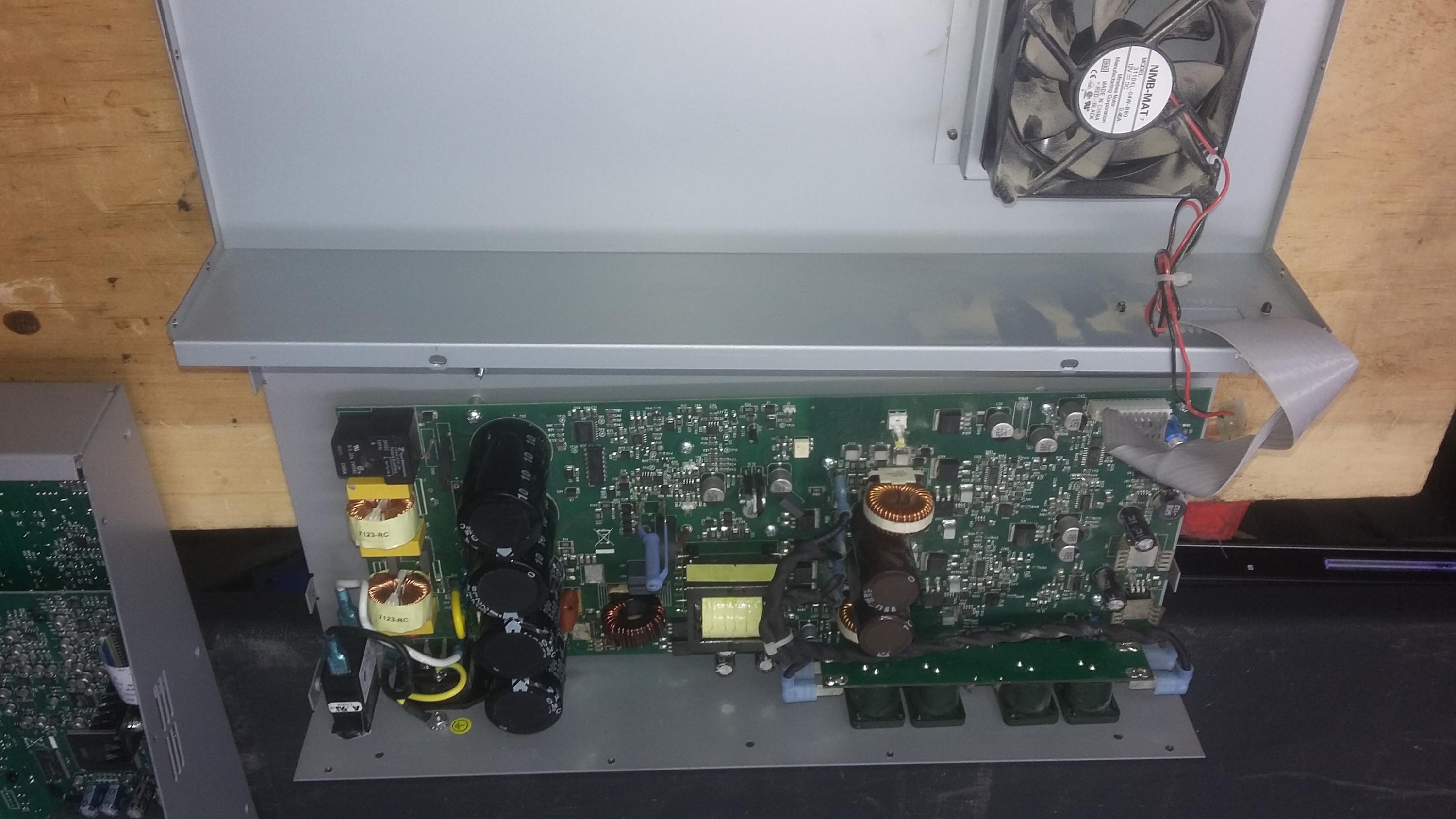

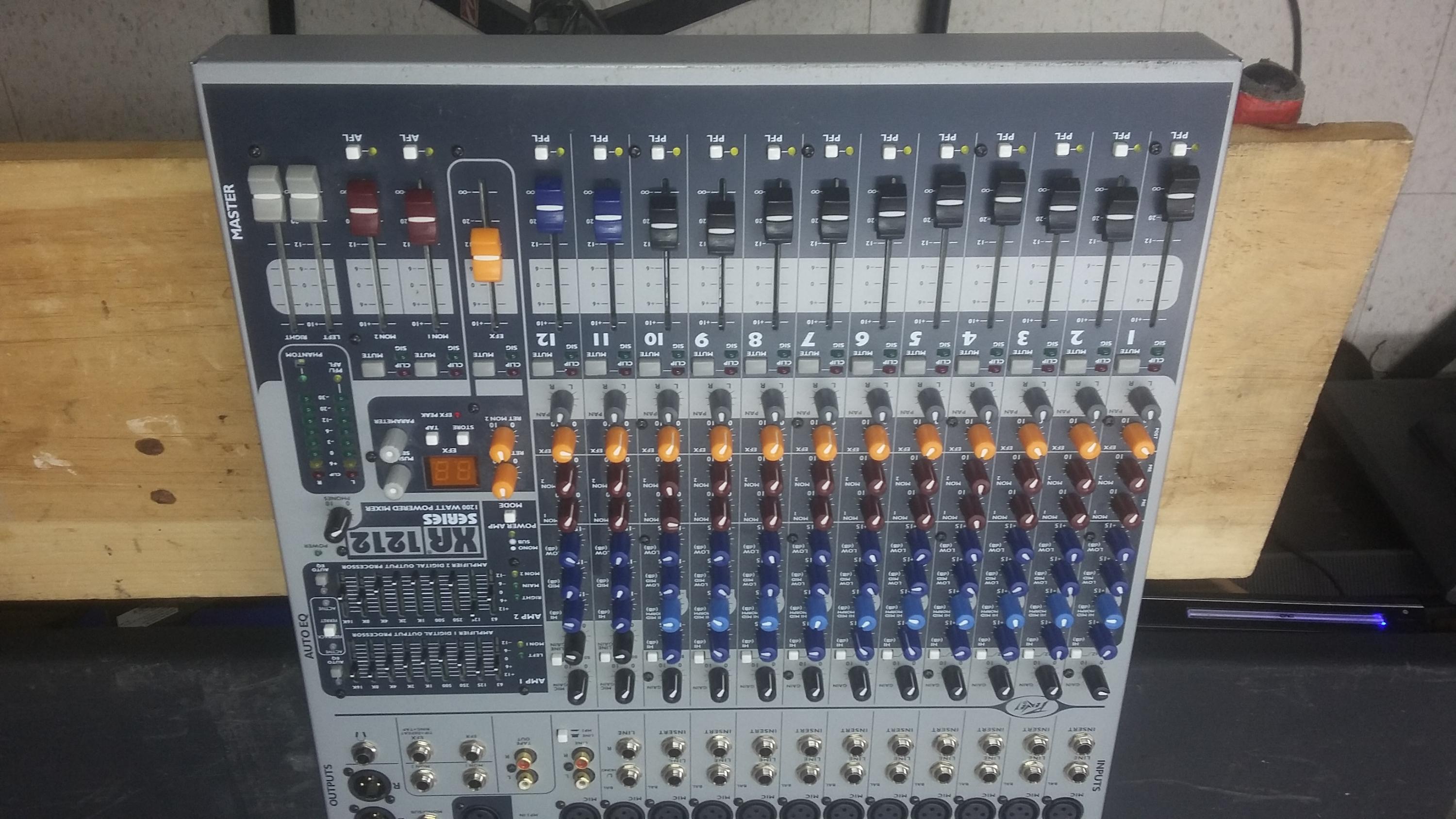

    hi guy's im looking for a service manual for this peavey xr1212 mixer....
    i have 2 parts that are burn and would like to replace them but cannot see info on them.....location is q3 and q4
    so basicly,when client brought me this mixer,he have already took out these 2 parts....and what he told me is that the mixer have power but no light or disply,ect...but that the powerboard come very hot and start smelling like burning.....
    so i kind of need these parts to make further test.any help would be very nice.thank you

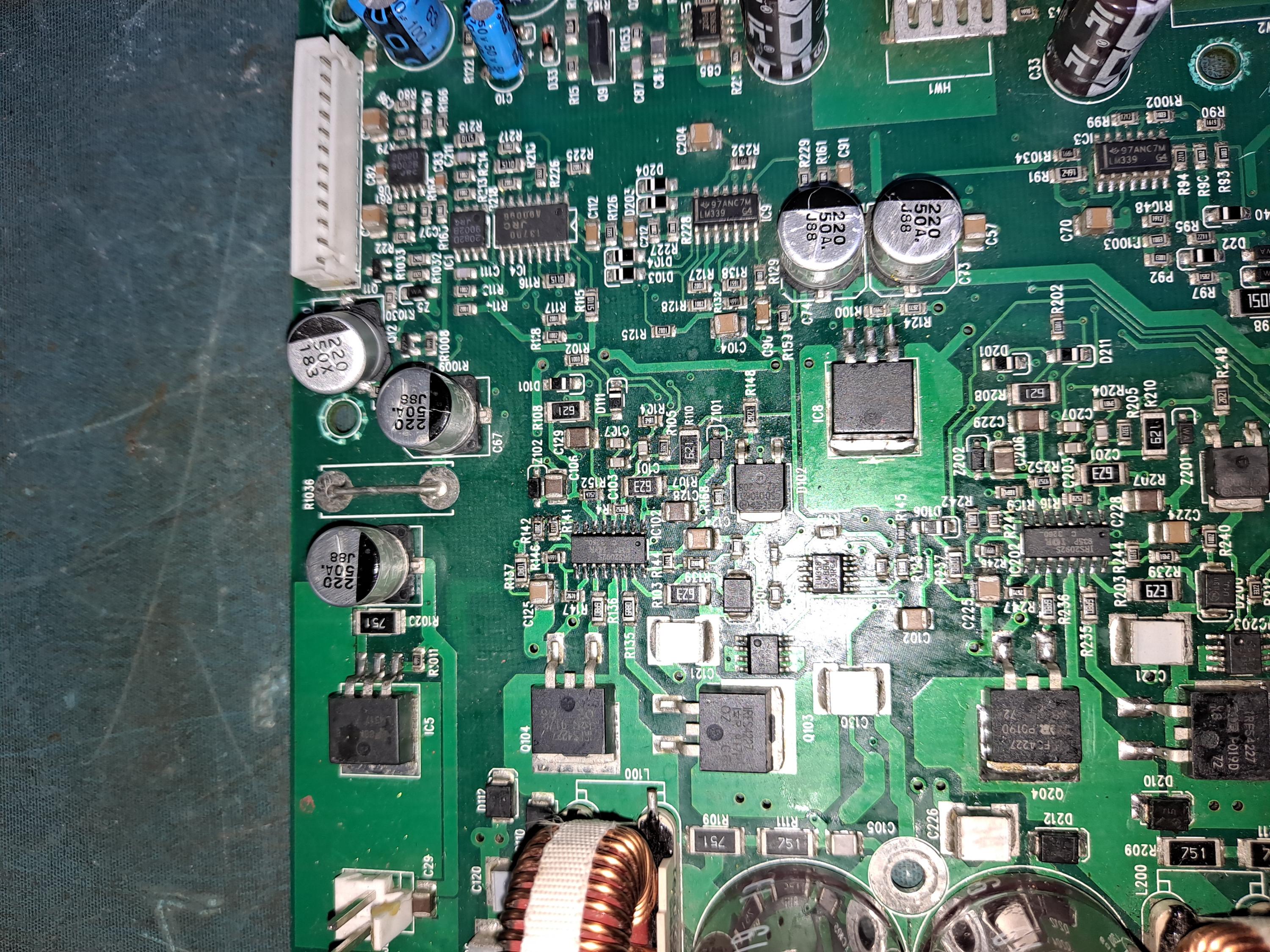

        Well from picture 9 -gb19nc60kd
        • R_J
          • Jun 2012
          • 9517
          Re: peavey xr1212
          If these two fets are blown, I suspect the driver ic is also blown, check the resistors connected to the gate and follow them back to the drive circuit. I suspect there are more issues, hopefully Peavey will provide the schematics

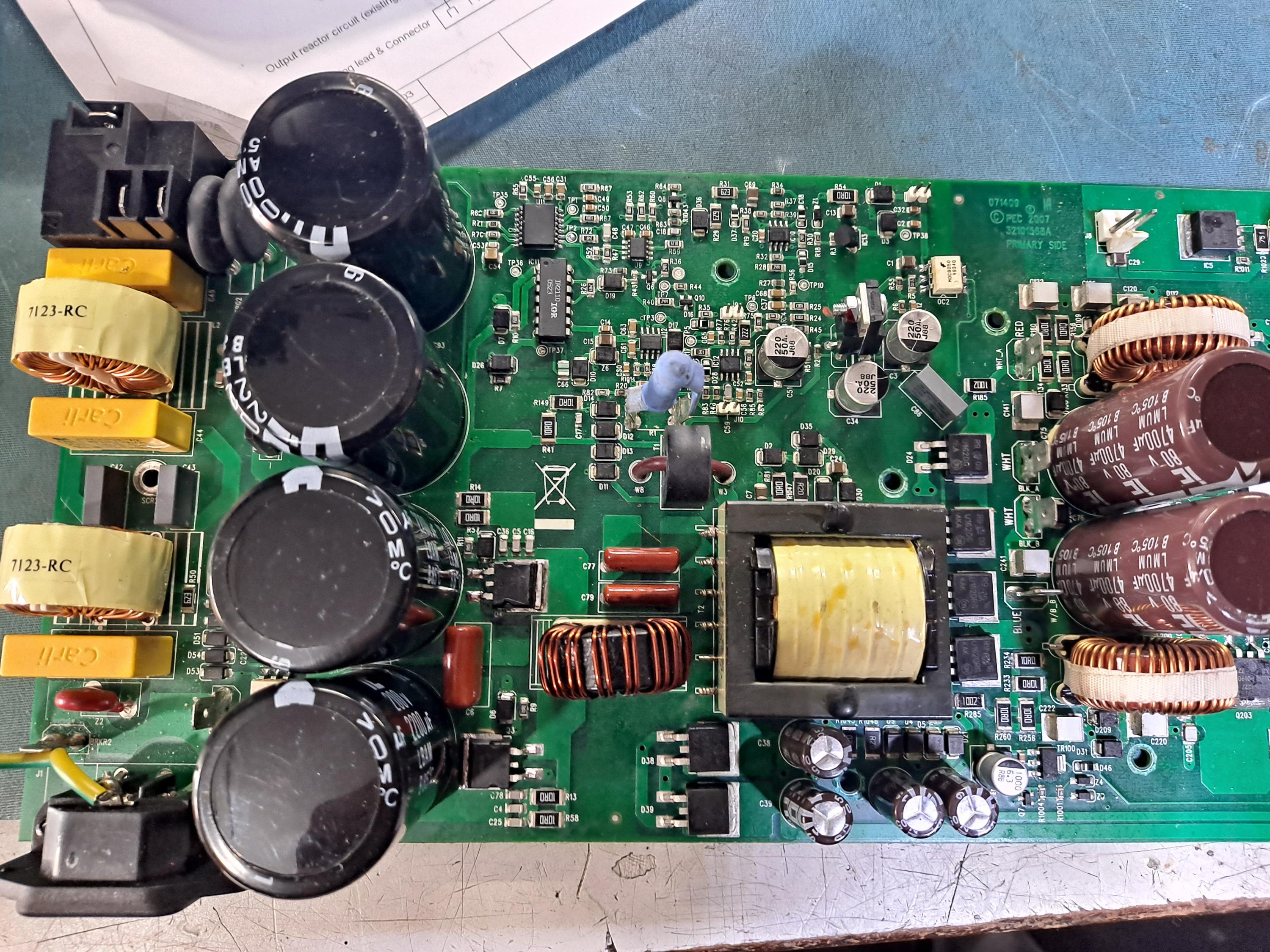

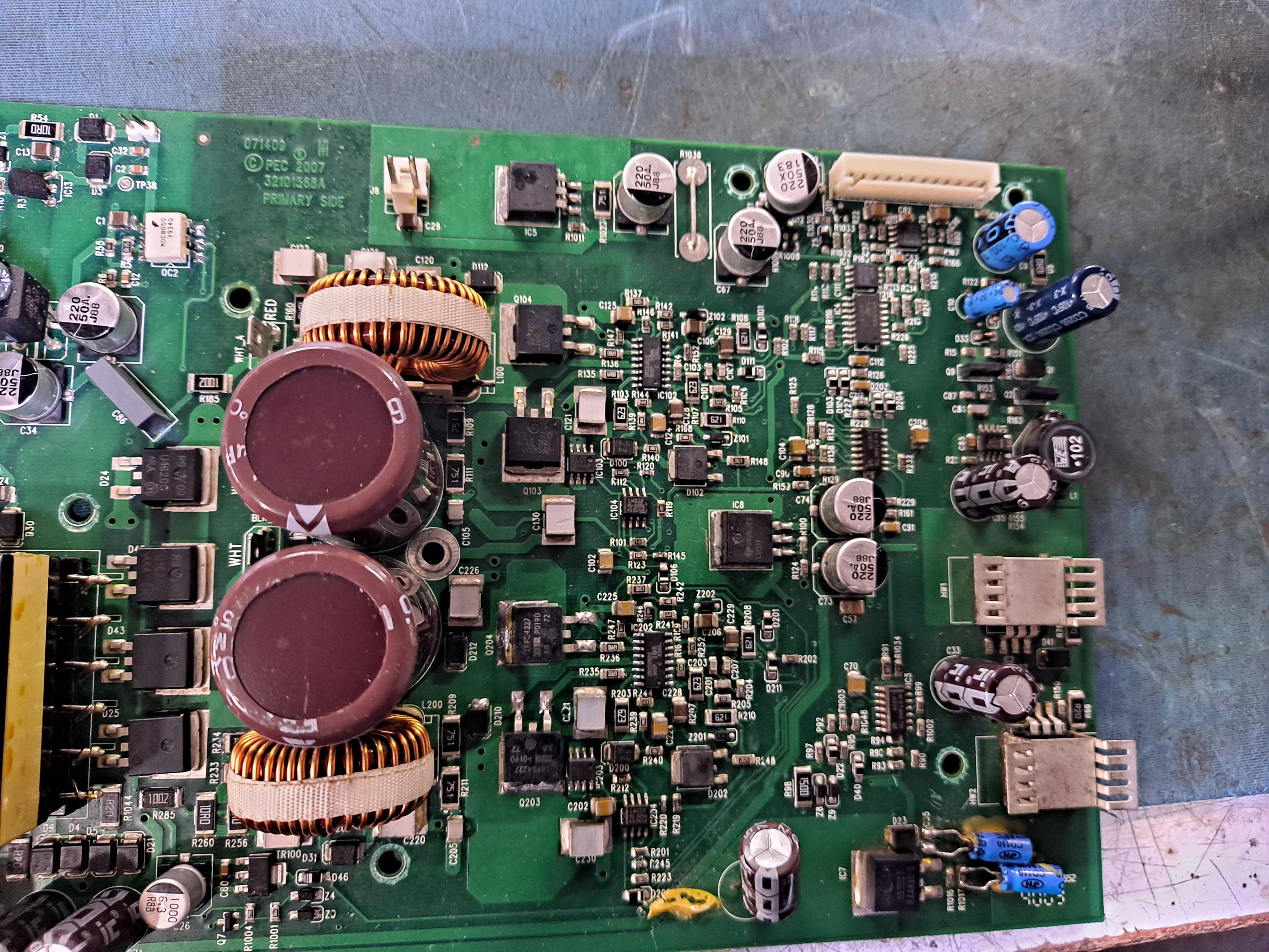

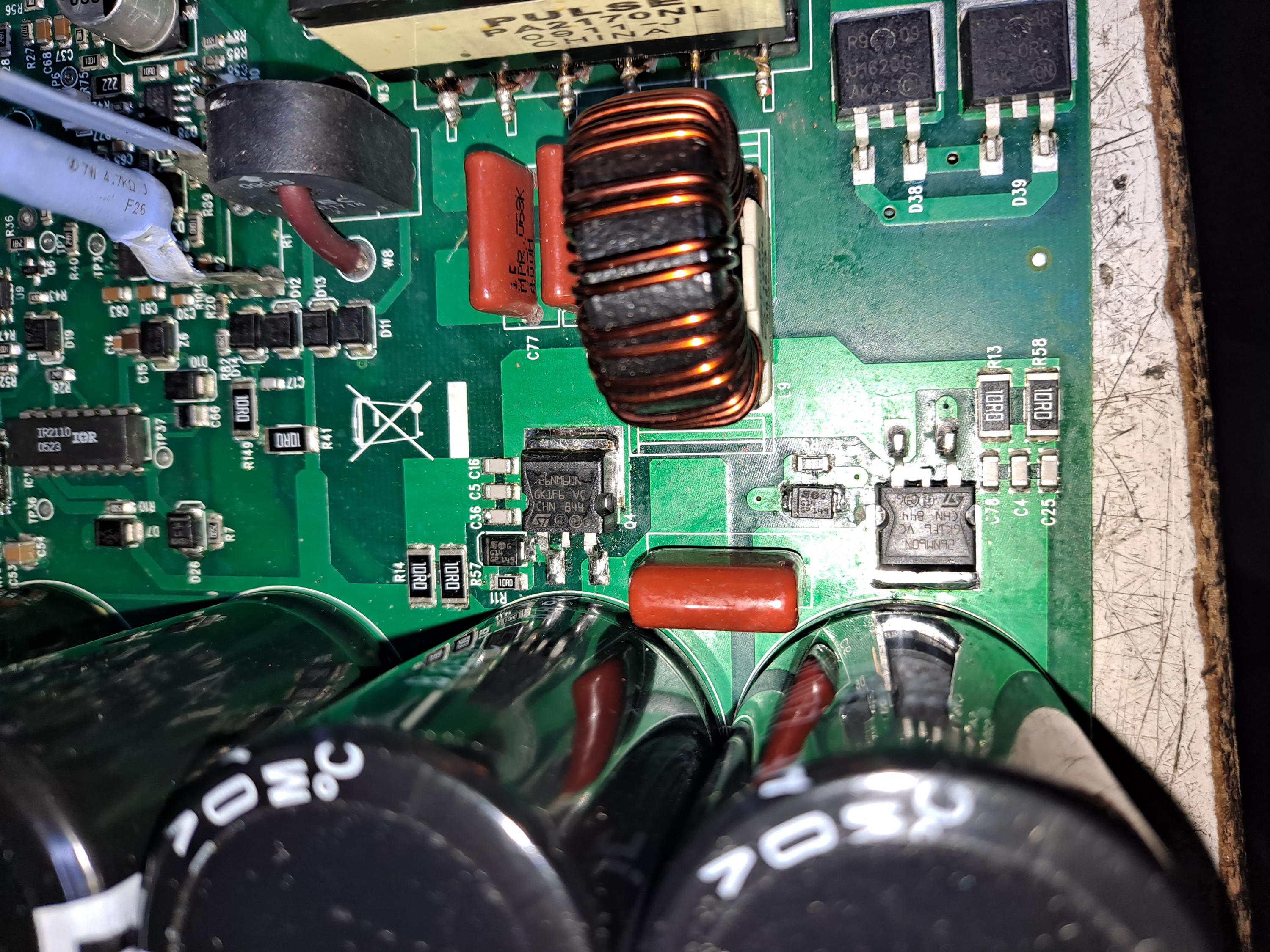

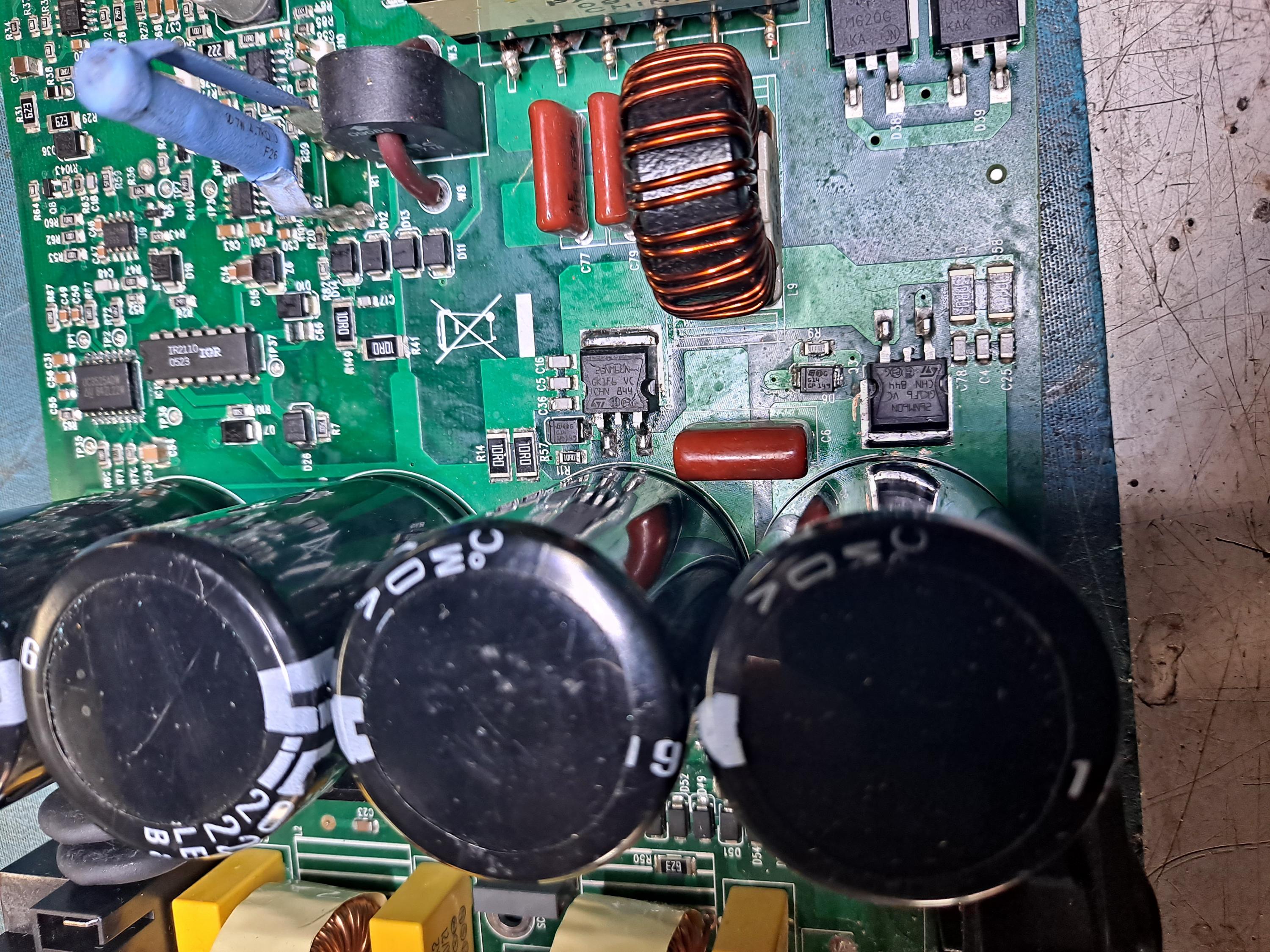

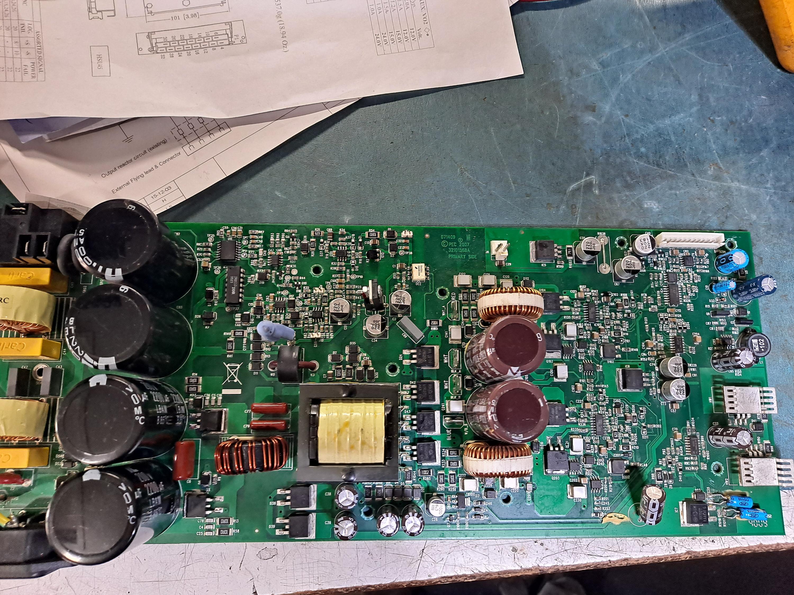

                          Hi, hope the pic will be useful for you, I had same problem blown mosfet, the part number is 26NM60N. the SMD diod marking is 14G.
                          • jo75
                            • Aug 2021
                            • 2
                            • England
                            Re: peavey xr1212
                            attached pictures
                            • check12
                              • Nov 2012
                              • 103
                              Re: peavey xr1212

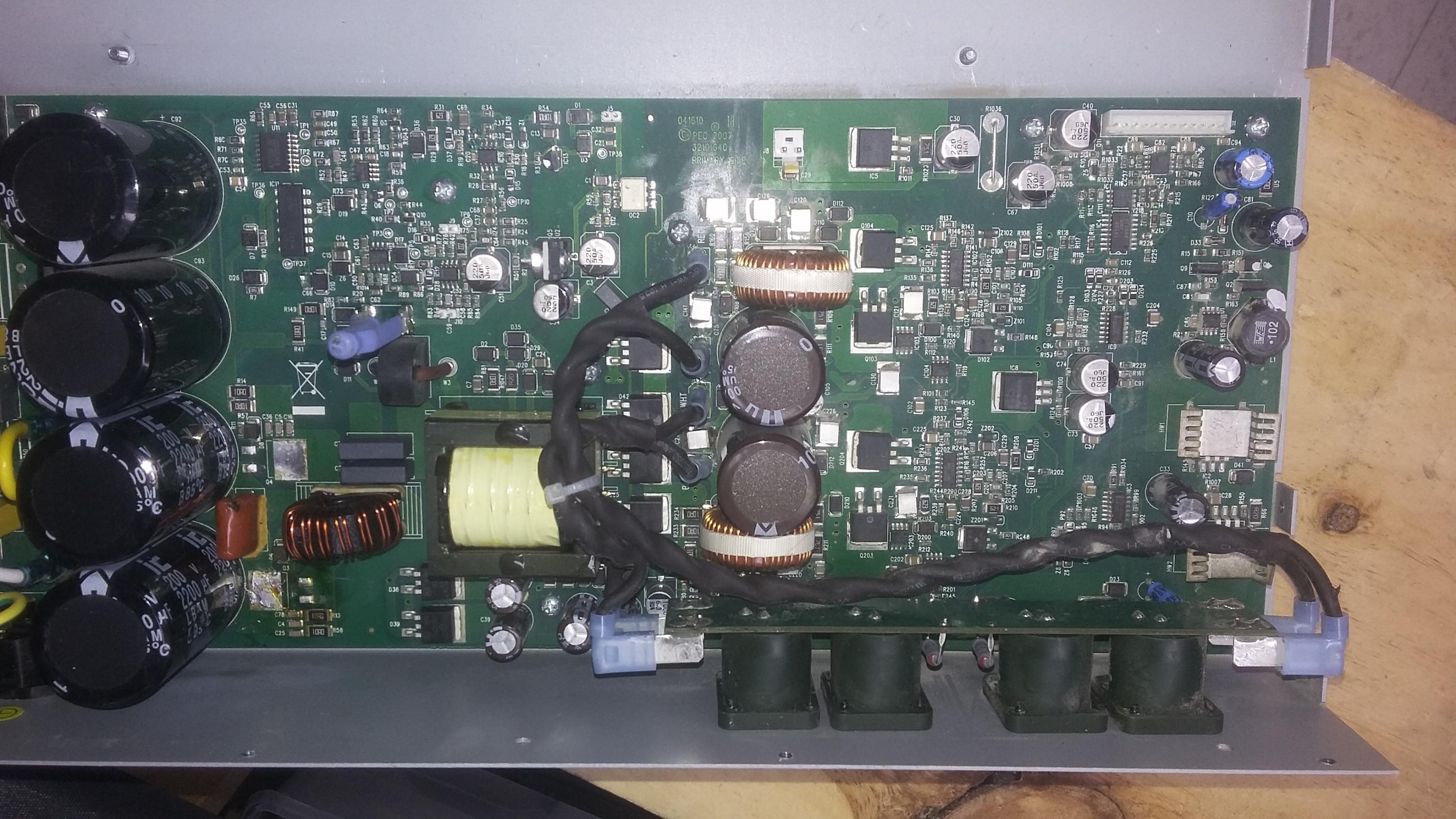

                              Interesting ... that mixer uses the same amplifier board as the Peavey IPR1600 power amp ...
                              The original 2x components were IGBT's but several other fets can be used to replace.
                              Be a good idea to remove the amplifier side power fets and check them or you may blow the new PSU fets again on 1st power up.

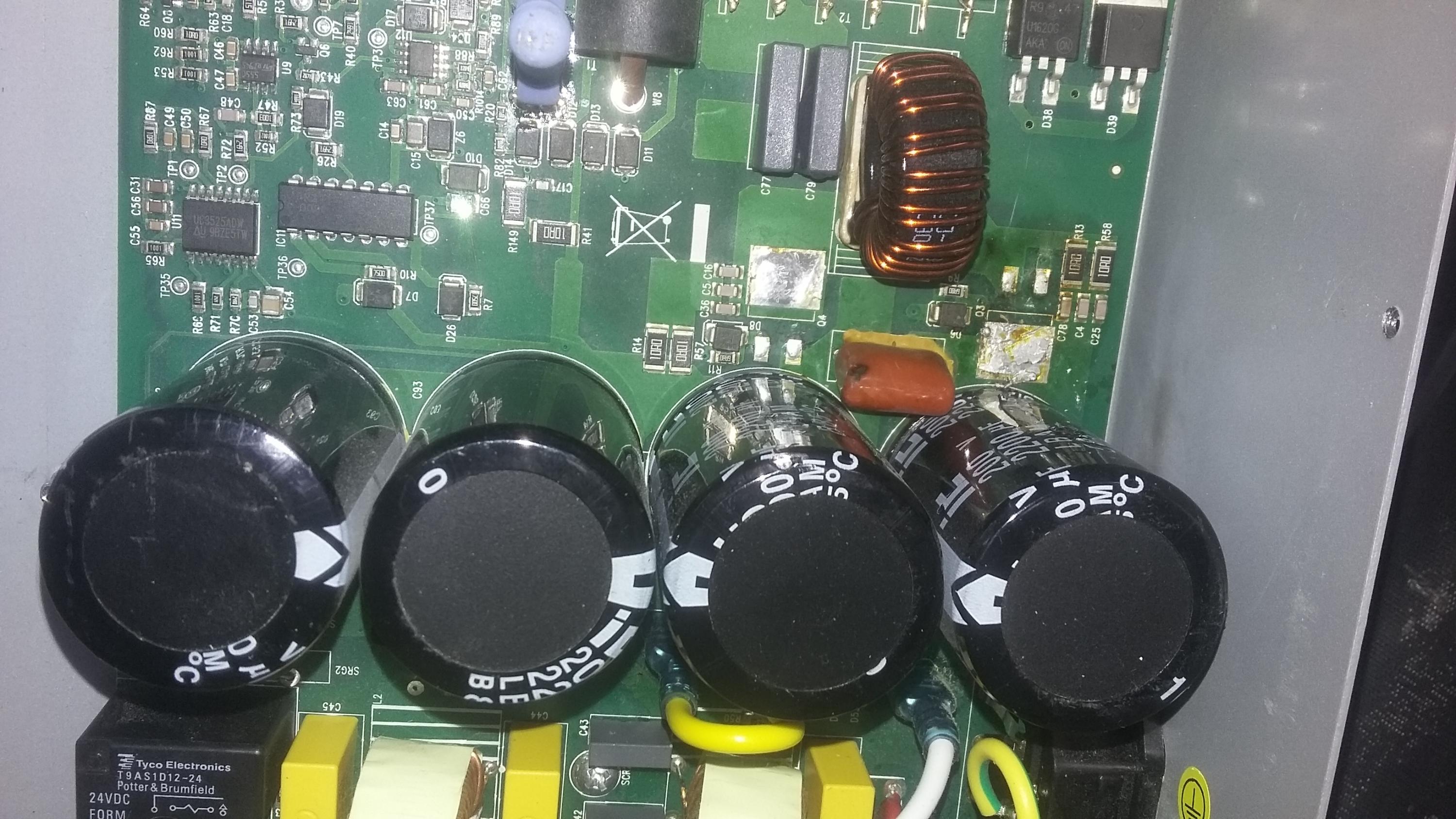

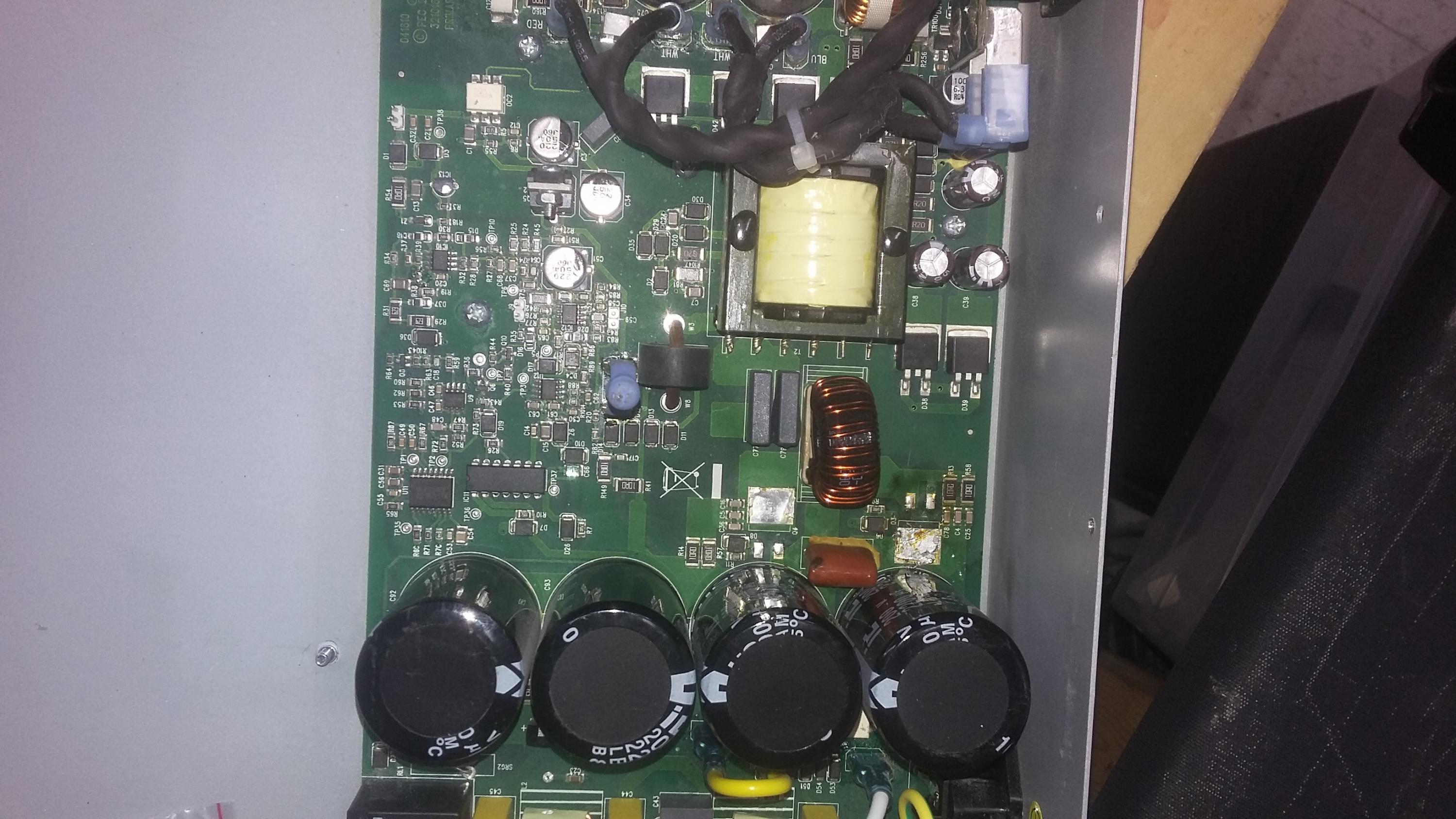

                                  I have several Peavey XR1212's in my possession, and have built up a reasonable degree of expertise in diagnosing, localising and repairing the main power boards.
                                  Being SMD they are not easy to work on, and require a fair bit of dexterity with a soldering iron/heat gun! Not sure whaat solder was originall used, but it has a VERY high melting point!
                                  Interestingly, I have had issues identical to those described here, with regard to Q3 and Q4 giving up in spectacular fashion. They do appear to be a point of weakness on this board.
                                  I am about to replace these, so will post back in due course.

                                    The same main board is used in the XR8600D (not XR8600) as far as I can tell.
