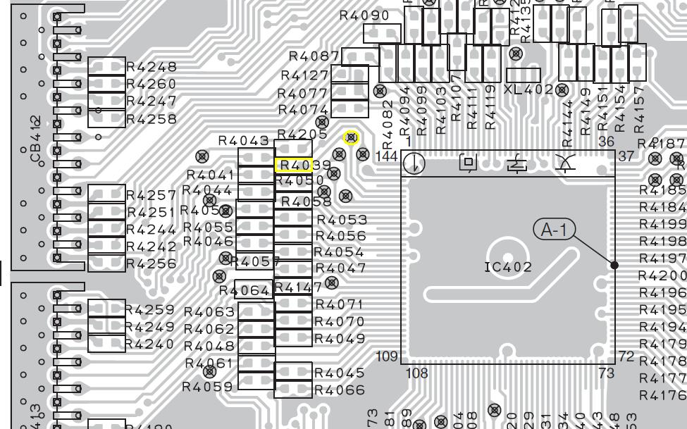

                Check the voltage on CB18 pin 3 (PRVS) [page 154 of manual] it should be 2.8~3.2v
                If you look at page 114, locate IC402, to the left is R4039, check the voltage on each side, it should have 1.1v on the test point.
                This is the line that is triggering the PS3 error, so maybe there is a poor connection somewhere between the power supply and the micro.
                  Thank you very much for the next tip, very much appreciate you taking the time to help out. I will get this checked today and report back
                  Thanks heaps!!!!
