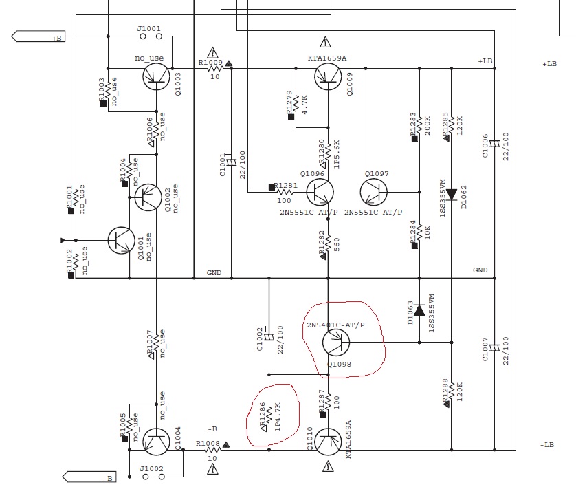

    HI, i wonder i someone can guide me with my yamaha receiver, i test almost everything that i found on the net, im run out of option, i have in all the channel -7v and just the right front -5.2v, i check and i have randomly 6 and 8 v from the signal AMP_OLV, all the power supply signal are ok, sometines i have goog voltages on the +B and -B but now a have 70v and -55v.
    Thanks for the help

      i found something on the right channel, the resistor R1111 3 point 22ohm x2 just one side was ok, and the diode D1028 was open/Bad.
      i will check changing this .

        check the output transistors .
        am guessing the resistors are 2x 0.22 ohms

          yes. one of the 0.22 ohms resistor fail, i already change and the diode but burn the transistors on the right channel .

            I suspect the problem is in the -LB signal because R1287 and Q1098 are extremely hot but they work, also the signal shorting the double resistor is the positive transistor Q1048P which is connected to the -LB_R

              This 2 components are hot even if i isolate the amp side , Its that normal?
