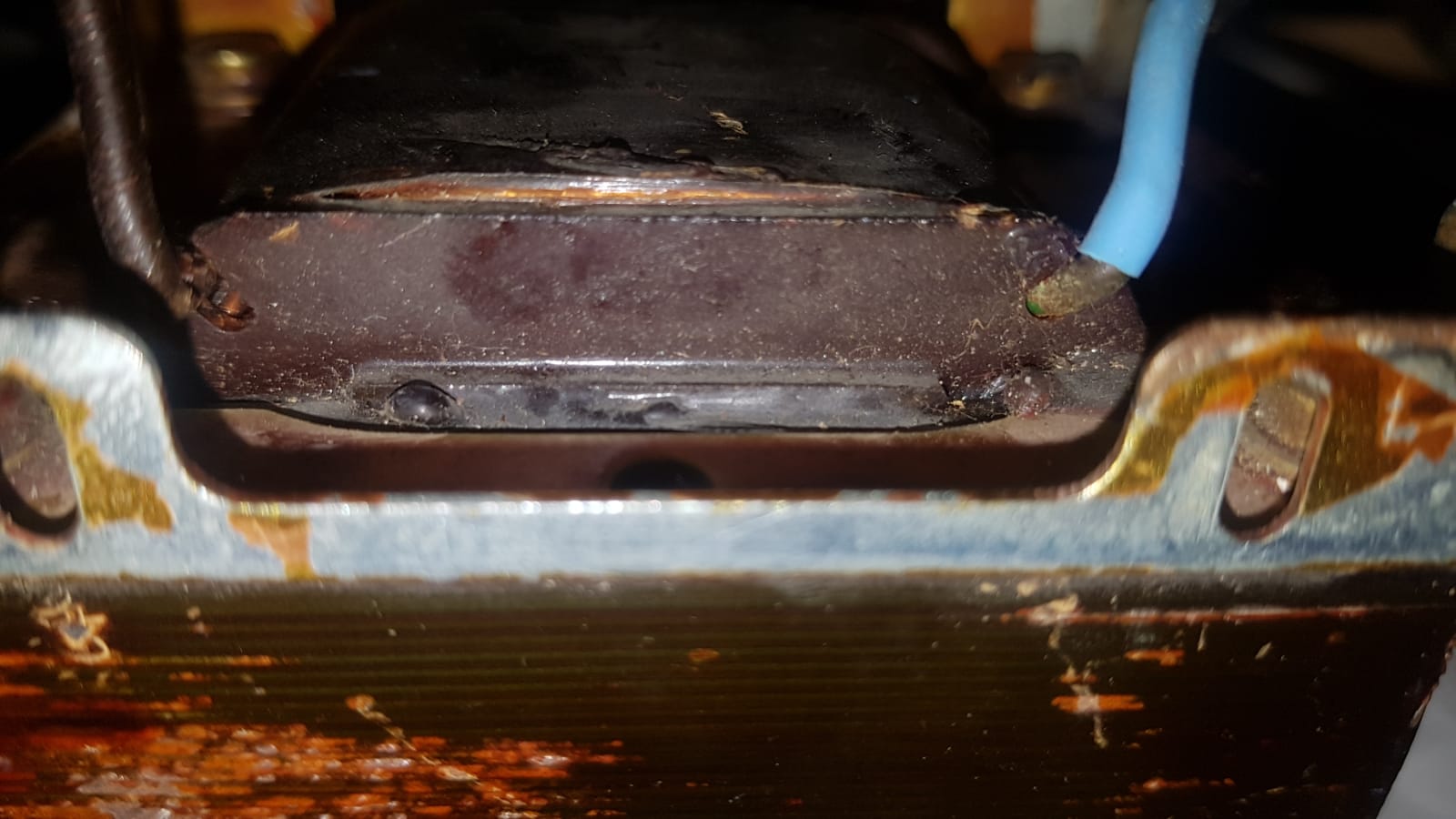

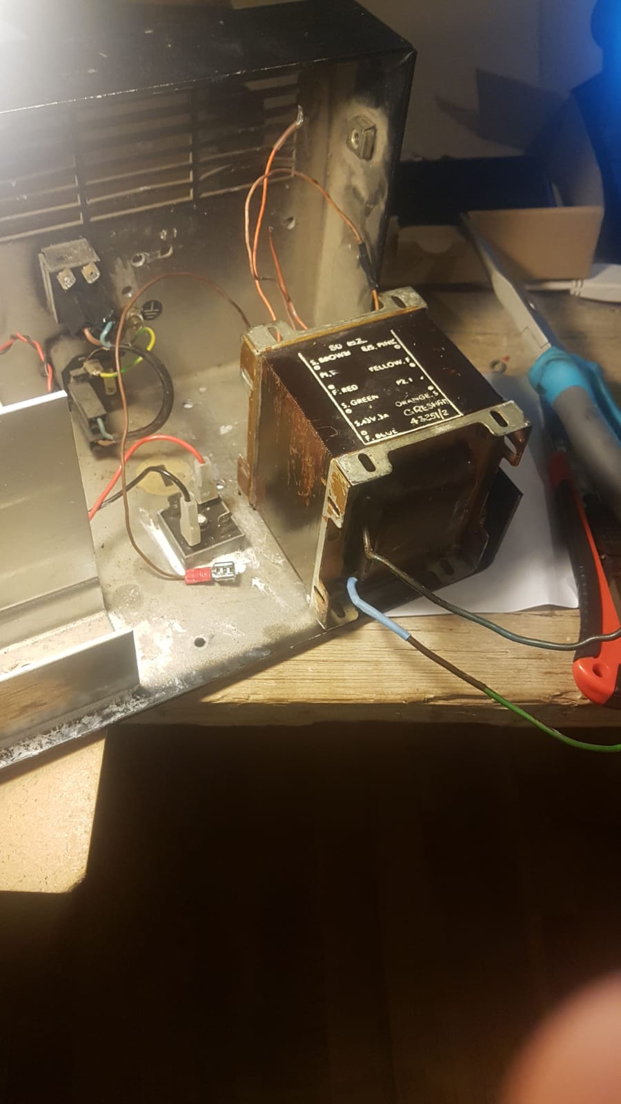

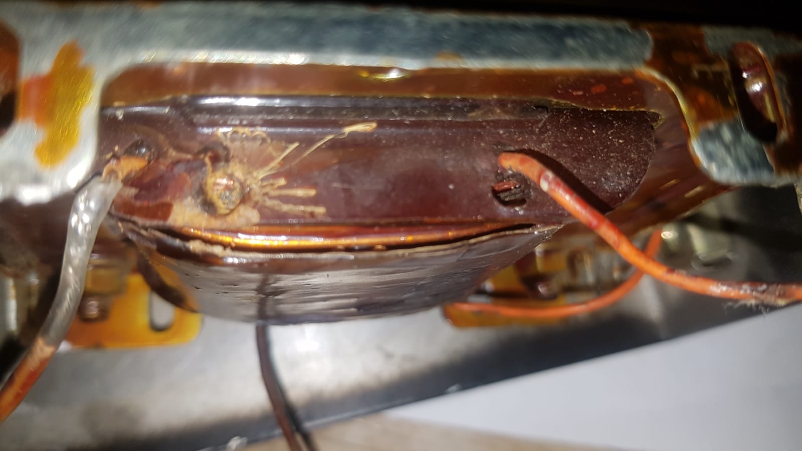

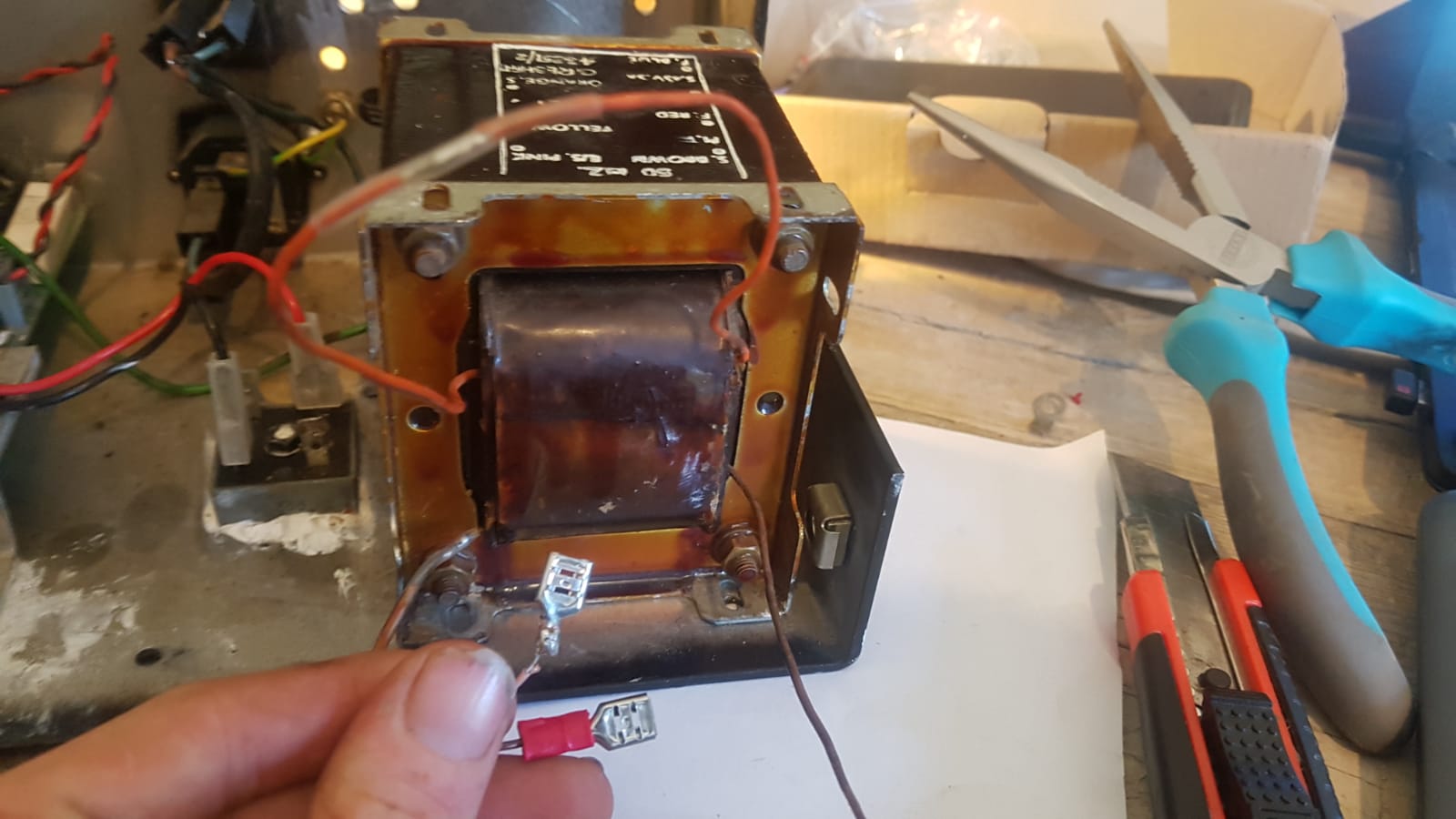

          Re: Broken transformer on Carlsbro GRX7

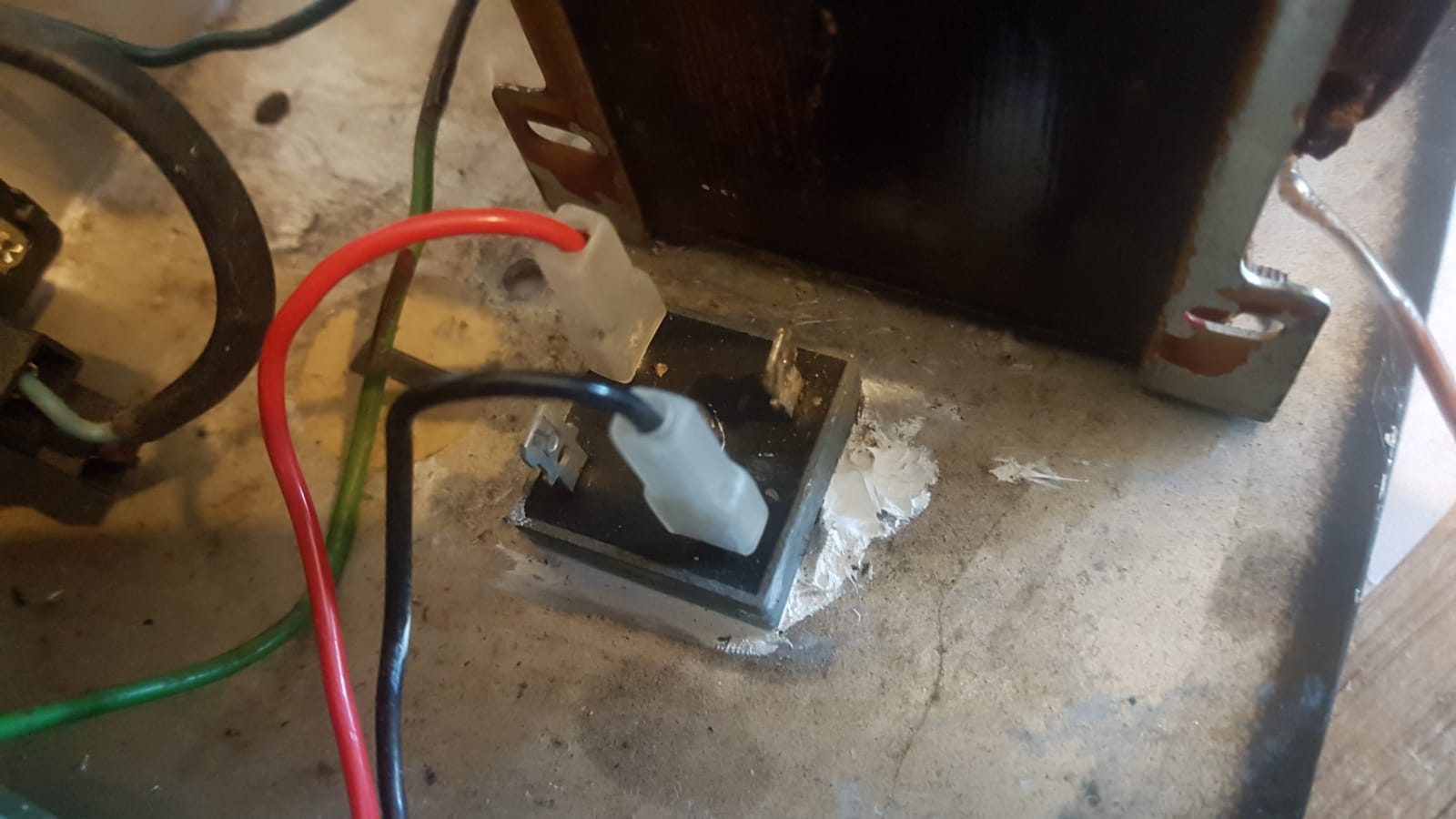

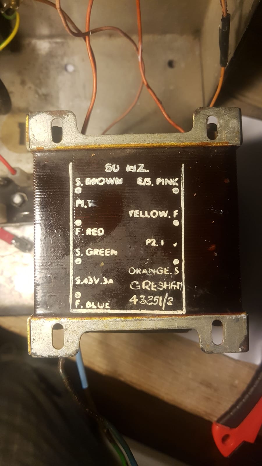

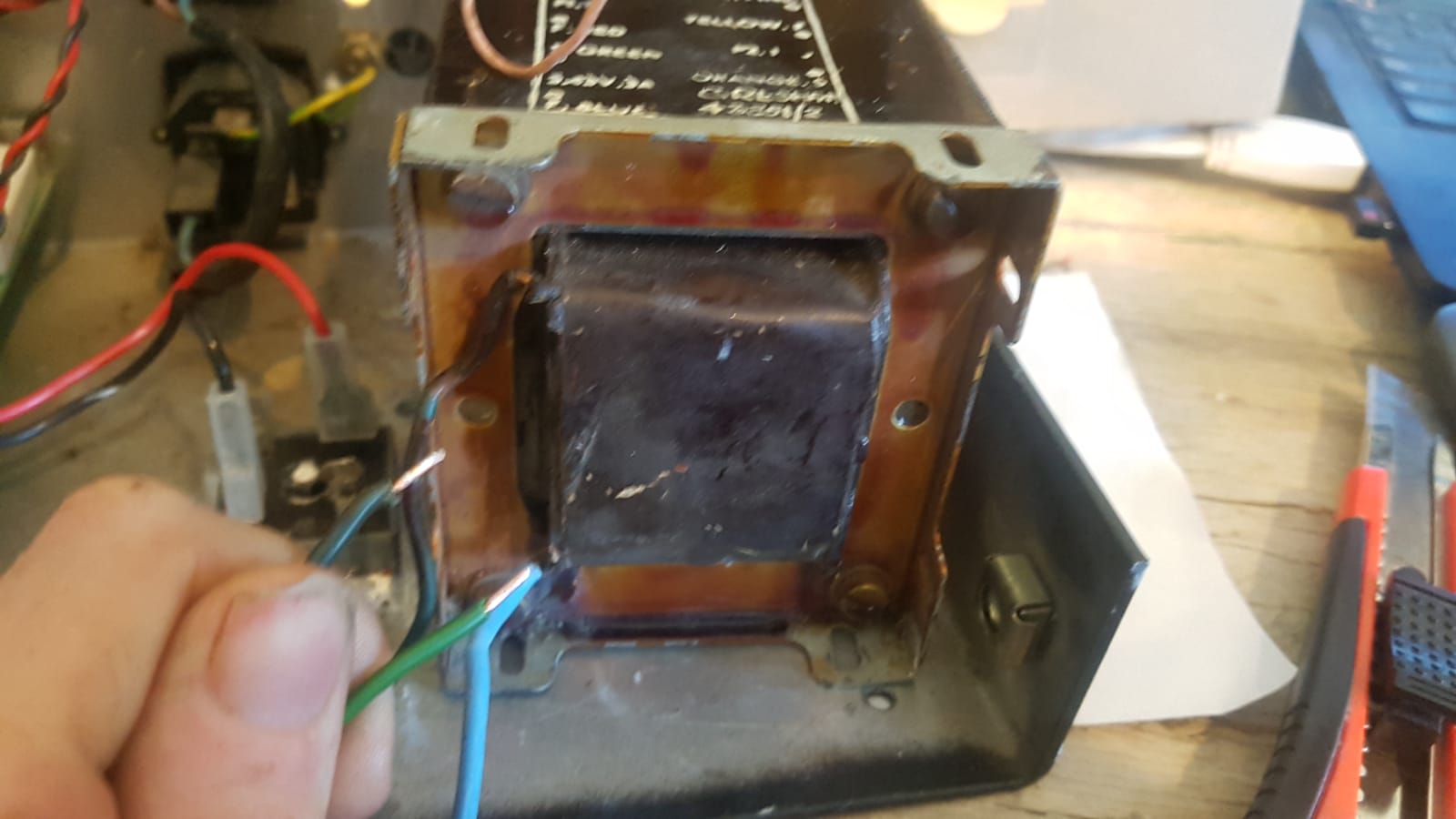

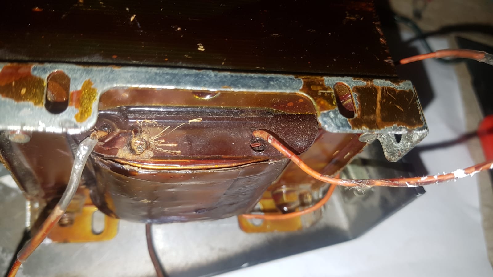

          here are some pictures, were i show both sides of the the transformer, on one side, the one with 2 windings there is a small misterios hole, the board has a 2 terminals, tagged with +V and -V but there is no GND terminal or tag, so I think it is just a single rail and the -V is just the ground.
          Thanks for you quick responses

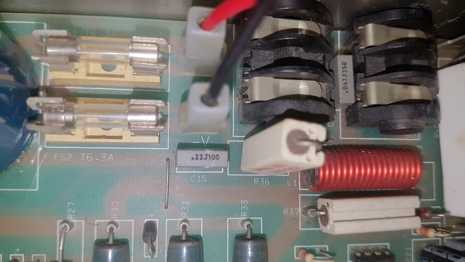

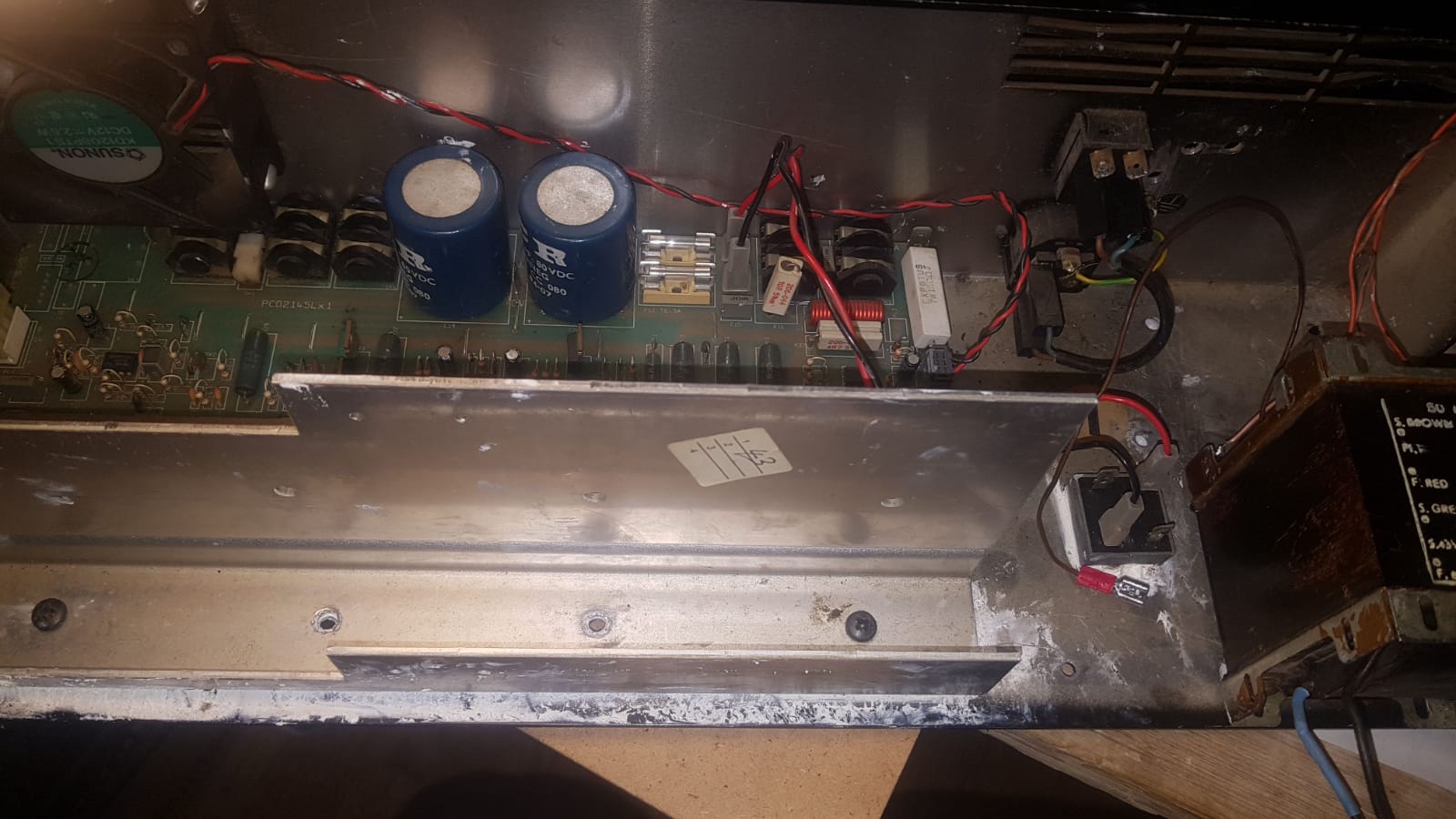

            The pictures are closeups but don't show the complete unit, Picture 4 shows 2 fuses, why would they put a fuse in the ground line?
            I see part of a large capacitor, is there only one or are there two?
              you are right, it is a +/- supply, there are 2 big caps and i just found the GND terminal in in between them!
              But still one of the windings that is on the side where there is 2 is open circuited.
              Also the DCR mesures 0.6 ohms on the single winding side, and 3.6 on the other winding. that makes me think that i have it the right way round. because there the VAC will be lower on the secondary therefor there will be less turns and les DCR. Right?
              And despite all of that, when i connected it up and it blew the fuse, there was nothing connected to the other side of the transformer so there should be only a very small current not enough to blow a 8 amp fuse. but some how i got to find out the VAC out put to order a new one.
              one clue i have is that them big caps are rated at 80V, but that doesn't really help much dose it

                There is sticker on the top of the transformer, can we see straight shots of that label?
                BTW, I see two wires (Blue and Brown) on one side of the transformer :
                https://www.badcaps.net/forum/attach...1&d=1557945236,
                https://www.badcaps.net/forum/attach...5&d=1557945236
                if they stick with wire color codes then Blue will be neutral and Brown will be Hot (Phase).
                On the other side of the transformer I see 4 wires: Brown, brown, orange, orange.
                So I do not see 4 wires for the Hot side in your pictures.
                  here are some more photos, so there is a blue and green one on the side with one winding

                      Do you have 7 wires on that transformer? can you ohm out the windindings to match the colors? does one winding have 3 wires by chance?
                      I also see two large capacitors, Usually one is for the positive supply and one is for the negative supply, they will have a common point which is ground. usually the transformer has a center taped secondary where two wires go to the ~ & ~ on the bridge rectifier and the center tap of the winding goes to ground.

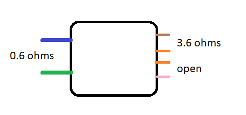

                        There seems to be no sing of the center tap on the transformer, you're right about there being a ground terminal in between the 2 caps. Maybe the center tap wire has broken off in side, behind one of the other ones... but I can't see anything behind them
                        Here's a drawing I just done if it helps
                        the orange ones were connected together when I got it.
                            pic 2 post 5 should clear it up .spades go to bridge .

                              I would guess blue and green are the secondary 43 volts, Brown and pink 240vac with the orange and (yellow/red???) connected together. and now the winding between the pink and orange is open. You could supply 120vac to brown and orange to see if you get 43vac for the secondary
