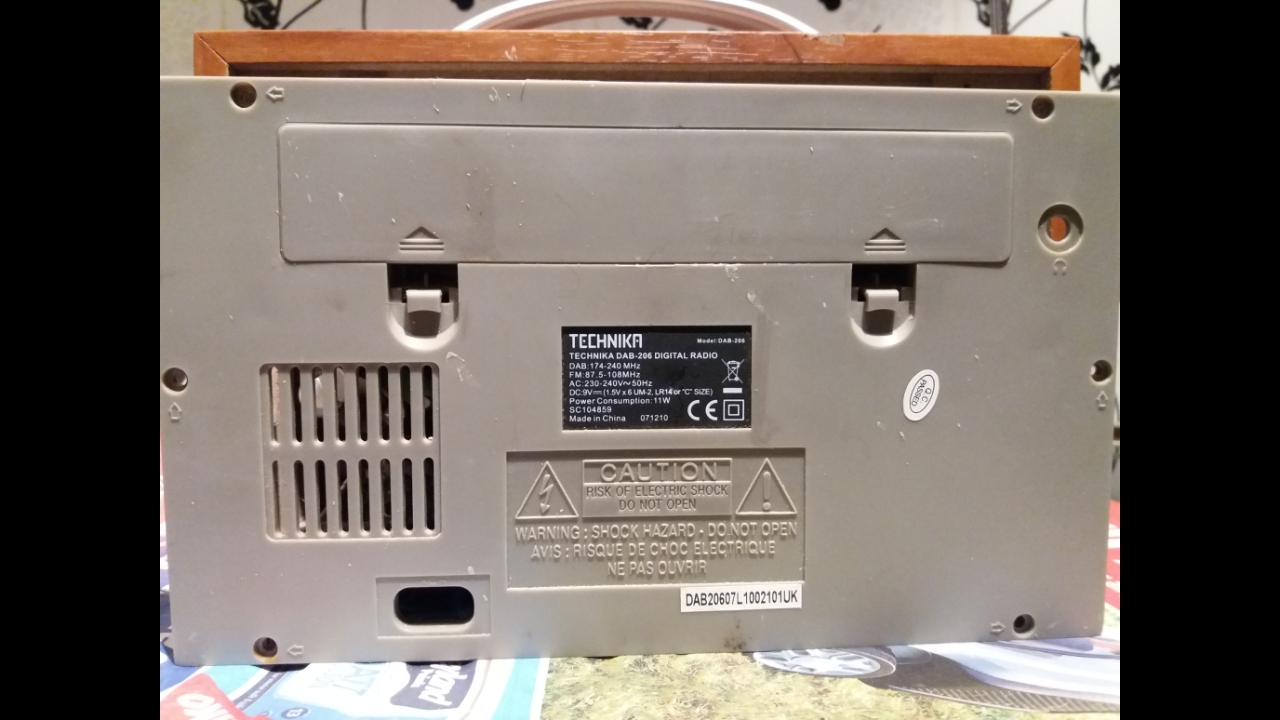

          Casing shell

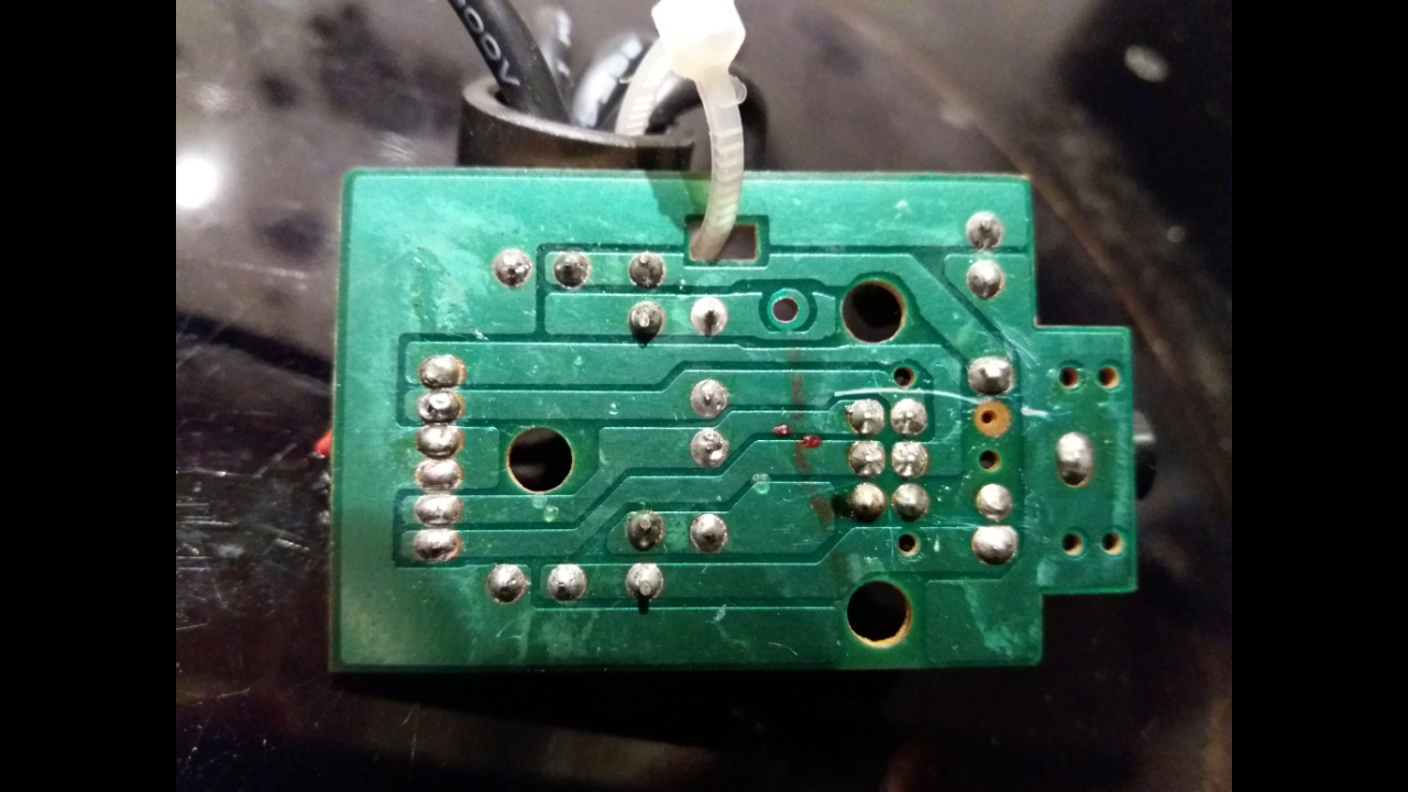

            Re: Technika 206 DAB radio NO AUDIO

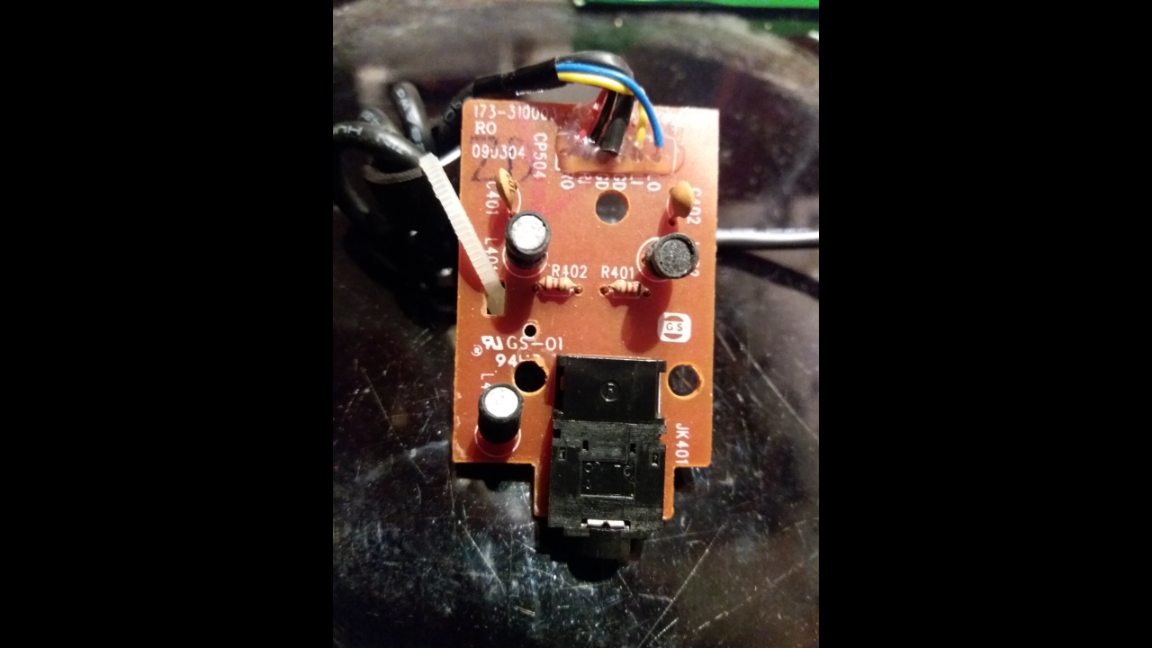

            Headphone pcb

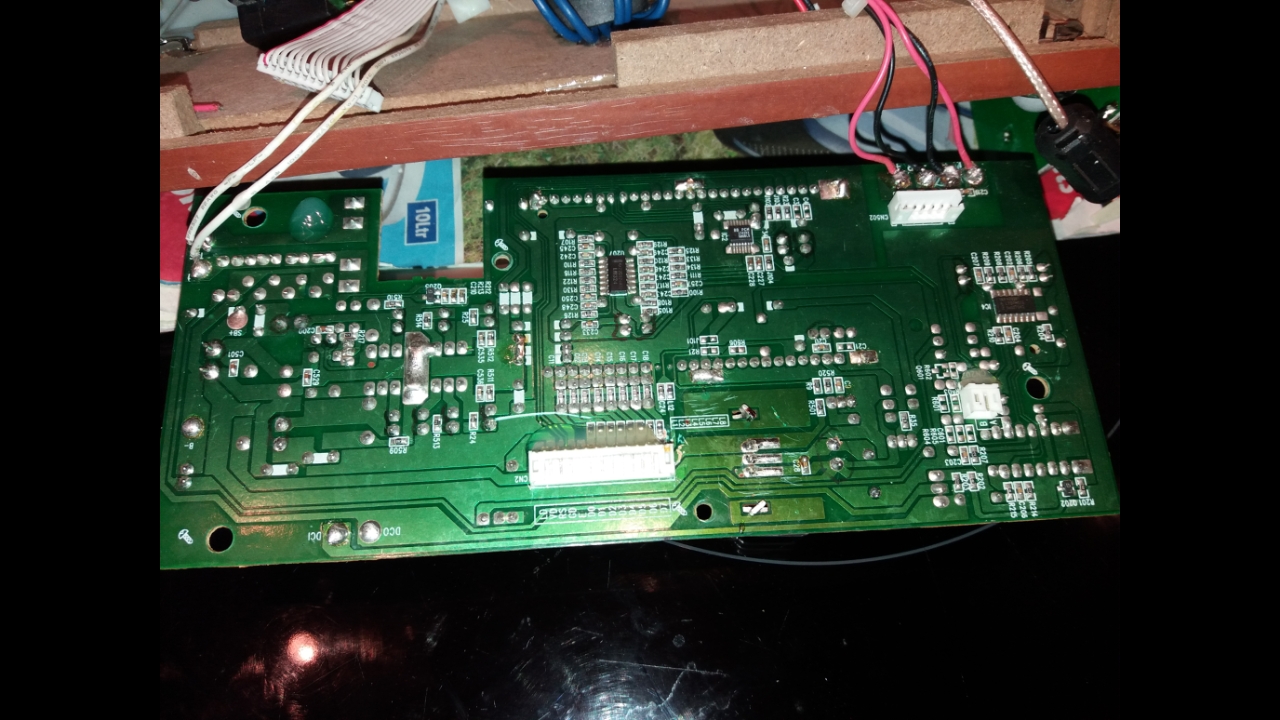

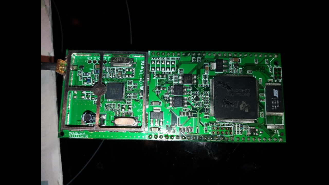

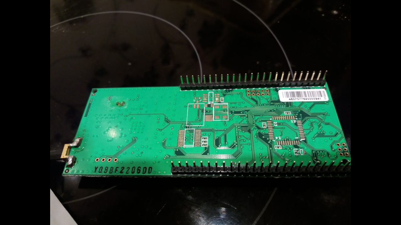

              Tuner / DSP board - Radioscape RS220

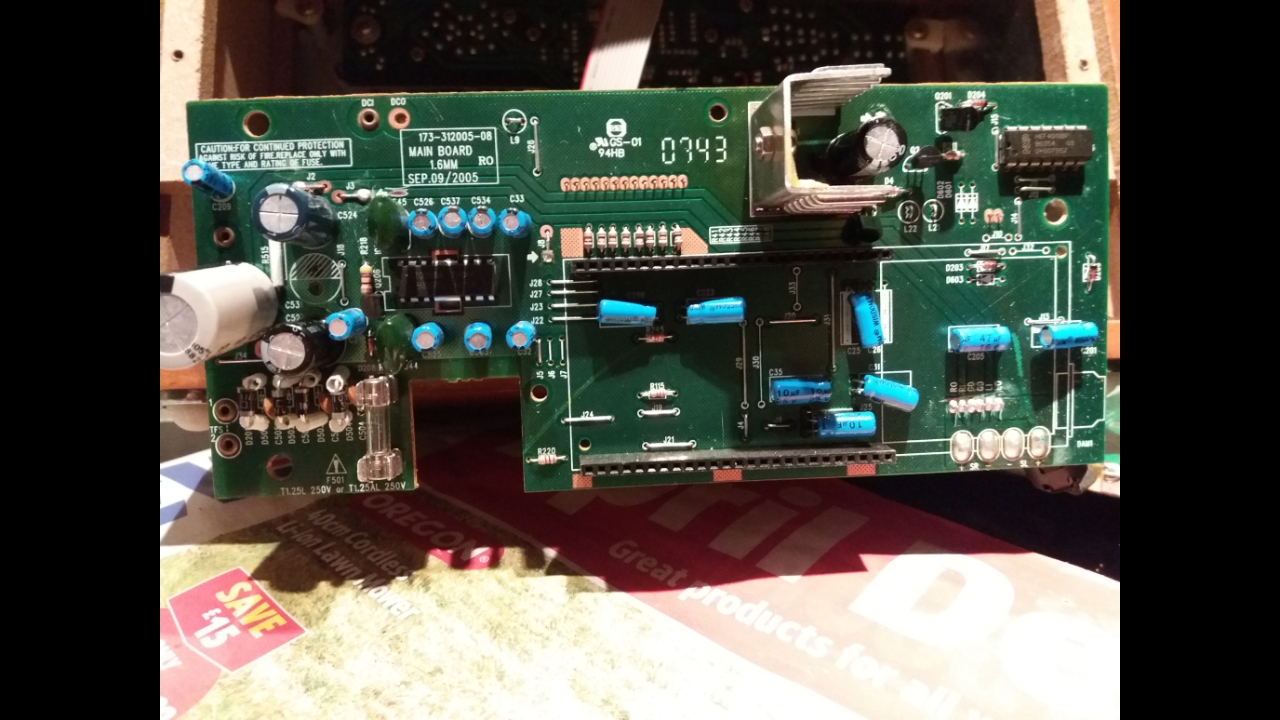

                Power / Amp board

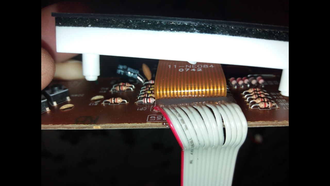

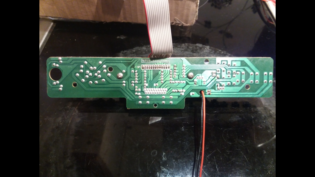

                  Key pcb

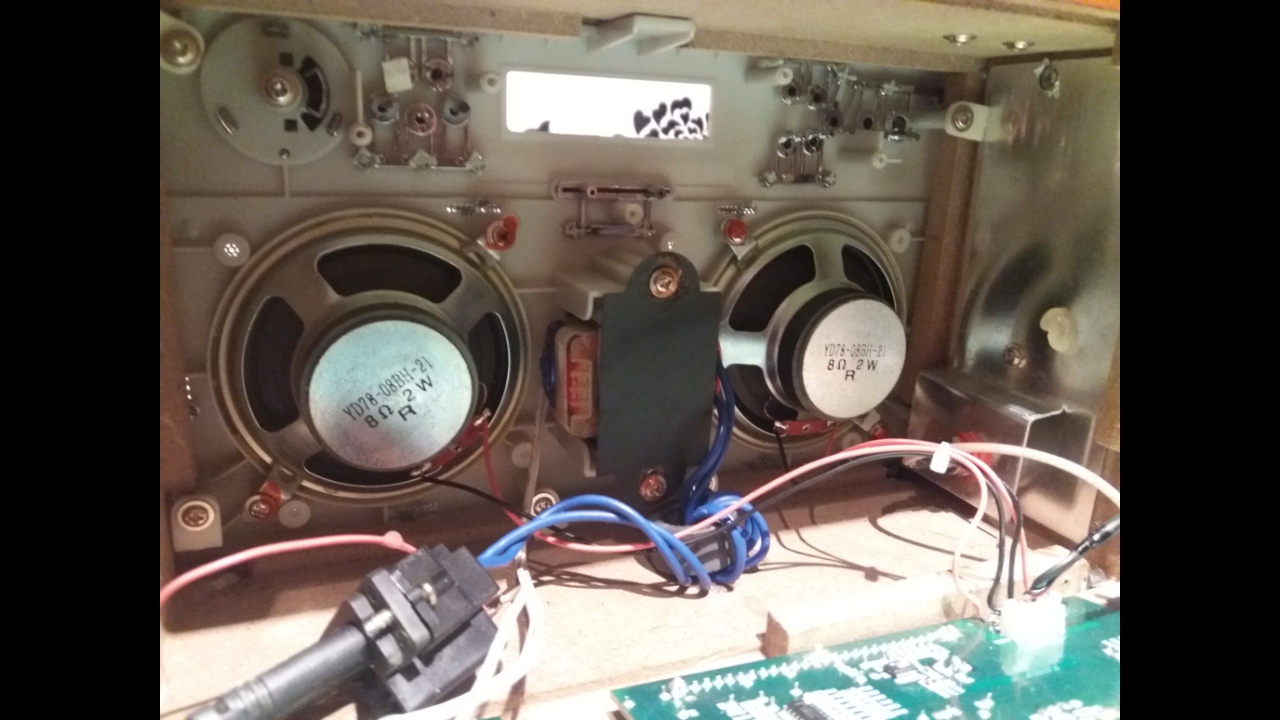

                    Mains supply in / transformer / speakers

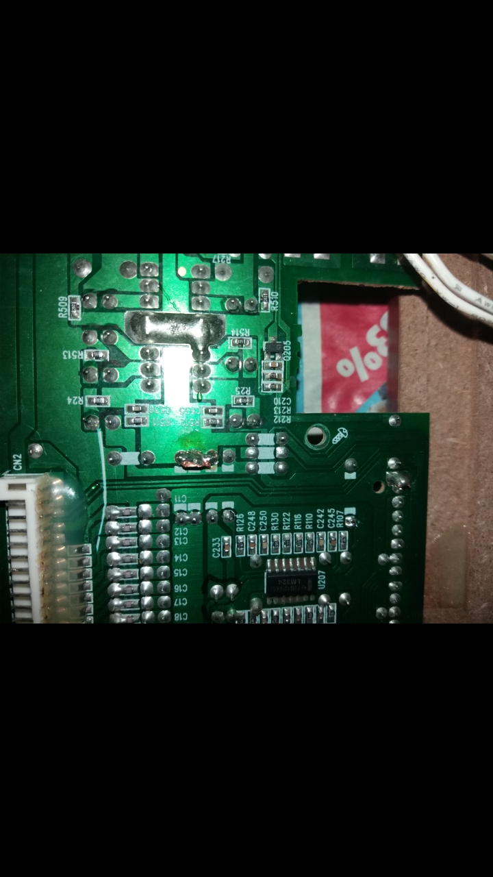

                      Power / Amp board
                      component side :
                      TA8227PG - low freq power amp
                      HEF4013BP - Dual D-type flip flop
                      solder side :
                      LM324 - low power quad op amp
                      PCM1742KE - 24-bit 192khz audio digital to analog converter
                      HEF4093BT - Quad 2 input NAND schmitt trigger
                        So you did a full recap on the amp board and the issue persists?
                        If so, I'd start at the TA8227PG amp chip and work backwards. That is, first determine if the amp IC is getting power on its Vcc pin (pins 1 and 12, looks like).
                        If that checks out, disconnect the two inputs on the amp IC, which most likely will be wired through some input coupling caps. Then feed an audio signal (again through some series coupling caps) into pins 6 and 7. If there is no audio, the amp IC is probably bad. If you do get audio, the issue is somewhere before that then - in which case, start tracing backwards from the signal input pins to see what chip they go to.

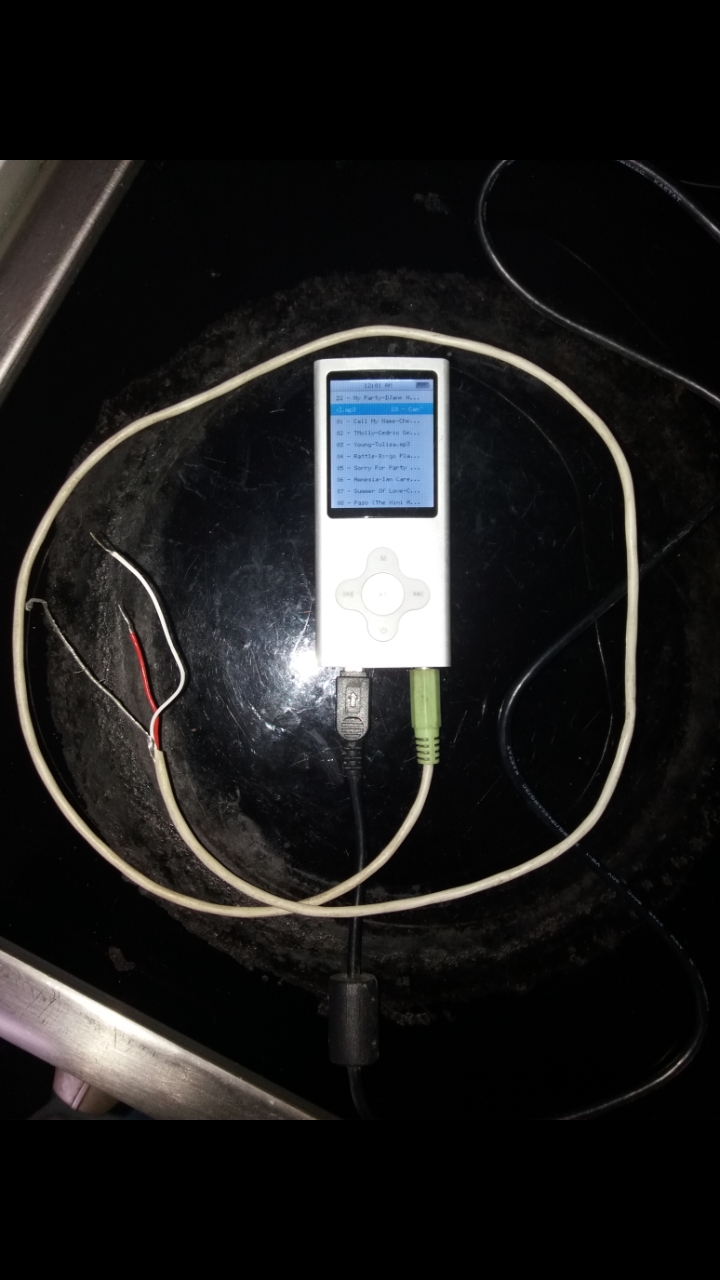

                            Where would I inject the audio output from this mp3 player via the headphone left, right and gnd wires?
                            Do I need to connect the headphone gnd wire to the gnd pin 4 Pre gnd on the TA8227?
                            Traced back TA8226 pins 6 & 7 to pins 1 & 7 of LM324 Quad amp.
                            TA8227 pin 6 traces back to R25 33k res, then a 2.2uF 50v elec cap, across a jumper link where it T's off to R107 1K res and Lm324 Pin 1.
                            Would breaking this jumper wire after LM324 Pin 1 and the R107 res be ok for either the left or right headphone wire?
                              Typo above on Post #14, should read 'Traced back TA8227', NOT TA8226!
                              Yep, that done it!
                              Audio coming through the TA8227 on both channels/outputs ok.

                                      • notallbad
                                        • Oct 2012
                                        • 1190
                                        Hope this close up photo shows enough detail.
