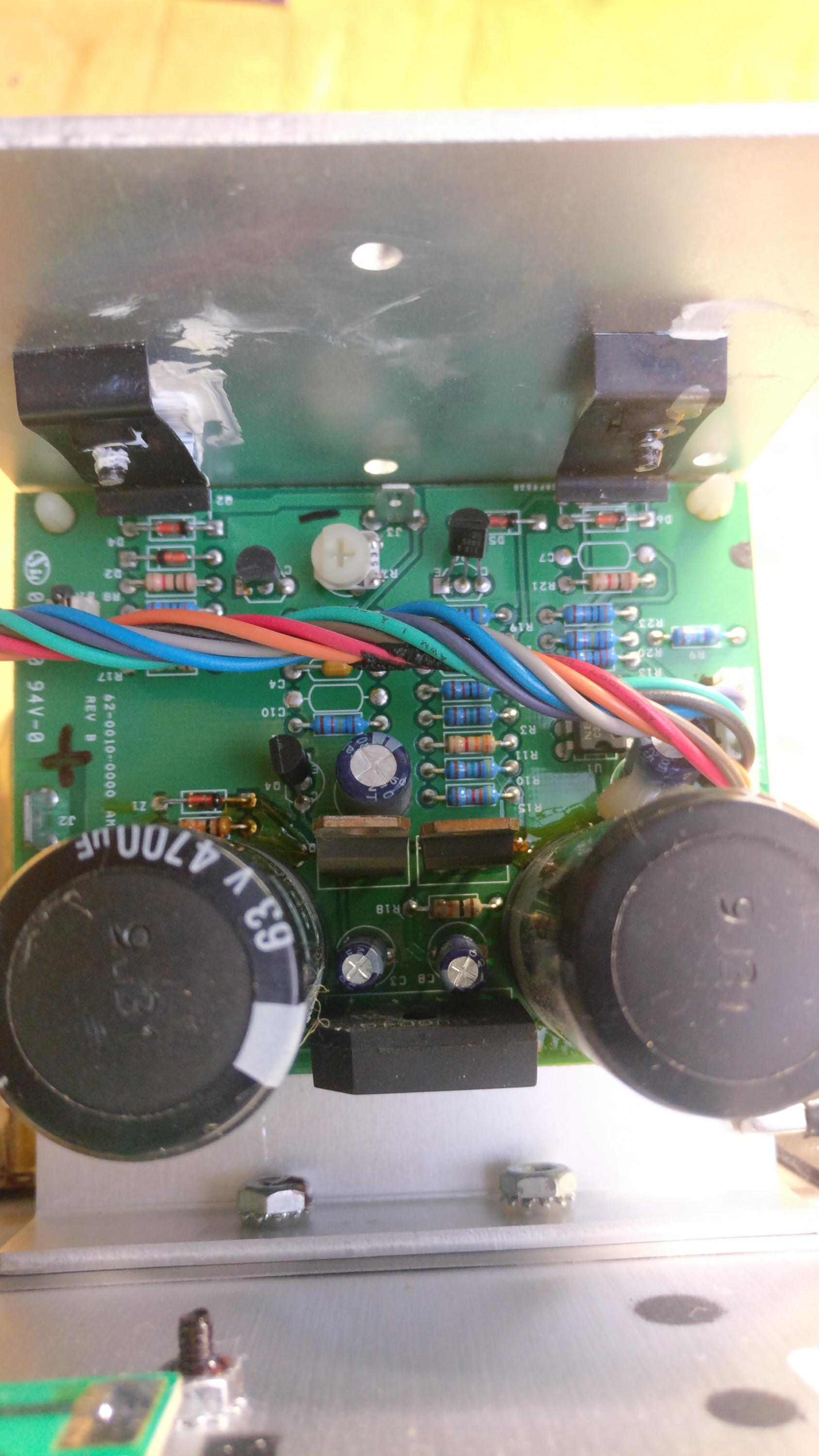

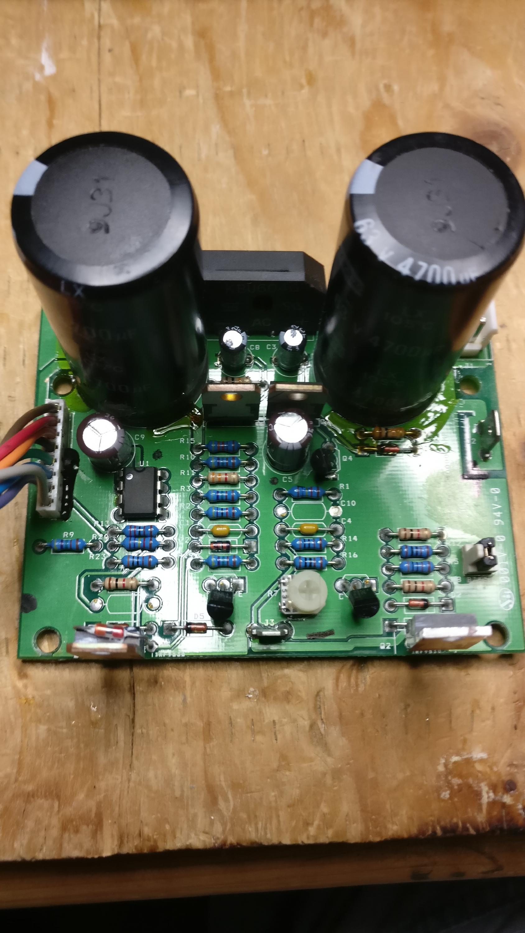

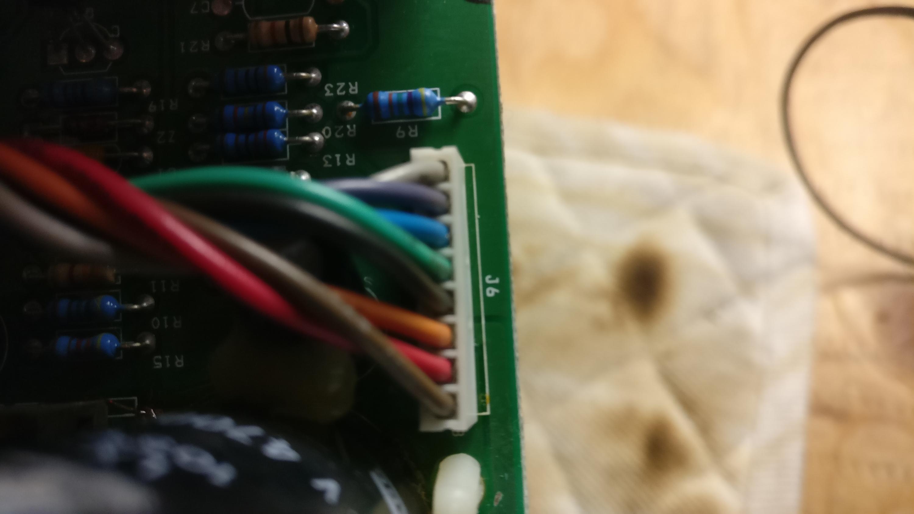

    This thing has no guts and a really muddy sound. I took the backplate/amp off and have these measurements on the eight pin connector J6 which goes from the amp to the input board.
    Pin1 0v
    Pin2 -13.97v
    Pin3 0v
    Pin4 0v
    Pin5 +51.7v
    Pin6 -51.8v
    Pin7 +14.54v
    Pin8 -14.58v
    Do these look good or... ?
  • mmartell
    • Oct 2013
    • 3189

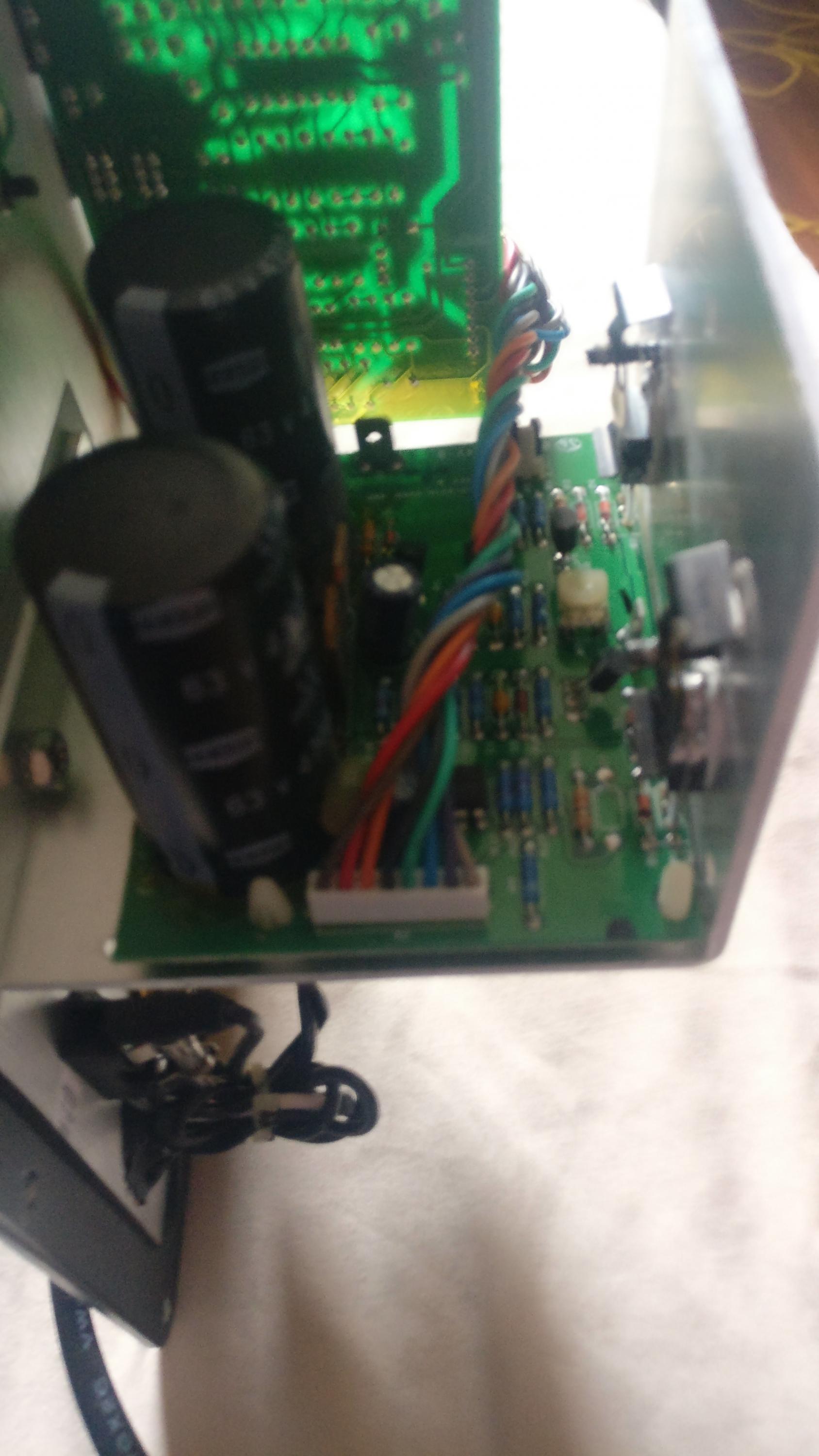

    Re: Polk Audio PSW350 No Balls
    Some pics...
    • mmartell
      • Oct 2013
      • 3189
      Alrighty then...
      From some of the other subwoofer threads I think I have all voltages present ?
      Is it good practice to just replace the electrolytics on the board first ?
              This unit has linear power supply and linear amplifier.
              What DC Voltage do you have on the speaker terminal?

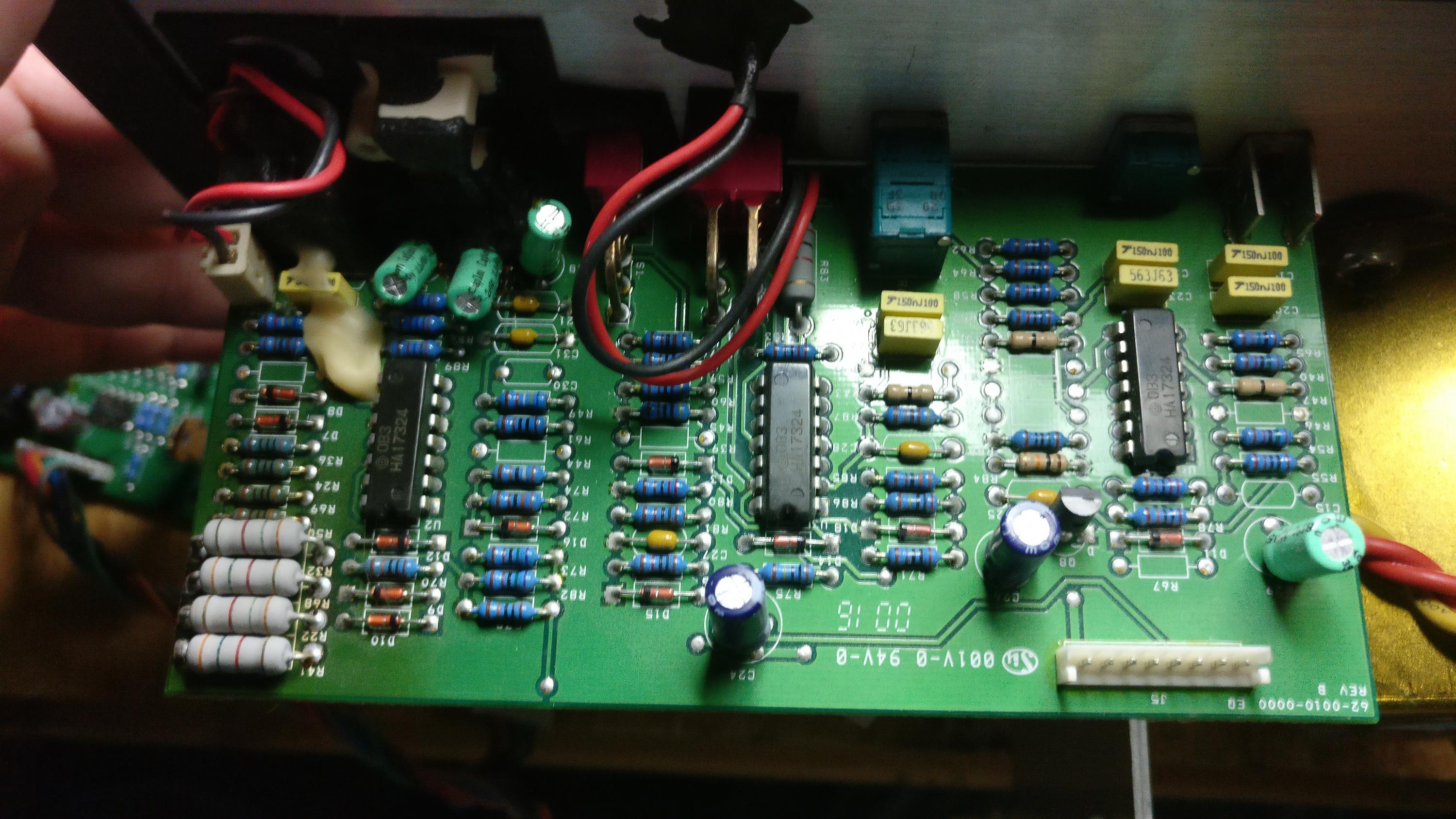

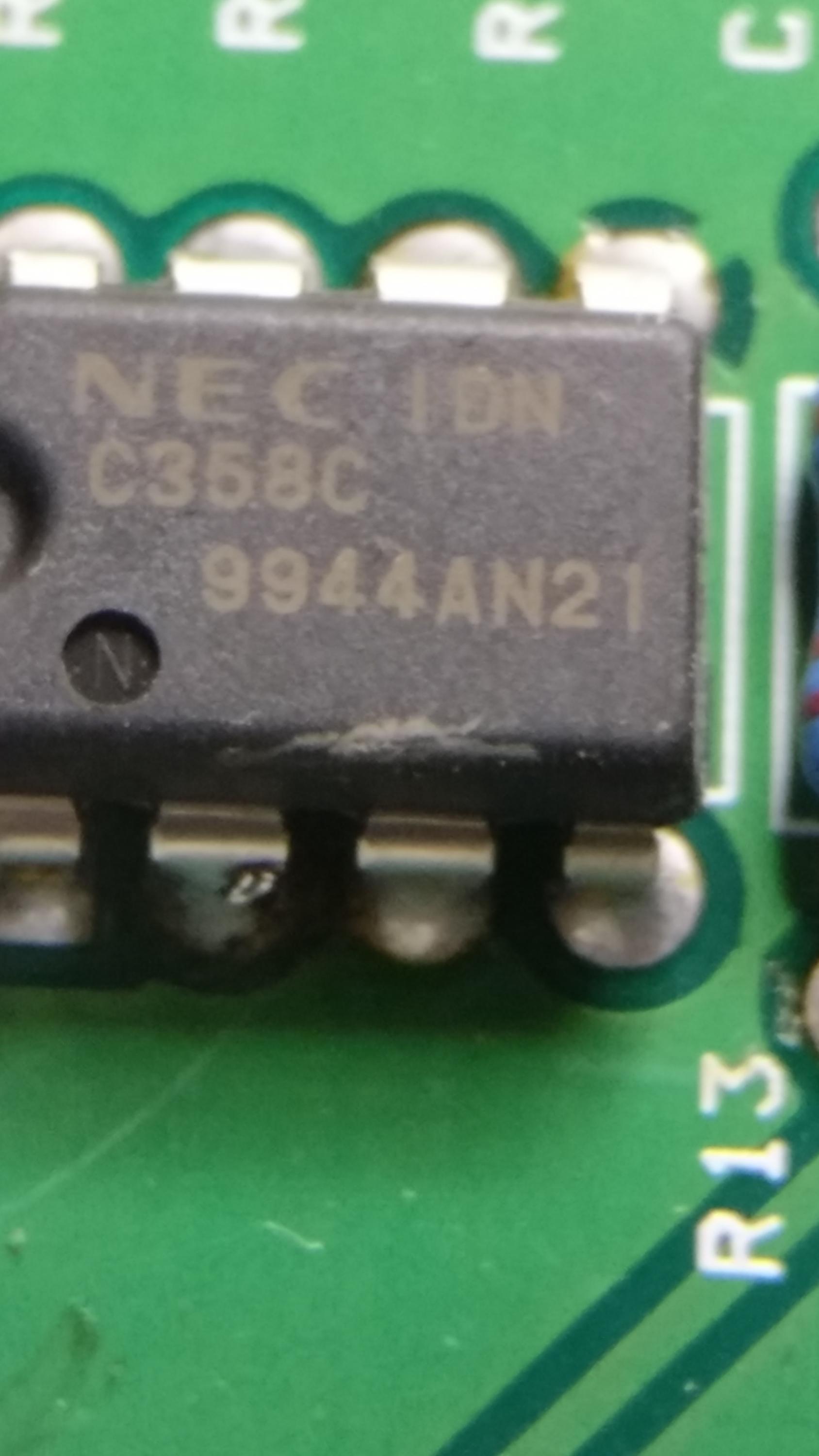

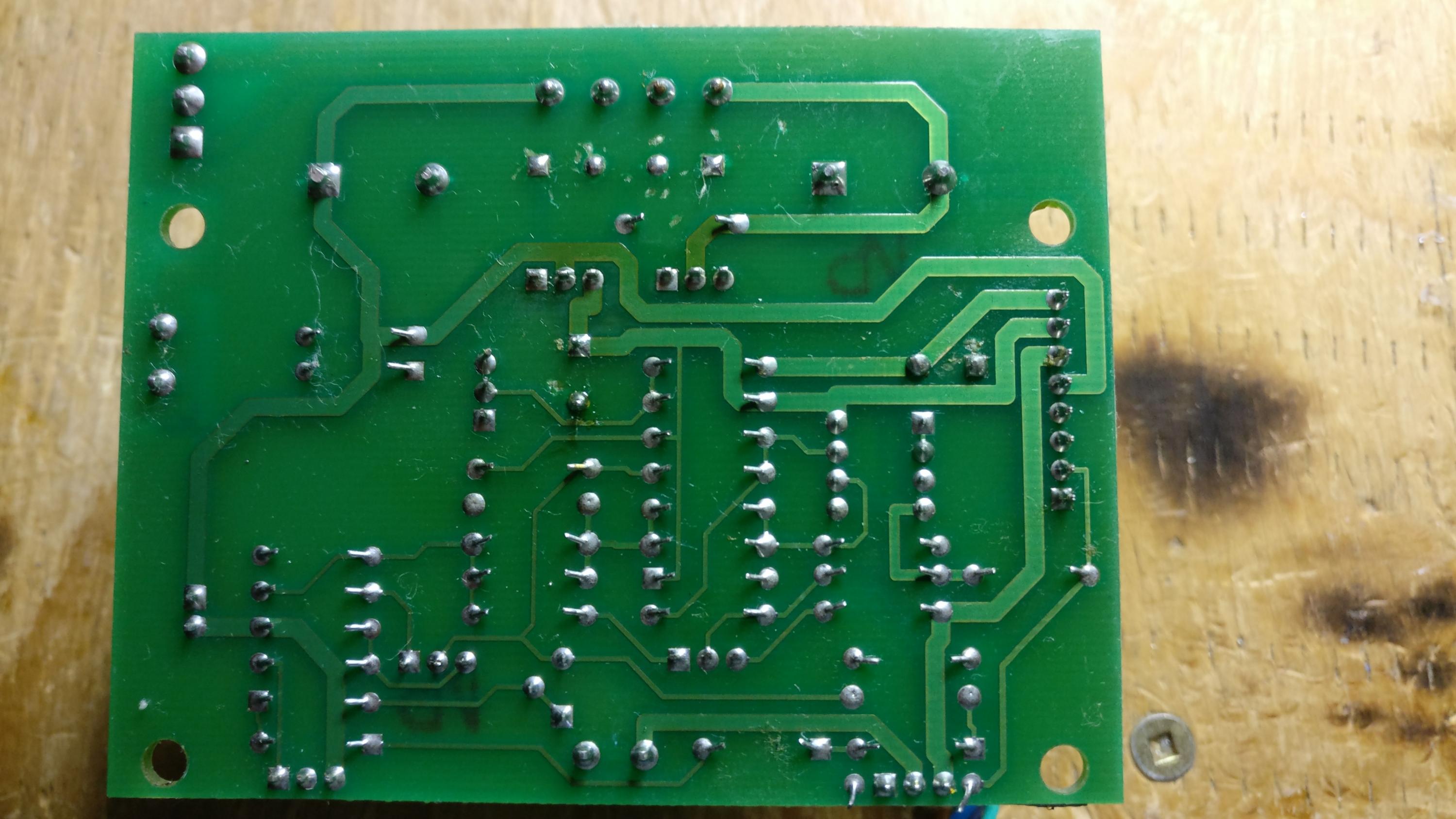

              Can I see good high res pix of the bottom side of the power supply/Power amp board?
              What is the P/N of the IC U1 on the power supply/Amp board?
              Can I see pictures of the Audio input board?
              What is the history of the unit?
              The speaker is good?
                I had to put the caps back in. I read 0mv on the speaker terminals that doesn't seem right but then that was without input (it's still mostly apart)
                I do not have a history on the unit it was given in trade for a few other things. It was supposed to be working and sat for some time before I tried it.
                The speaker measures at 3.2ohms on my meter and was functioning previously just not with any power or thump. Much lower volume than I would expect even with the gain turned up.
                Pics you requested in next post.
                  Amp board
                  Bottom of amp board
                  IC U1
                  Input board
                                  Dual OP-AMP C358C on the power amp board, the signal from Preamp board is fed to R13 which goes to pin 6 of the C358C Dual-op amp. You can use audio probe (PC powered speaker with 1K resistor and DC blocking cap on the input to the to PC powered speaker) to check the signal on the leg of R13 to goes to the connector (cannot see the designator) of the power amp that goes to the preamp board.
                                  Please see the spec of the IC:
                                  C358C DUAL OP AMP, it is used for driving the output section of the amplifier.
                                  HA17324 Quad op-amp
                                  I would check Voltages of the IC power supply pins (V+/-).
                                  You can use audio probe to trace the audio signal at output pin of the Op amp.
