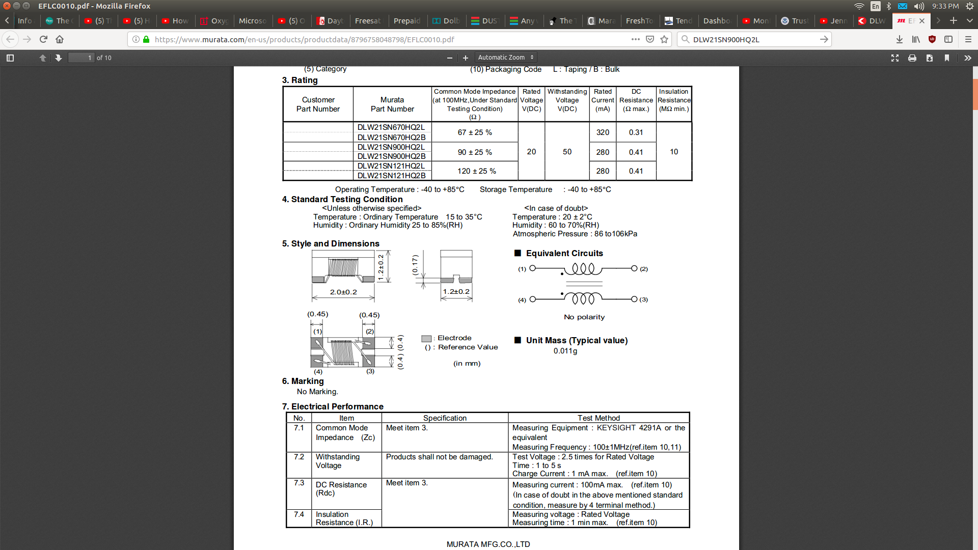

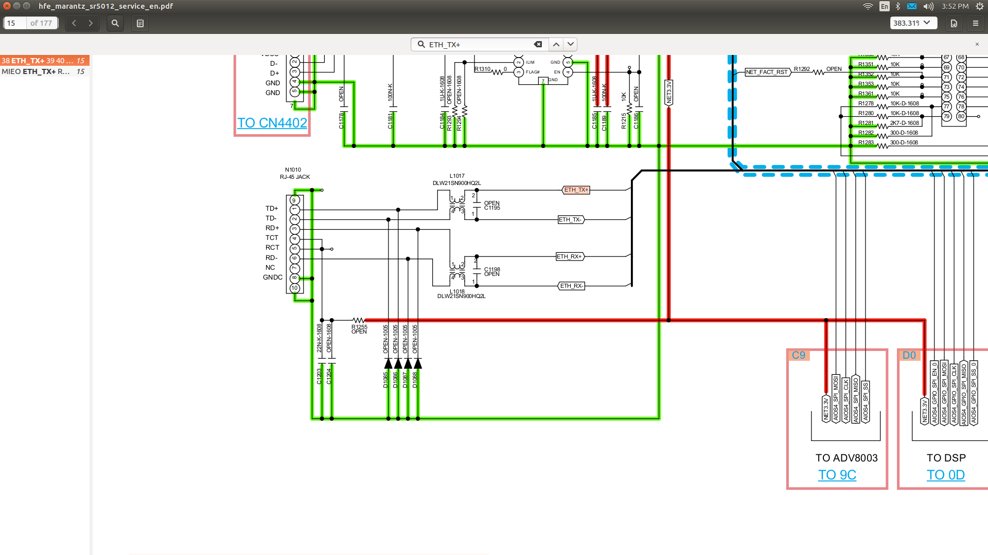

    The four comm lines are all shorted together. At first I thought maybe the common mode chokes had shorted and that would be a coincidence in itself maybe but to have Tx shorted to Rx makes me think it's not the chokes at all.
    The continuity tests were done with the lan/wifi daughtercard removed from the circuit and the Tx+/Tx-/Rx+/Rx- lines appear to run direct from the RJ45 connector (through the chokes) to the daughterboard connector. The schematic (included below) indicates the same thing.
    The RJ45 pins are not bent or smashed up.
    Is there something peculiar about these RJ45 connectors that something could be going on inside it ?

        Whats the number on it, there are also part numbers in the service manual, it seems to be a a variation of the 99 series
        like a HBJ-4109NL
        Are you sure its bad?
        The lan8720a ic has led status outputs, you could connect a led via 270Ω to ground (led anode to ic pin 3 led1) and check if you get activity when connecting the lan cable

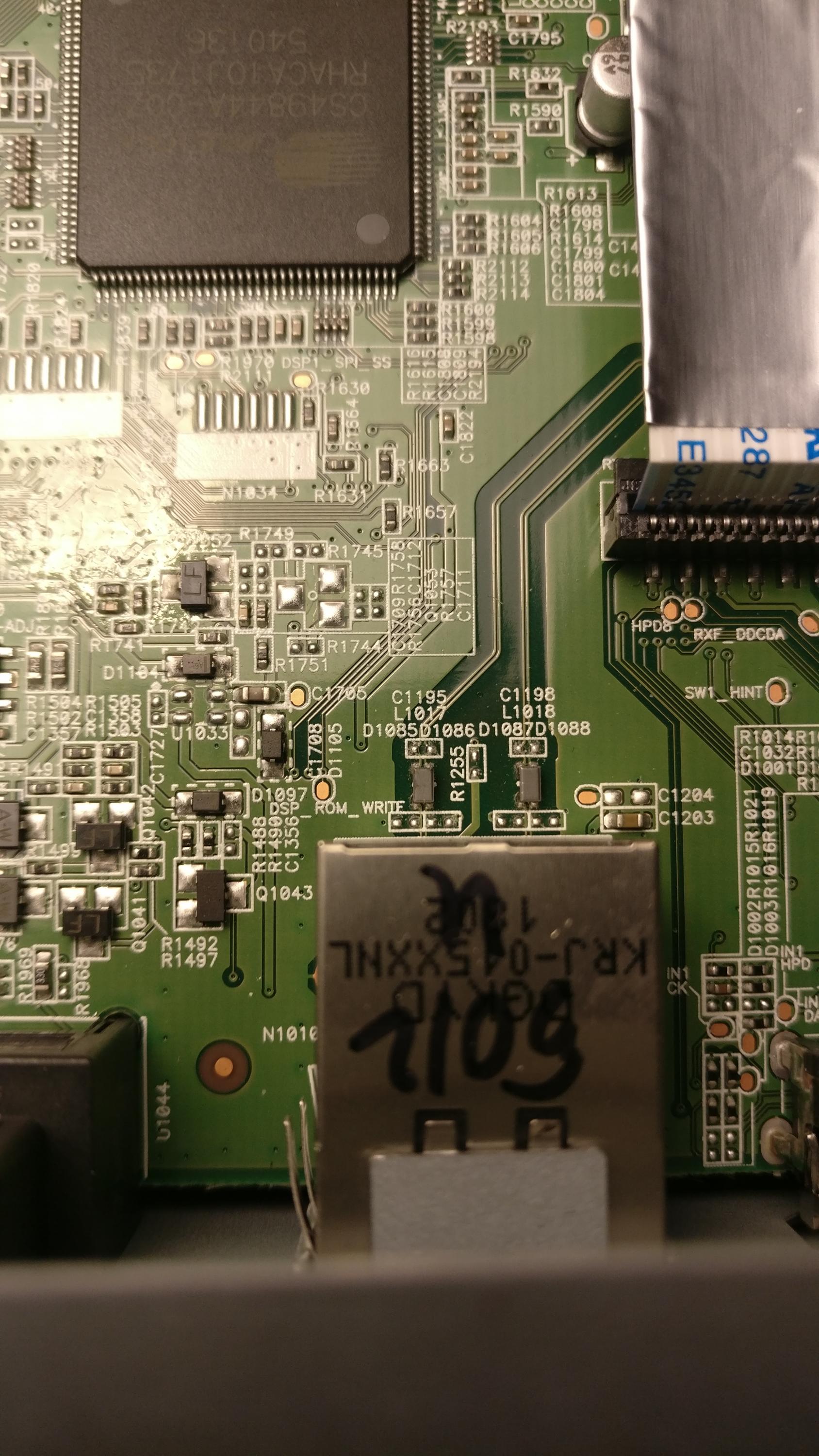

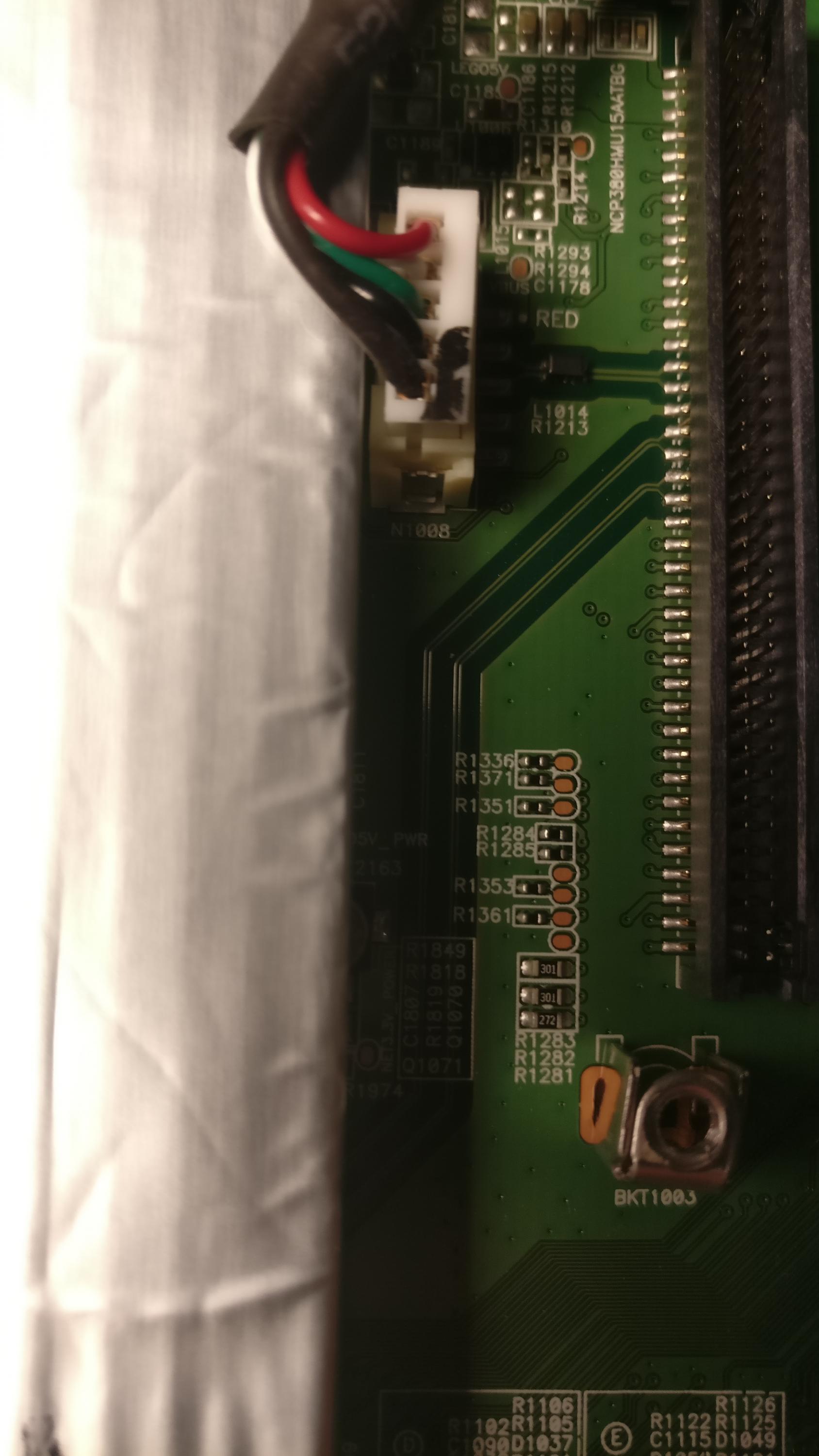

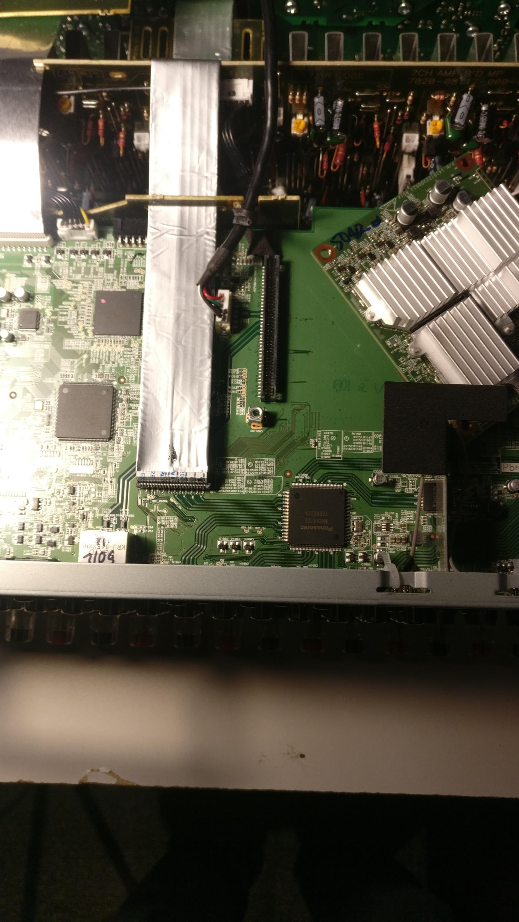

            Re: Marantz SR5012 Not Connecting to LAN but Wifi Works
            In the first pic you can see the lan/wifi module removed from it's connectors on the board.
            The second pic shows the TX and Rx lines terminating at the module connector.
            Pic three shows the RJ45 and the two common mode chokes. As far as I can tell these comm lines run uninterrupted from the chokes to the module connector.

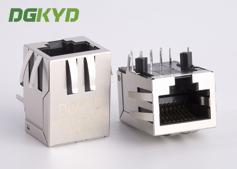

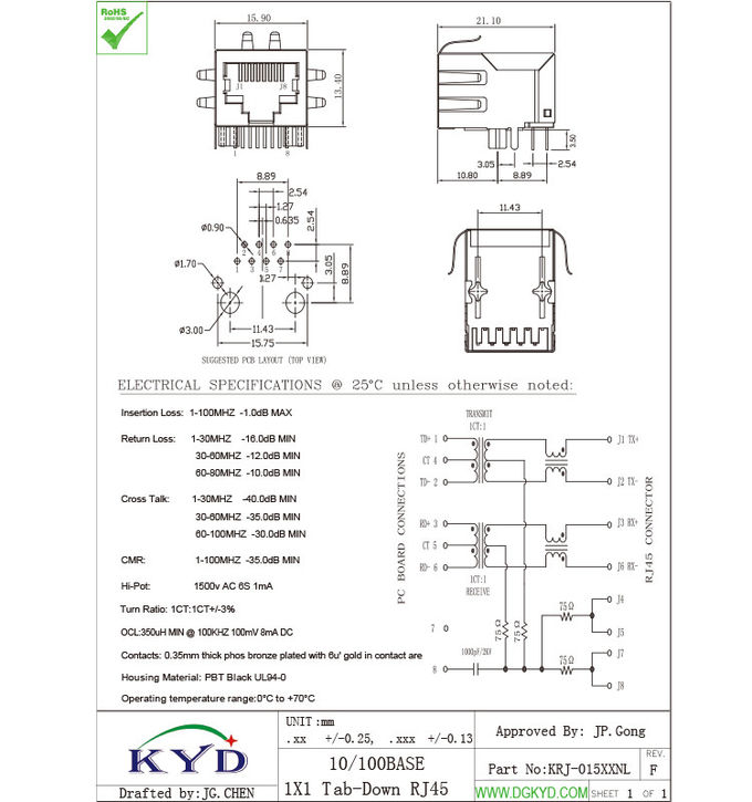

              The maker is DGKYD, KRJ-015XXNL is the pt# I checked there site but can't find the exact number.
              It is likely the internal magnetics are what you are reading as shorted
              No I'm not sure what's bad but all four comm lines and pin 4 are shorted to each other.
              This is WITHOUT the lan ic connected so I can't imagine what else it could be ?
              what side of the jack are you measuring the short, on the board or where the ethernet cable plugs in?

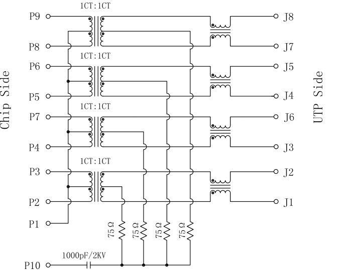

                    I did find the jack, it is not just a straight through jack
                    http://www.rj45transformer.com/sale-...thout-led.html
                    • mmartell
                      • Oct 2013
                      • 3189
                      Was about to say UH OH. I think I was working under a false assumption the whole time.
                      I remembered I have the SR5008 right beside it and measured the same damn shorts on it!
                      So I see you've posted before me and explained why...
                      So this is not the fault I'm looking at and more likely a fault on the module I guess ?
                        R J,
                        First, please don't stop entertaining my lunatic rants in this sub-forum.
                        Secondly after looking over the module and seeing nothing wrong I reassembled the module and tried running the unit to see if there were any leds on it that might point out a diagnostic clue...
                        But now it seems to work.
                        I know I've had this apart before but the module must not have been seated properly ?
                        Thanks again.
                        Nothing to see here folks, move along. Lol.
