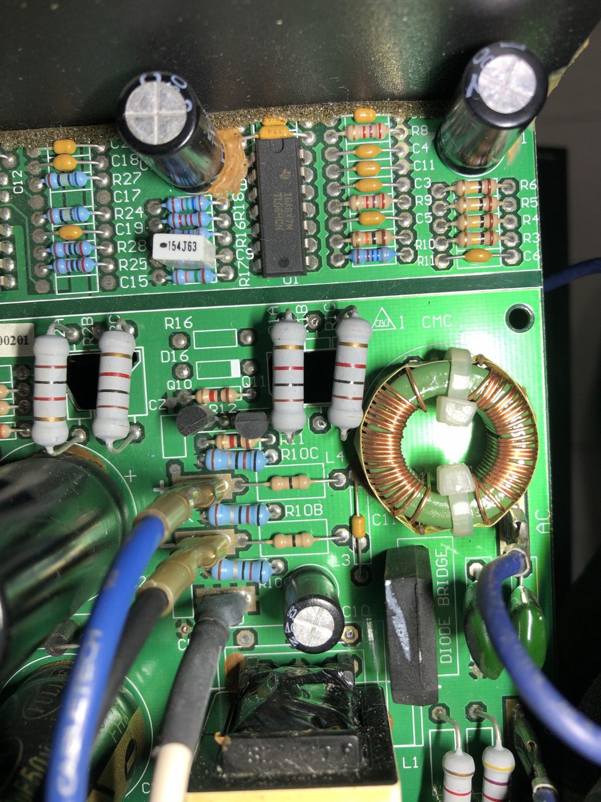

    I have a Mission MS8 subwoofer here for repair. I had a bubbled cap and also I have a burnt part. I am hoping someone will be able to help with the value of the capacitor. The location # is C11. Or if you have schematic you can share would be much appreciated. Thanks

    can we see a high resolution, straight shot picture of your board and upload it as an Attachment.

      https://www.flickr.com/photos/145608...posted-public/
        That being said, that may or may not be something along the lines of 100nF perhaps.
        Any chance of a shot of the bottom side of the board?

          I don't think that the capacitance is too critical here. 0.1uF is what I'd jam in there too.

            ok Thanks guys. Will give it a try and see what happens

              It will be good to see the pictures of the whole top and bottom side of the board so we can determine the function of that cap.

                  Hi TVrepairs, did you repair the MS8 subwoofer? Because I have got the same issue with my print board, also a burned C11, thanks in advance, Taeke.

                    Here is a picture of a working unit, The cap is a 330nf 100v axial ceramic.
                    Kemet# C420C334K1R5TA or equivilant should work.

                      atleast the conductive glue is only shorting the opamp input!

                        Hello, I'm currently having this same problem with my ms8, or at least i can see that i also have the same cap gone on the board, if thats all that is wrong im not a expert, I come from a car audio background. Is it possible to find the same value of cap say out of another component I may have around or am I wasting my time?
