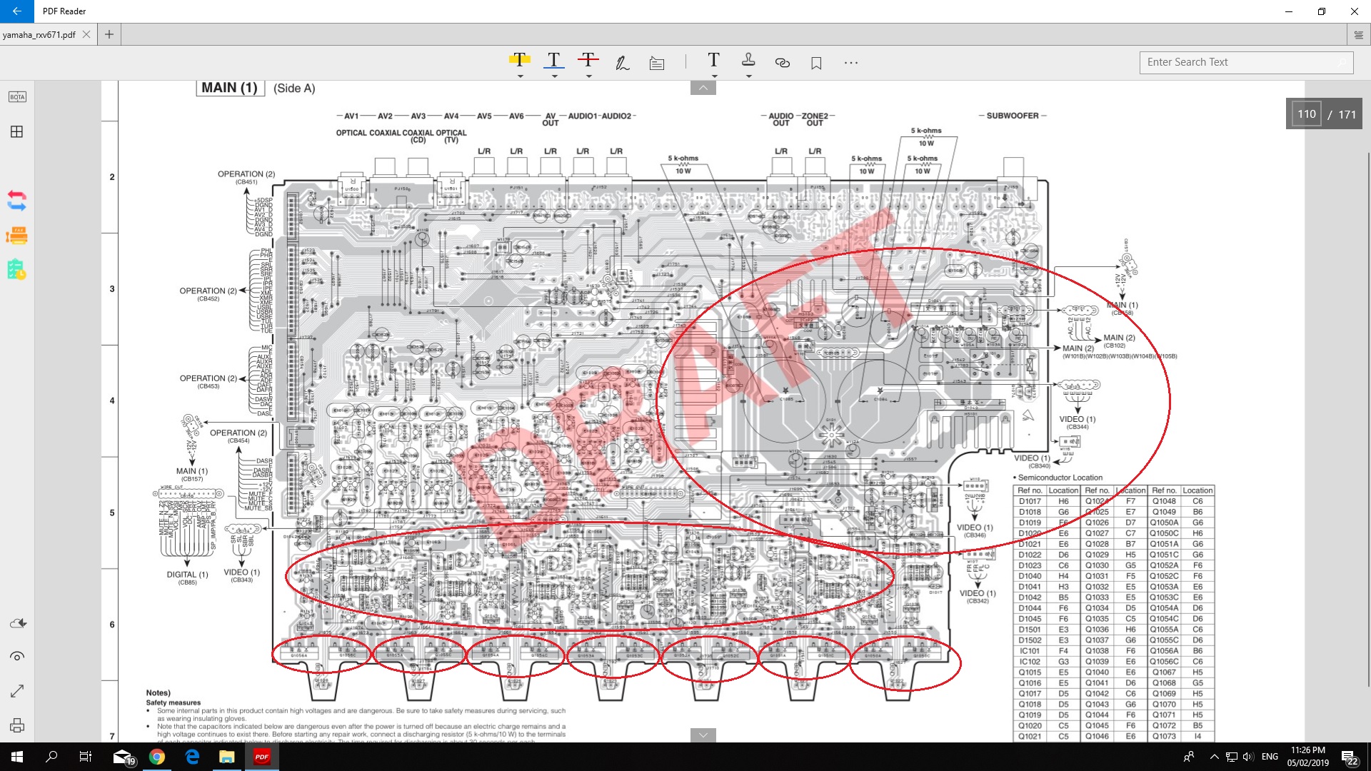

    My Yamaha RX-V671 has an illness
    I think we had a power surge/outage a couple of days ago as my PS4 informed me that I hadn't turned it off properly, it's usually left in rest mode to charge the pads, anyway, amp turned itself off when my wife turned it on, and then again, so I tried, same thing, I reset the amp, checked all speaker cables, then powered it back on, it worked fine for about 45 mins then switched off again.
    Diagnostic mode gives the error: PS: PRT 135 H
    I also see a fluctuating value in p1-2 diagnostic: PS 160/129 which suggests a high volt error somewhere ?
    No C405 on this amp lol
    I have the service manual, but wiring diagrams have never been my strong point :/

            Apologies, I forgot about the service manual.
            Not easy to look at on an iPhone lol.
            I haven't spent a lot of time on it so far, mainly checking for dry joints, and checking caps that have been mentioned in previous posts.

                      From what I can see there are no burnt, discoloured or swollen components, the inside is tbh quite clean.
                      If I've read the manual correctly, then Ic89 is a required voltage test, but I can't see in the manual what they are supposed to be.
                      Video 7 board has 7.2v off both terminals
                      Video 2 board has 5.4v from all 4 pins to video 3 board
                      I'm getting 46v and 21v from transformer, but that is in circuit
                      None of the "transistor amplifier" test as shorted, all gave the same ohm reading
                      Qpins ?

                                  A error P1-2 PS: 160/129 would indicate a fault with the lower voltages like 5v 3.3v etc.
                                  Check your + & -12 volt supplies, also check the voltages on Q1067 collector and Q1068 emitter. If they are ok, the fault could be with one of the 5v or 3.3v voltages, there are more than one of each
                                  Check that you have a good 5.5v coming from the ac-dc converter, this is the standby voltage that is allways on and is the source for the 3.3m voltage to the digital board

                                      12v on CB101 is 15.4v
                                      Q1067 is 0.6v middle/top 0.05v middle/bottom
                                      Q1068 is 1v Middle/top 1.6v Middle/bottom

                                        CB101 is the AC input to the D1041 bridge rectifier from the transformer, You would be better off checking the DC voltages on the regulator ic outputs, IC101 should have +12 volts, IC102 should have -12 volts.
                                        learn what the pinouts are on transistors, Q1067/Q1068 need to be checked when the amp is turned on. If it is in standby you will not have any voltages at all.
                                        There are about 20 different voltage sources in this amp, you need to be able to identify them and then check there voltages
