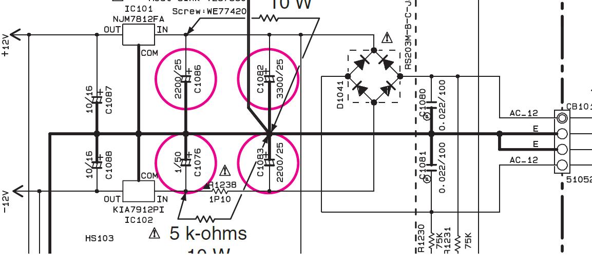

      If you measured 15 volts on CB101 I suspect D1041 could be shorted
      You need to measure the voltages on the two regulator ic's ic101 and ic102. check the input and output and note the polarity also.
      Q1067/8 both gave 62v to ground ????? this makes no sense at all,
      with amp turned on
      Q1067 should have positive62 volts on the EMITTER and about Positive 55-60 volts on its collector
      Q1068 should have negative62 volts on the COLLECTOR and about 55-60 volts on the emitter.

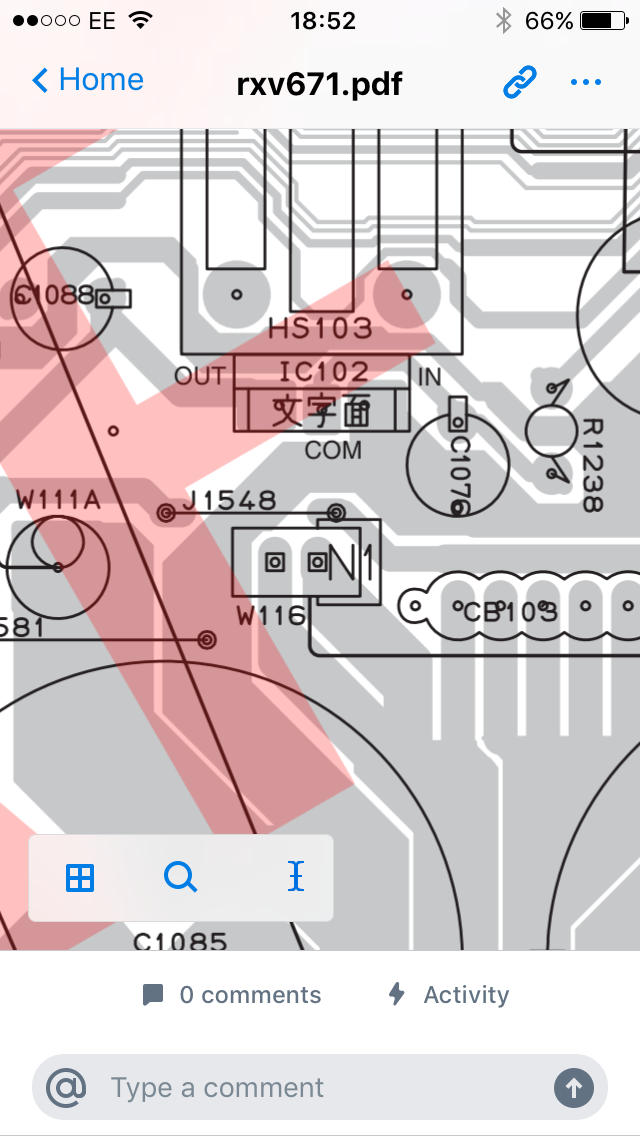

            [ATTACH]190438[/ATTACH]
            I will double check, but that's what I got all measured to ground.
            2nd test:
            OUT 1v COM -18v IN 0.005v
            Getting a relay click when I test the out voltage, it doesn't effect the result tho

                          You should be getting NEGATIVE 18.75 on C1076, and R1238 is connected directly to C1076 so how do you get a different voltage on it?
                          You should have -18 volts on both sides of R1238

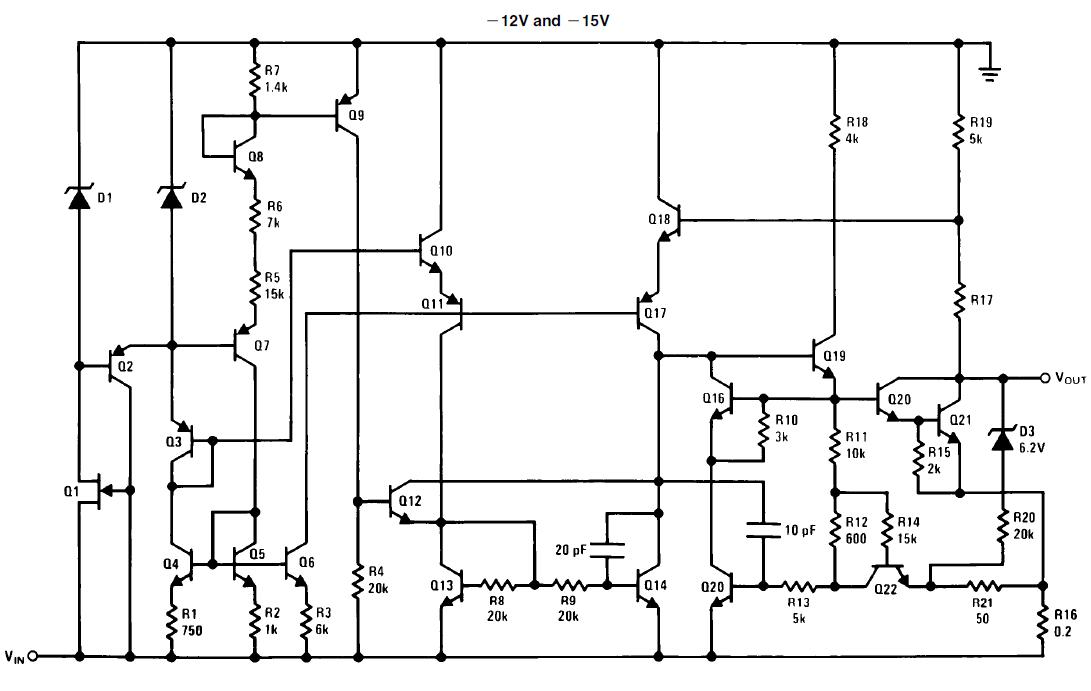

                              Here is what is inside of that negative voltage regulator ic.
                              I am sure the ic is bad, If there was something loading the -12 volt line I suspect the voltage would be 0 and not -6volts
