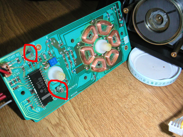

    The tape starts and then immediately slows to less than half speed. If i try more, it slows to a autostop. But the (always on) motor is so strong that I can't stop it by pressing with my finger... What makes it stop if playing any cassette?
    I changed these capacitors on the motor board:
    http://www.audiokarma.org/forums/ind...oblems.239117/

          Only one capstan is true direct drive, in typical JVC fashion they always sneak truth in features lol.
          First, I would suspect the belt needs replacing, there is one between capstans and connected to the flywheel.
          TA8409S is an H-bridge with two-speed control for the take-up reel motor.
          Capstan speed control servo is done at the motor, it just gets 11V power switched. There should be a servo and trimpot on the capstan motor PCB, you'd have to take it all apart to troubleshoot - if it's a motor problem.
          I'll bet flipping autoreverse gives you no speed problem because the (capstan) belt has load playing on one direction. If the belt is really stretched, the flywheel would not turn so good.

                It could be that the capstan motor bushing is worn a bit, make sure it is not rubbing on the coils or anywhere else
                You should be able to hear it when in play mode and if you remove the capstan flywheel you may see where it is rubbing, If may not be but worth a check
