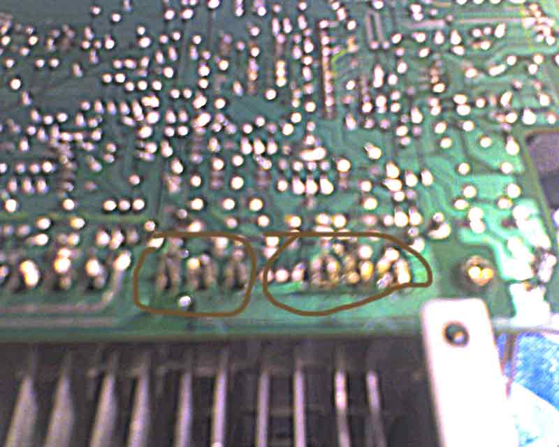

              I looked inside and some ICs are disconnected. It doesnt look like they are shorted out... hmm.

                Resoldered ICs, not much changed. The NEC PC2581V get fairly hot, almost too hot.

                  Nice blurry picture... lol Glasses just make it crystal clear that it's blurry...
                  >>I looked inside and some ICs are disconnected...<<
                  Oh Joy! Somebody's f**ked with it before! See if any parts appear missing. Service manual is out there for $4 or so. WOW! 44 pages -
                  http://www.e-servicemanuals.com/prod...d_id=954645026
                  **NOTE - NOT an endorsement of that site. I just found it on Google.
                  Here's the part you mentioned. If it's getting hot, without volume being turned up, it's very suspect. Just make sure speakers are always connected when on. Or at least a proper resistive load.

                    But I'm going on a tangent that picture is way too blurry to make out anything I don't wear glasses but even if I did they wouldn't help .

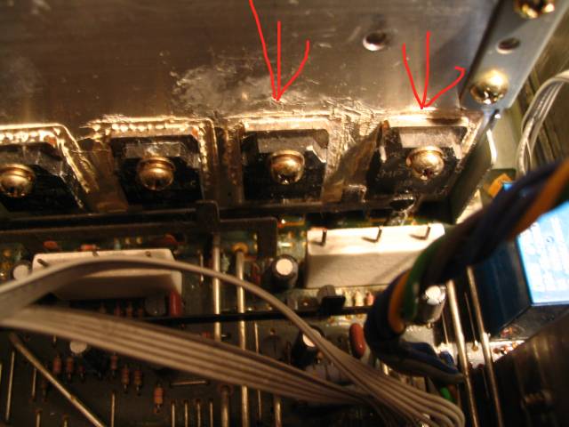

                          Thanks for finding the ICs, I don't think anything else was changed except some mosfets on the controller board. They appear to be working. Better pictures are coming. I could only use my phone as my batteries were dead in the camera. You have to turn the volume up to 20 or 30 to get a decent level which seems wrong. I'm testing with 2 8ohm 75 watt speakers.
                          Don't know if I should get new drivers for the amp or if I should replace some of the output ICs. There is also a cap I'm suspicious of. Its 16V 47uf and its right by the inputs.
                          I don't know if the so called "service manual" is just schematics and nothing else. I might give it a shot but I don't know if its worth spending money on.
                          These 2 were either desoldered or the solder broke off.

                                NxB >>These 2 were either desoldered or the solder broke off.<<
                                Solder broke off? How do you mean?
                                Unsoldered underneath, from circuit board do you mean? Somebody was def messing there. Make sure their tabs are not shorted to the heatsink. Ohmmeter plz.
                                They could be the cause of that IC being so hot. Are they connected to/from it?

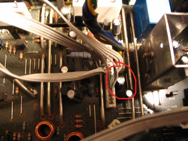

                                NxB >>There is also a cap I'm suspicious of. Its 16V 47uf and its right by the inputs.<<
                                Why suspicious?

                                  Cap is dented at the top, its in the pic. Yes, ICs were completely disconnected as if someone had used a desoldering tool on them. Every input and output still worked on the amp. I checked them for obvious shorts, like the heatsinks and nothing. I don't know if the NEC ICs got hot before I reconnected the MN and the MP, I never ran it with the cover off when first testing it.

                                    Can't determine problem of dented cap from pic. Not really evident. Minor dent is likely not a problem. Big dent, yes, could short. Unsure? check with ESR meter if you have. If not, then check with ohmmeter or just replace it.
                                    Pics are of transistors or IC's you said got hot? I'm unclear what MN & MP are or what that means. What IC is getting hot?

                                      MN and MP are the output ICs, they start with that.
                                      NEC PC2581V are the amp drivers, they get burn your finger hot.

                                        MN2488 & MP1620 are output transistors, not IC's. Now I'm not confused.. LOL
                                        Are they getting hot since resolder?
                                        Both of the uPC2581V are getting hot? IC701 & IC702?
                                        How about the other? IC501 STK350-230 ?
