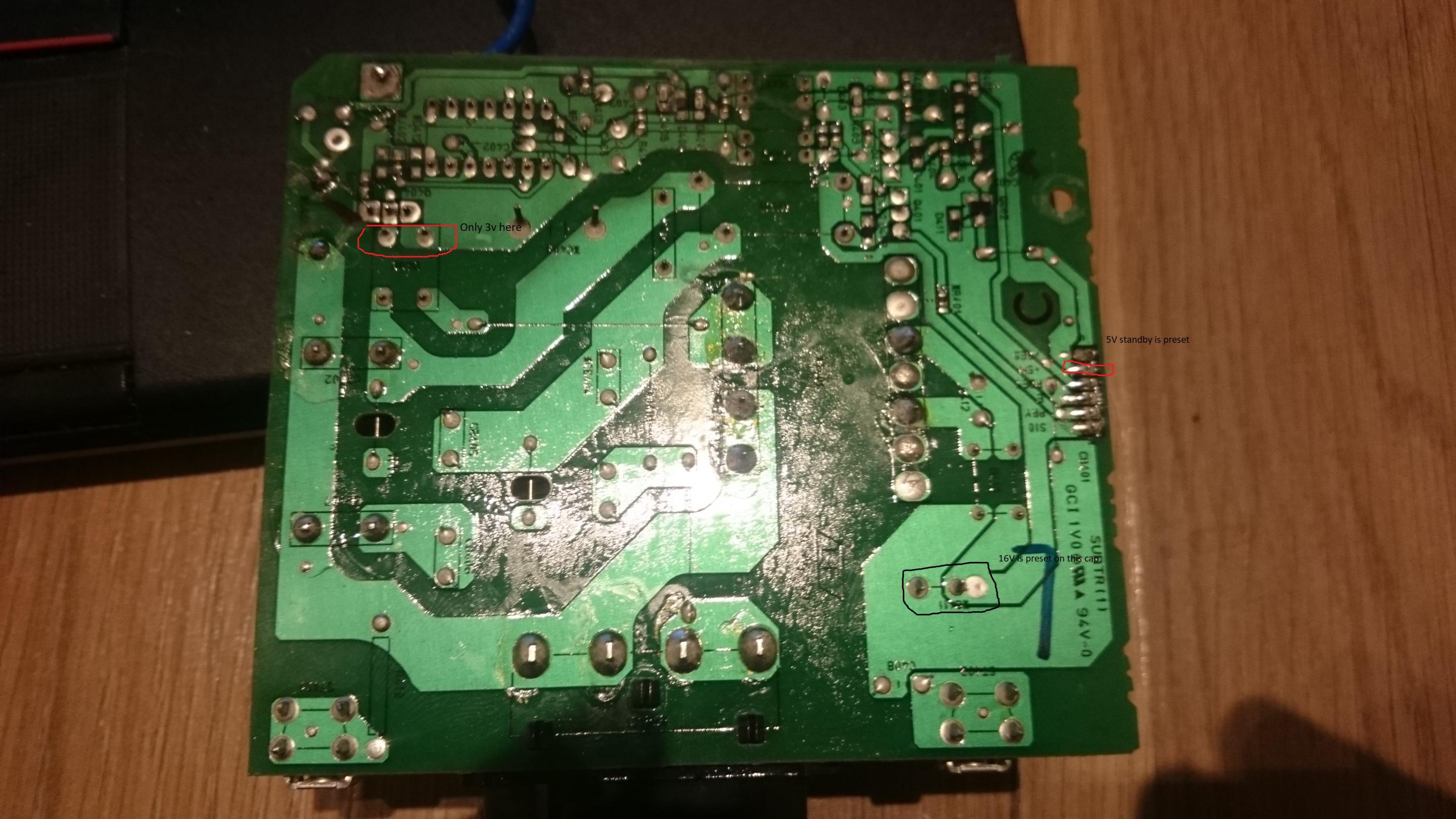

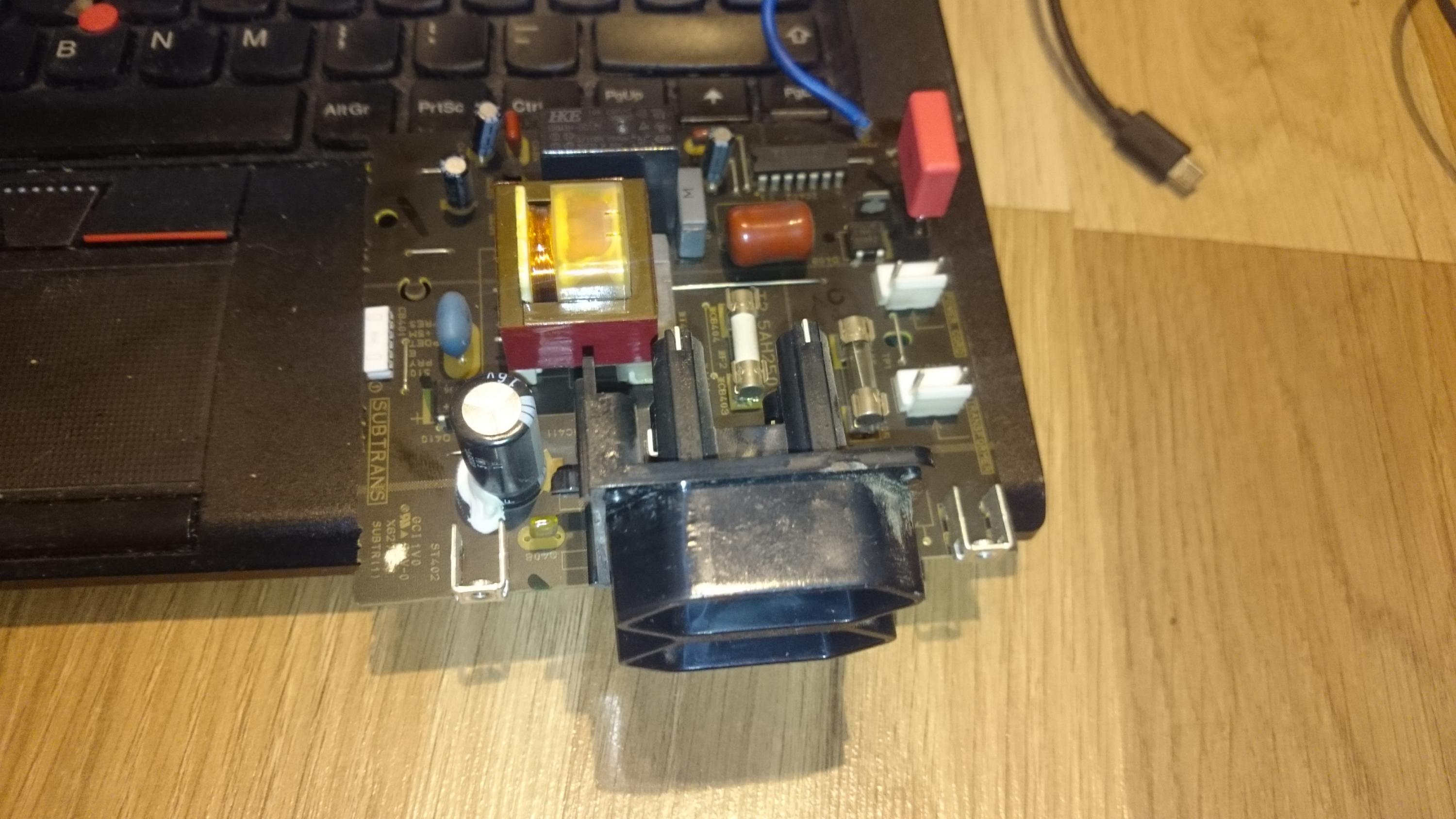

    I have a Yamaha receiver that does not power up. Does absolutely nothing. I have this far changed the common fault capacitor C405 to another 22nf 650V capacitor but that does not seem to help.
    Testing the voltages I have 16 volts on C411, 5v standby is also present(excactly 5v). And AC input 230V is also present.
    Only problem I have is that from the transformer leads I do not get 230V output at all. When I measure plus and - on D408 the multimeter shows only 3 Volts(testpointts marked on picture).
    What would be the bad component here? What should I look for?
    I am not really that familiar with mains voltage rectifying procedures.

    The power board makes a 10VDC standby rail from the small power transformer at conn CB401/S10.
    It has no 5V rail; that comes from the main board and to power the reset circuit.
    There is a complicated AC power detect and standby switch circuit with IC402 and C405 on the power board. It does many things. Also, it is floating at hazardous live on AC mains, so careful with voltage measurements there.
    What voltage do you get across C406, which is power for this section.
    If you have voltage on C411 then Q404 is on and hopefully power detect PDET signal is working, which also controls the reset circuit.
    I would look at CB401/PDET and PRY (power relay) signals to see if they are doing the right thing.

          After further measurements I can say:
          220V also reaches legs of C405
          C411 had 17,74 Volts which is a bit high for a 16V capacitor
          5M rail had 4,975 Volts
          S10 had the same voltage as C411 which is a little odd. It had also the same 17,74V, alltough it should be 10.
          I guess the anomaly is in the 10V rail somewhere which sets too high voltage? But where?
          C406 has stabile 9Volts
          CB401 PDET has 0,61 volts
          CB401 PRY has no voltage.

            The 10V rail is unregulated and will go up without no load.
            I worry about it at 17.74V, as the +5.5V reg IC452 (sheet 91, E3) rated 14V max. but it's working OK to make +5M. C411 is 50V?
            The schematic shows only 69V going into the standby transformer T401 though, I think it's a bad or DC number, not AC? The schematic has seems to have mistakes for voltage readings.
            The main relay needs PRY to turn it on, from the MCU IC451. I would see if the MCU is on.
            Can you check the voltages for the MCU +5S (+5BU I think is OK if +5M is present). Is reset (CB401/RES) stuck low, or does it go up?
            Pressing the main power button takes /PSW low (normally high from +5S), so the MCU turns then everything on.
