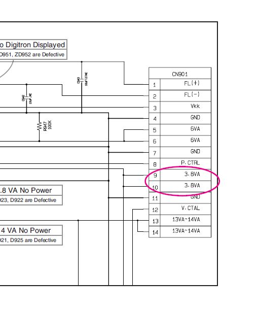

            Ok time for updates. Have changed all the faulty components. Power is up. Theres standby light on the home theater BUT i measured the voltages on the power board, the voltages on all the pins seems higher than rated as i checked using MM on DC mode. Now thats weird. Check screenshot
            Upon measuring using MM on DC mode, these are the voltages im getting
            3.8VA im getting 9.3VA
            6VA im getting 13.7VA
            14VA im getting 31.8VA

              I did not look at the schematics yet but I wonder if those Voltages may not be ref. to the circuit common GND.

                Hi budm, heres the service manual that has the exact same smps. Pls check and tell me what u think.

                          Im sorry i dont get u budm.
