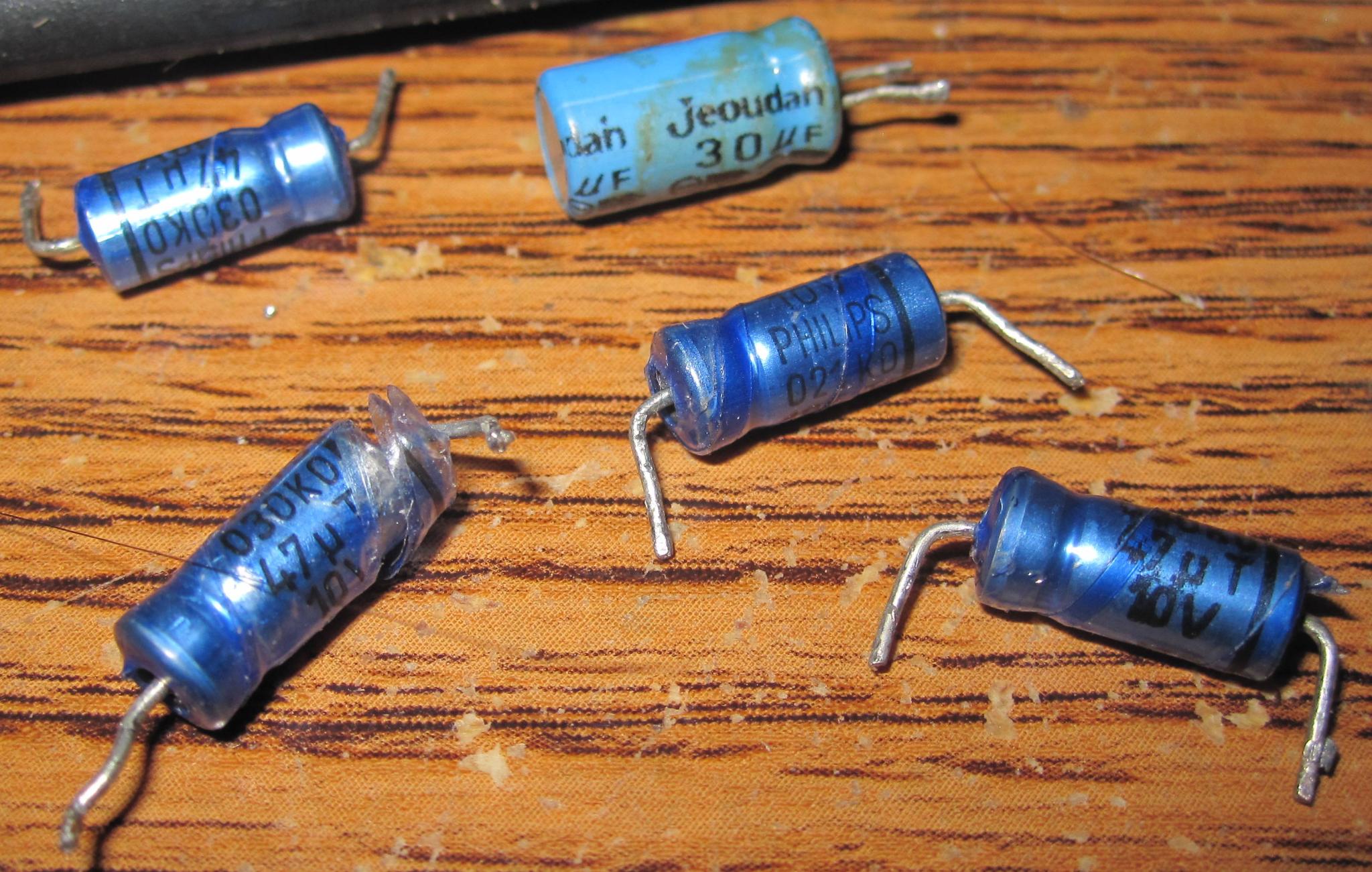

        It's a Chrysler stock radio, not sure who actually OEMed it but it does have custom parts in it (booo). The attached picture is the caps I pulled from it (well, not the radial cap, the axial ones are the ones I pulled.) Three of them are 47uF, and one is 100uF, all 10V. I didn't have any axial caps so I just plopped in some radial caps in their place.

          Philips electrolytic caps were horrible even back to the 1970's. Those are the blue axial ones in the pic. I change them on sight.

            Being a Chrysler OE unit it was most likely made by either Mitsubishi or Huntsville Electronics (Chrysler's captive electronics division until they sold it in pieces from 1996-1998). The Philips parts would make me lean toward Huntsville, I doubt Mitsubishi would be using Philips components.
