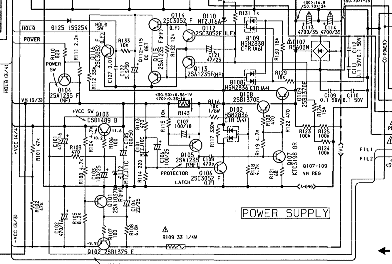

    First post.
    This Aiwa receiver does not power up. Checking supply voltages reveals the VM line is not coming up. Should be +11.6V. The power regulator transistors are not getting bias current via Q107 but I do not understand why. It seems the bias comes from circuits after the regulator transistors that are nearly turned off. These transistors and diode test okay.
    Measured voltages:
    Q109 E 26.35
    B 25.77
    C 1.470
    Q108 E 26.35
    B 25.77
    C 1.470
    Q107 B 0.385
    C 25.78
    E 0.005
    Q106 E 0.0
    B 0.0
    C 0.385
    Q105 E 1.330
    B 1.309
    C 0.0
    D101 anode 0.0
    cathode 1.370
    Note the power transistors pass more current (as they warm up?) so some voltages tied to them that should be the same are slightly different as I measured them at slightly different times.
    Any help would be greatly appreciated. I have been trying to figure this out for days now.

    Re: Dead Aiwa AV-D50
    quick look says its very likely in protect mode .
    is the negative rail ok ?

                  Is the biasing network R119, R120, R122 supposed to turn on Q108 and Q109 and then Q106 reduces over voltages based on the zener D101?
                    OK, I hope you can follow the operation of the circuit:
                    See that current sensing resistor R143? In normal operation, the current drawn by the load will not cause enough Vdrops on that R143 so NO BIAS for Q105 so it is OFF which makes Q106 to be OFF, so the Collector Voltage of Q106 will be high so Q107 is bias ON which will bias ON Q108, Q109. Q105, Q106 re part of the Latch/Protection circuit.
                    You only show part of the circuit so I really do not know exactly what you have and do not have.
                    If too much current flow through R143 then Q105, Q106 will be ON so Q107 will be OFF so Q108, Q109 will no longer have the bias to be turned ON.
                    Notes: Q108, Q109 are not completely turn OFF they are bias on a little by R119 so you will have little output Voltage to keep the protection/latch active until the you cycle the power to reset.

                        The collectors of Q108 and Q109 are at 1.47V well under the 11.6V output needed. It seems like the over current protection circuit should not be activated. Also the base of Q106 is 0.0V. Seems like in this state Q108 and Q109 SB conducting.

                          If the E-B junction of Q106 is at 0V, then what do you have on the Collector of Q106? 0.385V?
                          What is the feeding Voltage to the Emitter of Q108/109?
                          Once the latch is activated by the over current, the output will drop down to that low Voltage to keep the latch in place until you recycle the main power.

                            BTW, you need to test the resistance of R119: 4M7 resistor.

                              Collector Q106 is 0.385V (see measurements in #1)
                              I tried using my Fluke to record max current thru R143 on power up and there was no current surge. I also tried (risky) shorting R143 to prevent an over current detection with unchanged result.
                              Could you please explain the overcorrect latch? I do not understand how it works. Thanks.

                                R119 is 4.73M unfortunately.
                                  Take out Q106, right now Q107 is not getting enough bias to be ON.

                                    Do you think the .385V Q105 base should be biasing it on?

                                      If I take out Q106 might the VM line shoot up to 25V? (Since that also takes out the zener regulation.) Could that blow out other parts?
                                      • jworthin
                                        • Feb 2017
                                        • 33
                                        I removed Q106 and the output voltage indeed goes up to the full 25V.
                                        Does this mean Q106 was bad or the current protection WAS tripping somehow?
