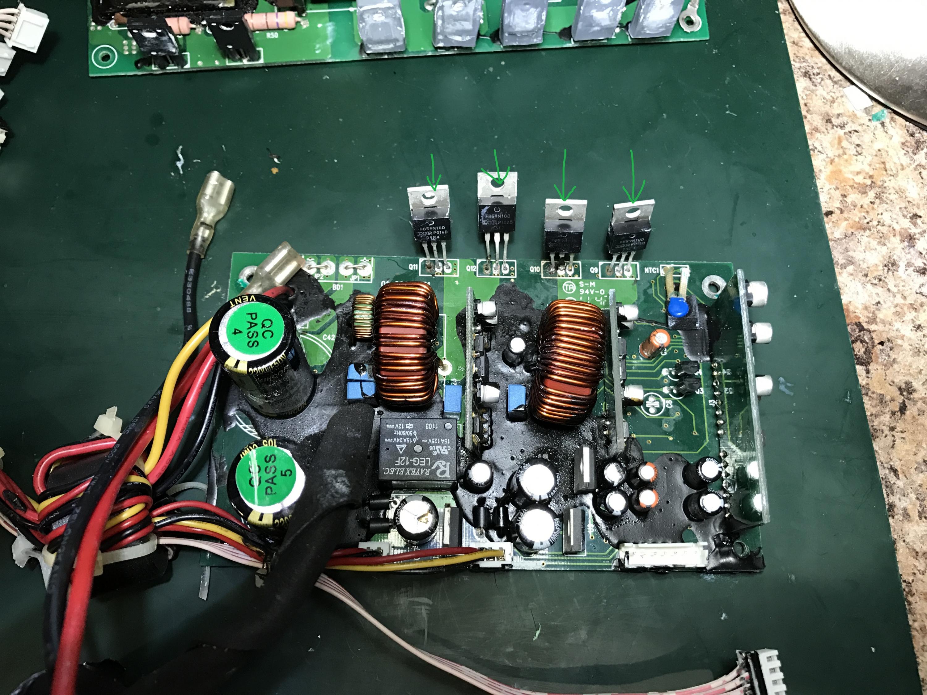

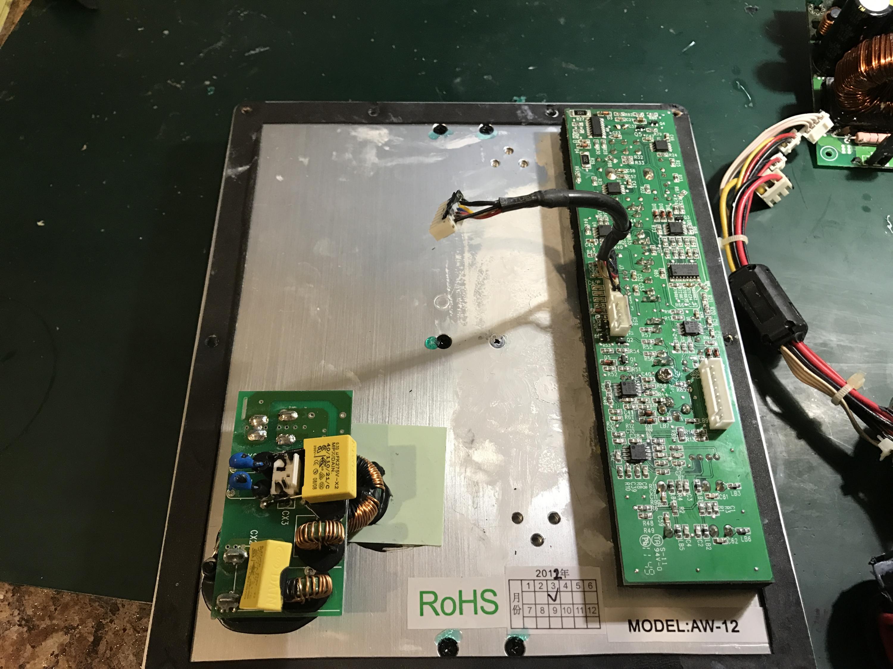

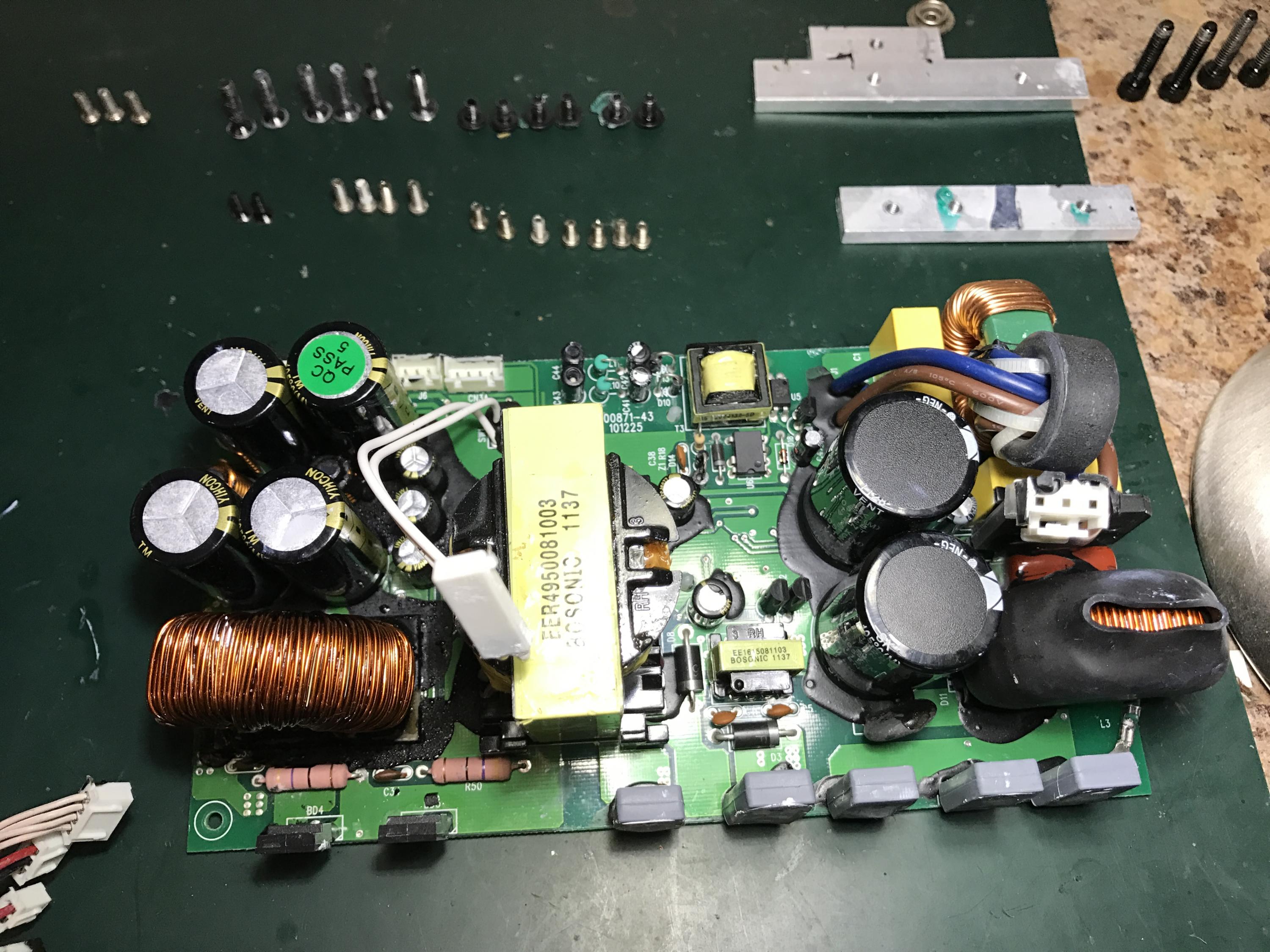

    Hi all , I have a monitor audio powered sub AW-12 which has an issue , the issue im having is it won't come out of standby , the led started flickering between green (active) and red (standby) now just stays red , I've ruled out the input end ..
    it is made up of 3 boards see photos . ive tested the transistors (arrowed green) and they are ok . The way the boards are held together with aluminium panels which double up as heatsinks for the transistors so when its assembled i cant get to the boards to check voltages ,

    Put that thing together, heat the PSU up with a hair dryer to like 40C and see if it fires up again.

        I also put my money on the psu board.
        This... "thing"* ( I'm trying to be politically correct here ) can be assembled and turned on without the radiator attached... of course only for testing purposes without any significant load.

            See that relay on the board? When the unit senses the audio input the unit will come out off the standby and that relay will be on, when the audio stops coming in, then about 10~15 minutes later the unit will go into standby. That is typical setup for most sub woofer.
            So check and see if the power supply is stable or not, if it is, the do you hear the relay even comes on or not.
            We need t o see the bottom side of the board to verify the relay function since it is single pole then it may be just the speaker protection relay.

              Do this to start:
              Get a 9v battery and some probes, find the two control pins on that relay, and bridge the 9v across them. If you hear a click, take the battery away. Do not hold the battery to the leads for more than a couple of seconds to prevent damage.
              If the relay clicks, it's probably fine but could have burned contacts internally, but we'll assume they're okay for now.
              Get a multi meter and check for continuity across the fets or transistors on the board. The ones in the TO-220 package are the ones I'm referring to (metal tabs on top and back). If none have shorts, then we'll have to go to the smaller components on the board.
              I'm betting a small bit on those International Rectifier fets. I found the datasheet, they're HEXFETS made for SMPS. I've had those in Alpine amplifiers and I've found that under high heat applications like in car amplifiers, they blow pretty easy.

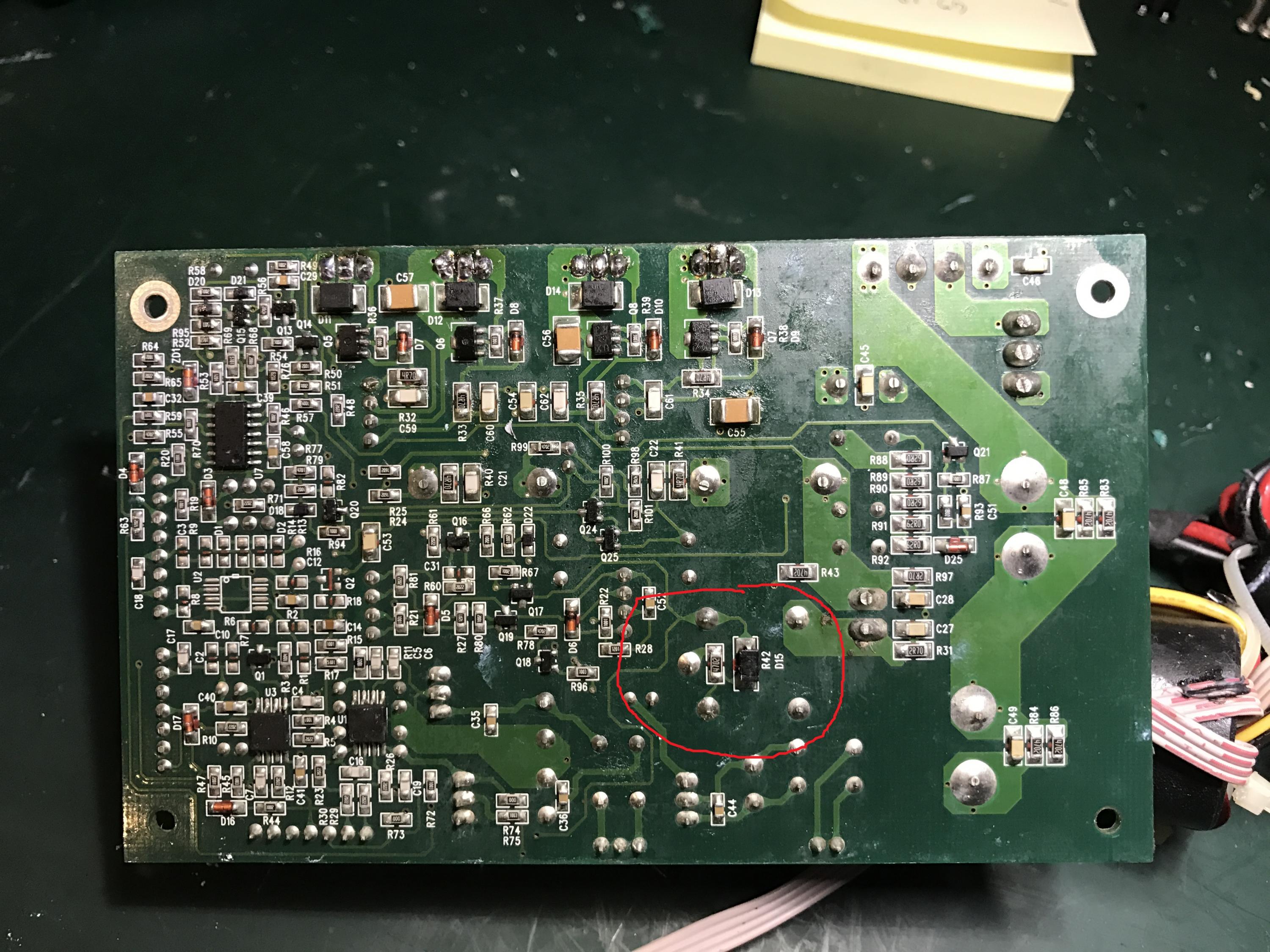

                                  here is a photo of the back of the board , the relay is in the circled section .

                                    Q9-Q11 (above d11-d14 on the last photo ) is this the original soldering?
                                    by the way ( for the ppl doing this for longer time ), is it normal practice to cover the whole pcb with this black goo?

                                      Re: powered sub wont come out of standby
                                      No I took these out to test them
