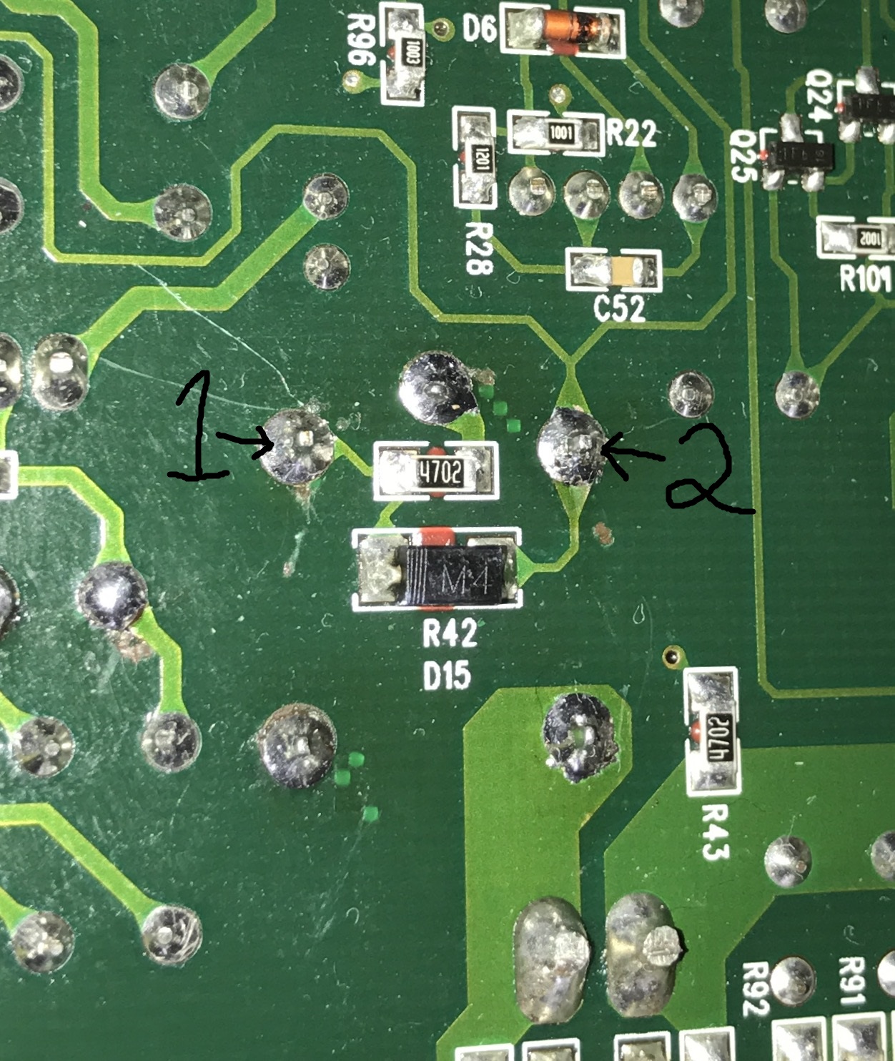

          what voltage is across where relay coil goes ?

            On pin 1 (with the ground probe on center pin of J6) .3 v dc , on pin 2: -12 vdc .
            with red probe on pin 1 and black probe on pin 2 i get 4 vdc.

              looks like relay voltage is way too low . maybe the driver transistor is wonky or its not being turned on enough .
              i could do with seeing the schematic really to see how the circuit works ..
              it doesnt appear to be the same as i am used to . looks like ground is hard wired to relay coil . i am used to seeing the driver transistor between ground and relay coil .

                  That first reading it means the relay coil has 12.3VDC (the V diff between the two pins, +0.3V and -12V).
                  Second reading is 4VDC on the coil, that has to be measurement error. Are you sure?
                  As you can see pin 1 is connected to the Cathode of the snubber diode so pin 1 should be more positive that pin 2.
                  If pin 1 is GND then the relay is using high side driving circuit with Negative power supply because you are reporting -12V.

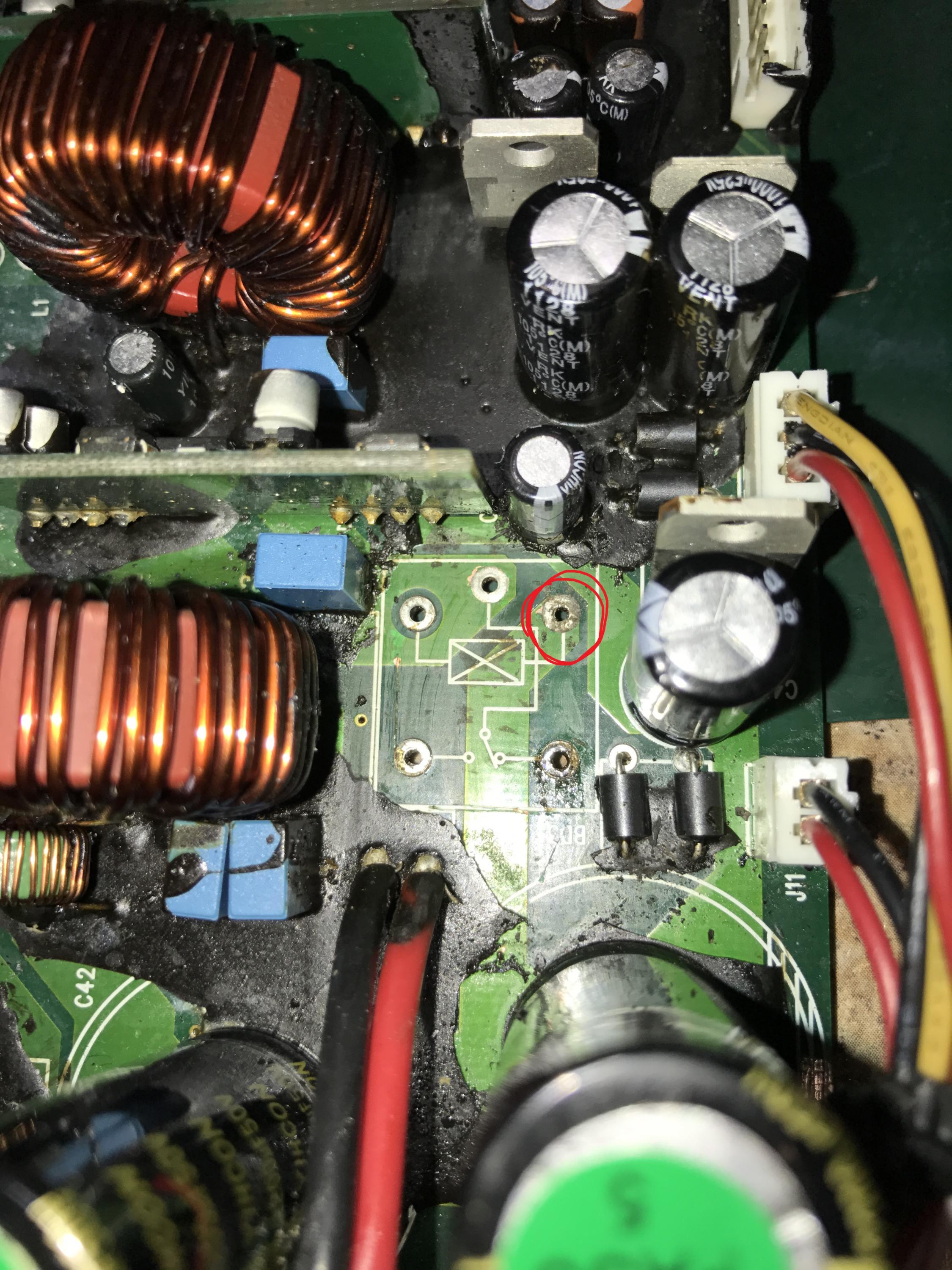

                    Hi guys , im about ready to give up on this , i thought i had found something , i noticed when i moved this coil the led would flicker green/ red , i took the capacitor out next to it ,(circled in the drawing ) as couldnt get a reading from it from my esr meter .
                    Replaced it and after a few seconds the relay clicked and green led , tried it a couple times and seemed ok . but now back to red led again .
