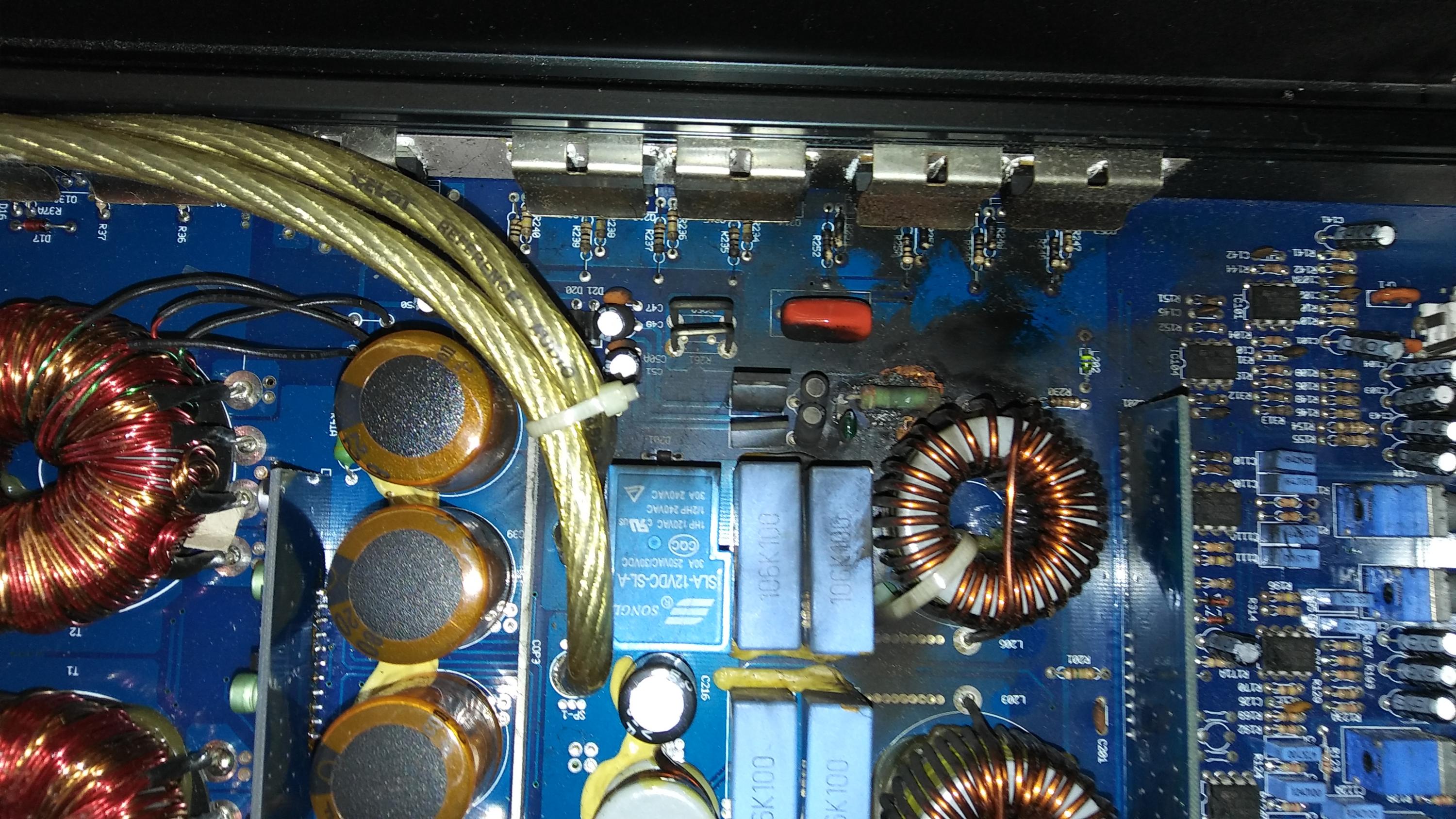

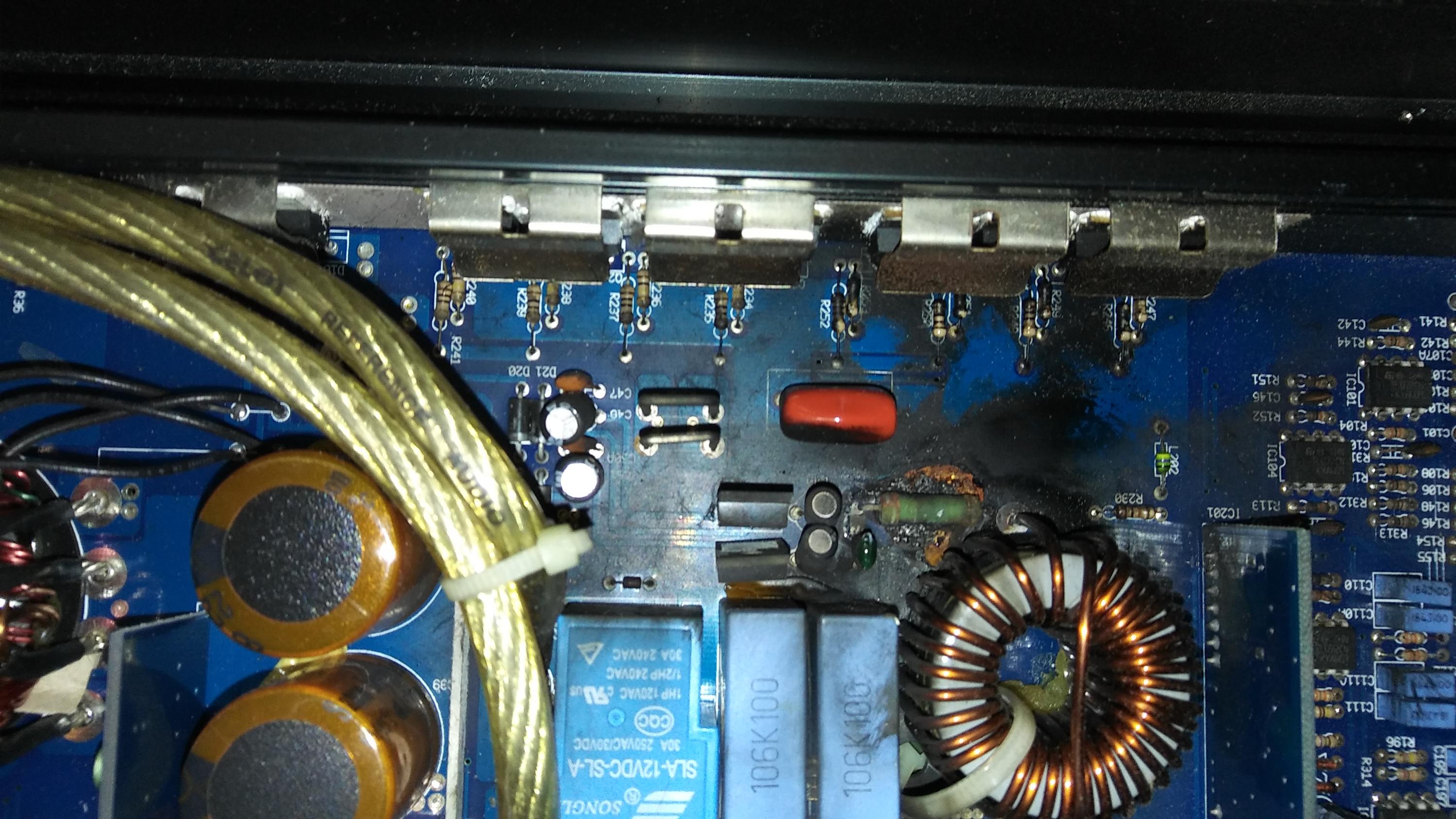

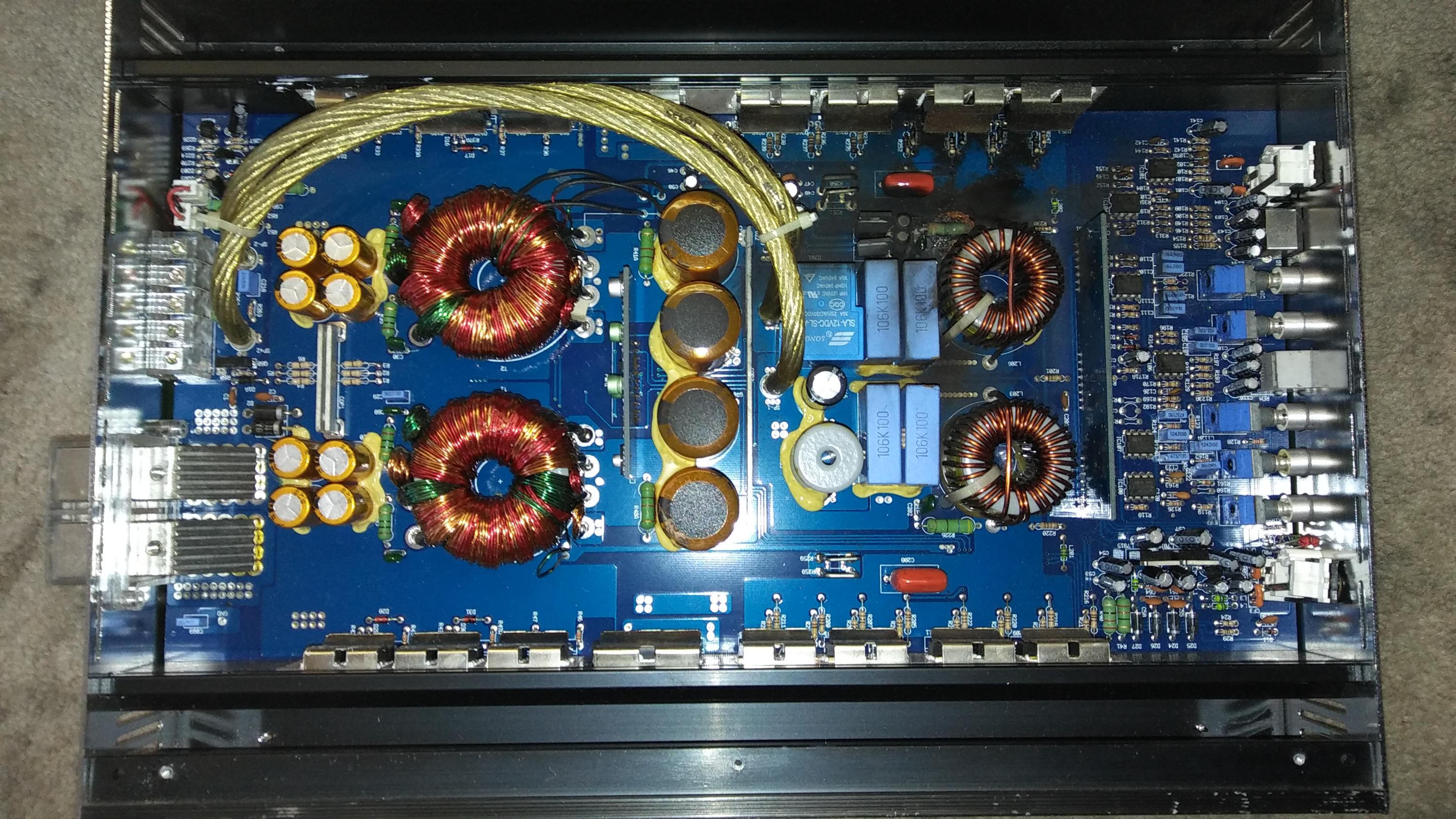

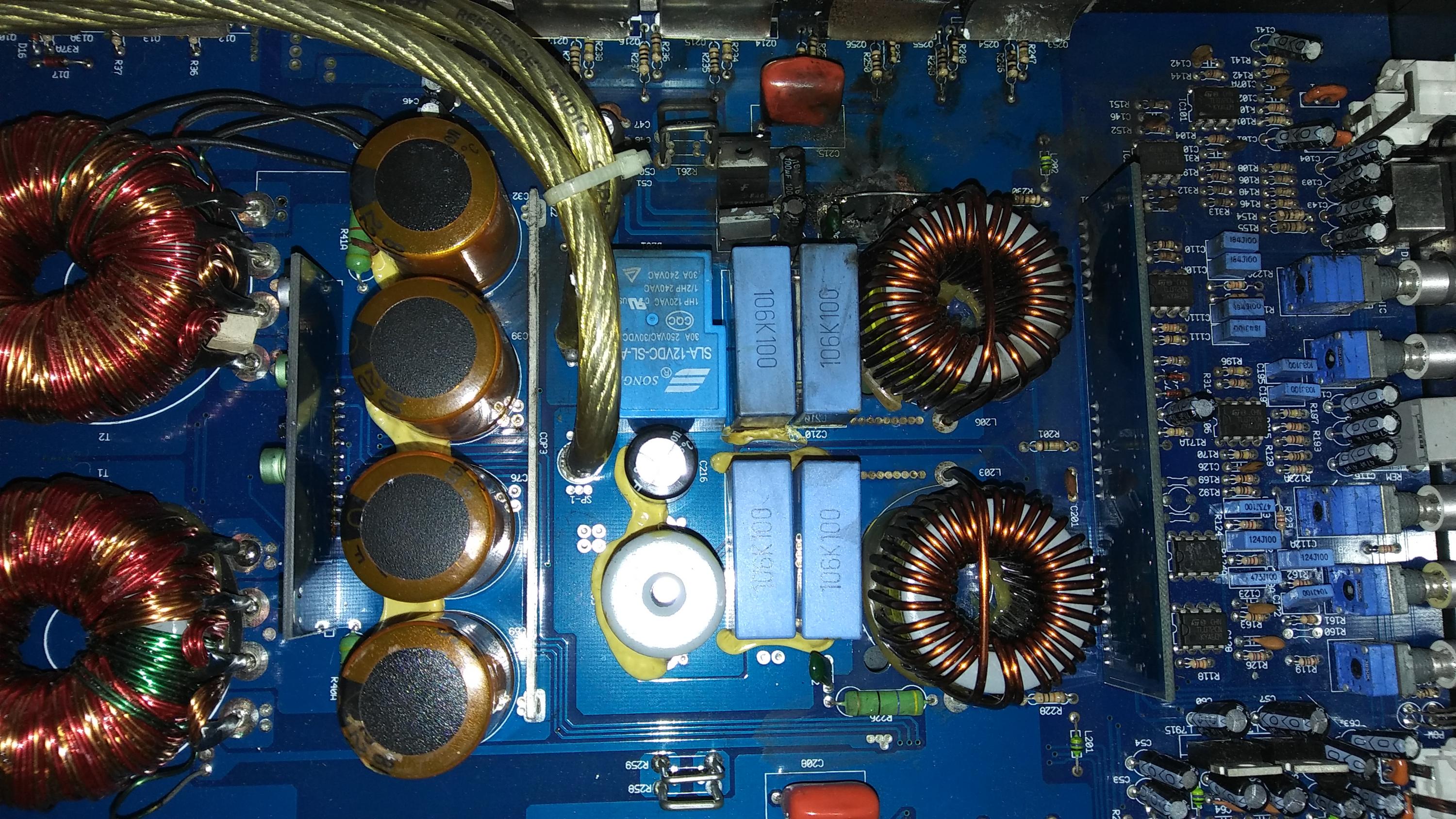

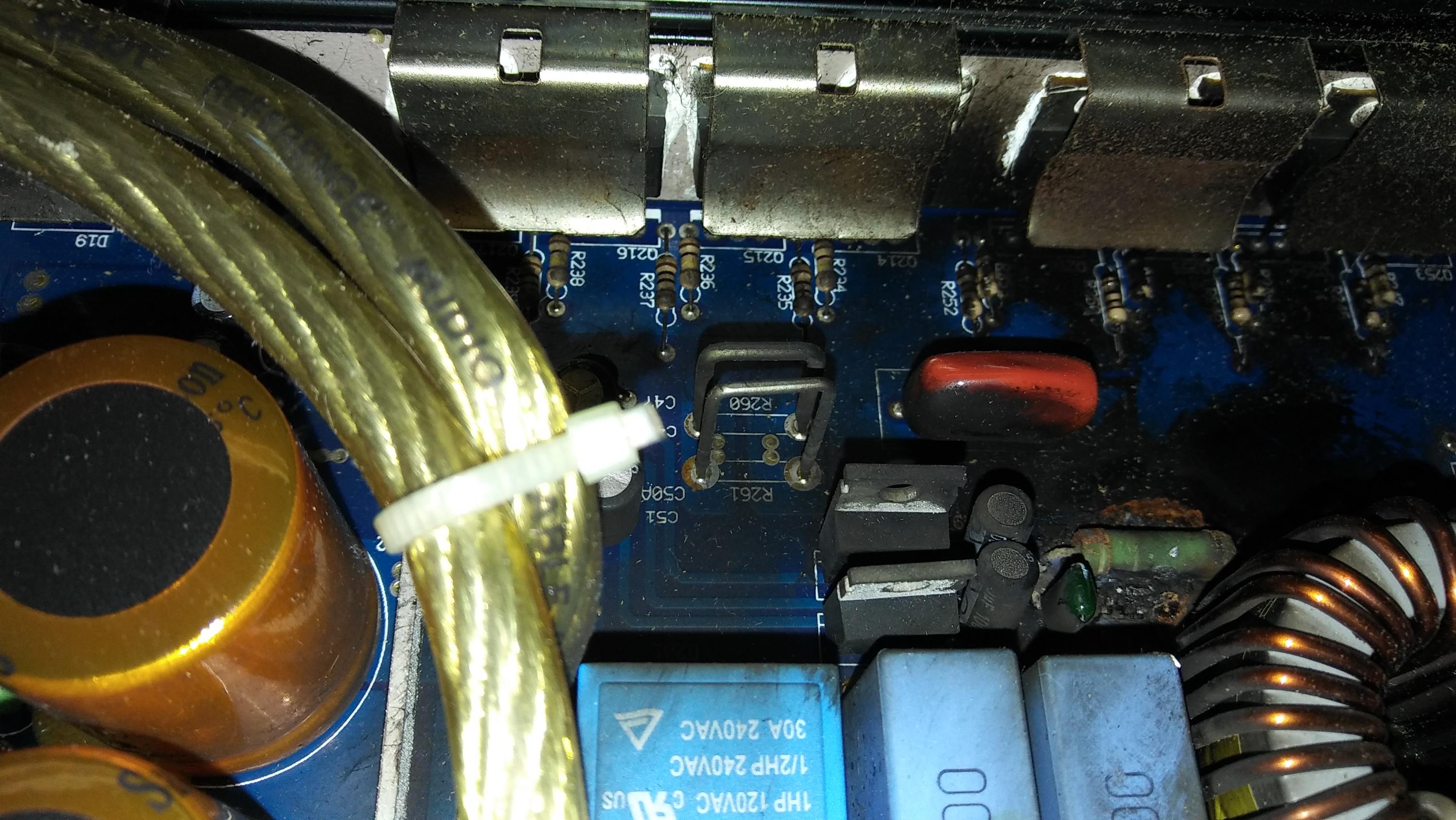

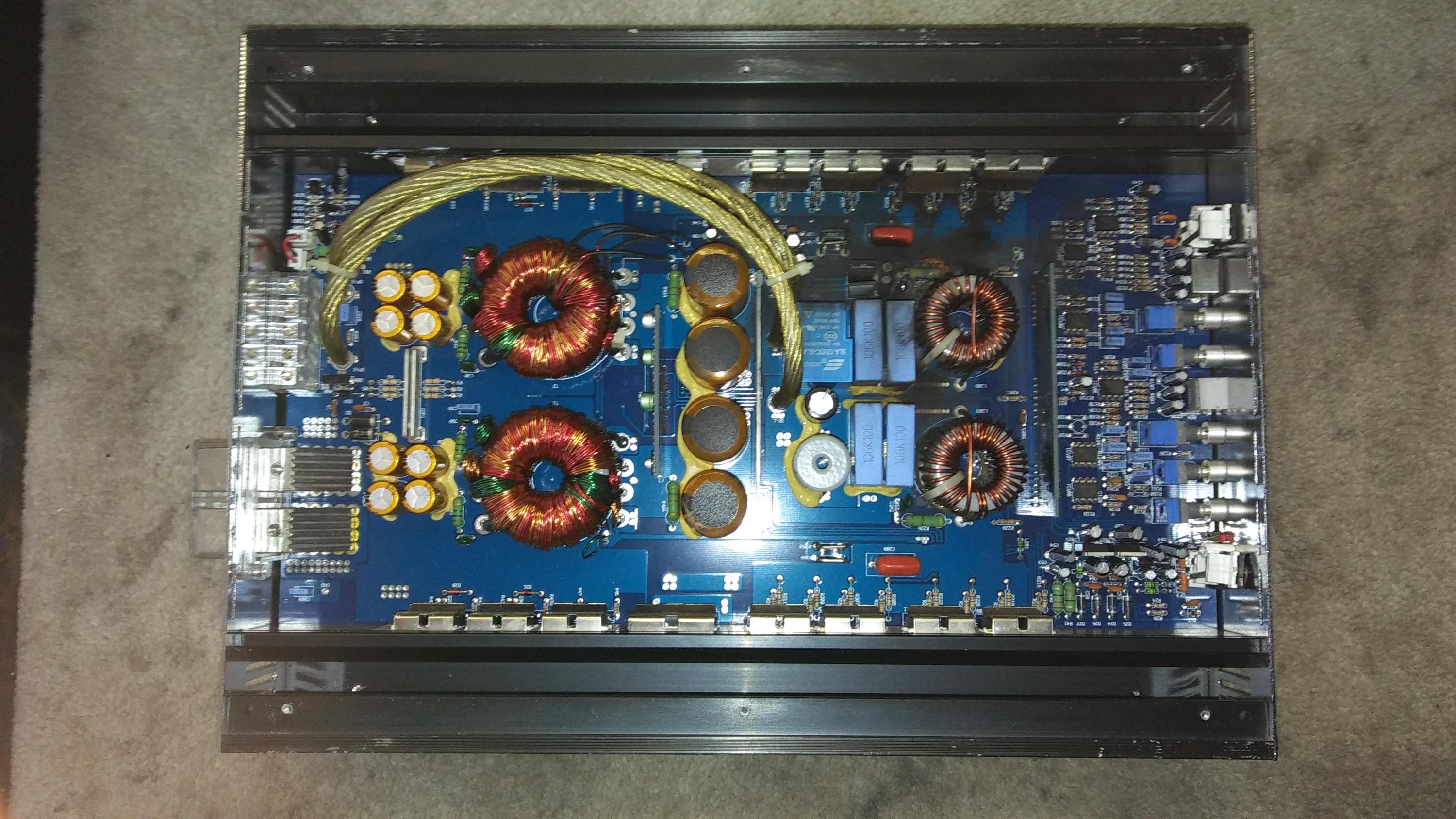

    Need Help! ...............on this Hifonics 2006D car Amplifier. came with burned (R225? other side R226 is 47 ohm 2W resistor) resistor, changed R still burned once again?
    I Put a piece wire then it works during A week, should I give back to customer like this? I can't keep on testing!

        That resistor and the cap that is connected in series (R226, C202 on the good side) with that cap looks to be ZOBEL network, you should find out if the cap has leakage resistance or not.

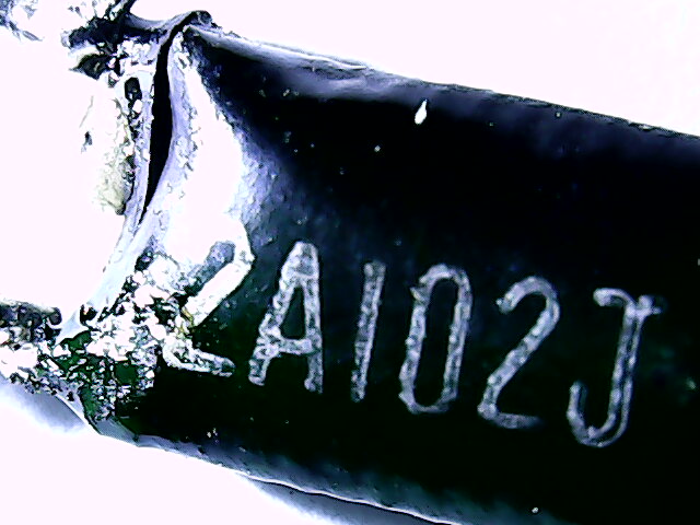

              Thank you very much , After changed this 102 Mylar capacitor, the 47 ohm resistor still gets hotter than the other side, So put wire jumper for customer to pick up. All I fix is put A piece of wire.

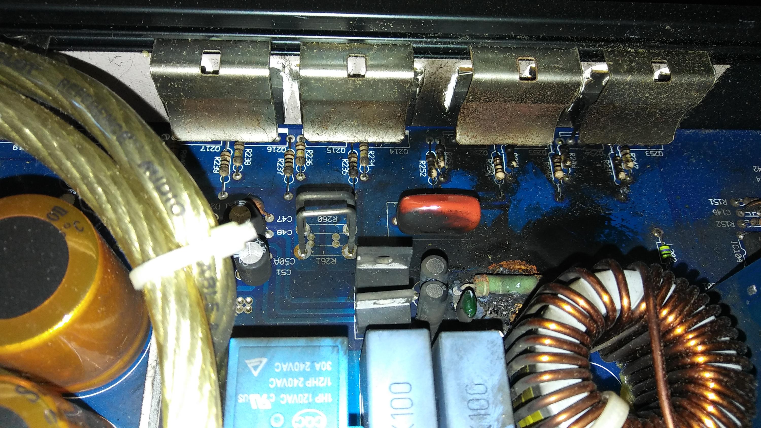

                            Since it is class D I would look the output with the Osc.scope to see if there is high frequency coming out at the output.
                            What wire jumper? Where?
                              Re: Hifonics Brutus BXi 2006D Car-Amp repair.
                              Customer already picked-up. I only have an old photo, the difference is i add a new 1000 pf Mylar capacitor and wire.
