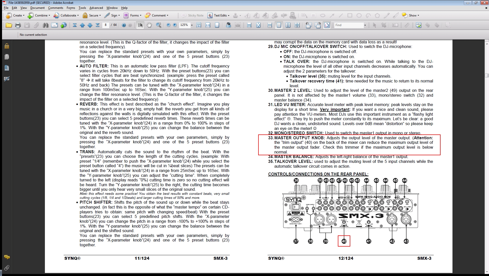

                  BTW, does the Trimpot #40 per manual page 11-12 have any effect on the MASTER 1?
