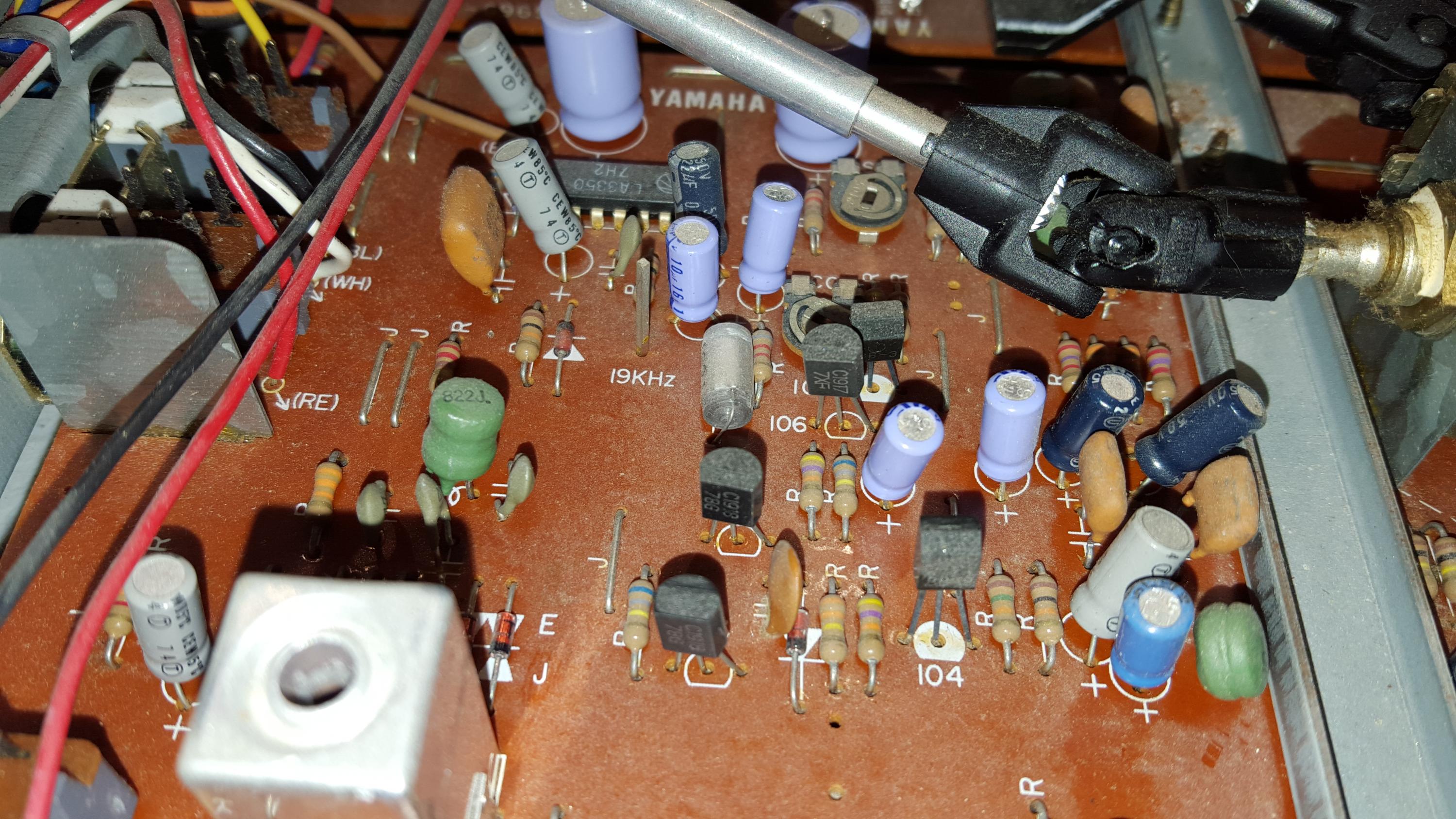

    Hello Badcaps community...
    This is my first post; hope I am dropping it in the right area. I apologies for being a bit long winded, but I am not sure how to go about explaining this any better....
    I have started a audio repair/restoration side business and frequently, I am running into an issue I am not sure how to resolve. When working on older stereo receivers, the original service manuals do not always tell you what specific types of capacitors are used . For instance, I have a Yamaha CR-420 I am working on now. The majority of the electrolytic caps are one color (light blue). But then there are some that are dark blue, black, orange. (I am specifically referring to just the electrolytic caps). The Service Manual lists all it's caps as "Electrolytic Capacitor Vert." However some also have RB, TS or MS (which I have no clue what they mean and there is no legend for it.) My main question is if there a way to look at a cap and tell what type of cap it is. IOW....'Standard' vs low leakage vs low ESR vs low impedance, etc. I have a basic cap tester that will give me an ESR and capacitance reading....just not sure how to test for low-leakage. So service manuals flat out say if a cap is low leakage, but not in this case. To make it even more confusing, this particular receive has a number of 1uF, 50V caps....so are light blue, some are dark blue. If they used different brands for different values, I can see why they would be different, but you would assume if it was the exact same value, it should be the same exact cap...and it is not. This tells me SOMETHING is different about the two. If there any way to look at a cap or cross reference it against some mystery database that will tell me what spec it is?

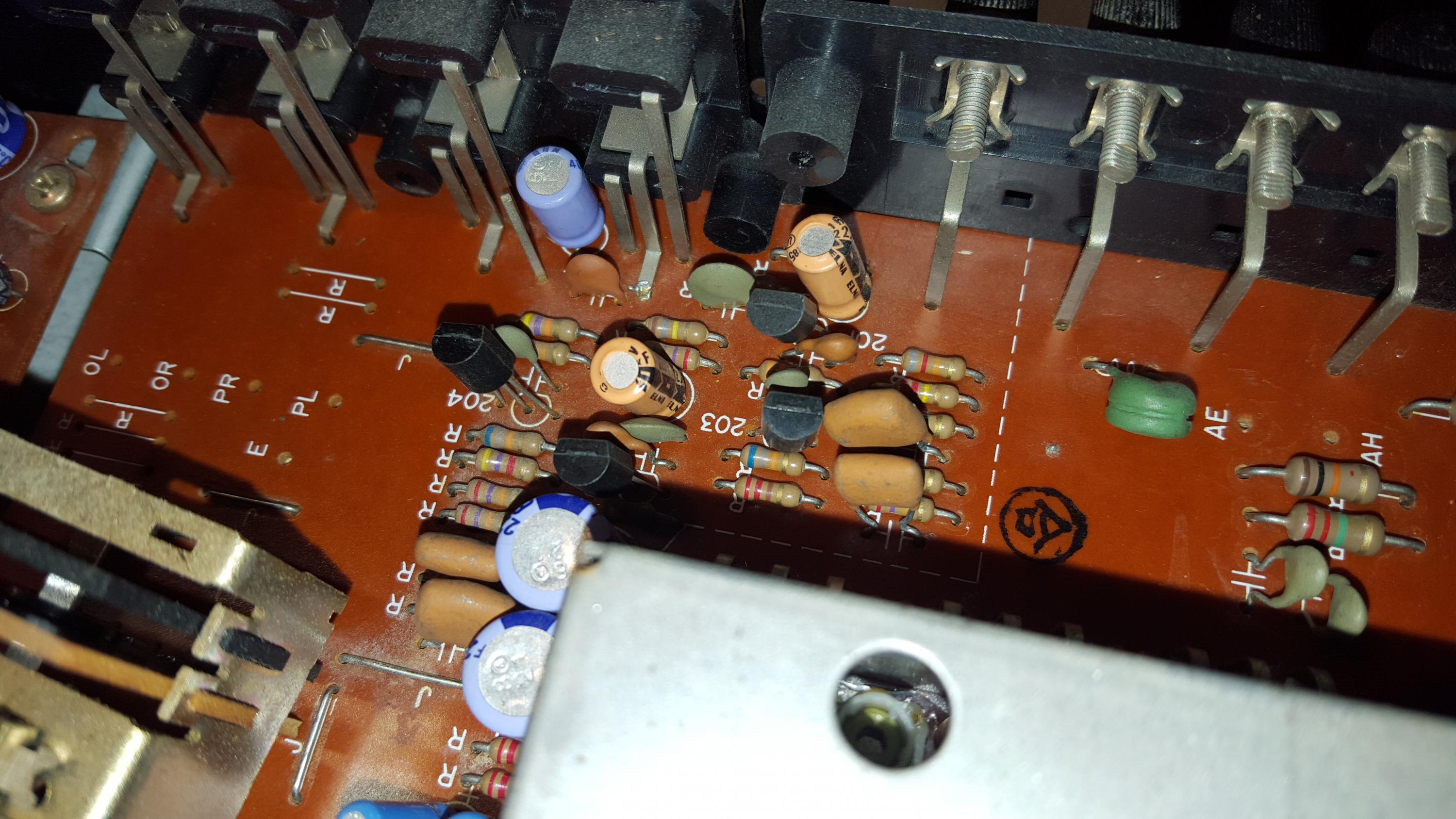

        The rule of thumb for seventies caps is, sky blue, orange, and yellow use low leakage or low noise. All others use low impedance. I generally use Nichicons from Mouser because they stock them in almost any value you want. PW I use for general purpose, KL for audio path, EP for bipolar because it has a 105 degree rating.
        You should replace all the electrolytic, they're 40 years old and pretty much done now. Replace the 2SA 726 transistors with KSA 992's, replace the 2SC 1313 transistors with KSC 1845. Those two are known to get noisy by now or will soon. Sometimes they fry themselves for no reason. I usually replace any with the black plaque on the legs. They usually have silver legs and have corroded massively by now. Sometimes the corrosion will go between the legs on the body. One thing I do is check the boards for running hot. Pioneer and Sansui were bad about that in the mid seventies. Usually I will form a solid 22 gauge in the shape of the copper runs and parallel them. Gives the currant an easier path and generates very little heat after that. I have seen some that cooked so long they were black.

              Here are some photos of what I am looking at. You see that there are a number of el caps that are of unique color. There are some (gray and blue) that have the exact same value (1uf, 50V, 85degree). Sigh...

                  If it were mine, I would probably look up those orange in the manual to see what they are used for, maybe replace with UKL. The rest are all UPW.
                  When you get around to doing transistors, buy a cheap meter with HFE. Always check each one that comes out and each one you put in. Match the HFE as close as possible but mostly your checking the legs. The manufacturers have changed them over the years and you can't always trust the data sheet. I had one that didn't work after I finished it. Checked everything all looked good. I decided to pull the transistors and found the originals were ECB and since the new data sheet said they were BCE I just installed them backwards. My HFE meter said they were BEC. So not only did I have to put them in backwards, I had to swap two legs. I used a piece of nylon tubing to keep the legs from shorting. It works fine now, I use it all the time. I checked my bag and found both BCE and BEC. The newest ones I ordered were the BEC.

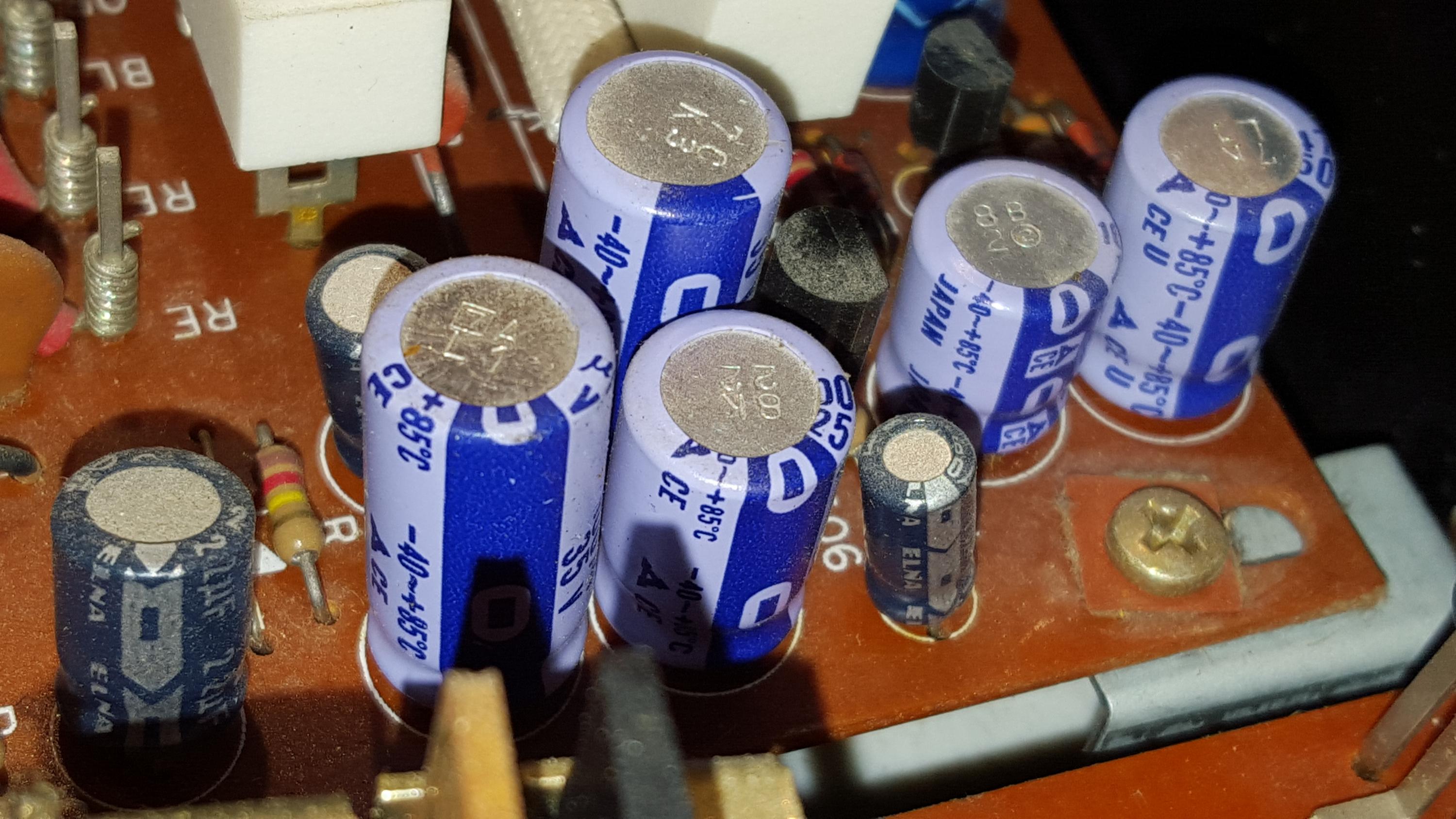

                    Ok...so I went through and broke these down by brand/series as best I could.
                    Orange caps: stamping: ELNA CERB (85 degree) 7D (U) ....these are for sure low leakage as I have identified the same ones used in a JVC receiver where they specifically called them out as L.L.
                    Light Blue: Matsushita/Panasonic CE -40~+85 degree....have no idea what a CE series is and have spent the morning trying to find out with no apparent luck.
                    Dark Blue: ELNA CEW (or CE-W...not sure) 85 degree; no other stamping...Other than it being an 'audio series' line....I can also find nothing really definitive here.
                    Large Power Blue Cap on Power Supply - Nichicon 470uF, 50V N7902L
                    Large Black main filter caps in PS - Another Elna CEW 85degree, but different color with these stampings: 6800uf, 35V 7N (F)
                    Plain Blue - Matsushita/Panasonic CE Series; 85degree (Two different colors for the same series??)
                    Gray - Elna CEW series again. 85degree with a 74 (T) stamping
                    Hope I am not making a bigger deal of this, but I just don't want to replace each 'type' with the correct one.

                                      Really, maybe apart from the low-leakage ones, don't sweat the whatever types/series the caps are
                                      105C rated should be fine ("even" general-purpose series), and Rubycon / Panasonic / Elna / ChemiCon make good stuff too - Nichicon aren't the be-all-end-all
                                      One thing to note, though, is that (monolithic) voltage regulators *might* not be 100% stable with (too) low-ESR caps on their output, especially considering they're relatively old-ish designs. So you might not wanna go too "crazy" on those, unless you enjoy risking oscillation - i wouldn't
