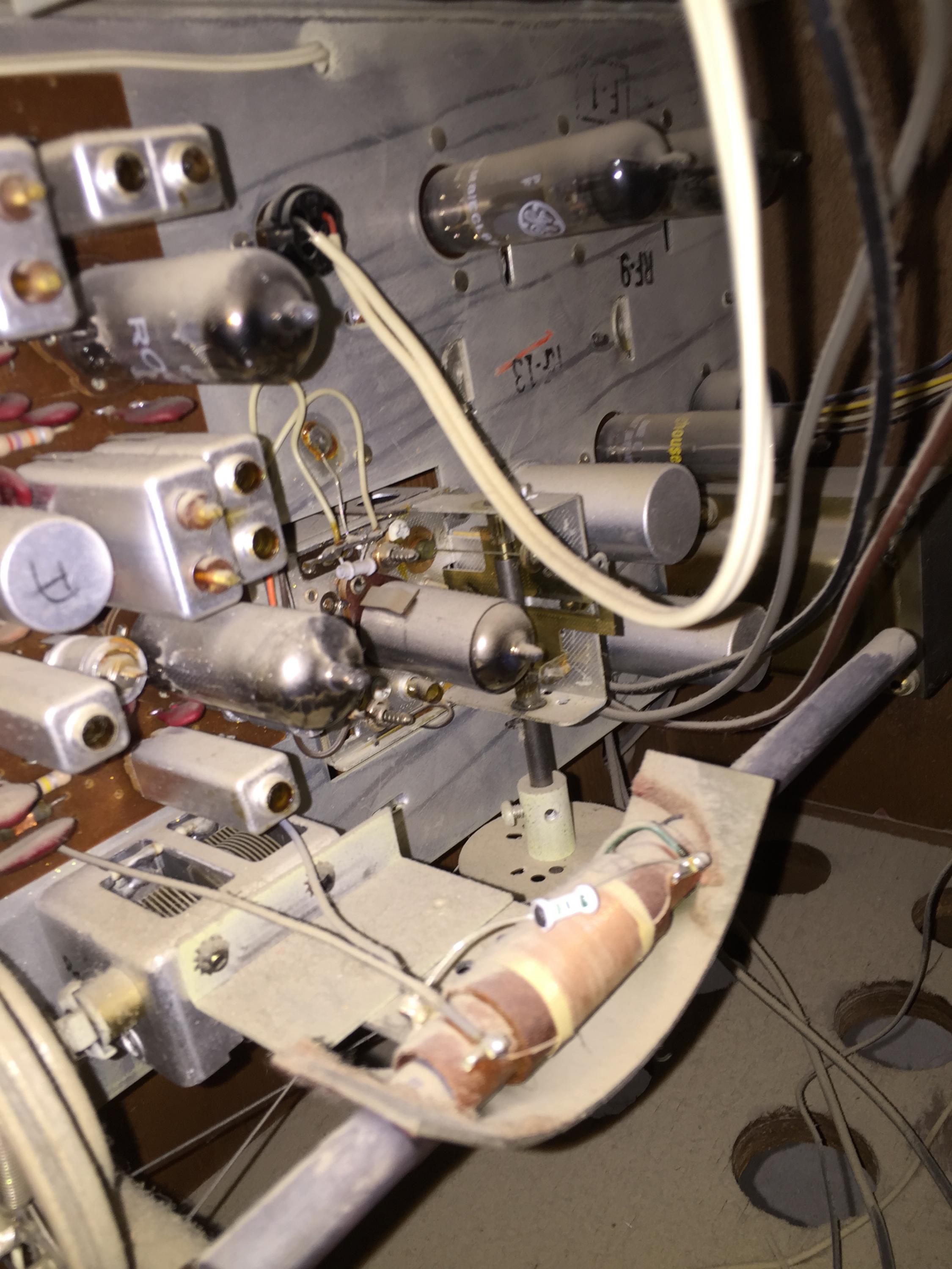

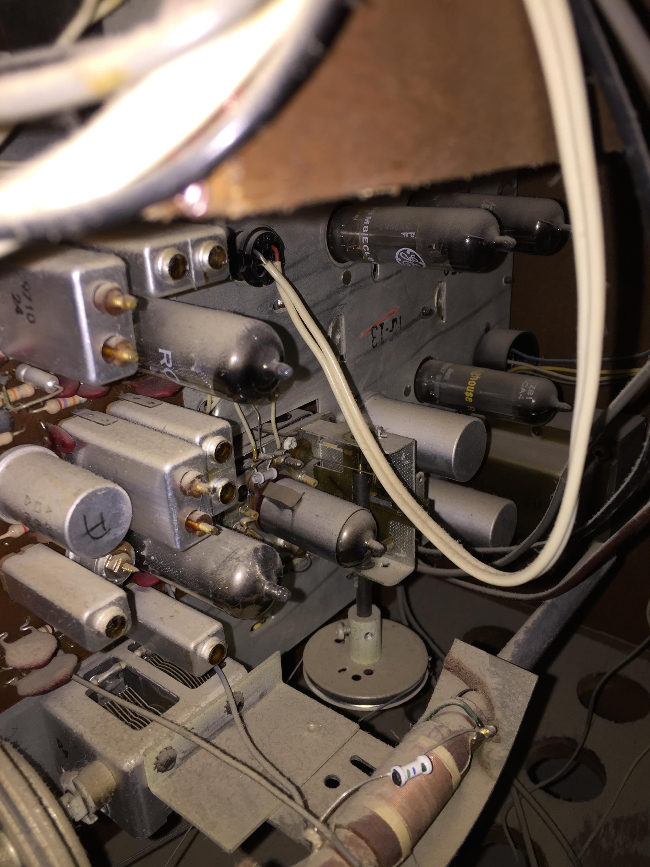

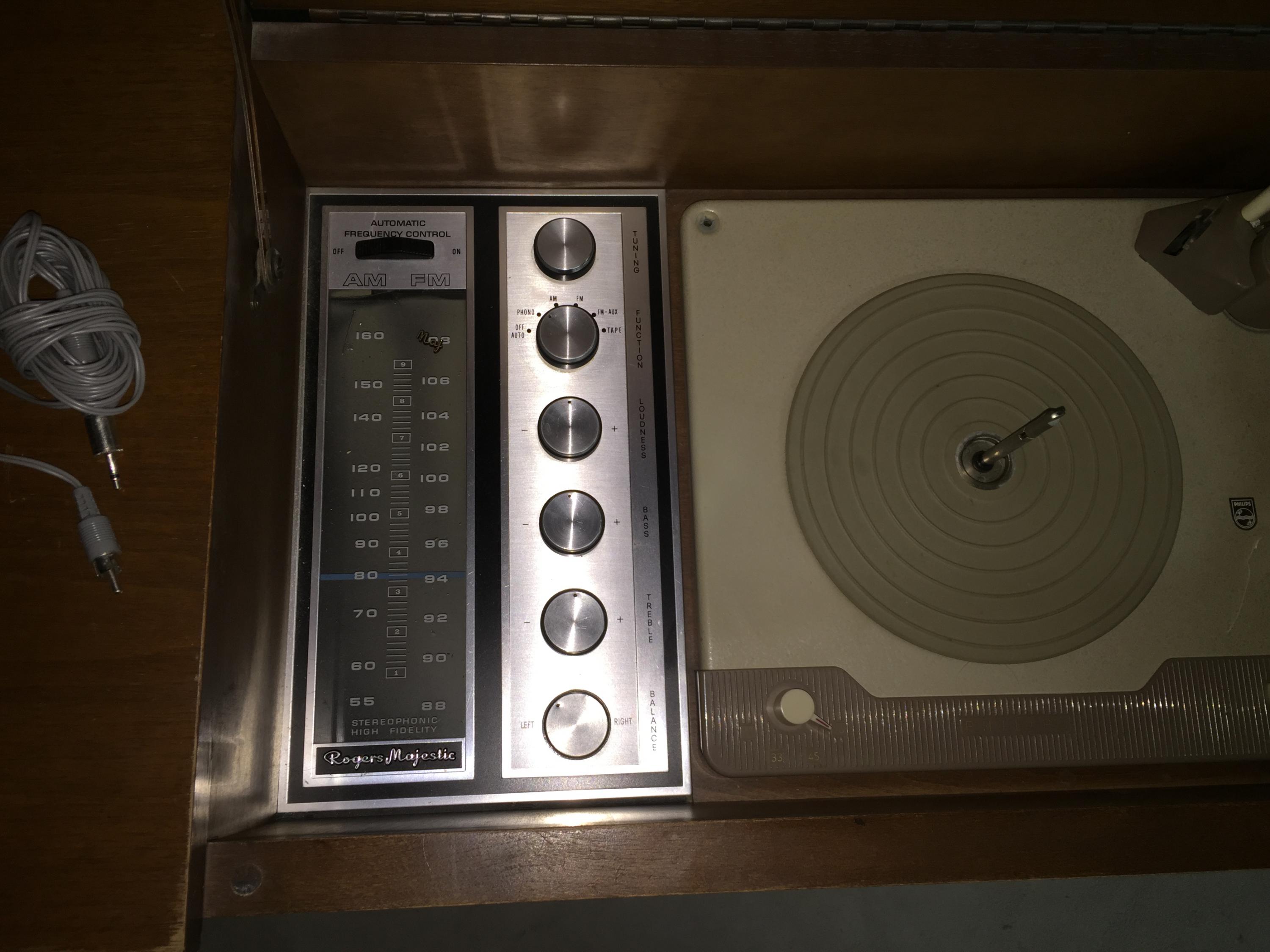

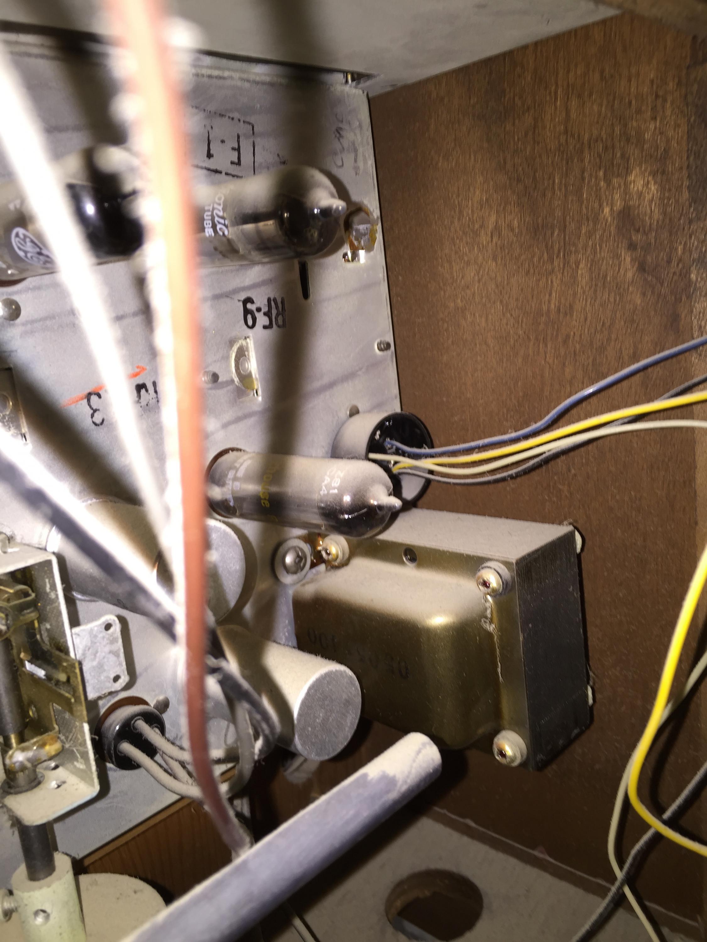

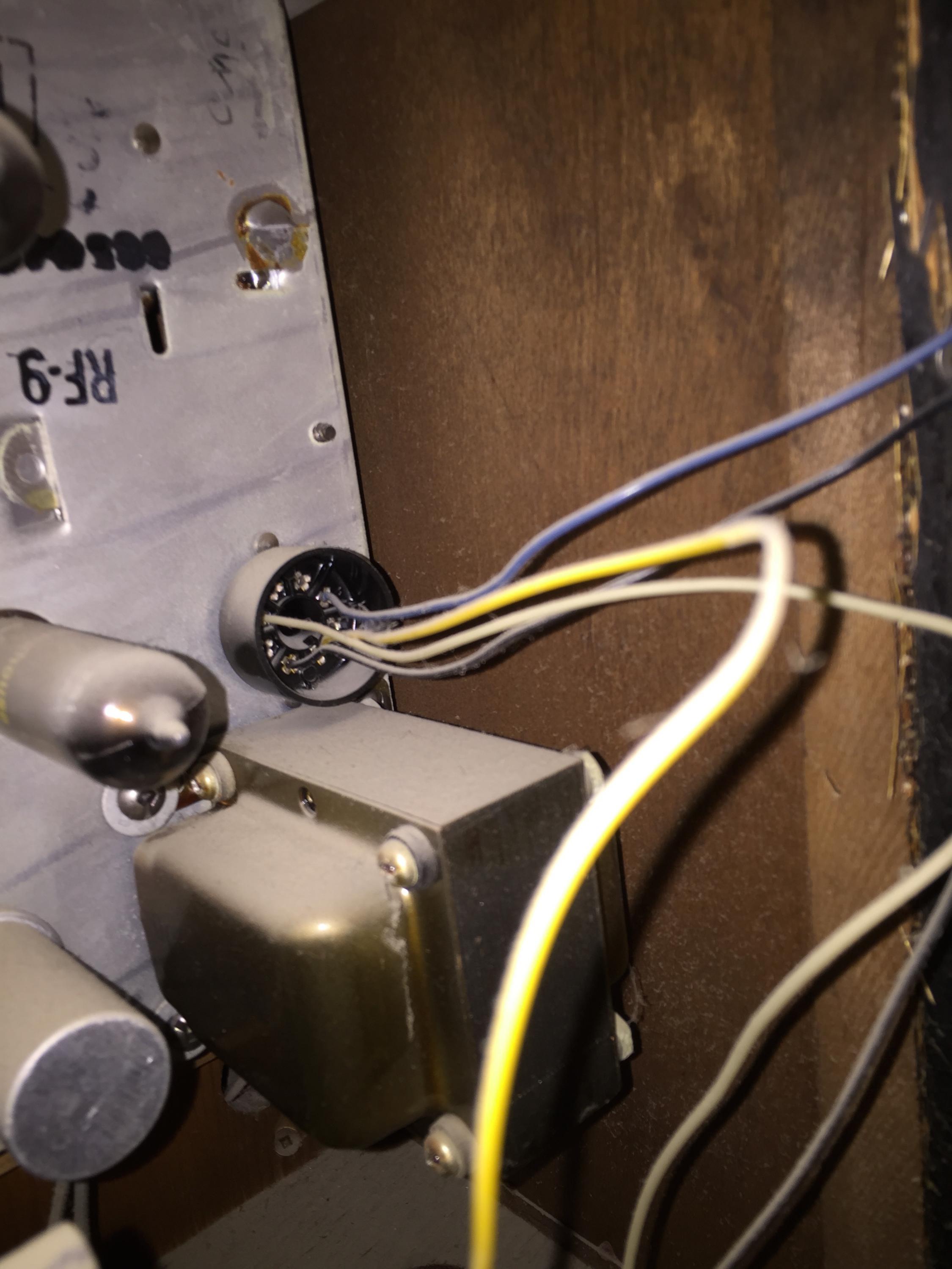

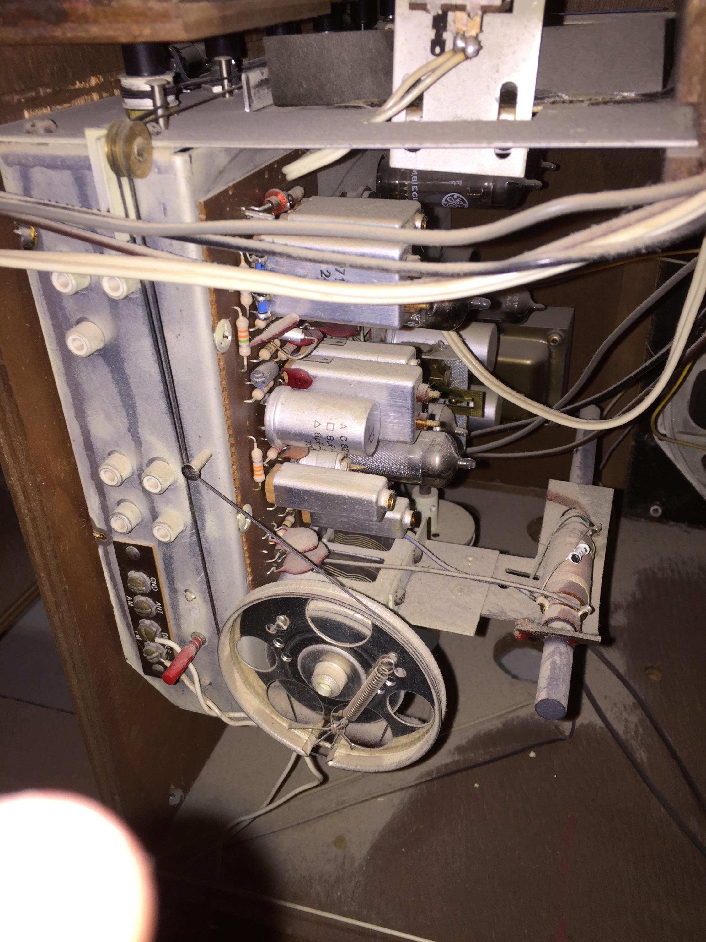

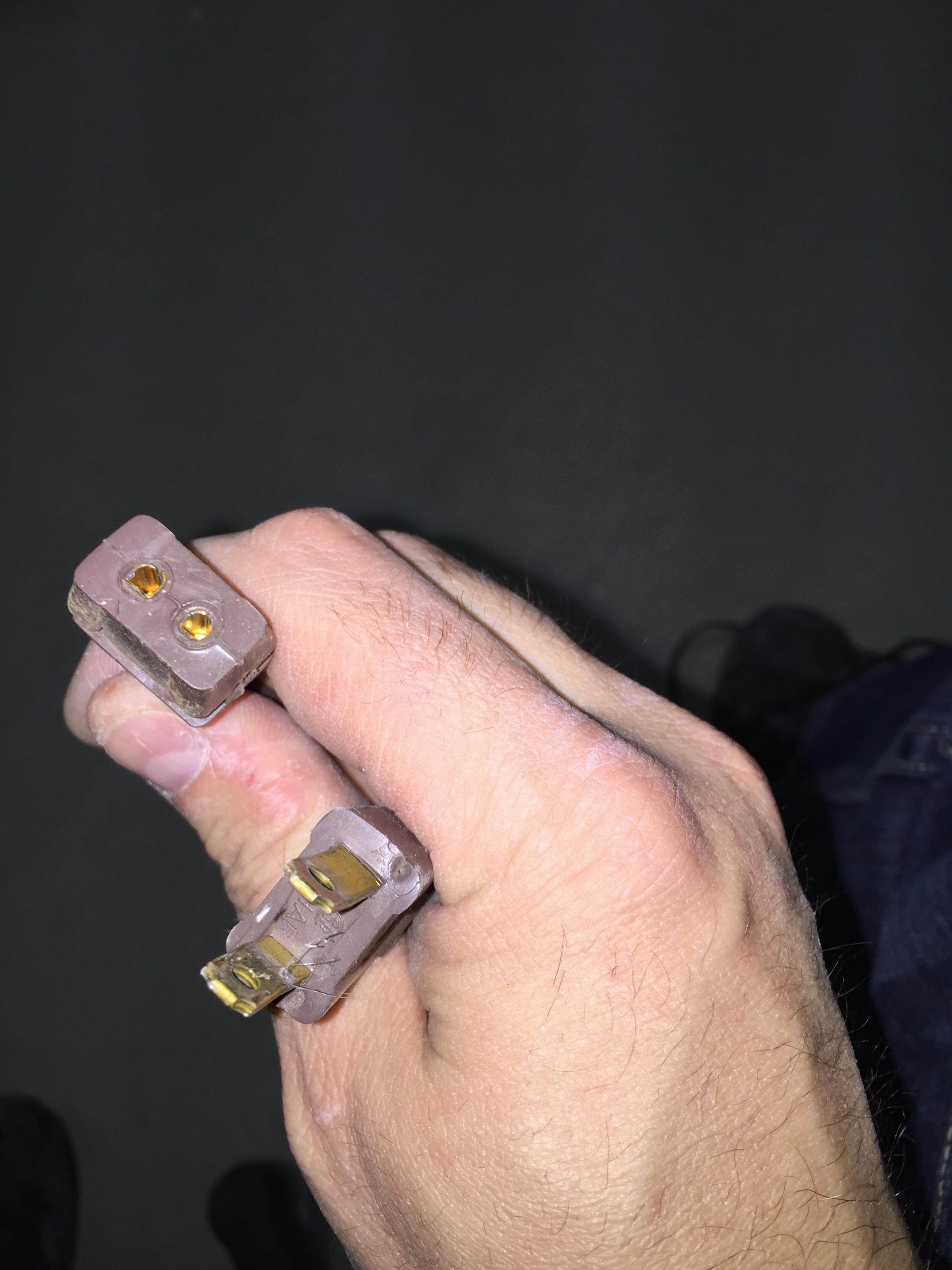

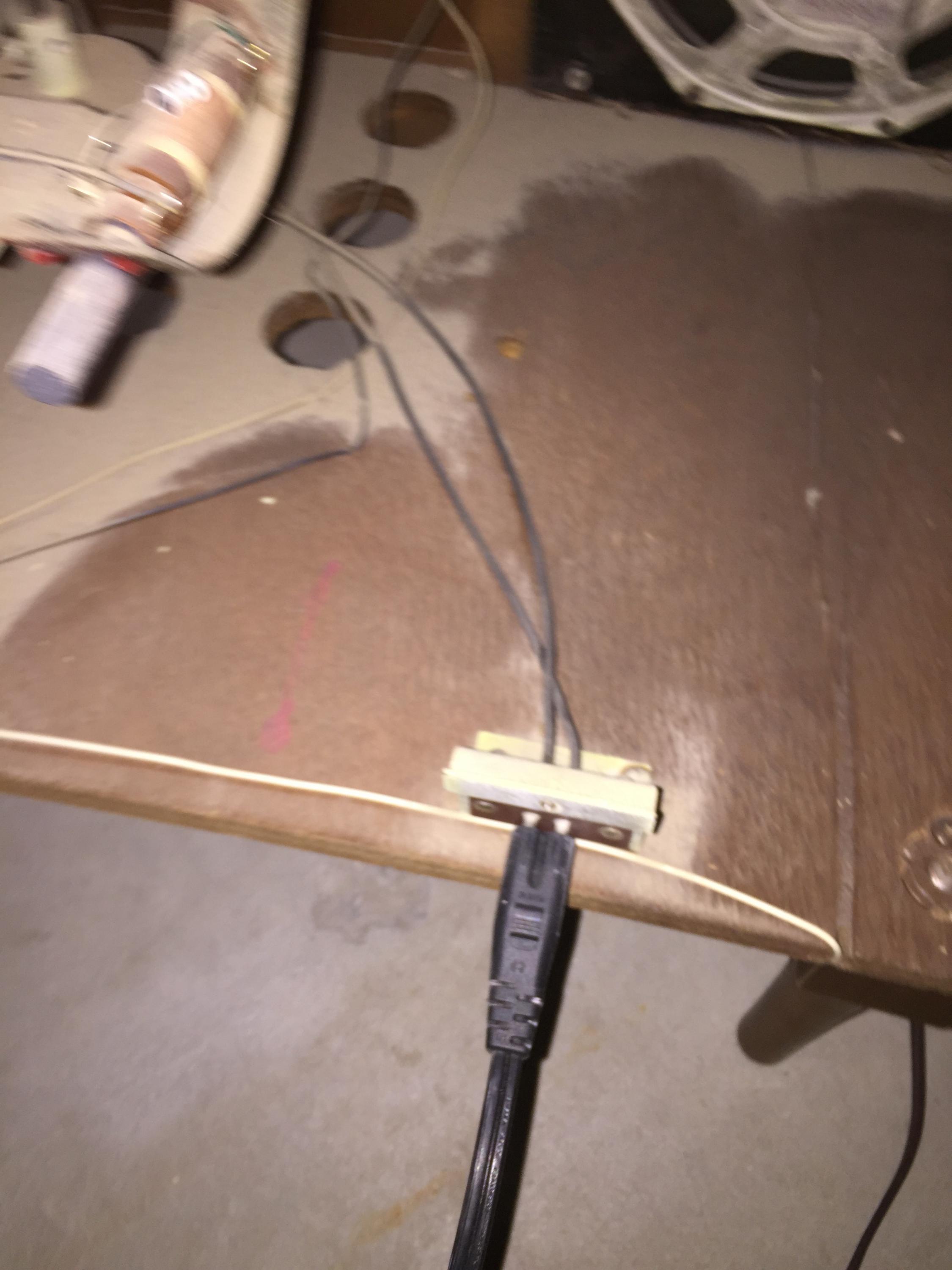

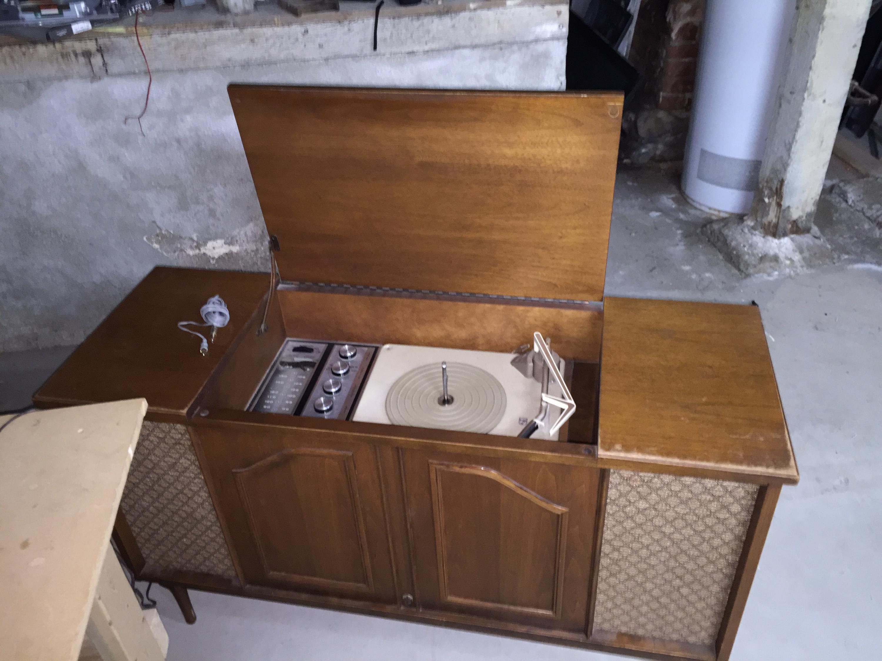

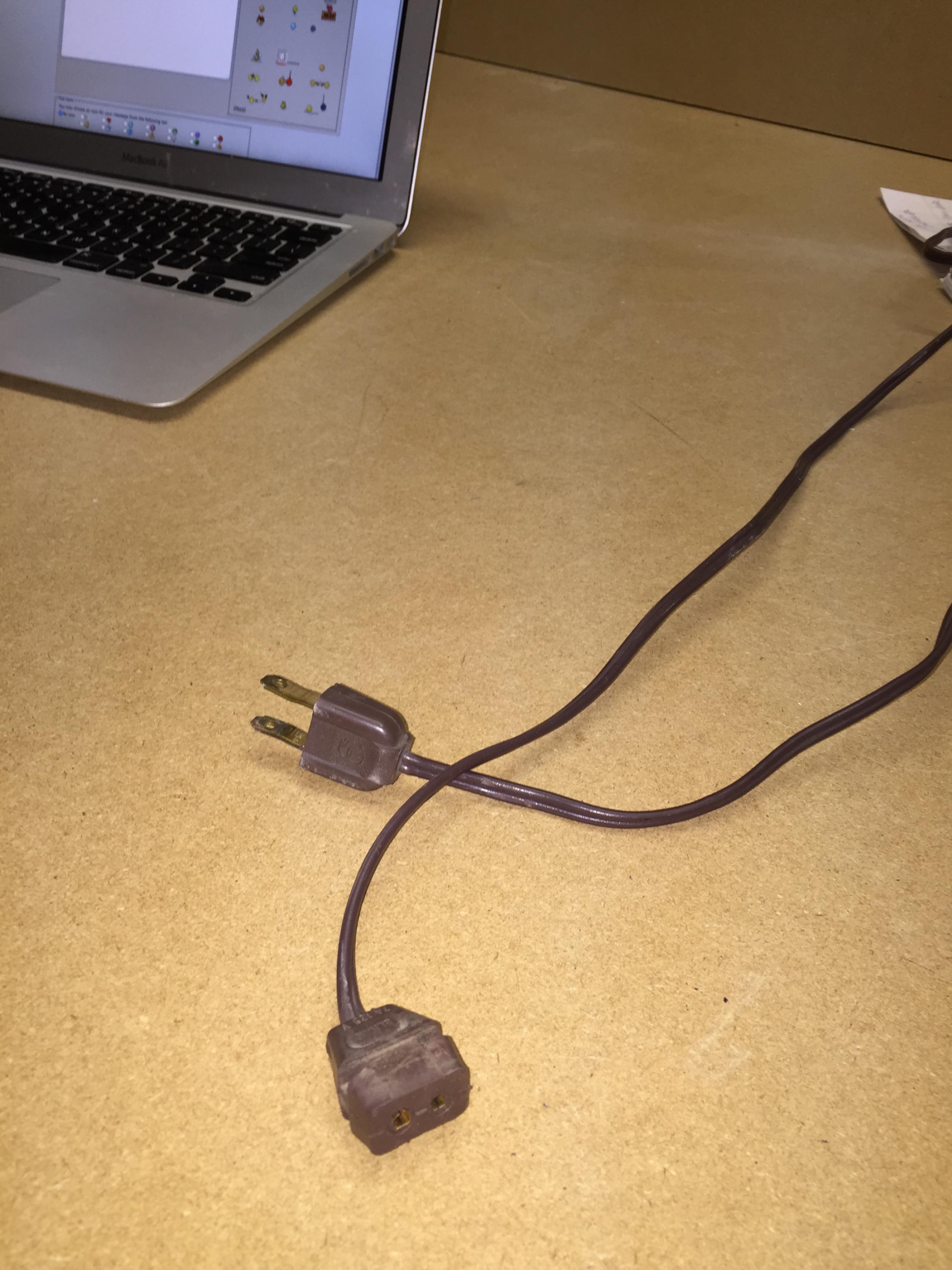

I got a very old cabinet style stereo. The customer says that they get shocked when using the radio. I took some pics of the unit and power cord. Would the shock come from a bad ground or possibly the power cord is bad. Any ideas?

Only 2-prong non-polarized cord so there is no safety GND on the chassis.
Can we see better pictures of the chassis?
There should be a paper sticker that gives you the tubes layout and full chassis model on the console some where. It has been since the early 70's that I worked on one of these consoles.Never stop learning

It may have one of those paper cap connected between the AC and the chassis which they do fail badly.

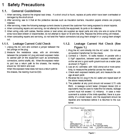

You do have some kind of AC leakage current. You will also see difference reading if you reverse the plug when you plug it into the AC socket.Never stop learning

Originally posted by tech2014 View PostWould it be possible to build a 3 prong modern power cord for this cabinet, and would this fix the AC leakage and shocking problem.Never stop learning

If you're reading 1.2vac from chassis to actual ground at an outlet then that's about what you'd see from neutral to ground due to the house wiring resistance (neutral and ground are bonded at the panel). That is of no concern and probably not causing the shocks. It doesn't indicate leakage or a bad transformer either.

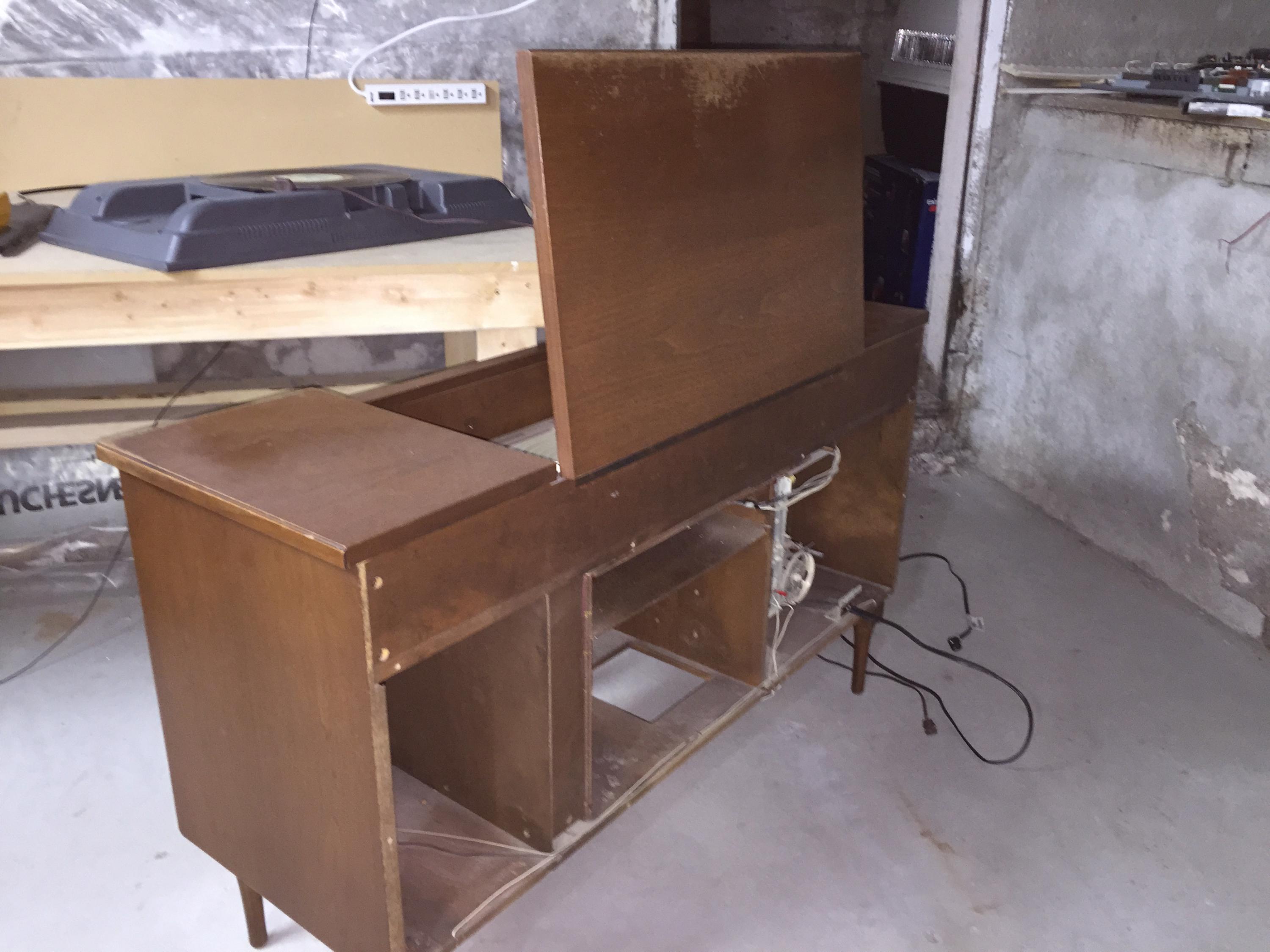

That's a EZ81/6CA4 dual rectifier tube with a 6v heater next to the AC power transformer. That tells me that the the power transformer has a primary winding for 117v and at least two secondaries, one at 6.3v for tube heaters and one somewhere between probably 90v and 150v for the B+ voltage. But the primary winding is we want to deal with.
Each side of the transformer primary is tied to a side of the ac supply, one via the power switch on the supposed "hot" side. One is also connected to the metal chassis, that's "supposed" to be neutral when the 2 wire cord is plugged in the "right" way. To wire a three wire cord with safety ground cord to it, disconnect the side of the transformer primary from the chassis and wire that lead to the neutral wire (white) in the cord, wire the other primary wire to the hot wire (black) in the cord via the switch, then connect the green wire of the cord to the chassis. Of course you'll have to pull the chassis out of the cabinet to do this. You're also gonna want to replace those old power supply filter caps, they are well beyond their life expectancy.Last edited by SteveNielsen; 12-29-2015, 07:58 PM.

I have never seen these consoles with power transformer has the neutral wired to the chassis especially when it is uses non polarized plug.
You can easily verify that by checking the resistance between the chassis and the AC plug.Last edited by budm; 12-29-2015, 08:11 PM.Never stop learning
Re: Old Stereo Cabinet shocking people
Yeah, you're right. It generally isn't tied directly to chassis but through a capacitor to chassis, which isn't much of a safety measure at all and in some circles called the "death cap". I don't think they've actually caused anyone's death but sure pack a wallop nonetheless.

You probably do have a shorted or leaky paper cap on the input. But my question is where are you touching when you receive the shock? The radio tuning knobs and face plate all appear to be plastic. Maybe the metal chassis of the turntable is acting like a return.Is it plugged in?
The turntable is also attached to the chassis.Never stop learning
