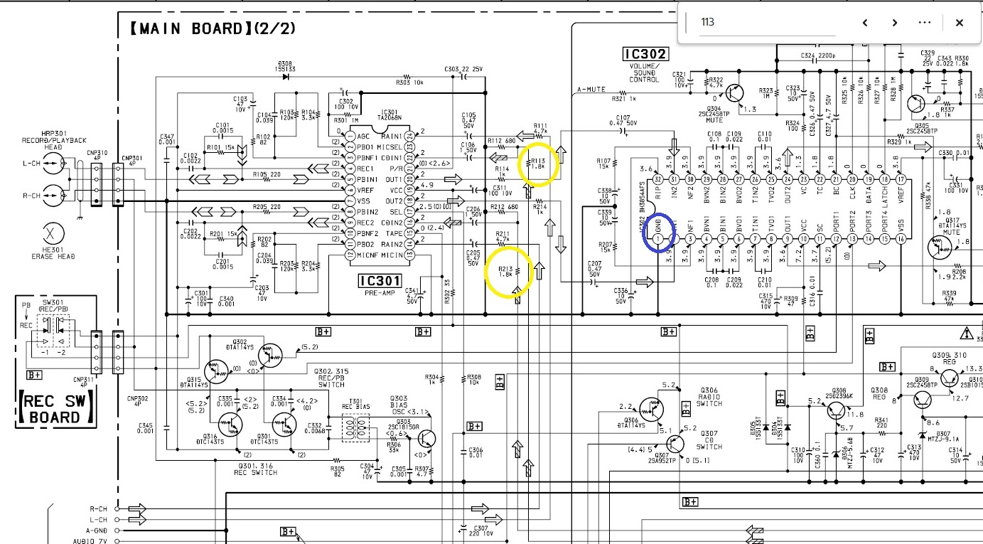

    Hi.
    I bought a Cheap HIFI to use as my PC output and speakers and forgot to check if it had an input. It doesn't.
    Is there any way to add a stereo input. I have a bunch of Phono sockets I am not using.
    Where in the circuit is the best place to solder the 3 stereo input wires?
    This is the model and schematics:
    https://www.manualslib.com/manual/91...7l.html#manual

    r108 r208 should do it

      Re: Add Stereo Input To Hi-Fi (Sony SONY PMC 107L)
      i wouldnt - that will bypass the controls.
      it would be better to tap the signal from the tape or cd section so you still have use of the controls - and keep the tuner working
        • 31124
        tape:
        R105 & R205
        cd:
        R113 & R213
          Originally posted by stj
          tape:
          R105 & R205
          cd:
          R113 & R213
          Thanks everyone.
          Where do i connect the negative wire?
            Can i solder the negative wire to any suitable ground on that main board.
            Eg: On the volume control ground marked blue circle in the jpeg?
              • 31124
              anywhere nearby that is 0v/gnd on the schematic
