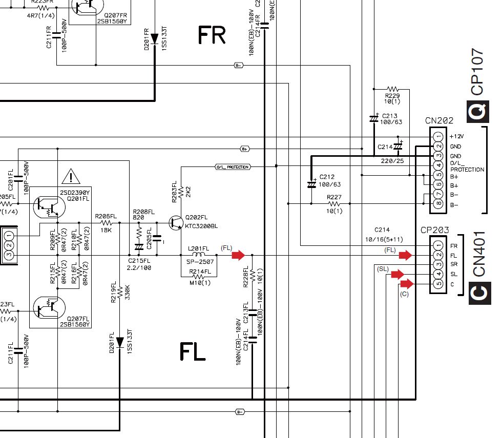

Pioneer VSX-520-K Protection problem
  • DjKrish
    • Oct 2012
    • 354
    • SG
    Re: Pioneer VSX-520-K Protection problem
    Originally posted by tibimakai
    Maybe a reset at this point, it wouldn't hurt either.
    Haha tried that already, still same with DC msg.
    • rievax_60
      • May 2012
      • 897
      • australia
      Re: Pioneer VSX-520-K Protection problem
      Most amplifiers rely on a few certain screws to ground the input sockets to the rear panel.
      If these screws don't provide a contact, the amp wont work properly.
      • DjKrish
        • Oct 2012
        • 354
        • SG
        Re: Pioneer VSX-520-K Protection problem
        Originally posted by rievax_60
        Most amplifiers rely on a few certain screws to ground the input sockets to the rear panel.
        If these screws don't provide a contact, the amp wont work properly.
        Its all tight.
        • DjKrish
          • Oct 2012
          • 354
          • SG
          Re: Pioneer VSX-520-K Protection problem
          Can i get some assistance on CP107 on how to measure those pins? I believe B+ and B- should be 100V. But when measure B+ and AGND, there's reading about 50v, is that a leak of DC on main board?
          Last edited by DjKrish; 09-10-2015, 06:42 AM.
          • rievax_60
            • May 2012
            • 897
            • australia
            Re: Pioneer VSX-520-K Protection problem
            Measuring 100v between B+ and B- rails is normal if the rails measure +50v and -50v respectively to ground.
            • DjKrish
              • Oct 2012
              • 354
              • SG
              Re: Pioneer VSX-520-K Protection problem
              Originally posted by rievax_60
              Most amplifiers rely on a few certain screws to ground the input sockets to the rear panel.
              If these screws don't provide a contact, the amp wont work properly.
              Originally posted by rievax_60
              Measuring 100v between B+ and B- rails is normal if the rails measure +50v and -50v respectively to ground.
              Ok i have measured the amp block thoroughly and there's no faulty components on it but when i plug it in to main board via CP107, then there's DC leak via CP203 on speaker assy. Almost all the legs has DC leaking. My friend said, if i pull out CP107 from amp to main, it will disconnect the amp but the receiver will turn on fine provided theres no shorts on main board to cause a dc protection. Looks like the DC is still present on speaker assy relays. Sighs
              • rievax_60
                • May 2012
                • 897
                • australia
                Re: Pioneer VSX-520-K Protection problem
                What DC voltage reading are you seeing? And is it on all amplifier outputs?
                • DjKrish
                  • Oct 2012
                  • 354
                  • SG
                  Re: Pioneer VSX-520-K Protection problem
                  I see dc around 47v on FR,FL,C,SR,SL connector that goes to speaker assy
                  • rievax_60
                    • May 2012
                    • 897
                    • australia
                    #29
                    Re: Pioneer VSX-520-K Protection problem
                    Look for something common to all amplifiers like the - rail that feeds the emitters of the voltage amplifier transistor via R227 10 ohm. And also the +12v rail that goes to the 7.5k resistors that connect to the input transistors' emitters.
                    Last edited by rievax_60; 09-10-2015, 08:29 AM.
                    • rievax_60
                      • May 2012
                      • 897
                      • australia
                      #30
                      Re: Pioneer VSX-520-K Protection problem
                      If you find nothing wrong then measure the voltage at both ends of the input capacitors, C206FL, C206FR.
                      • DjKrish
                        • Oct 2012
                        • 354
                        • SG
                        #31
                        Re: Pioneer VSX-520-K Protection problem
                        Hey folks, im back after a long time due to work load. OK as for updates, i manage to fix the amp as on the power amp side, a couple of regulators seems faulty triggering the protection circuit. Now the amp powers up perfectly, all relays clicking fine.
                        BUT, I measured using DMM @ 200mV setting,
                        Left speaker output there's -31.3mV present while the right side -7mV dc offset present. What do i do now? Checked the big caps, they read just fine and measure as it should using a cap meter.
                        All the driver amp transistors seems to be fine as well as none blown or short.
                        Update : All surround speakers and center speakers, L&R speaker outputs are working perfectly fine with all under 10.0mV. Weird.
                        Could it be the big caps failing intermittently?
                        Last edited by DjKrish; 05-10-2016, 04:27 AM.
                        • DjKrish
                          • Oct 2012
                          • 354
                          • SG
                          #32
                          Re: Pioneer VSX-520-K Protection problem
                          The amp at cold start, right channel has at least -30mV and left shows -0.00mV. After about 10 or 20 minutes, right channel resets back to 0.00mV. May i know why is this? Anyone can help?
                            #33
                            Re: Pioneer VSX-520-K Protection problem
                            30mV offset is not going to trip the speaker protection relay, the trip point is usually around a Volt or two to trip the protection circuit.
                            • DjKrish
                              • Oct 2012
                              • 354
                              • SG
                              #34
                              Re: Pioneer VSX-520-K Protection problem
                              Originally posted by budm
                              30mV offset is not going to trip the speaker protection relay, the trip point is usually around a Volt or two to trip the protection circuit.
                              But is it normal for -30mV to present @ speaker terminal? Ive seen + and above dc offset, but mine is minus offset. Thats the weird part. Sound wise no problem, still kicking good.
                              Minus 30mV present when volume at zero with no signal input and speakers unplugged. Ive let it run for couple of hours, still showing -30mV. Only the right channel. Left seems fine.
                              • kevwag
                                • Nov 2016
                                • England
                                #35
                                Re: Pioneer VSX-520-K Protection problem
                                Originally posted by rievax_60
                                Most amplifiers rely on a few certain screws to ground the input sockets to the rear panel.
                                If these screws don't provide a contact, the amp wont work properly.
                                That's an interesting theory, but it would have to be a pretty bizarre set of circumstances for poor earthing on an input at the pre-amp end to cause DC on the output stage of the power amp!
                                That said, I just managed to cause DC on the INPUT of my VSX-520, taking out C206C with a loud bang! This is a good example why you should use the service manual, even when you're experienced and know what you're doing. I dived in without the manual, replaced the output transistors and also needed to replace the protection transistors as they were also dead-short. It has been well over a decade since I worked on electronic repair of this type and it seems things have moved a long way...
                                The protection trannies were marked C3200 and A992, which, back in my day you could have safely assumed would have meant 2SC3200 and 2SA992 but not now apparently! I should have used KTC3200BL and KSA992F - these codes didnt exist back when I did this for a living! I Feel a bit silly for not having checked - lesson learned the hard way!
                                I don't need the centre channel right now so I'm going to isolate B+ and B- for that channel, pull out the incorrect trannies and try again, if the rest still works I can order the right parts and use it 4.1 until they arrive lol
                                • srt1
                                  • Aug 2013
                                  • 177
                                  • india
                                  #36
                                  Re: Pioneer VSX-520-K Protection problem
                                  Originally posted by DjKrish
                                  Hey folks, im back after a long time due to work load. OK as for updates, i manage to fix the amp as on the power amp side, a couple of regulators seems faulty triggering the protection circuit. Now the amp powers up perfectly, all relays clicking fine.
                                  BUT, I measured using DMM @ 200mV setting,
                                  Left speaker output there's -31.3mV present while the right side -7mV dc offset present. What do i do now? Checked the big caps, they read just fine and measure as it should using a cap meter.
                                  All the driver amp transistors seems to be fine as well as none blown or short.
                                  Update : All surround speakers and center speakers, L&R speaker outputs are working perfectly fine with all under 10.0mV. Weird.
                                  Could it be the big caps failing intermittently?
                                  Can you explain what cause the DC offset on Speaker output?
                                  • srt1
                                    • Aug 2013
                                    • 177
                                    • india
                                    #37
                                    Re: Pioneer VSX-520-K Protection problem
                                    Originally posted by rievax_60
                                    If you find nothing wrong then measure the voltage at both ends of the input capacitors, C206FL, C206FR.
                                    Hi i Hav pioneer VSX 522 it have DC offeset on all channel can i checked Can you explain what cause this DC offset
                                    • rievax_60
                                      • May 2012
                                      • 897
                                      • australia
                                      #38
                                      Re: Pioneer VSX-520-K Protection problem
                                      What voltage and polarity are the offsets?
                                      • srt1
                                        • Aug 2013
                                        • 177
                                        • india
                                        #39
                                        Re: Pioneer VSX-520-K Protection problem
                                        Originally posted by rievax_60
                                        What voltage and polarity are the offsets?
                                        its around 54 volt (positive polarity) with ground
                                        • rievax_60
                                          • May 2012
                                          • 897
                                          • australia
                                          #40
                                          Re: Pioneer VSX-520-K Protection problem
                                          If the input differential transistor pairs lose Emitter current, the amplifier outputs will go to a high positive voltage. There is a 12v rail that is common to all channels.
                                          • m1ch43lzm
                                            by m1ch43lzm
                                            05-12-2025, 08:37 PM
                                          • howardc64
                                            by howardc64
                                            Problem
                                            08-04-2024, 10:36 PM
                                          • Hakuu
                                            by Hakuu
                                            Hi There,
                                            More Details
                                            TV Model - LG OLED77G1PUA
                                            07-12-2023, 02:37 PM
                                          • canadaboy25
                                            Panasonic TC-P54VT25 No image. A or D board?
                                            by canadaboy25
                                            I have a Panasonic TC-P54VT25 that will power on and prime the display but there is no image at all.
                                            The panel is primed as there is a slight glow from the entire panel. This means the problem should be logic related. The service manual also confirms this and recommends replacing the A or the D board.
                                            I have tried to get the TV to display the test sequence but I have been unable to and I don't even know if this TV has a test sequence or not. I tried following tom66's instructions in post #3 on this thread https://www.badcaps.net/forum/showthread.php?t=26790. There was...
                                            01-17-2021, 01:06 AM
