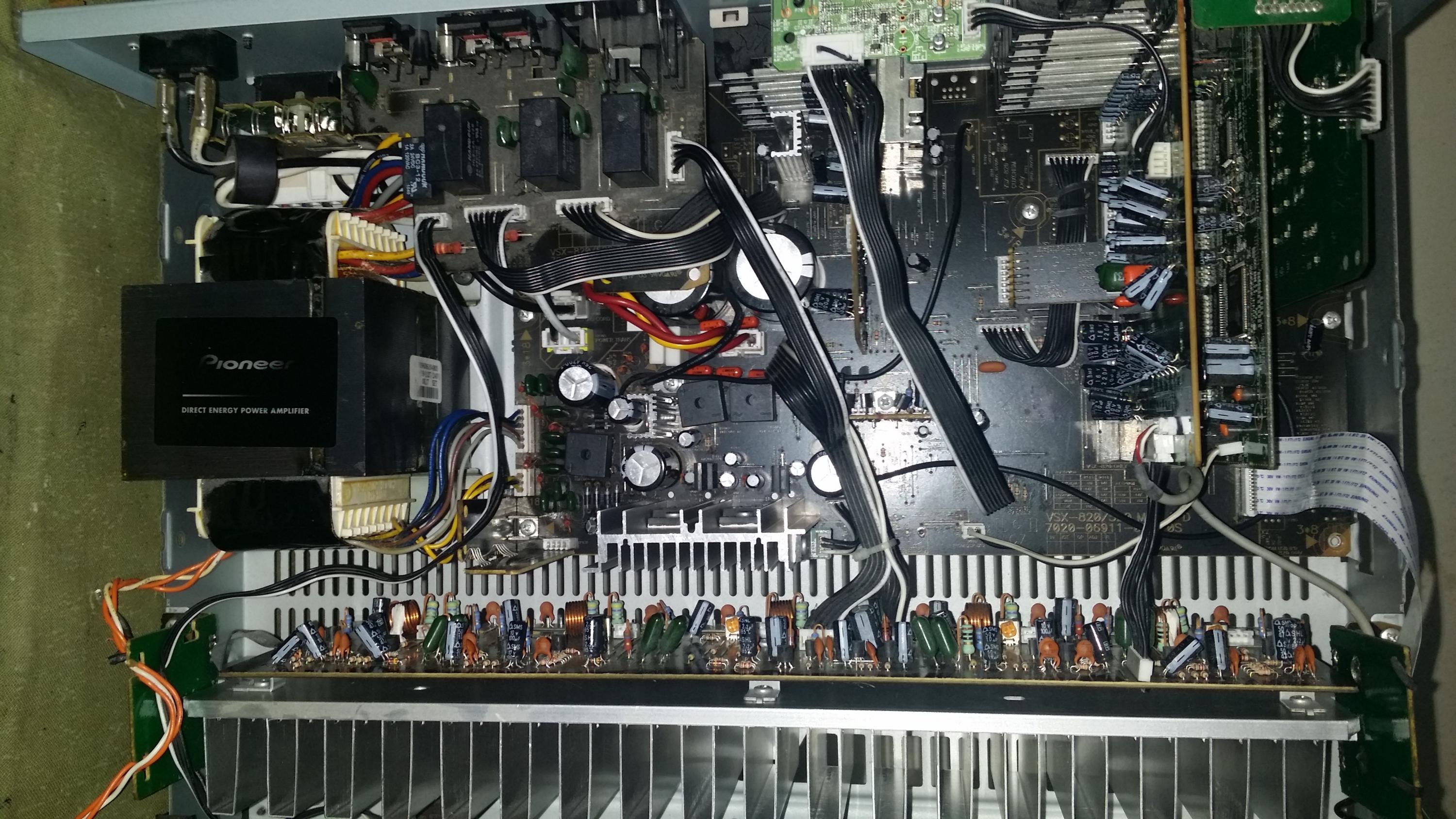

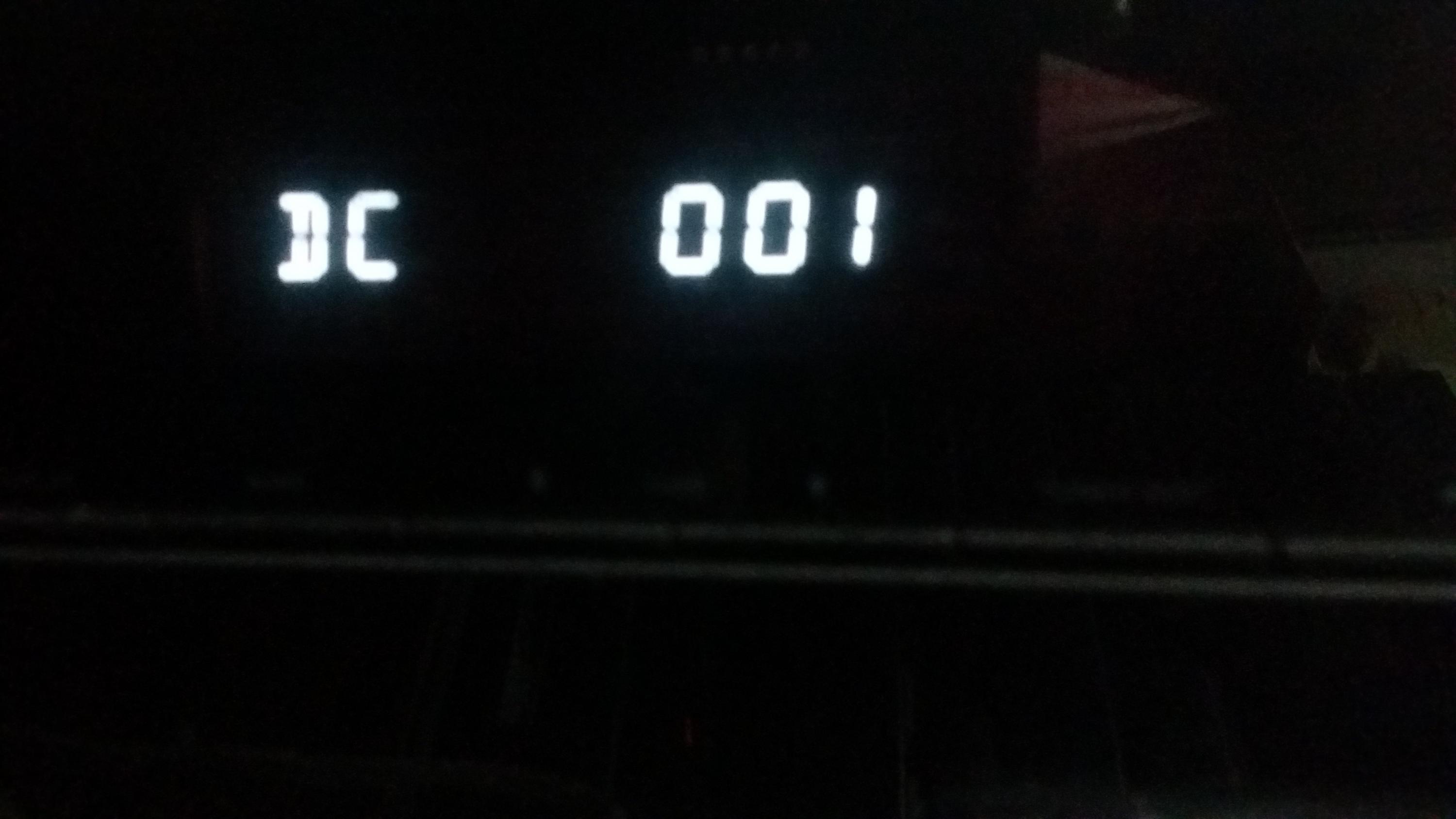

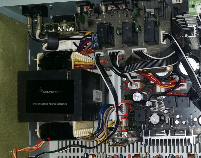

    I'm sure many had this issues with other models but now im having it sadly. The problem im having is DC 001. I suspected the amp block, i unplugged the amp block from the main board and speaker board. Turned it on on safe mode, still shows the same DC 001. So i suspected other boards, i removed the HDMI board, optical board, AV board, video board. Turned it on, still same DC 001. Tried resetting it, clear it, turned it on, shows same DC 001 and turns off after few seconds. Then i have to reset it again to be able to turn it on again. I suspect the main board. Checked all transistors, reading all good. Could it be the transformer? Could be somewhere else on the main board? Need some help here from Gurus. Anywhere shall i seek to troubleshoot or to measure voltages? Please check attachment pictures.

    Unplugging various modules is not a valid test for anything except maybe a dead short that is blowing fuses. Snap it back together again and take some readings on your power output stages.

      Unplugged the amp circuit, tested all the output transistors on the rail, all measured good with no fault, no resistors open either. No DC spotted on the speaker outputs either, probably cause the relay haven't click yet for the speakers to activate. This amp actually was left on standby when i went outstation. When i got back, i noticed it cant be turned on anymore. Nothing burned, all fuses are perfect, all caps seems to be in good condition. Im sorry im not a pro or a technical engineer. Just a normal DIY person with some basics. Hope you can guide me further on where to check and how. Deeply appreciate it. How do i measure the dc output from the transformer to know its fine? Pls see the picture. As per the video below, you can see this guy unplugged the amp cable from the main board and turned it in, it was perfectly fine and no DC error msg, so that confirms the amp block was faulty which is in case i tried the same, i still get the dc error msg. So in here i confirm, my amp block is perfectly fine. See the video from 5:40minutes.

              Already tried that, reset, cleared codes, still switches off.

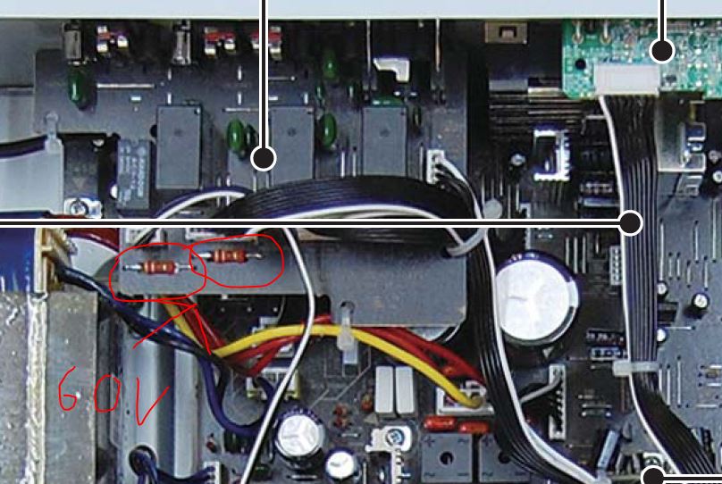

                12v to the relay legs of speakers from the main board are perfect. However, i noticed there's at least about 60vdc on the second leg of the speaker relays I believe thats the ground. 60vdc on the ground? Now thats weird.

                  60v sounds more like a primary rail, are you sure your not mixing up the pins?

                    This is what i meant, its actually a speaker assy. Those 2 resistors i measure using a MM and showed near 60vdc before the power relay cuts off. See picture
                      Re: Pioneer VSX-520-K Protection problem
                      You have 12Vdc for the relay coil, the relay contacts (poles) should not have any DC on them at all (the most will be in mV range), the DC PROTECTION trip point is usually around 1~2VDC range, it does not take much to damage speaker, when the circuit detects that Voltage on the output of the power amp, it will not allow the speaker relay to come on. See the service manual. Did you download the service manual so you can see where to test the Voltages?
                      So you do have problem with the power amp section.

                                    Update : Fully checked the amp block, in and out. All 100% green light. Perfectly fine. No shorts. The short was from the main board. Below the board on the tracks, there was 2 tracks that's filled with corrosion. Manage to clean it out all fully, and installed everything, walla no more dc at output and 12v present for the speaker relay. Its clean
                                    Now, IC101 pin 20 on the main board must have at least 3.3v at standby and 0.5v upon turning on as its the protection circuit. But my MM detects 2.5v at standby. I suspected something at the PT assy. I pulled out the PT assy and checked again pin 20, now its reading 3.3v accurately at standby mode. I will be checking all the transistors on PT assy.
                                    Anywhere else should i be looking at? Now its fully pointing at main pcb as the last resort as everything else seems to be clean and in good order. I suspect this protection circuit happened due to the corrosion below the main board. Luckily the protection circuit saved everything.

                                      Also make sure all the board mounting screws are tightened because that is how the boards are grounded to the chassis ground and for grounding connection between boards.
