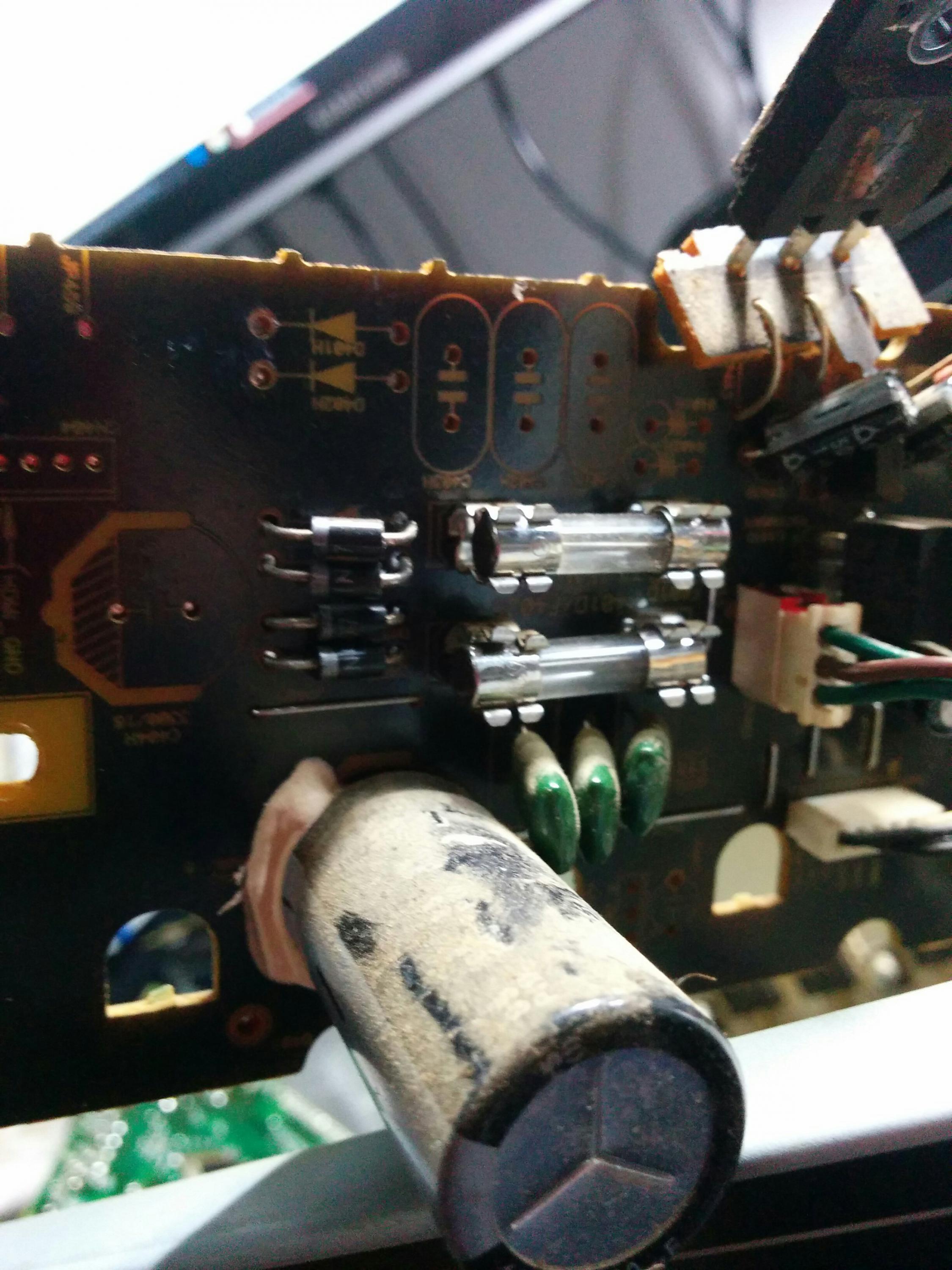

    I had one friend receiver that has a problem. It's a DENON AVR1609. When i turn on, the received relay click, everything is displayed and turned OFF after 2 seconds. The red light flash interval of .5 seconds.
    I replace 3 IN4007 diodes on the main pw entry supply that was faulty. It does the same problem. I found 4 IN4007 diodes in the main exit power where the 2 fuses are located in the transformator input in a board that show "0" of reading in circuit. I've unsoldered, but when unsoldered, measures came back to life by reading 0.5 in diode testing? WTF? i've tested 3 times before unsolder them.
    I know that received has a lot of problem. Can someone help me with that please? Im stuck with the same problem. Thanks.

    Re: Denon AVR-1609 Power On and Off
    Components need to be measured out of circuit.
    How do the original diodes you replaced measure ?

        New ones are 0.564;
        Short ones are "O". But same problem than before.
          Are these the diodes you replaced? This power supply must be working otherwise you will not have blinking LED.
          Did you take the measurement when the receiver is still plugged into the outlet?

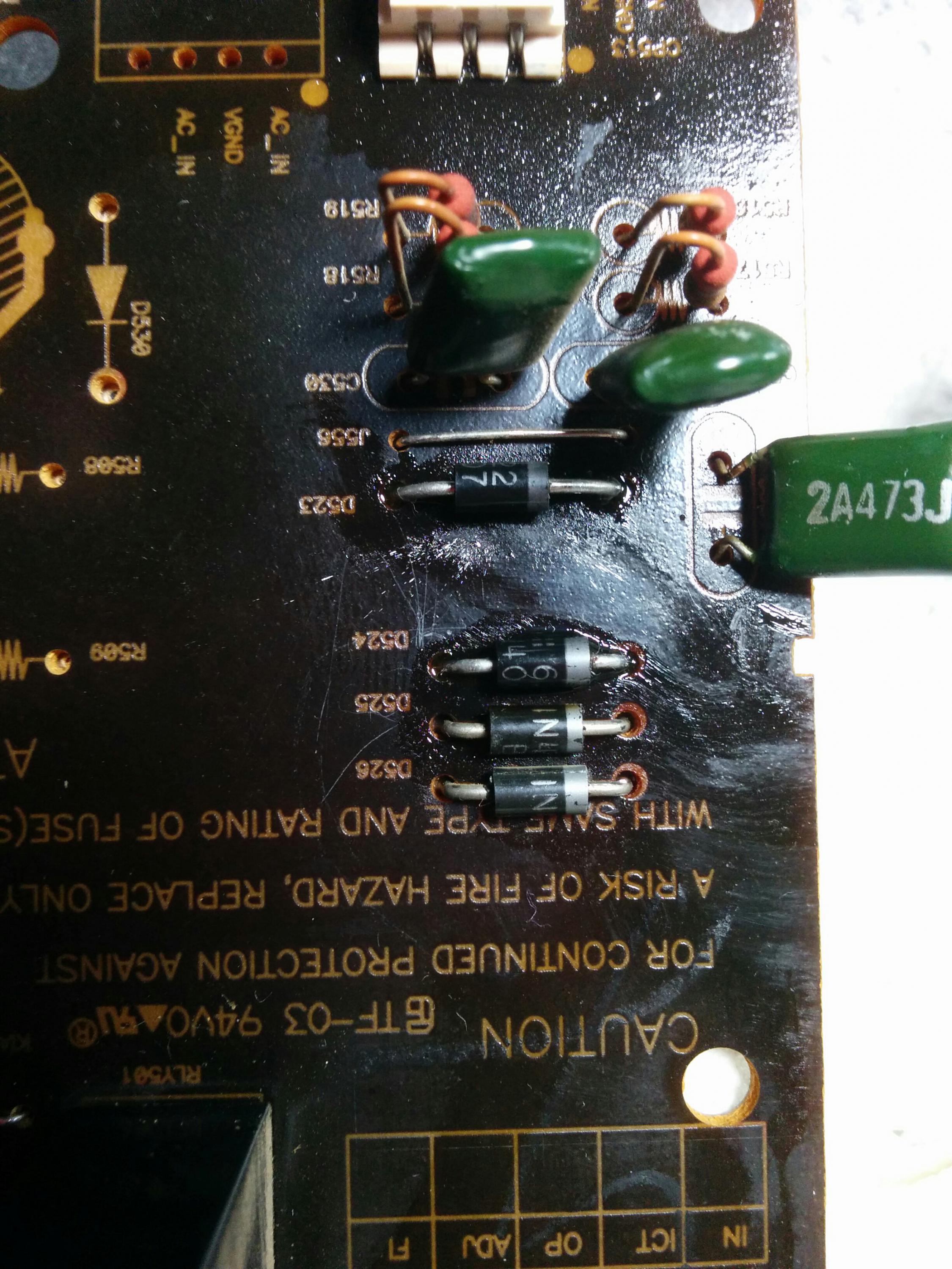

            Can you explain which diodes you changed and which are giving short in circuit? Maybe worth checking out those power resistors. Maybe those changed value.

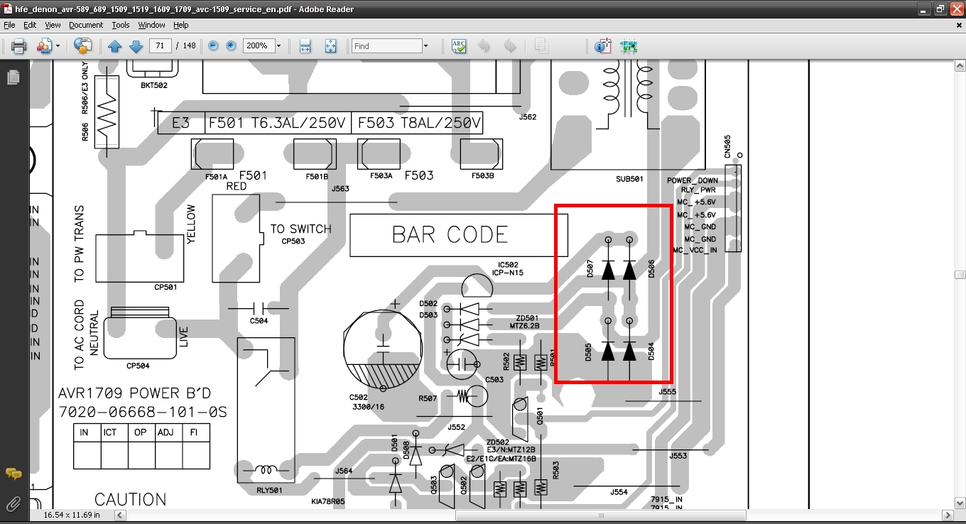

              I changed the D523 and D524. (Fiirst attachement) was replaced.
              The other one tested in circuit has no value is the seconds and 3rd attachement).
              Also check on the 3rd picture, we see an burn spot. Is it possible that the transistor has blown? How can we measure that?
                the transistor you can test with the diode check function of your DMM.
                  I've test it yesturday, seem's fine.
