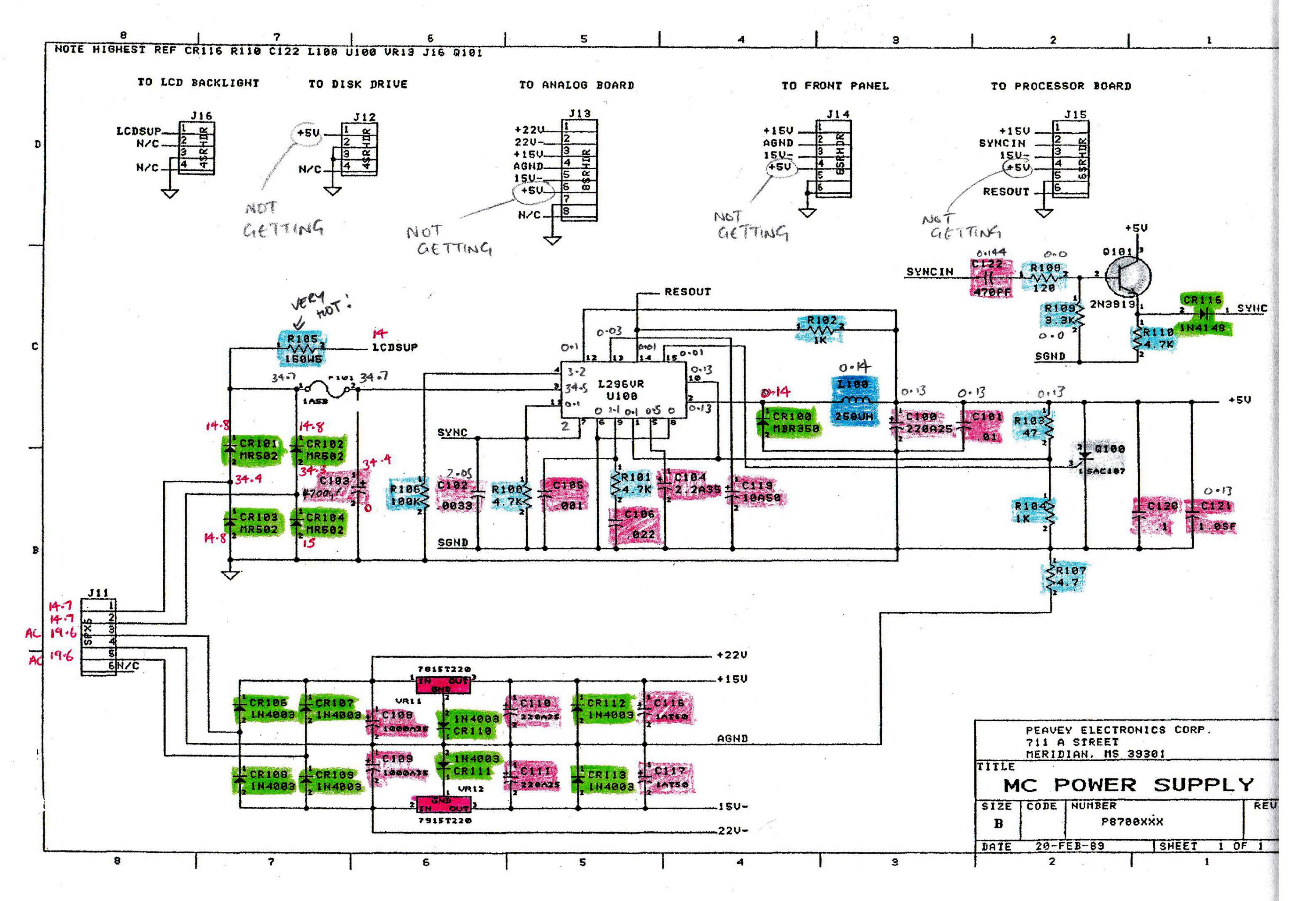

    My friend asked me to take a look at his Peavey DPM 3se Keyboard. All that happens is the lcd lights up and that's it. Peavey very kindly sent me all the schematics for the keyboard. I checked voltages on the power board at first and they read ok. But after taking a few components out and testing them, then putting them back in something has happened.
    Before, the lcd looked clear so you could see the actual pixels. Now it looks kind of blurred. I have checked voltages and there is no +5V. I have attached the schematic of the power board with my notes on it. As you can see i trace the voltage at each component. Everything goes into a component called 'L296VR - U100). Could this could be the problem as output 2 is the rail to the +5v but it's outputting 0.13v.
    Can anyone help and let me know if I've done the readings correct and where I should be checking?

    Re: Peavey DPM 3se power problem
    check if Q100 is shorted out.
    and consider relpacing all the ancient small electrolytic capacitors - that chip is a switching regulator - they are fussy about such things.
      Check the components you removed, you may have either damaged them or maybe have shorted solder connections on a component you re-installed, The +5 volt line may be shorted somewhere loading down the regulator ic.
        Thanks for the replies.
        I did a test on Q100 (SAC187) and attached the results.
        I'll check the components I removed later tonight.
        Thanks.
          I checked everything and I had diode CR100 the wrong way, doh!!!
          The display is back to being clear but still no letters etc on the LCD, no sound. I'm leaving it on over night as I've read a few times when putting in a new battery it gives a blank LCD. So overnight charges up and then you reset the keyboard. So lets see what happens tomorrow
