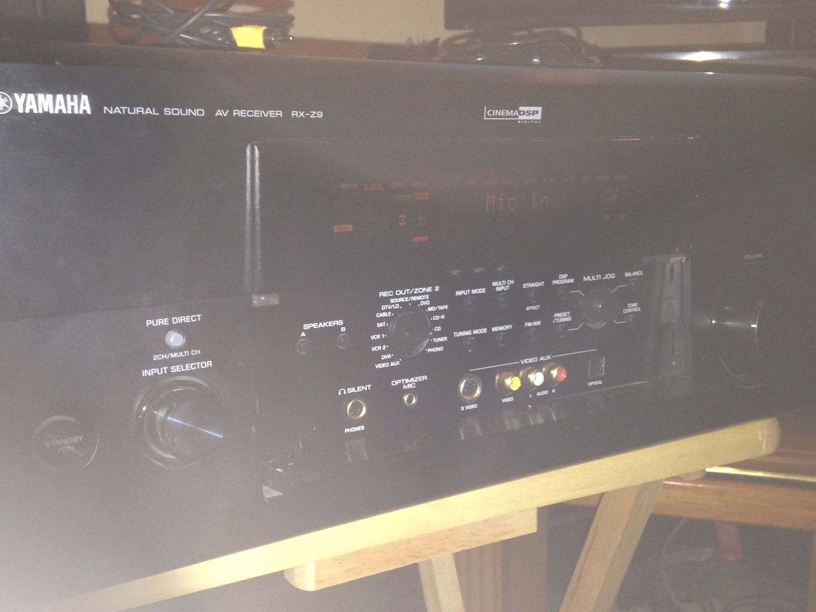

    Yamaha RX-Z9 A/V receiver Microphone port issue
    I just came into a used Yammy RX-Z9 A/V receiver. The front display shows 'Mic In' even though there is no microphone plugged into the front jack. This is preventing me from getting any sound out of the unit except for analog "pure direct" mode. There doesn't appear to be anything jammed into the mic port and I have tried inserting and removing (and twisting and wriggling) the calibration mic plug. I even tried a q-tip with a bit of alcohol to no avail.
    Any help would be greatly appreciated as this is a well built receiver/amp foiled by a small input port!

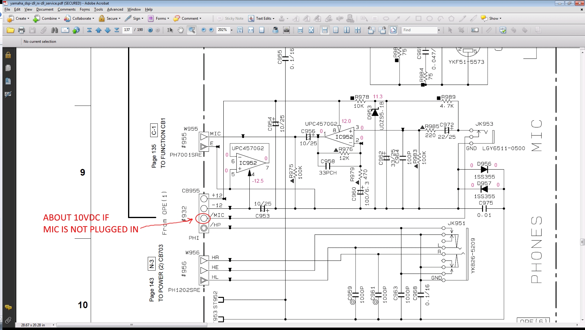

        Re: Yamaha RX-Z9 A/V receiver Microphone port issue
        Service manual:
        You have to sign up.
        http://www.hifiengine.com/manual_lib...ha/rx-z9.shtml
        Check the Voltage as shown.
          Originally posted by budm
          Service manual:
          Wow, that looks right on the money! But is this something a novice should be messing with? I know how to solder/de-solder...but perhaps I should stop there?!
