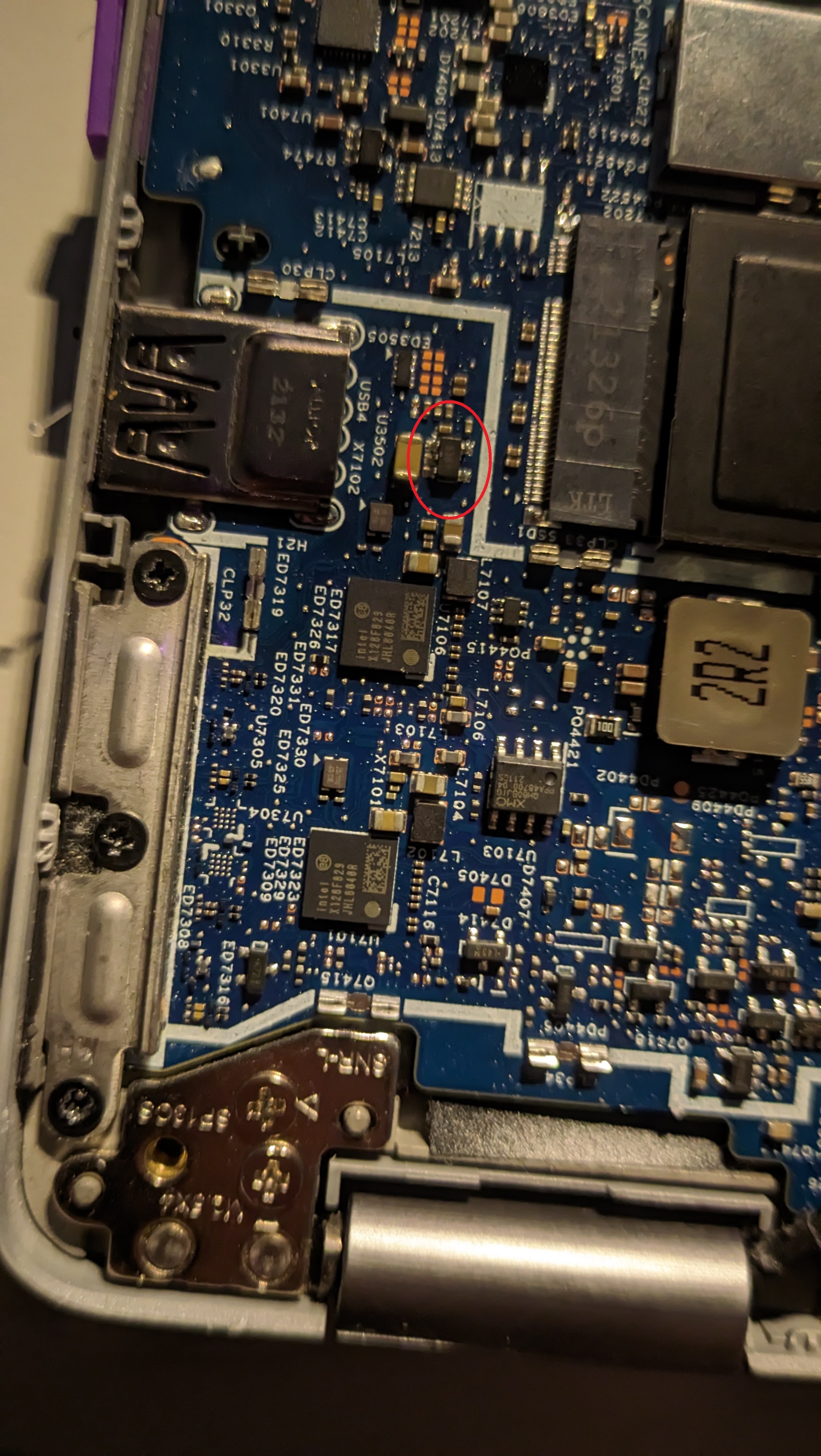

    Hey guys,
    so my half-year out of warranty Dell Latitiude 5320 (19817-1 SOUTH PEAK 13 10L) w/ i5-1145G7 and 16GB just started to act weirdly...
    The first/upper USB-C/TB port suddenly didn't accepted the charger every time and sometimes only a different one... or with a different cable but so far, the self-diagnostics didn't noticed anything so I suspected a dirty port.
    Today however... it stopped completely to accept a charger, the second/bottom one however does and after a half an hour, I notice something getting hot under there... blazing hot!
    I traced the issue down w/ alcohol (too poor for thermal camera) and it's a 5pin IC with the marking "53B7" (see picture)
    Diode readings to GND from top to bottom;
    1L = 14Ohm
    2L = 0Ohm
    3L = 1310Ohm
    1R = 14Ohm
    2R = 1840Ohm
    Now I'm asking you for help... may that be the real issue or is something more beyond that?
    Best regards
    ~Daniel

    Suspecting this to be a SOT23-5 packaged TVS ESD diode array. Flux and carefully remove the part and test the PCB pads again (without his part on the board).
    Also, when you are in DIODE mode, these are voltage readings.
    When you in RESISTANCE mode, they will be in ohms.
    When in DIODE mode, be sure the RED meter probe is to ground. Black meter probe on the pin to test.

      Looks like a switch/mosfet. It may have gone short. Remove it like mon said, and test resistance between each of IN, OUT, and GND pins. Should be 6 readings. Also test the board pads resistance of IN and OUT to GND. Let us know what you find.

            Uhm, now I'm bit confused but on the chip itself, I got these readings;
            IN - OUT = 2 Ohm
            IN - GND = 14,5 Ohm
            OUT - GND = 14,5 Ohm
            (used the G524 images as pinout)
            On board I got;
            IN - OUT = 16 kOhm initial, raising to infinite kOhm slowly
            IN - GND = 2 kOhm initial, raising to 4,6 kOhm
            OUT - GND = 500 kOhm initial, raising to infinite kOhm slowly
            • hobostove
              • May 2023
              • 73
              Yeah, switch is definitely dead. The 5V in has only 14.5 ohms to jump to ground. No wonder is was getting so hot. Almost 2 watts going through that tiny chip!
              Thermal Resistance Junction to Case, (θJC)
              SOT-23-5. . .60°C/W (Means it was about 120C above room temperature) 😅
              Board is good. Time to order a chip

                    It's possible it's just a coincidence. One way to find out is you can power it up with that chip taken out. You just won't have 5V on that USB-A port, so it won't work. But everything else will work fine

                      Hmm... Both USB-C/TB ports takes power and PD in except the first/upper port only on one side, I tried with several cable different cable and my Lenovo USB-C brick (don't have the Dell original one)
                      Maybe USB-C port is a bit loose? Loose and somehow bricked the IC by accident? (At least no heater inside anymore)
                      I use a J7-c in between to check the voltages and something caught my eyes, I have one cable with a small display for Watt reading and if PD is enabled or not, no matter how I flip it, it keeps blinking on the first/upper port but not on the second/bottom port (on the picture I've sent it's upside down ofc ^^)
                      • hobostove
                        • May 2023
                        • 73
                        The switch chip may have been broken for a while, and you just noticed it because you were actively looking for a problem. Don't think it's related to the USB-C issue.
                        The fact that it got worse overtime and didn't just suddenly stop makes me think the port is dirty or damaged. Try to get a good look at the pins. You'll need a magnifying glass or microscope, etc.
                        What does the J7-C tester say on that port? Does its screen come on?
                        • D3D_Tray
                          • Oct 2024
                          • 11
                          • BDR GmbH
                          The J7-C test only powers up on one side, the other side it acts like being not connected.
                          Are there any testpoint on the board to test the USB-C pins? I have a breakout board for USB-C so I could check for continuity on each pin (the manual way)
                          I also realized this morning that only the USB-A port on the same side doesn't have 5V, the other side still functions fine :o
                          • hobostove
                            • May 2023
                            • 73
                            On the side it powers up on, does it negotiate more than 5V?
                            Not turning on at all means an issue with the CC lines. Since it works one way but not the other I'd say the port itself being bad is very likely.
                            • D3D_Tray
                              • Oct 2024
                              • 11
                              • BDR GmbH
                              Nothing, no 5V or PD negotiation, I even externaly powered the JC-7 but it's dead. Even when I try to attach as USB-C device, only works on one side (tested just now) so I assume...
                              A worn out USB-C port (nice... yesterday first time desoldering a tiny IC with hot air and now an USB-C port although I have low-melt solder w/ bismuth)

                                        So late update but I DID IT!
                                        I managed to solder the new USB-C port and it work flawlessly now
                                        I used low-melt solder for the pads and on the anchor pins regular solder to give it more strength, hope that was not a bad thing to do for the long run :/
                                        Thank you all for your help and time, I never thought that I could make it but that was definitely a good start for me to get used to soldering with hot air and I hope, that I'll learn and do more with the time!
